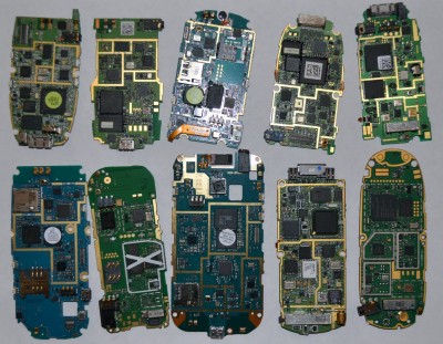

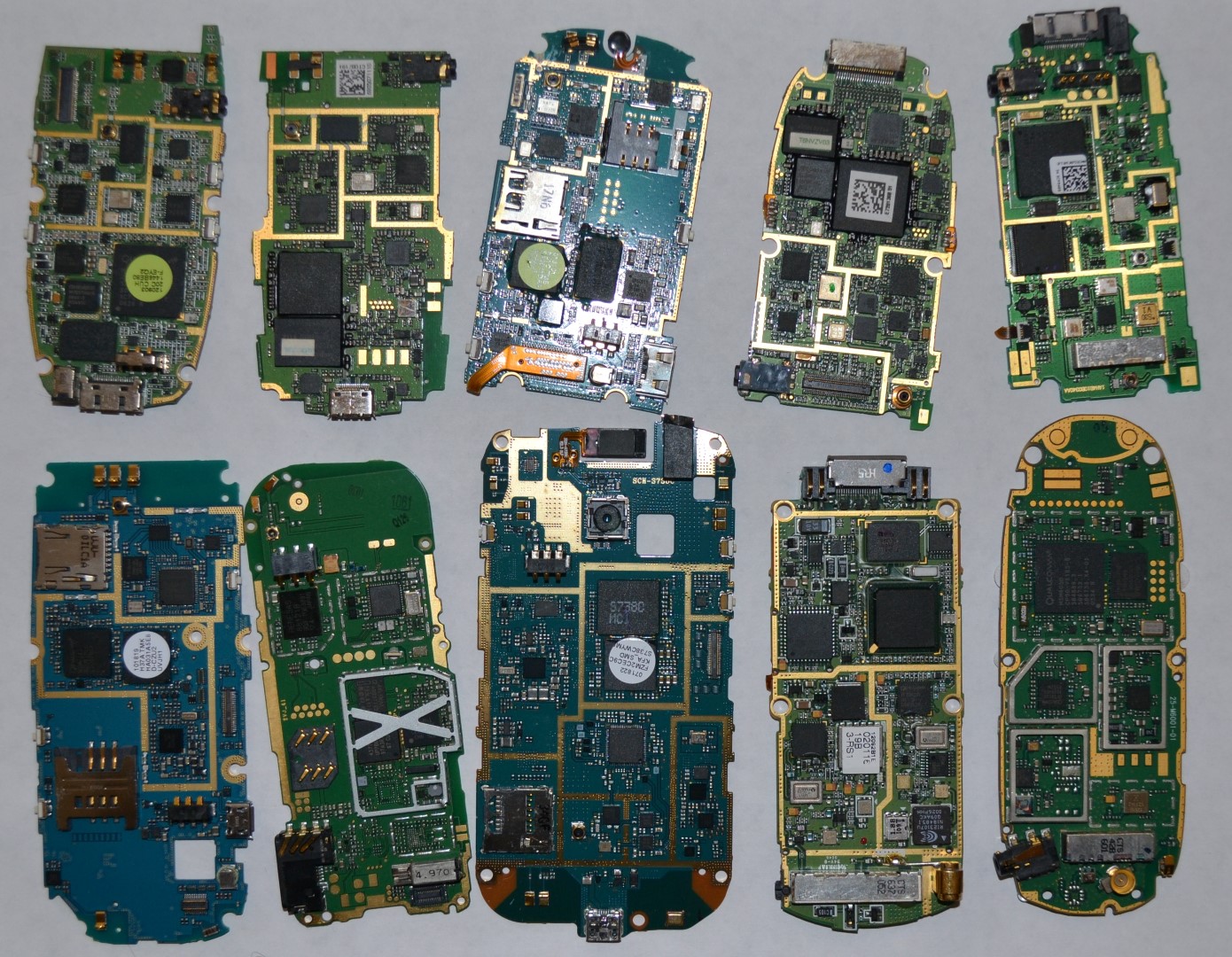

I pulled a handful of clean cell phone boards (below) and weighed them out. Those ten boards weigh 0.338 lbs.

Those ten cell phones without scraping would weight way over a pound. The smallest cell phones I've ever seen weight 2 ounces so you need only 8 to make a pound. There is a smart phone board there so those weight about 3.5 oz. Average flip phone weights about 2.5 oz
You get more money keeping the phones intact.

I agree...And, if he's got 82 lbs of good phones left, he's looking at stripping down over 500 phones, to recover less than 18 lbs of boards (using all the above numbers). That would take me more than a few football games and NASCAR races worth of time...

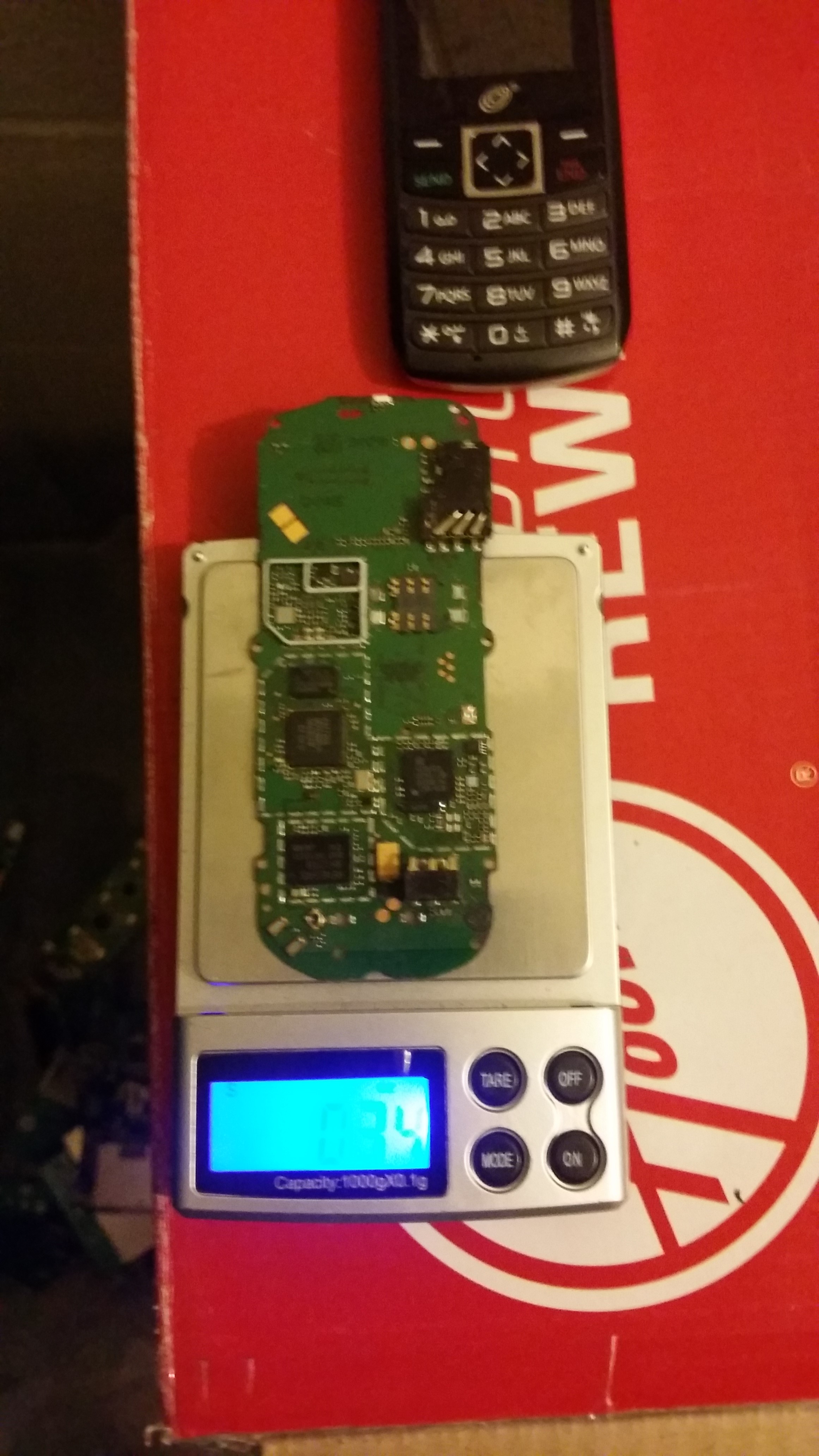

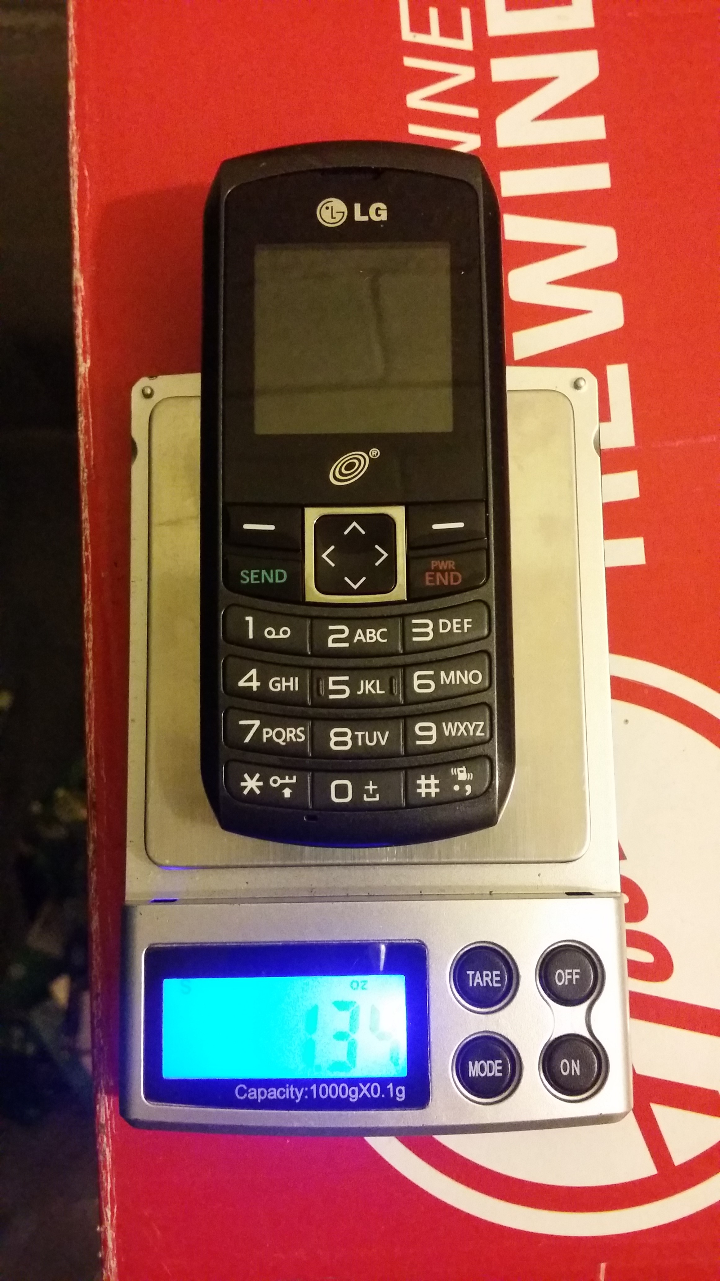

Here is a real sample. In the first pic the tiny cell phone weighs 1.34 oz. You'd need 12 of those for a pound = $4.50. In the second pic the board weighs 0.34 oz. You'd need 47 of this one to make a pound = $10.00
47 of these unscraped phones are about 3.9 lbs at $4.50 per lb = $17.71
So the labor will actually cost you money and hours and hours of wasted time.

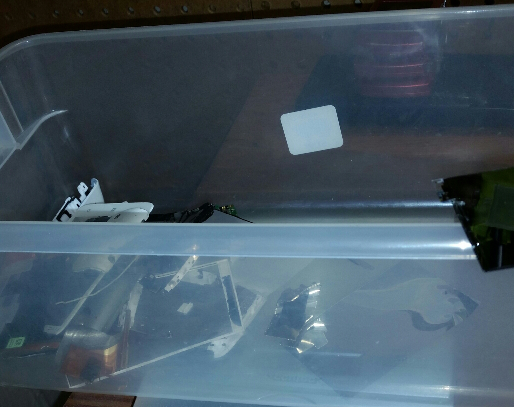

Your ignoring the rest of the phone. Here's my every-part breakdown on an htc flyer.
in ounces
Motor .1
44c - 3c
Ag .1
$16/oz - $1.6
Green dlp .1
$5.75 -36c
Gold contact .1
65c - 4c
#2 .1
$2 - 1c
Lite wire .1
$1.6 - 1c
Gold wire .1
$10 - $1
Cell board 0.4
$10.5 -27c
Shred 0.6
5c - 1c
Gold recovery .1
$12/oz - $1.20
Flat.wire 0.5
6c -1c
Sheet aluminium .8
55c -27c
Screen 0.3
$1-2c
Stainless 300 series 0.8
40c - 2c
So I'm seeing $4.85
For the phone scrapped
Better than the whole phone price.
