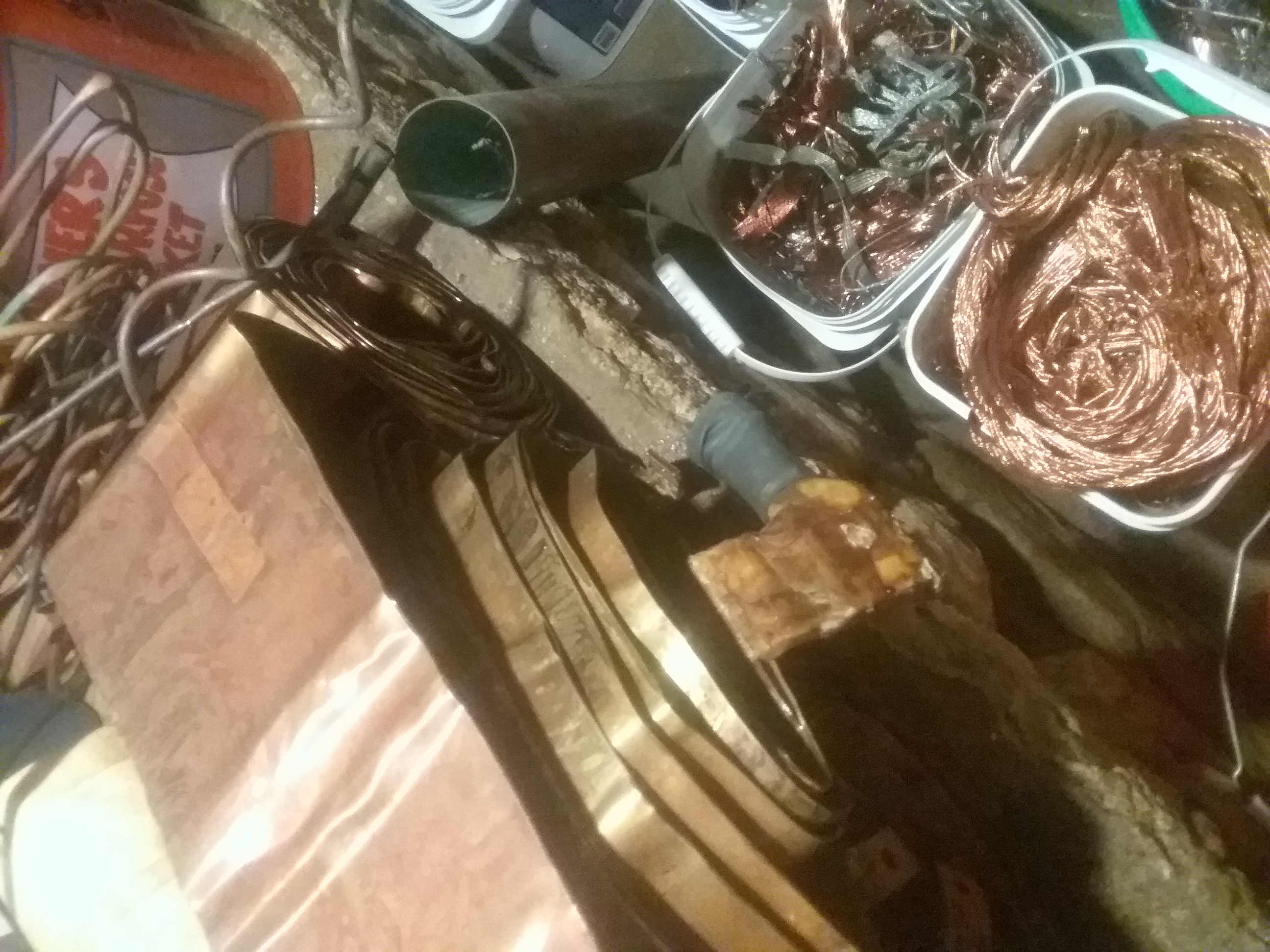

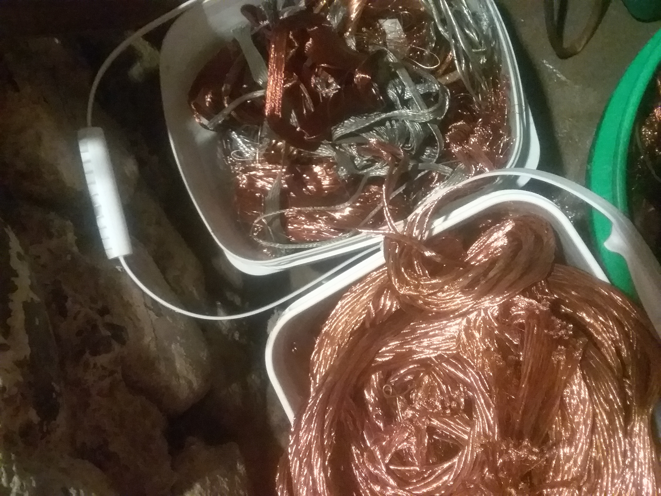

Here are a few examples of what my yard would consider number 2 copper.
The bare bright copper that is shown in the pictures goes as number 2 for me because the individual strands of copper are smaller than a number 2 pencil lead (my yard's description, it will vary depending on which yard you go to).
