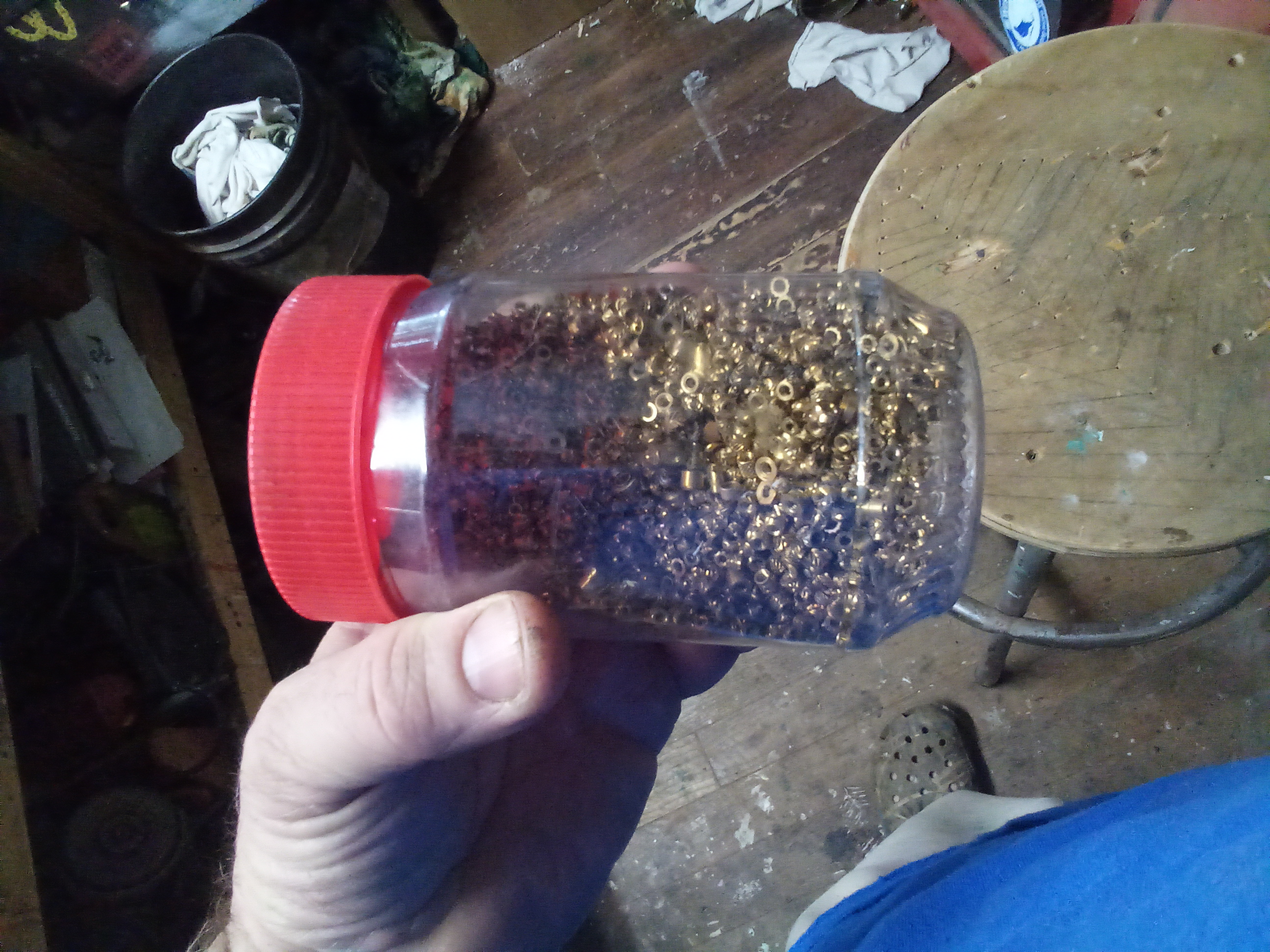

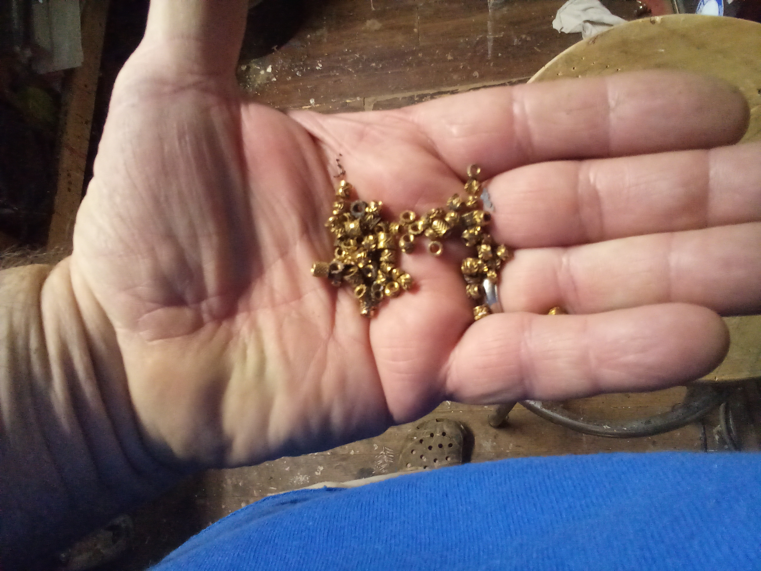

Perhaps some of the objectionable metal in computer cases comes from the embedded brass nuts used to hold small bolt ends. I remove these just for sh@#ts and giggles and have a container of them I sometimes use as beads in recycled jewelry making. I doubt anyone bothers to remove them before sending computer cases in. It's rather tedious. I found a fairly easy way to do so is with a metal pick tool or scratch awl. Simply spear the center and pry it out of the plastic. You also get a nominal amount of brass scrap in the process if you don't care for jewelry making. I've been thinking of taking my container to a local bead shop to see if they'd like to sell it.
I certainly would not want to recycle material containing the amount of metal these inserts have if I were a scrap yard.

That’s a great method. I use a hex punch for prying them out.
When that failed I flip the plastic over and hammer it out with a circle punch. Making dirty brass (brass and plastic).
The problem with brass rings is they can’t be pulled out of shred easily. They are non magnetic. They are too small to be conductive. And they neither float nor sink in the melting process. Staying suspended.
It’s not just computers either. Those brass rings are in so many electronics cases. From really tiny ones in watches to alarm clocks, stereo equipment, game systems, coffee makers….!!!!
The price adds up fast recovering them. I’m surprised more people don’t.
