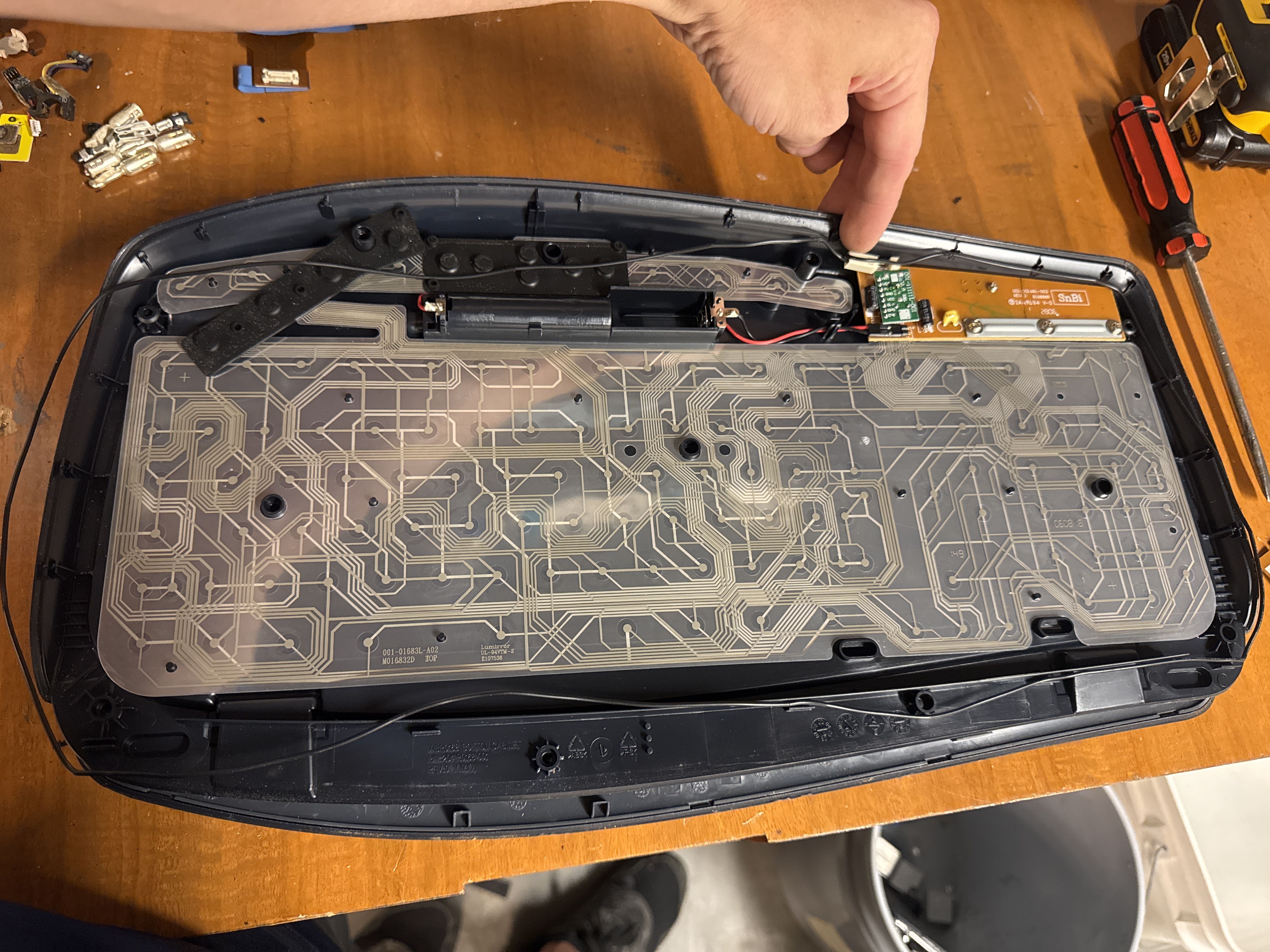

 Post subject: Wire loop in keyboard?

Kinda reminds me of a degaussing loop from a crt monitor. Connects to the main board and just loops around the housing.
What's that about?

Depends on what it is.
Could be an antenna.
Could be for radio interference compliance. Or a number of other things.

Google the keyboards Make and Model for the schematic diagram. Parts layout and parts list.
Hopefully. You can get a download or something. That coil should be labled on the schematic and/or mentioned in the parts lay out or parts list.
That should give you a clue to it's function.

As a side note. That coil could be for a FCC compliance for a quiet RF environment for the computer itself and surrounding devices.
Look for a tag on the keyboard stating what FCC regulation the keyboard fulfills.
But. Yeah. Sure reminds one of a degaussing coil on a CRT. Also a AM home antenna.

Too late to check any of that.
Whoops ¯\_ (ツ)_/¯

My best guess is compliance
2nd guess an early wireless keyboard.
Some like Microsoft had massive antennas.
That often were out of compliance lol

If curiosity "killed the cat." Wait! I better stop there.
After doing some further research on your question. Yes. I have the time to do this. I am retired. Of all the employment I had through the years in the electronic field. I never did home computers or main frame. So. I would like to know also.
LOL. ( After quite some time surfing the internet). The answer is right in your posted photo. Though part numbers on the plastic case and circuit boards are blurry.
One can see the battery case. The wiring reveals the answer. The battery powers the PCB. The PCB then is the low frequency transmitter. It's output feeds the coil which your question is about. All the right components are on PCB to be a primitive but effective transmitter. That keyboard most likely is early first run wireless keyboard engineering to satisfy customer demand. Wireless quickly evolved beyond that.
I totally 100% agree with lostinlodos. The 2nd guess.
It is an antenna for the wireless. Batteries drained quickly with that setup.
I got to hand it to the original owner of the keyboard. The battery holder doesn't show corrosion. So many individuals leave batteries in fine old antique equipment. Ruining them. Example. Old pocket transistor radios.

Later designs incorporated the antenna into the keyboard traces.
You will see long copper traces through the keyboard. Not connected to the keyboard matrix. Sometimes the antenna is on another PCB.
It was all a of matter of eliminating those antenna loops and solid antenna wires.
That has little to do with tear down e-scrap.
But. You did ask. What is this?
