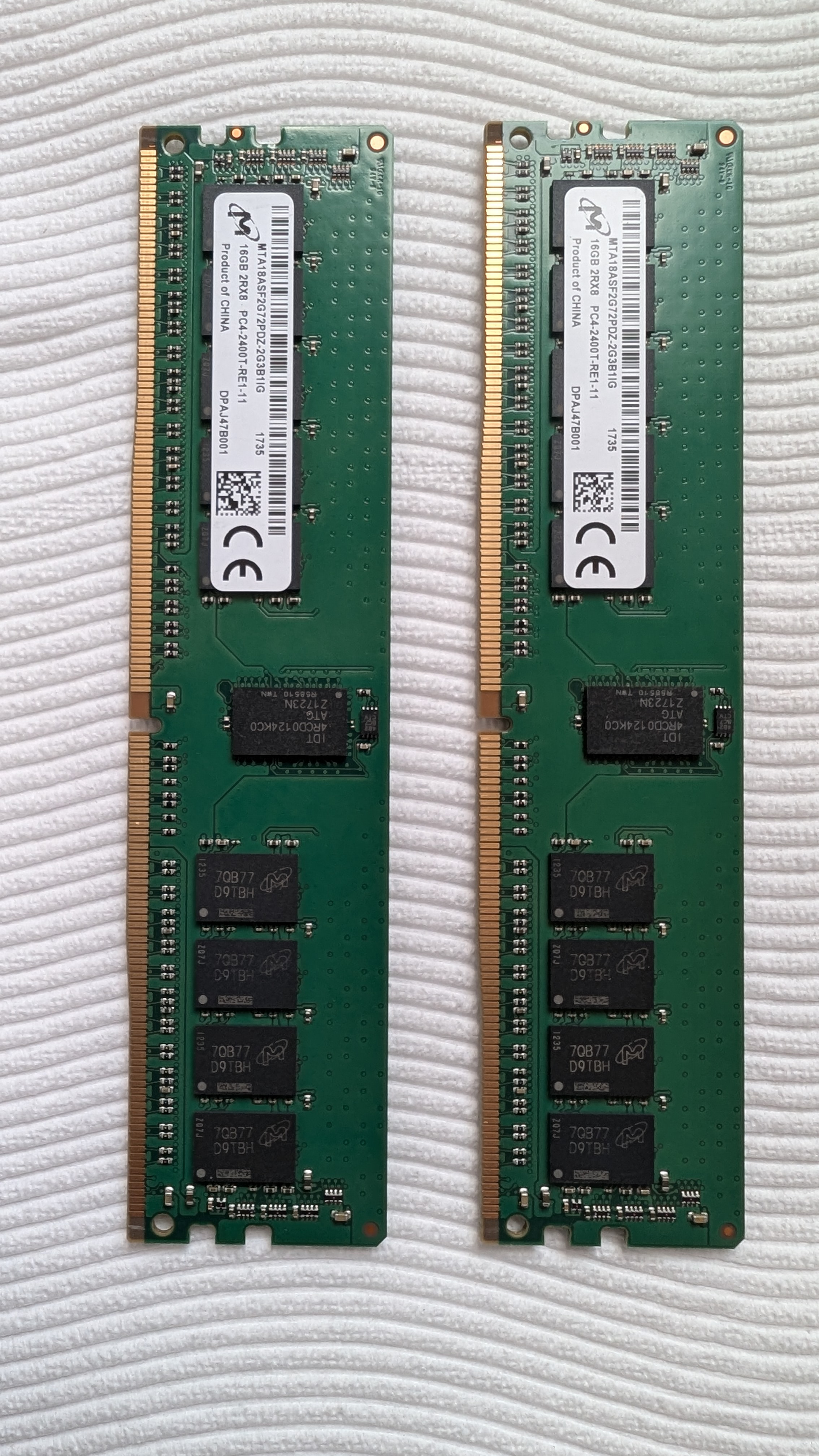

Is there a different in server ram and the ones you find in pc,s

When selling it on eBay or marketplace do I need to specify say from sever or will it work in pc,s. Sorry I'm new at this

I’m not sure what “marketplace” but usually you sell the memory by its brand and identity
16GB 2X8 PC4-2400T

I have found that in most cases the server ram will not work in regular personal computers. The server ram is designed to self correct and most personal computers are non-ecc. Like Lost said in scrapping it makes no difference and of course he is the top pro here. For those who do not know Lost has been the mainstay on this site since he joined and puts in a lot of time and effort to help all who read this site not just the members. I read the information here for over a year before I registered so I am sure there are many more people reading this then are registered. Thank you Lost.
Good note. That’s generally correct on mainstream computers (think bestbuy, Walmart, Fry’s) from the early mid-2000s through somewhere over the last 5 years.
That said: most major brands have/had a “prosumer” level that definitely takes ECC. Ryzn boards exist for error correction memory as does Core7 boards.
You’ll find boutique builders also have offerings in custom builds.
And it’s quite common in cloud and thin client boxes.
It’s not a general thing, but gamers and super-compute users like compile-distribute programming and massive database processing, rub shoulders and compete for parts.
Game like Halo Infinite and the new Silent hill need power. The same power that does AV1 encoding, massive set data compression, crypto processing (including mining), and raw code compilation.
But ram, and sockets, is one of the three most common failure points on computers. Along with the CPU and socket, and primary PCIe port used for video cards.
So if you intend to resell it as ram you need to test it. (Surprisingly, it’s easy to get a thin-client that uses ECC memory for under $100 and in many cases under $50).
MemTest64 is a go to tool for many millions of techs. The classic MemTest (not from PassMark). These are bootable CD downloads that do one thing, boot and load a ram test.
That said, ram testing is time consuming.really time intensive !
Like sending a 6 word happy birthday message over quest in 1982 slow.
So look up your part numbers and the sold prices on ebay or selling prices at somewhere like Big Data. No sense in spending 12 hours on a $1 stick. Just scrap it!
