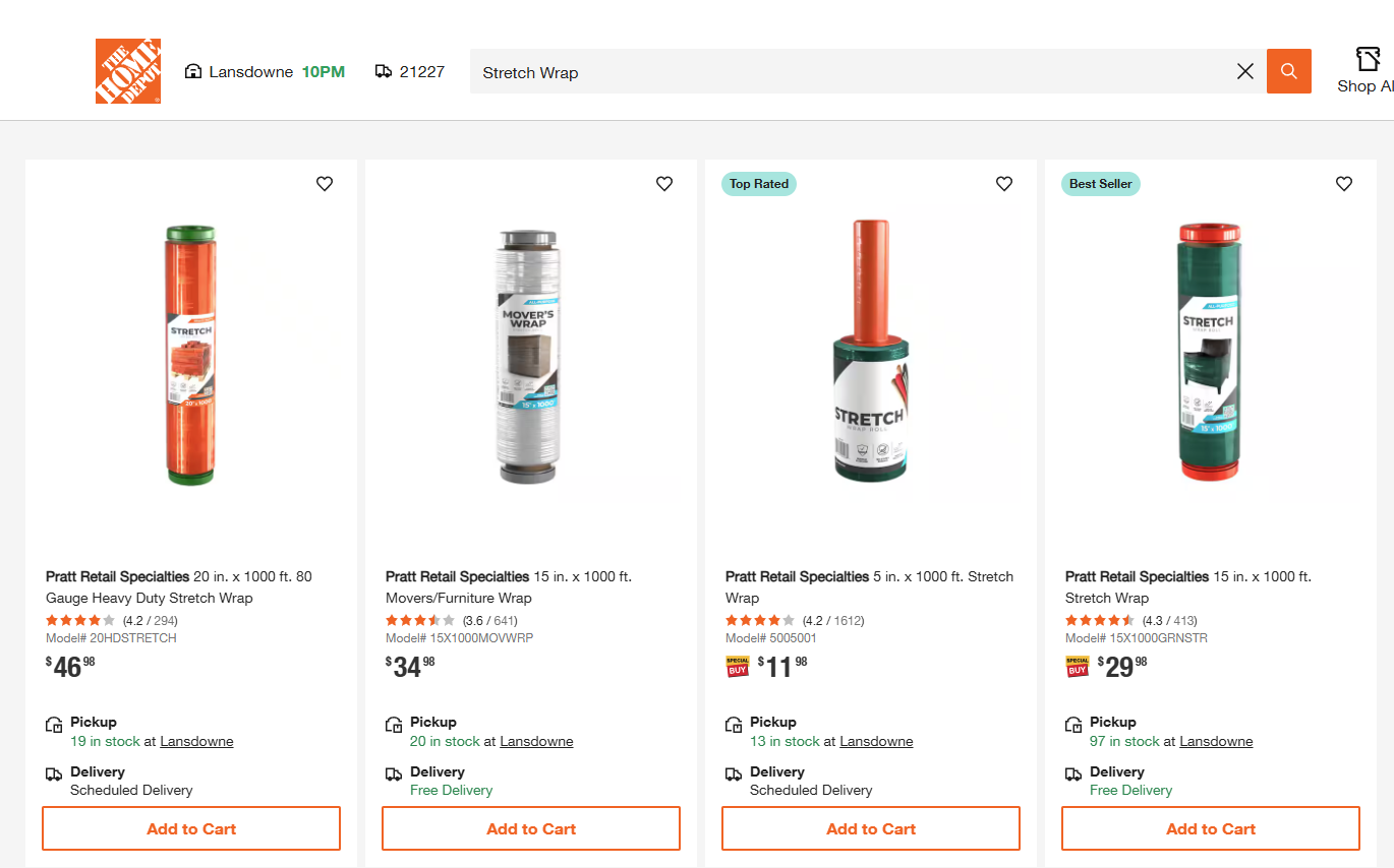

I've been an Ebayer and Scrapper for many years. The best thing I've found to wrap things up nice and tight before placing them in the shipping box are the hand held Stretch Wrap rolls you can get from your nearest Home Depot. They keep everything nice and tight, help stop items from moving or shifting in the box, and adds a bit of protection at the same time. Also, it's easy for the destination crew to simply cut the stretch wrap off with a razor knife or scissors. This works great for Ebay items that need to be shipped. I have yet to try this for Boardsort, though, so I don't know if the people at Boardsort would go for this.
