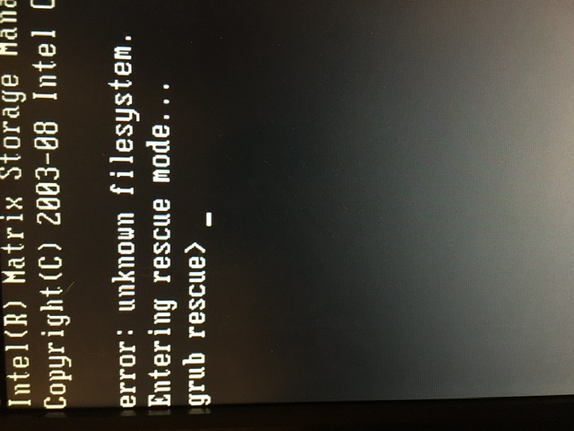

Got a couple of computers for free to recycle. But they were still serviceable so I wanted to flip them. One I did right...one not so much lol the hard drive had Ubuntu installed on it. I tried to install windows and I don’t know what I did but somewhere in there I deleted a partition, started the install, the install stalled at 97% and ever since I can’t get it to boot to even do a new install. The partitions arent recognized. Getting no filesystem found, error unknown grub rescue, etc. i don’t care to recover anything, just make the hard drive serviceable again so I can install windows. Steps I found online all assumed a boot record could be found but I don’t have the same luck.

With leaving Linux, hard drive issues are commonplace.
Many file systems work in the Linux environment. Some are containerised (much like Apple’s APFS). And having other tools, especially Windows PE, see all various aspects, doesn’t always work.
If various standard tools and installers have issues try gParted. they also offer a live cd image or live USB.
I’ve used that to recover from Uber borked installs. Just delete all partitions and then create a new one. I suggest using ext3 as the partition and then letting windows do NTFS. The open NTFS library is flaky. Going to true windows should use Microsoft’s own legitimate NTFS platform. Ext3 is ‘supported’ under windows and any windows disc or usb from 7 or later will at the minimum see the drive.
The point of doing a new partition here is to make sure there’s no remanent of any boot loader left behind that’s not overwritten. A minimalist safety net of sorts.
That is assuming you can boot off a USB/live CD.
If you can’t boot off a live disc or USB now, you have a larger issue than a botched OS install. Which would require a bit more digging to look into. And another longer post so try this first.

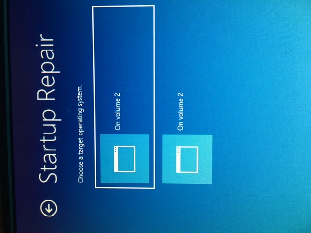

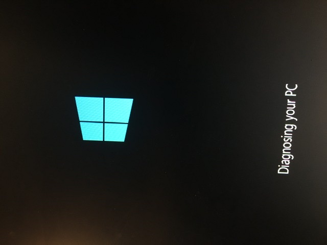

Don’t know if these images provide any clarity into the mess I’ve created lol
PostPosted: Thu Jan 23, 2020 10:31 pm
Posts: 365
(Pics are apparently in reverse order sorry about that - and rotated, too, how fun)

And yes the images confirm what I thought. Just a partition container issue.
Done that myself before coming from Linux, Unix and others to a new windows install. Windows isn’t very good at dealing with partitioning in general. And very bad at mixed and multi part partition file systems.

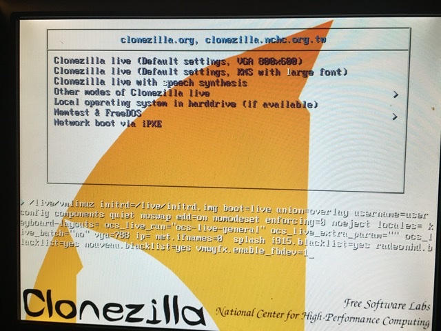

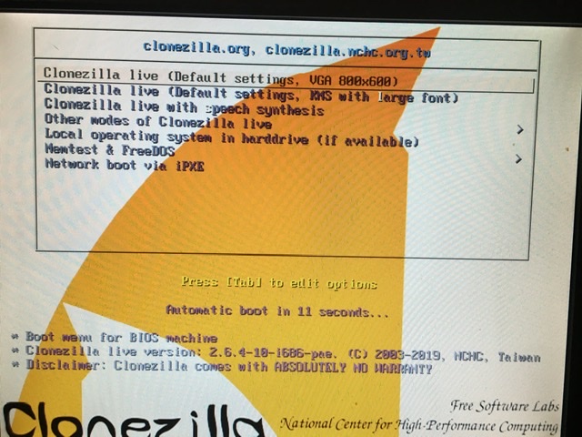

Ok I don’t know what’s going on...see images.
First screen says to tab to edit options. As soon as I tab the screen goes to what’s shown in the second image and apparently can’t change anything from there and have to force a shutdown

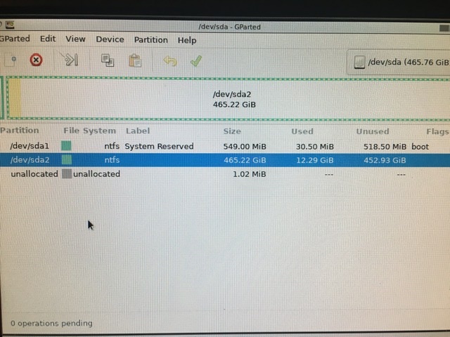

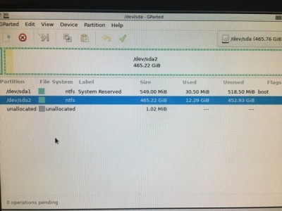

Ok tried again and now I’m in gparted
What specifically do I do here?

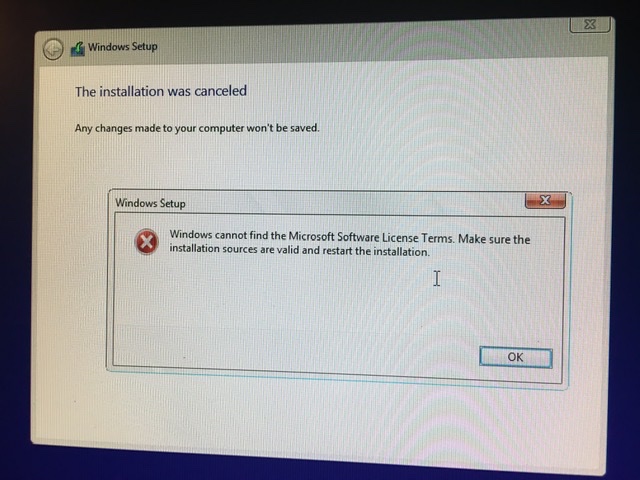

Ok more progress made....and now stuck on installation after inputting the product key (which you may recall was NOT an issue at the beginning of this process...as mentioned before the install got up to 97% before locking up)
Ideas?
