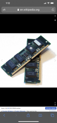

If you are missing labels. An image is attached.
This image fits multiple formats but 100% of the EDO memory modules.
It may have silver, nickel, or gold connectors. But! It will always be a layered IC. Meaning it’s never flat. It will also always be multiples of two in the memory ICs. 4, 6, and 8 are most common. Dual sided 6, 8, and 12. Anything more Than 8 or 12 is likely just a high capacity SIMM or first gen DIMM. ALL EDO memory is on SIM/SIMM PCBs

You’re on the right track. But not quite.
All ram from that era looks like the image above.
Crucially (not the company) EDO will never look like modern ram.
Yes. A photo helps. Especially if I can read the I’d numbers.
