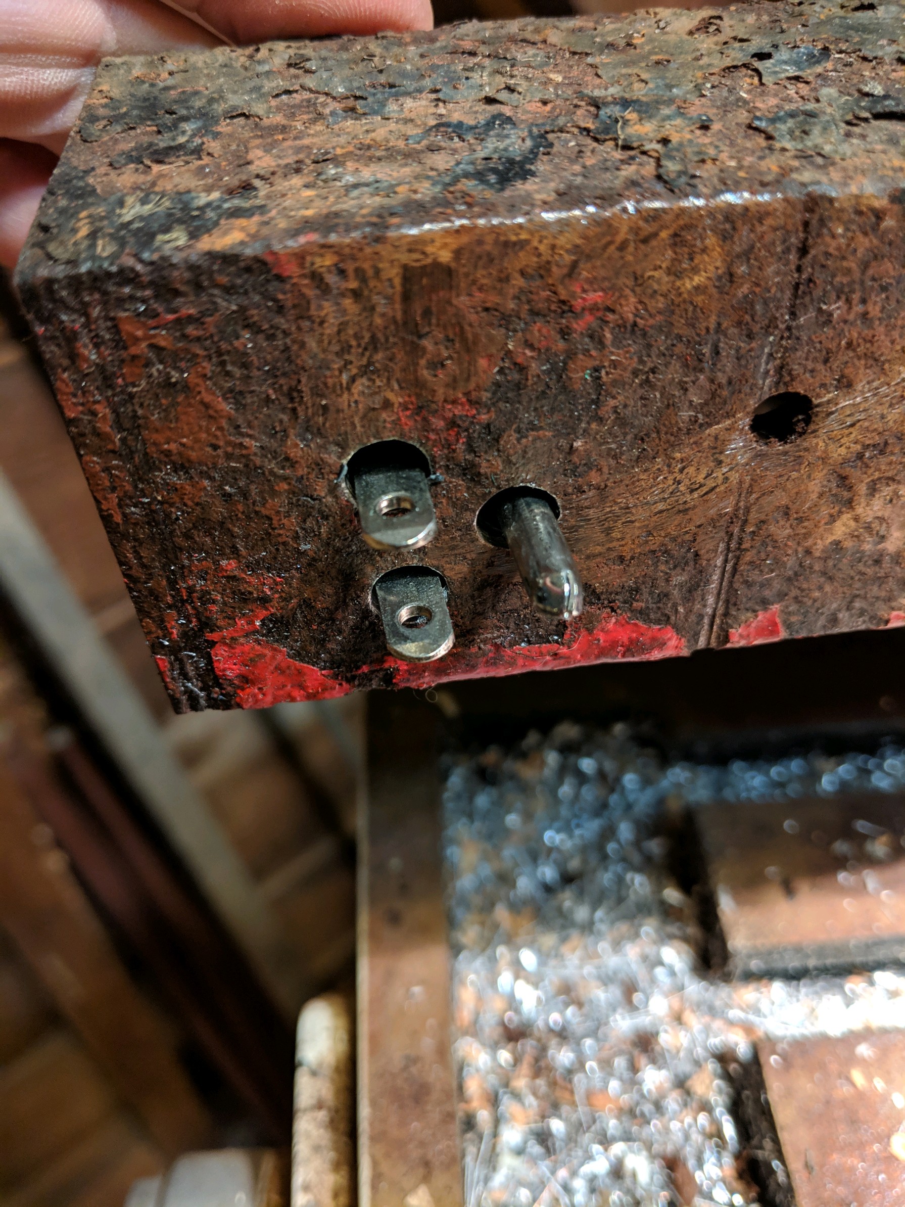

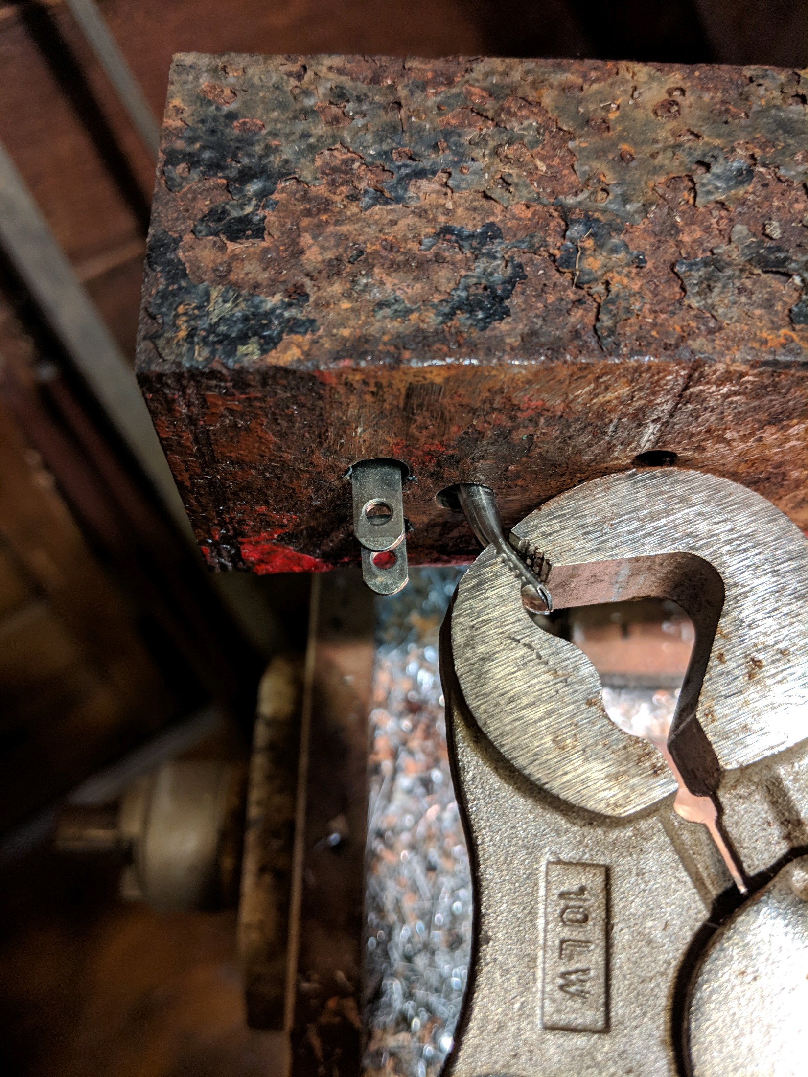

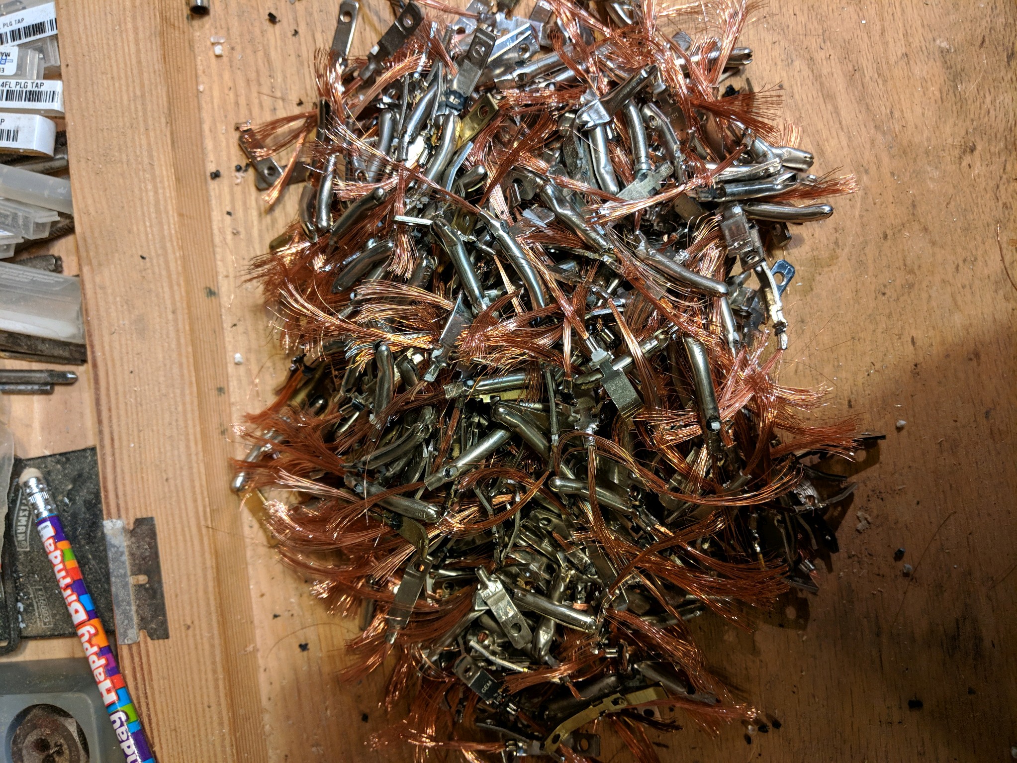

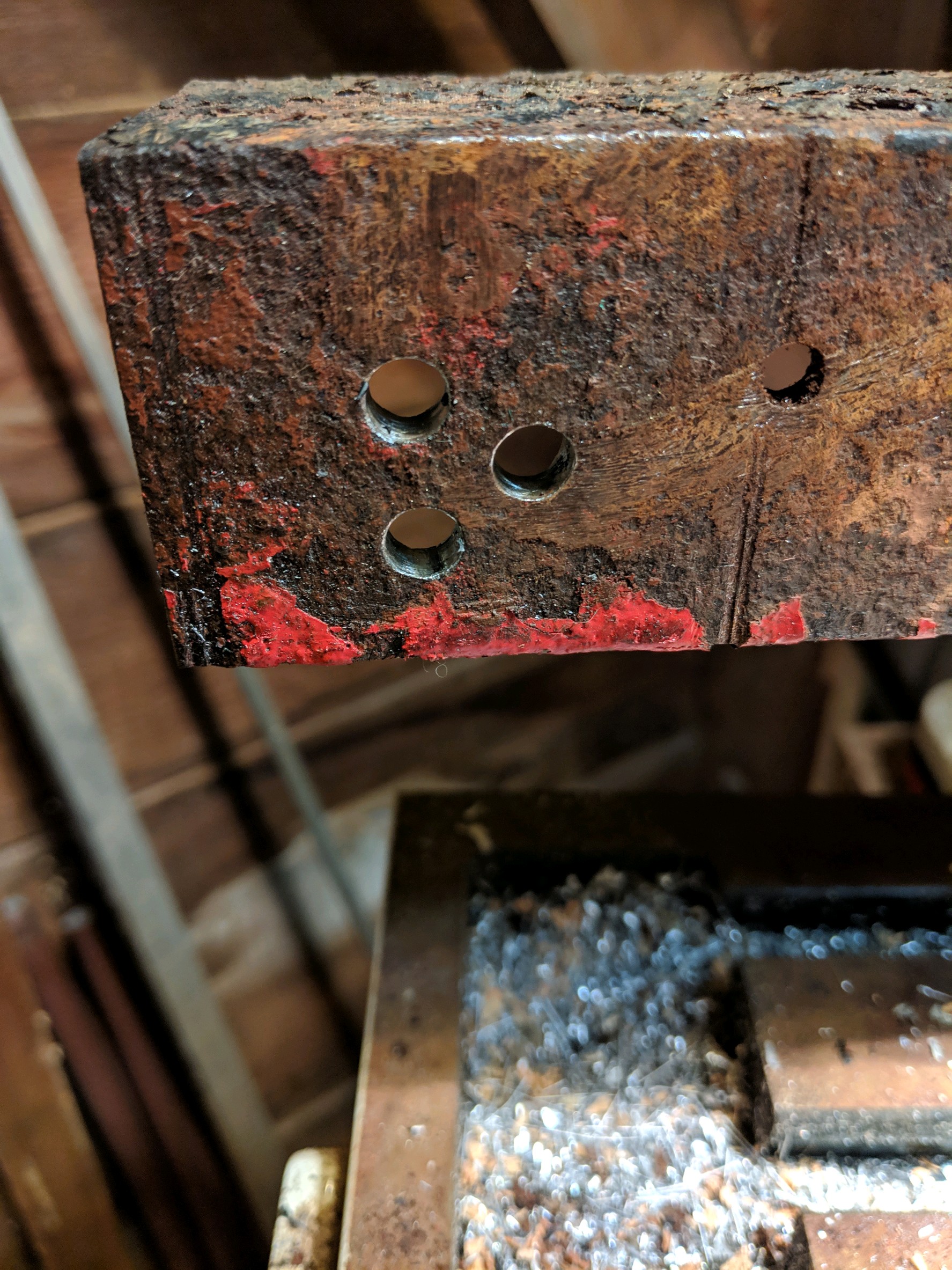

Here is my quick and dirty solution to remove the tabs from the connector on the male end of power cords.
3 holes in a piece of old angle iron
insert the plug end
Rotate the tabs out with vice grips
Produce a pile of brass and copper
The copper wire segments inside the plug usually pull out with the tab.
