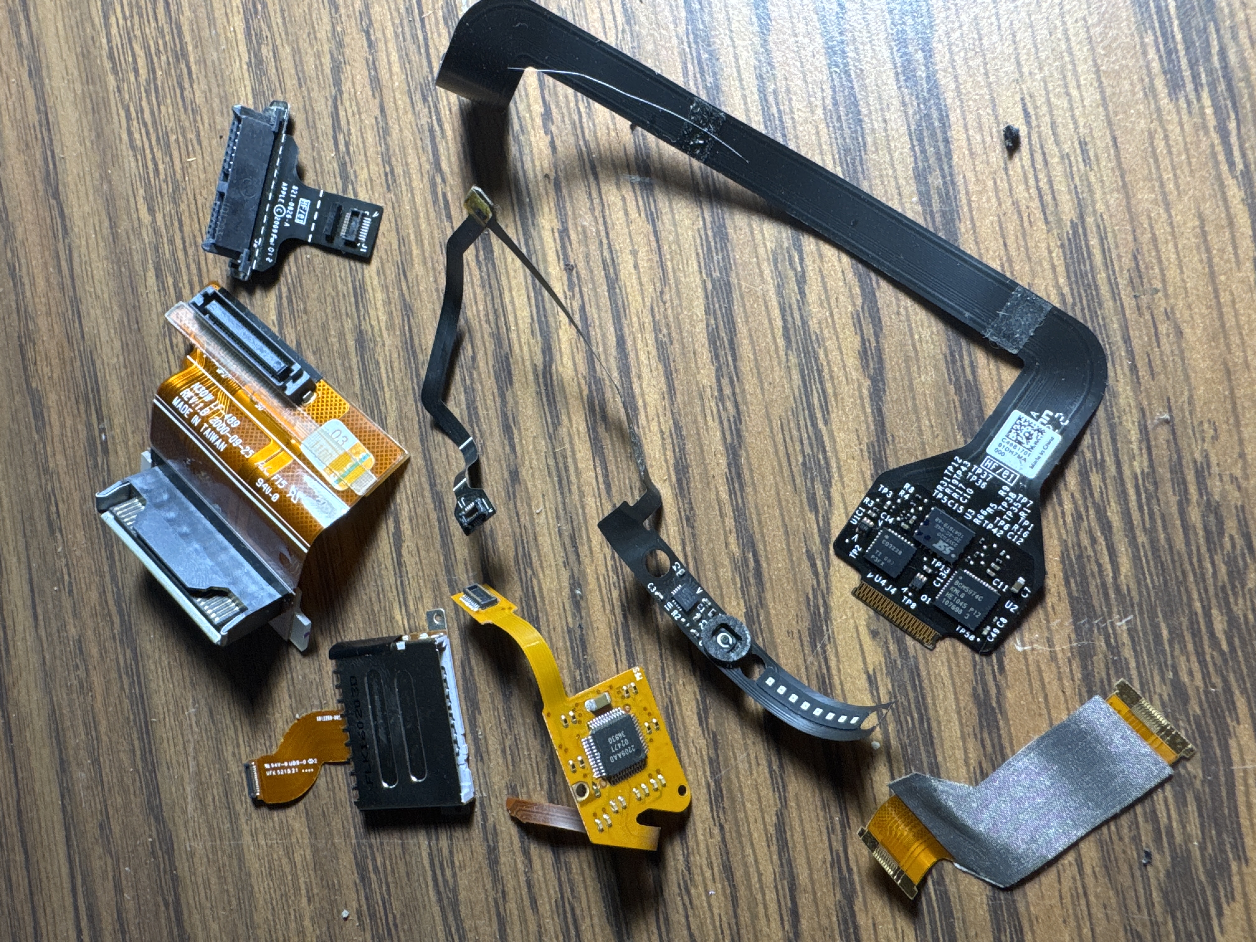

The impression I've always had is that ribbon cables and flexible pcb don't really fit in to any of the board categories. Is that 100% the case all the time or are there exceptions? If there are exceptions what do I need to look for?
Here are some different examples. Some with ICs, gold pin connectors, regular ribbon cable with flat gold connectors.
Here to learn more so I can recycle more

someone took apart a laptop or professional tablet.
The connectors are all Cable ends
The occupied plastic board sections are high peripheral
The clean bare wire goes with mixed wire
if that one Gold finger connector is rigid, it will go with Gold fingers if it is thin and flexible it goes with Cable ends
