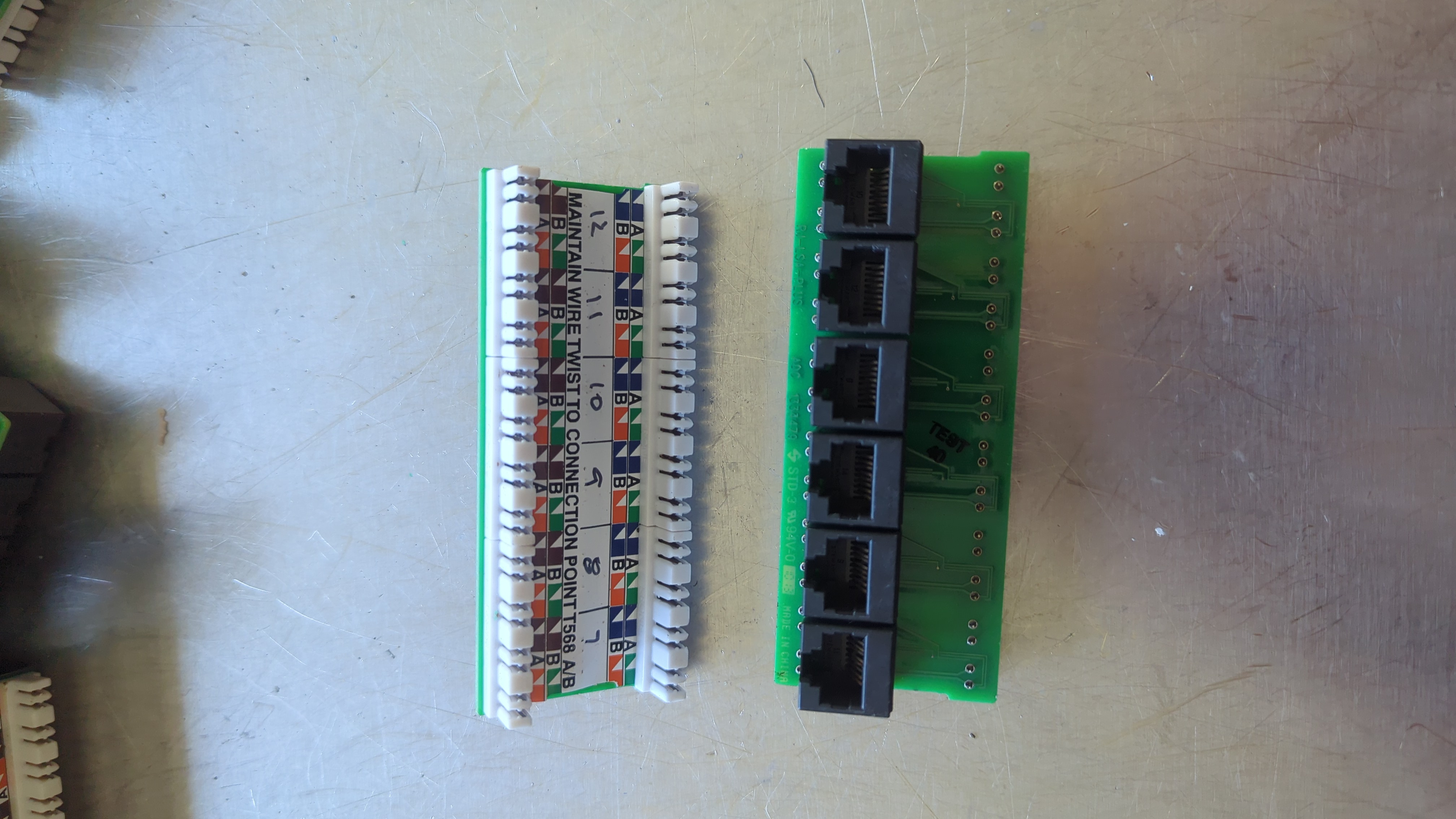

Hey everyone, I am not sure what these would be graded as. Any help is appreciated.

Don't you agree those should be posted in the What is it? Identification Forum?
Also. How about pictures of the back of the boards?
Having said that. Assuming that the back of the boards are only conductive trace.
I feel strongly your heading towards a Connector End strategy in order to get a sell to Boardsort.
Do those connecting points have gold on them?
Next. How much waste has to be removed to get into the Connector Ends category?
Even so. Have you uploaded to O.S.C.A.R. For a grade? My "off the cuff" guess. NO SCRAP VALUE. If my guess is right. Going Connector End might very well be your only option to get a sell. So review the escrap Connector Ends video.

White plastic I'm leaning low grade. It's likely brass connectors and lots of plastic.
Black plastic, I agree connector ends seems best.

The punch is midgrade if contacts are yellow. Low grade is silver or grey
The ethernet ports are cable end

The picture is the front and back of the same patch panel.

Midgrade then
