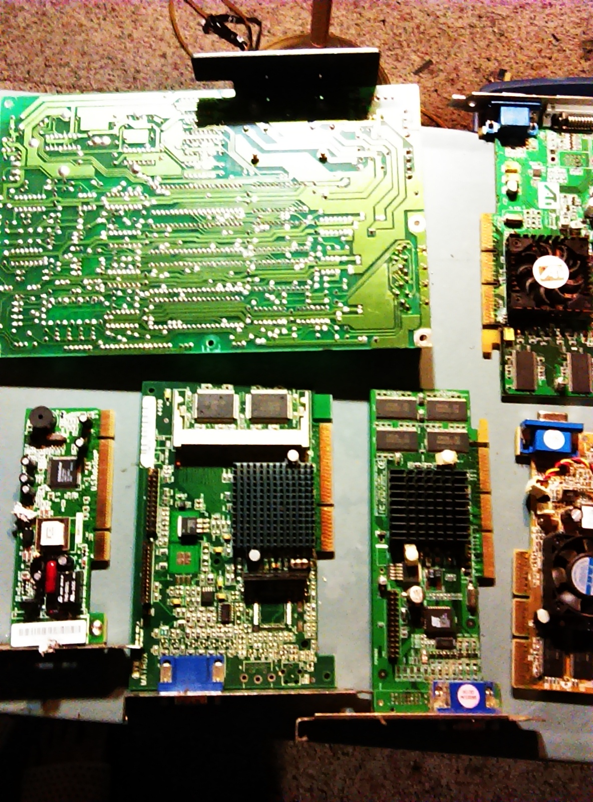

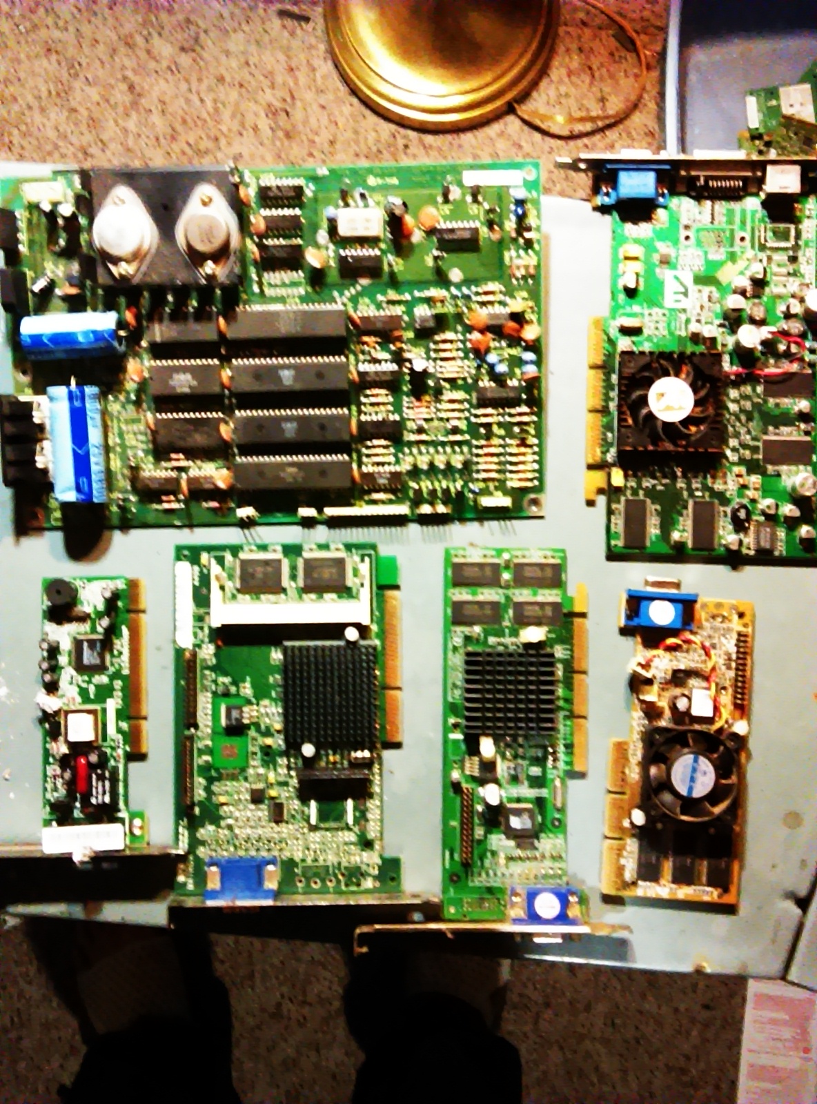

Anybody mind telling me if it's best to remove heats spreader/thermal dissipaters & fans from gold finger cards or peripheral card/boards with metal bracket? They should be taken off if possible so maybe the piece goes into a better grade correct?
What I do is take a comp apart (if it's obsolete or basic) and separate the cards & peripherals but I've stopped taking heat sinks and fans off of small board/card and I've also stopped taking cpu's out of the sockets.
I still take the large fans and heat sinks off the motherboards though. I can drive to drop off if that's matters as far as anybody kicking me some more knowledge. I feel like I'm doing some things best but there's always more to learn.
I added pics of the types of boards/cards I'm asking about. Is it worth removing the small transformers/fans/heat sinks?

I just read some about leaving tiny chip sized heat sinks on is ok. These coolers are small but bigger than chips. I bet I need to take any cooler, TRANSFORMER & FAN off bigger than a chip off to get the best grade. I don't want to lose weight where I don't need to though.

Most of those heat sinks need to come off, anything larger area than the chip it's attached to (over sized). All fans always need to be removed regardless of size.
99.9% of the time you're best removing the cpu.
The only 3 cases for leaving a cpu on the board are
1)Telco boards with lga (pinless) Ic chips.
2) ancient motherboards pre early 80s. If the cpu/ic chips are silver pinned and don't have gold caps. (Almost) All pre 486 motherboards are large socket class even though the socket is a smaller square or a rectangle. Many of those boards are telco though.
3) you can't get the cpu out. Be it frozen pins, or soldered spring clips. A broken cpu is worth a fraction of the whole one. If force is required substantially just leave it alone.

Ok thanks that's exactly what I needed to know! I'll post the boards there's only 12 right now though.
