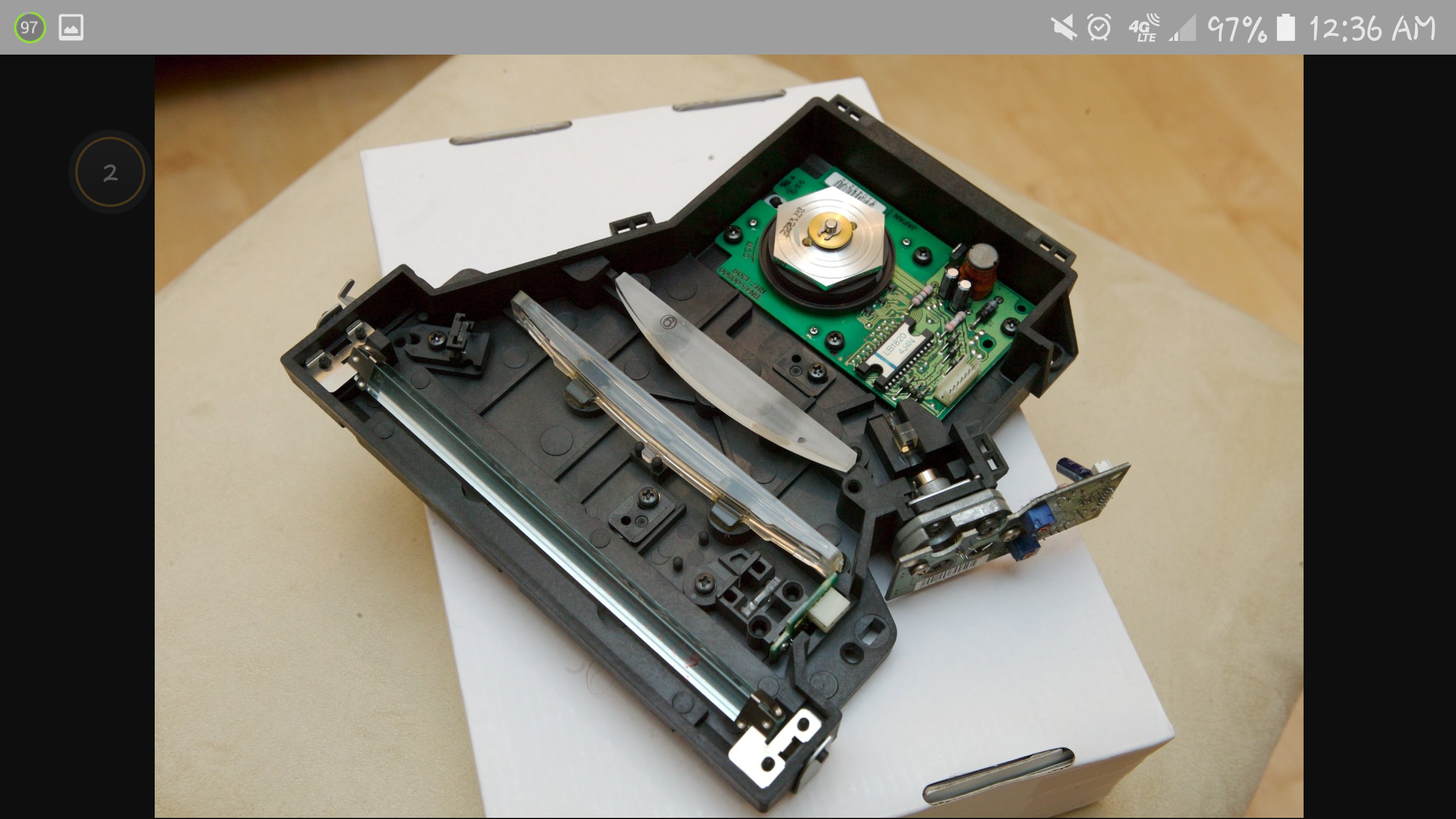

Inside large office fax/copier machines (where the glass is) looks like metal, but not magnetic, I thought it was some kind of non magnetic Metal. Any thoughts or suggestions
PostPosted: Wed Sep 07, 2016 12:02 pm
Posts: 10618
Depends; can you break / snap it? Metallic plastic will look white inside. Chalky or cream coloured
If you can't snap it try to carefully gouge it with a screwdriver or knife to see if it scratch through the layer.
If still not sure post a photo and I'll see if I can tell.
By sight.

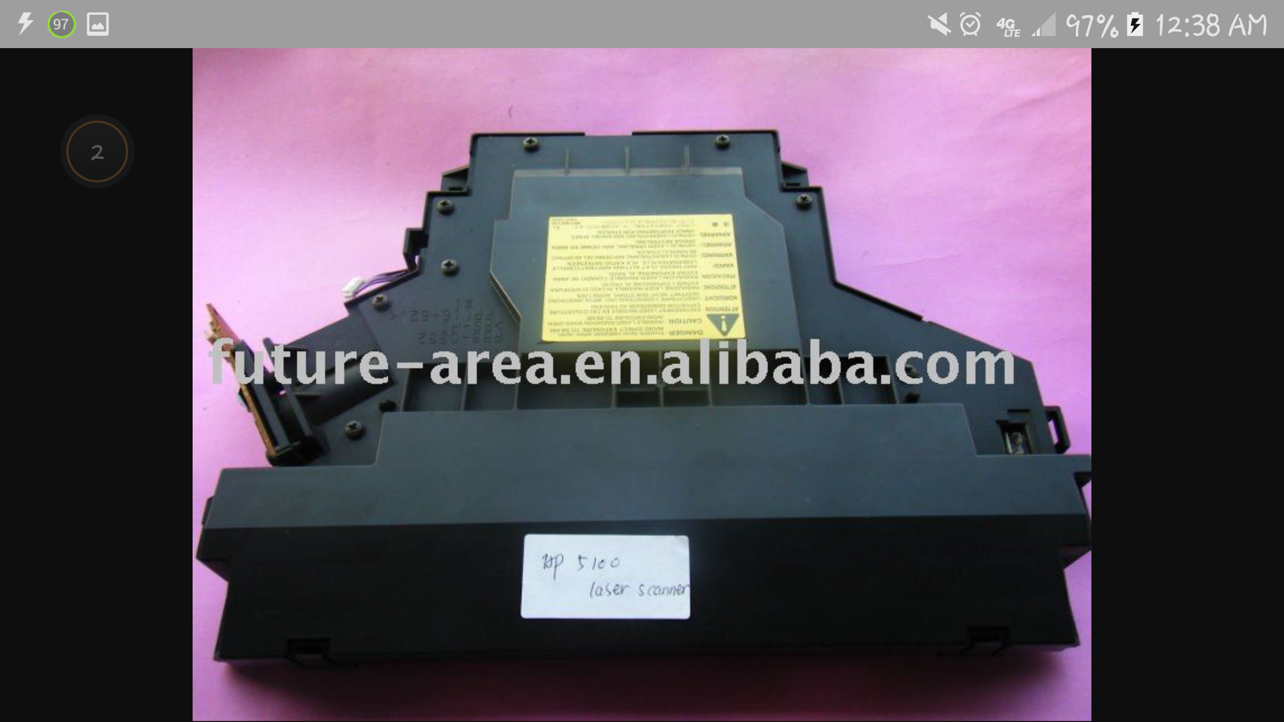

Maybe these pics can help,
Laser diode array assembly made from a ridged monolithic substrate, is this what I'm talking about or is this the laser assembly inside the hard drives? Like too know that also.
