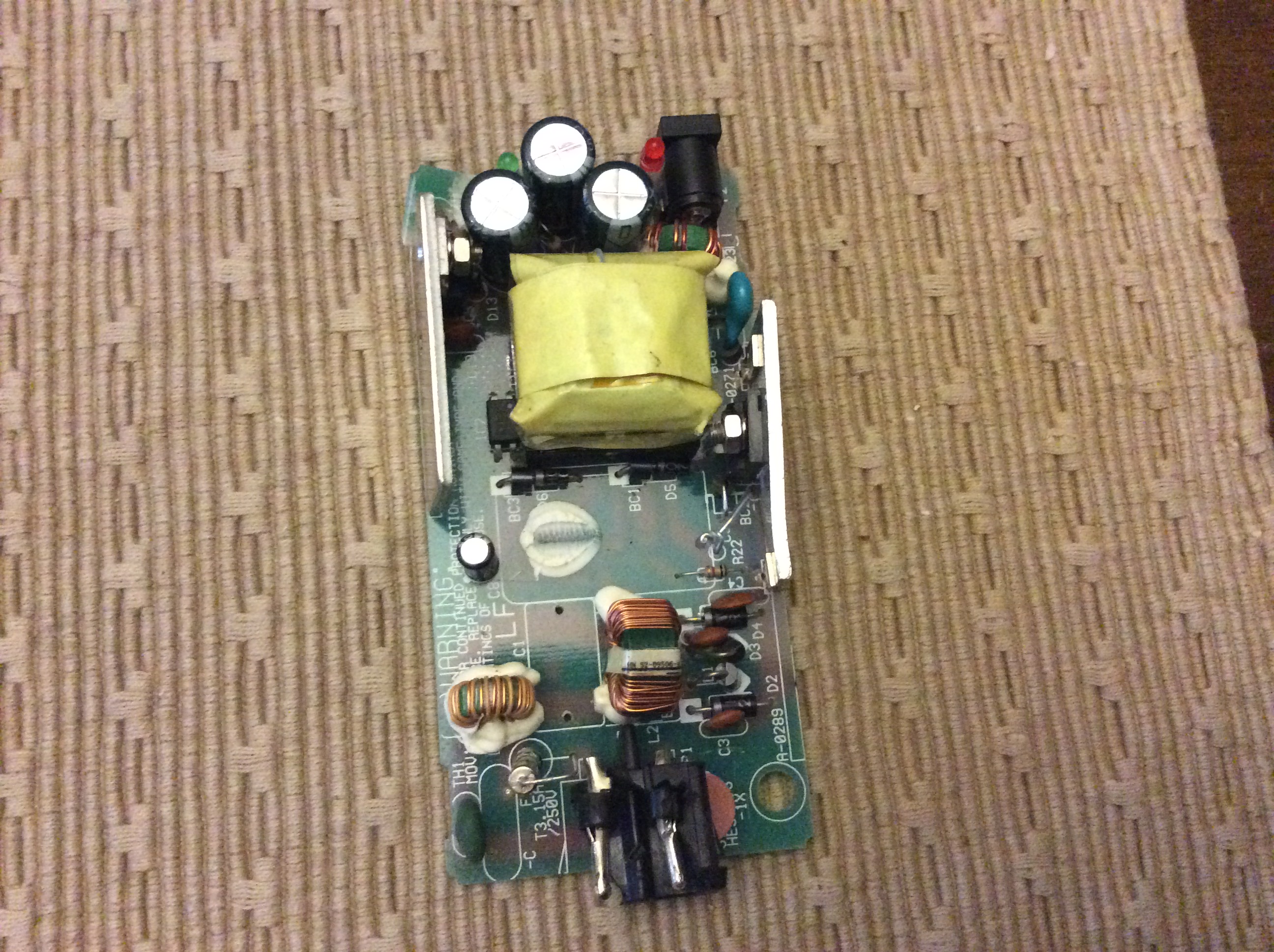

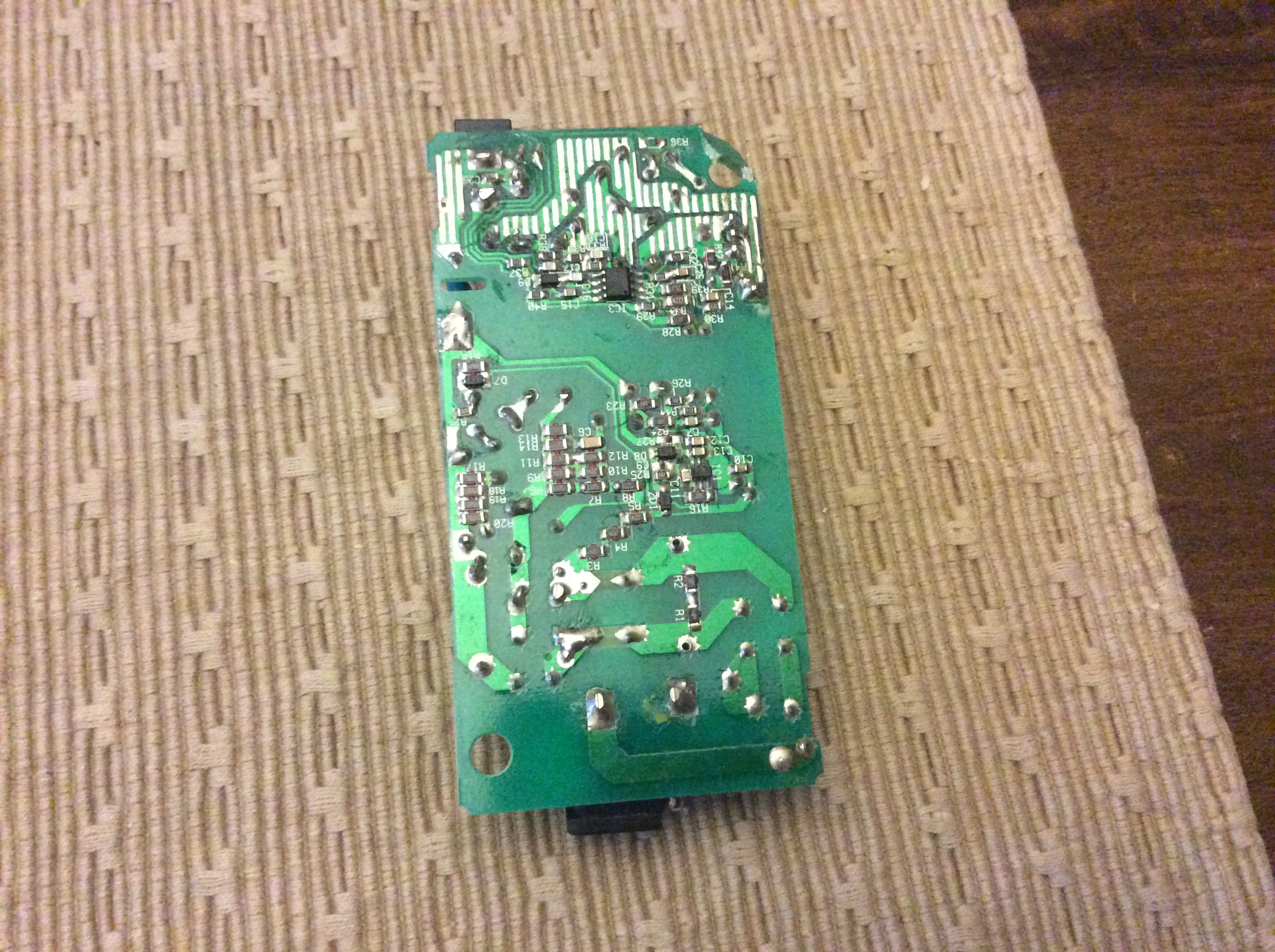

This is the front and back of a board that came out of a wall adapter. Would this be a mid grade board? What all needs removed and scrapped separately?

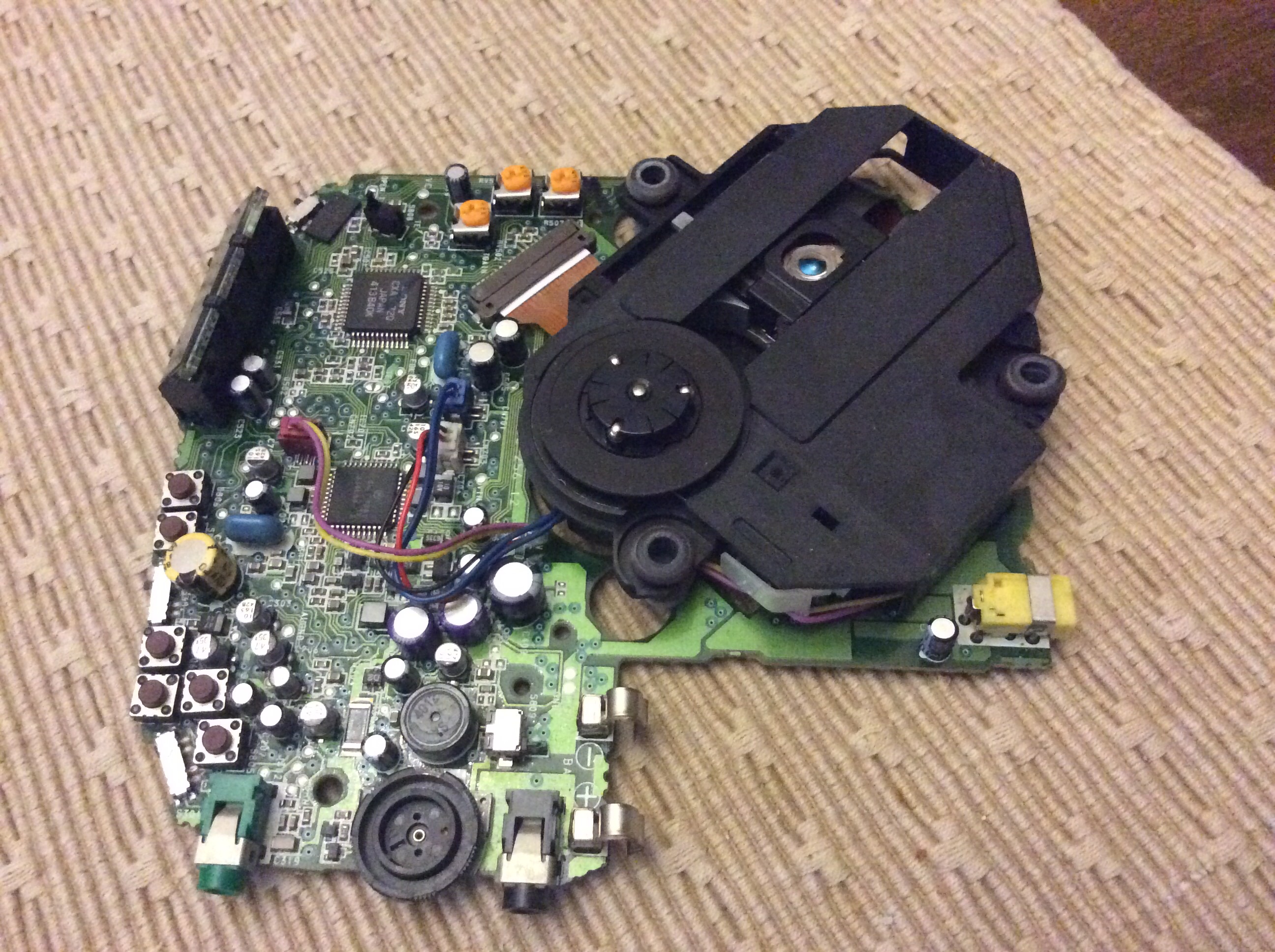

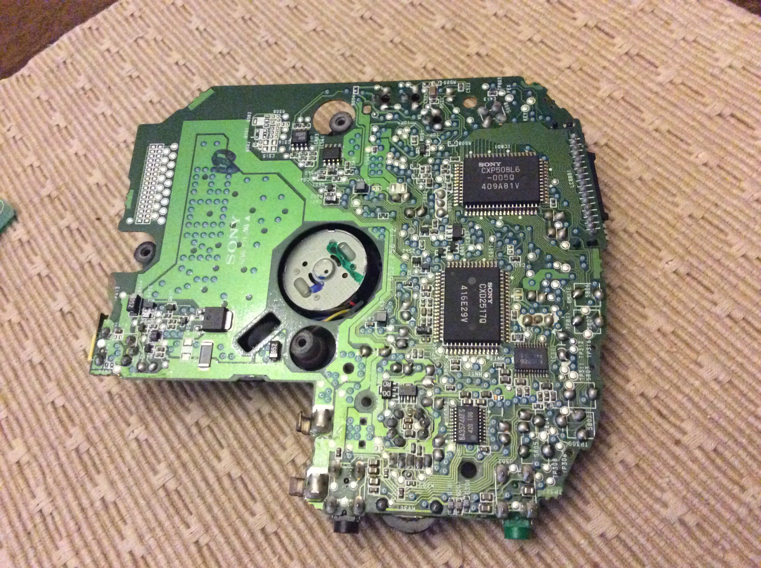

This one came from an old portable CD player. Again, mid grade? What else should be removed?

The first one is midgrade. Not much you can do for value there.
As is the second one is midgrade BUT
You can pull the drive unit motor and laser assembly and the board will be peripheral it's held down on the board by small screws, Philips or tri-bit. Usually size zero or 00.
If you want to take about 10 minutes or so on your first try you can go further with the removed assembly.
It's not much but if you're board there's a breakdown in my what's inside it threads. Look at the index to find it easier.
There's a gold laser diode in there. Stuck in the aluminium or magnesium base unit. If you can pull it out you'll get 50c-$1 for it. If not I get around 75c for the entire base. About one in five can be pulled out easily in my history.
If it was added after the fact a good tug with lock jaws can rip the glue. If it was set in a wet mold you'll never get it out without cutting.
There's a tiny DLP (CCD) that goes in peripheral. A fair bit of extremely light wiring. Some brass, bronze, or copper rings. ...
