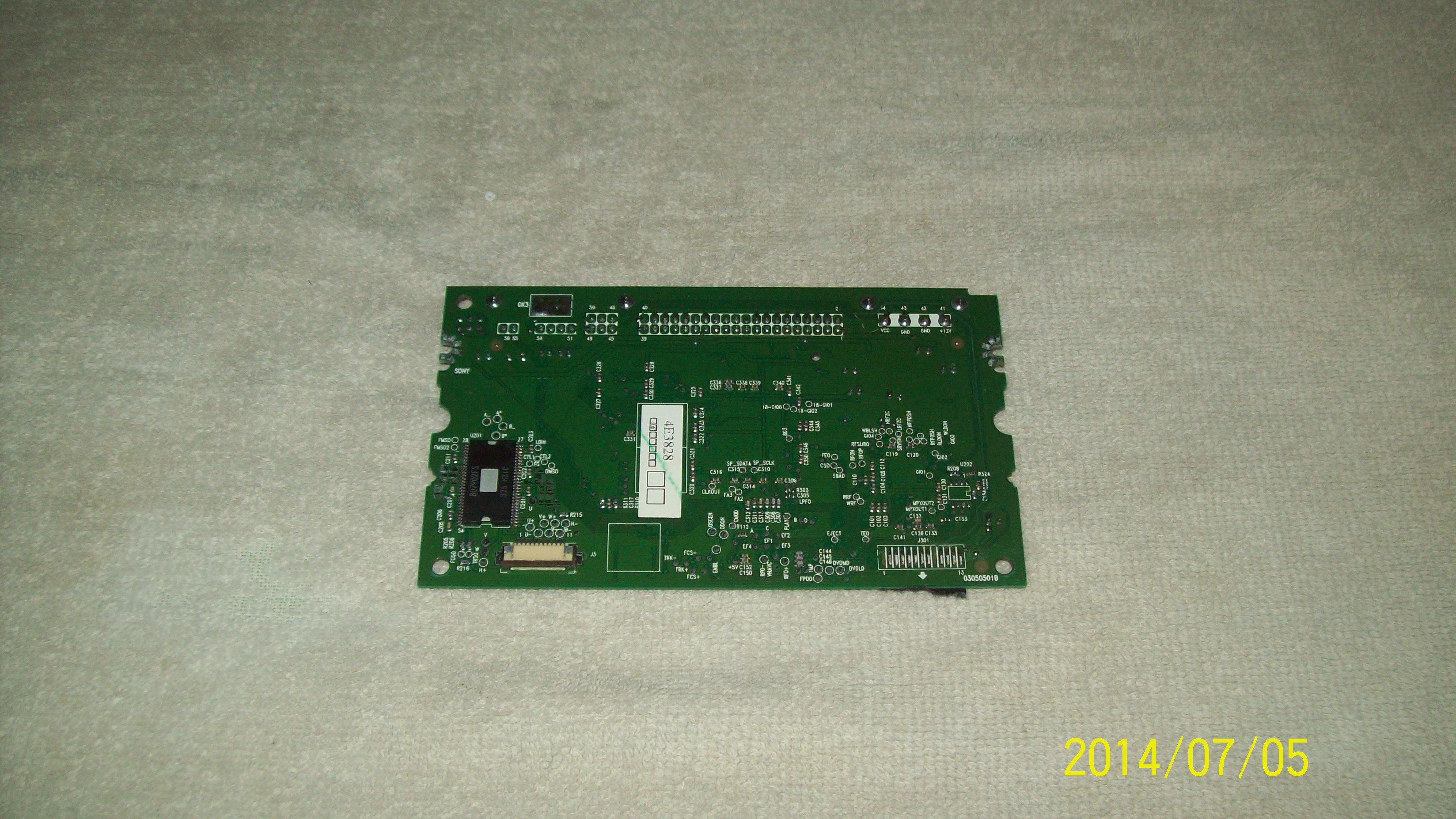

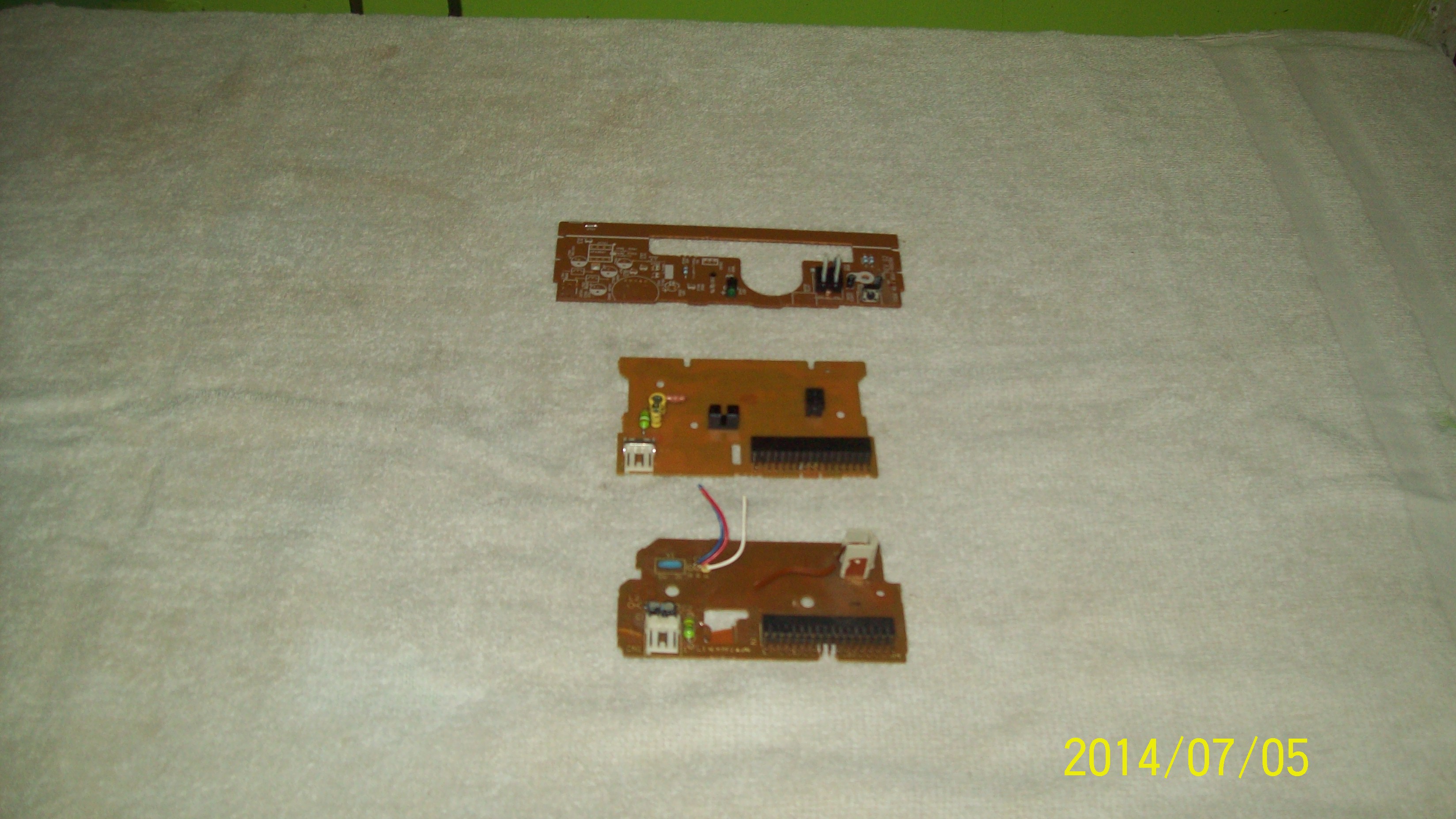

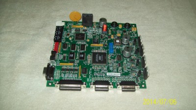

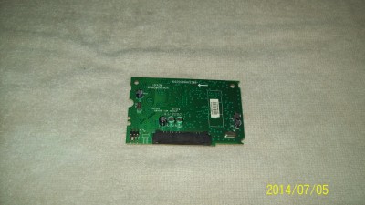

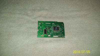

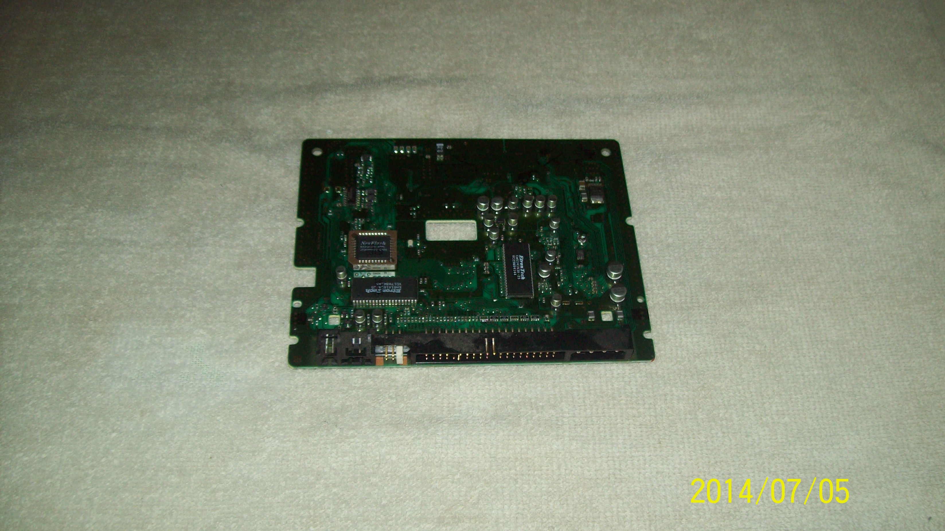

Still new to this, need to know what box to put these board's in. Pic heavy. Thank's

261/262 appears to be a midgrade board.
259/260 are low grade. Remember if the board is brown on one or both sides and contains little to no IC population, it's going to be low grade.
249/250/251 appears to be a CD/DVD board.
247/248 appears to be peripheral grade.
244/245 I would try to separate the steel from it. If you can't, I would toss it into the shred metal pile.

1# Peripheral grade
2# Low Grade maybe Mid Grade because of the gold pins.
3# CD/DVD board
4# CD/DVD board
5# Steel
