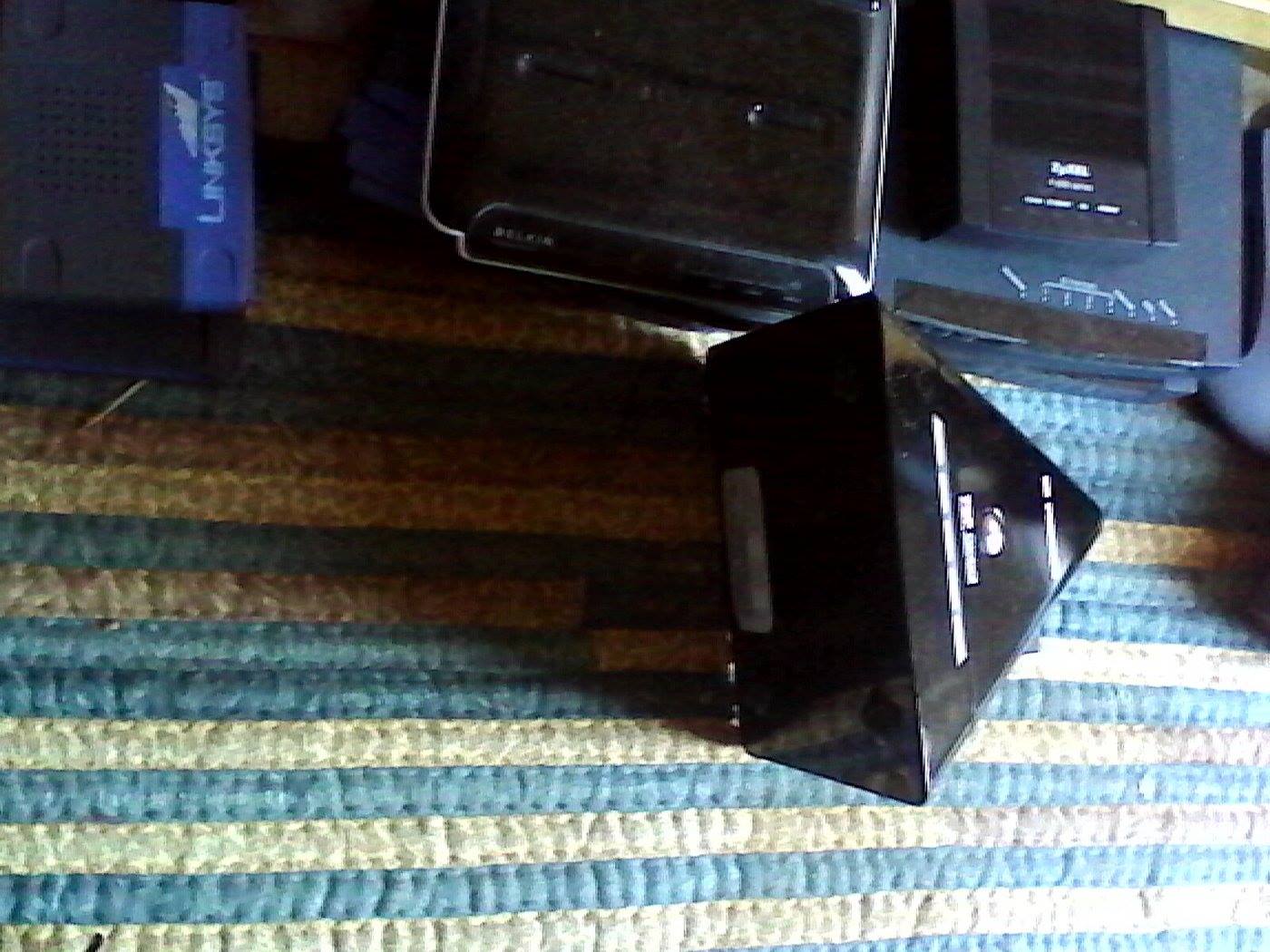

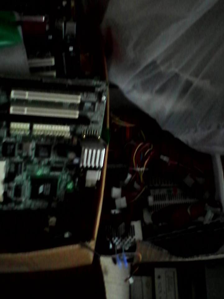

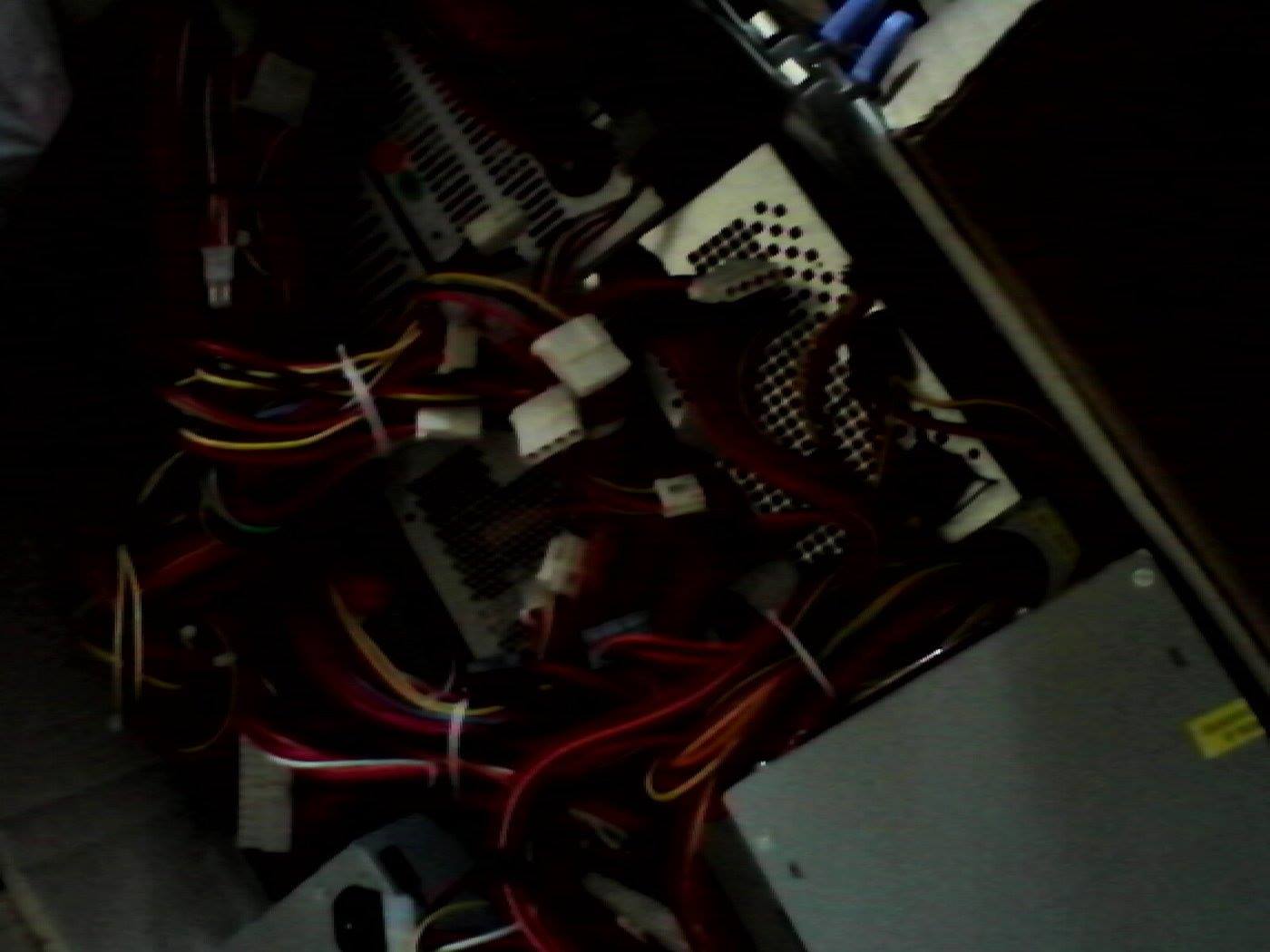

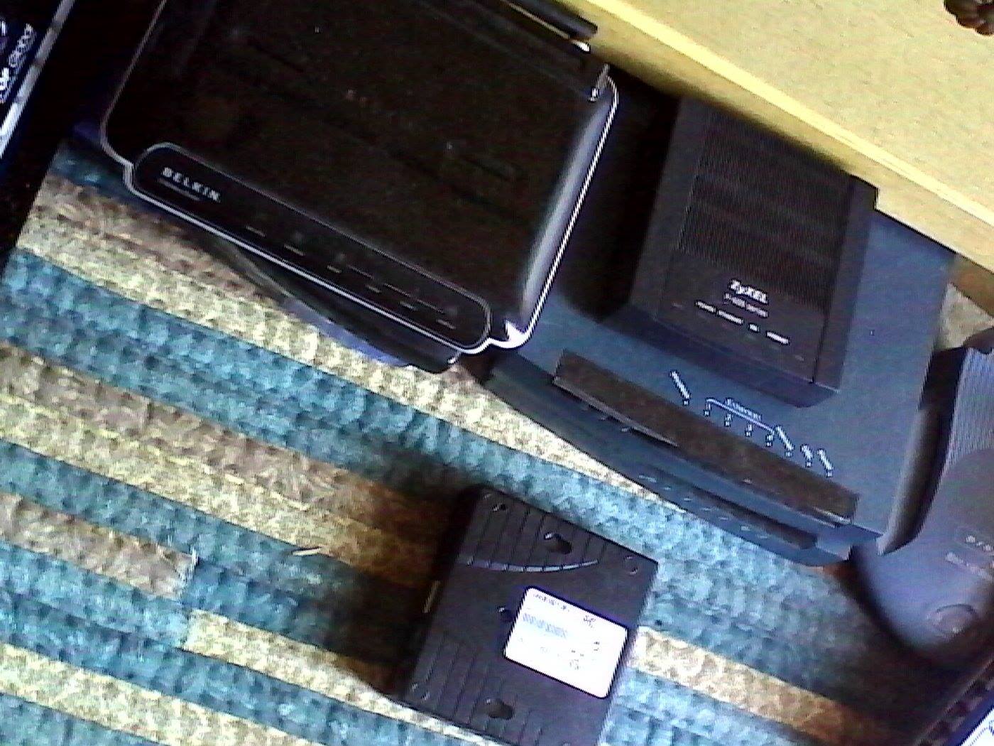

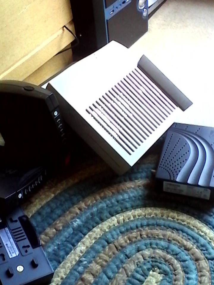

You guys are awesome making a forum on the site... I have sent some already to Chris... But i have so much to go through and get done.. Ok so pretty much these pics are Power Supplies, Modems, Routers, CD Roms and Floppy, as well mother boards i just want to get some help at what to take off and out and able to send out... Cause where im at the scrap yards suck donkey **** lol... Thanks boys.

Many of the consumer grade modems and routers you have contain peripheral boards. Open the cases of those devices and remove the boards inside. Any brown boards you have are low grade. Depending on your local scrap markets, remove any transformers you find on low-grade boards and sell them as CBMs, or separate for #2 copper and heavy melt steel.
Power supplies can be sold as-is, or you can do what I do is open them up and take the following items out:
* transformers (sell as CBMs or separate copper and ferrous metal)
* heatsinks (sell as aluminum)
* fans (sell as a CBM)
* magnet coils (same as trasnformers, but may be easier to separate copper from iron using hand tools)
You are left with the low-grade board, wire, and metal casing. Trim the wire and sell with your insulated wire. Sell the low-grade to your local buyer or to Boardsort, and the metal casing goes with your heavy melt.

With your motherboards, clean off any heatsinks you have over the CPU chip and other chips on the board. Test the metal of the heatsinks to see if they are copper or aluminum and place in your appropriate metal bin. Next, look at the CPU slot or socket to determine if the board is small socket or large socket. Large socket boards have CPU sockets or slots that are 1.75" or larger. Anything else is small socket, unless you have a 386/486 processor board.
