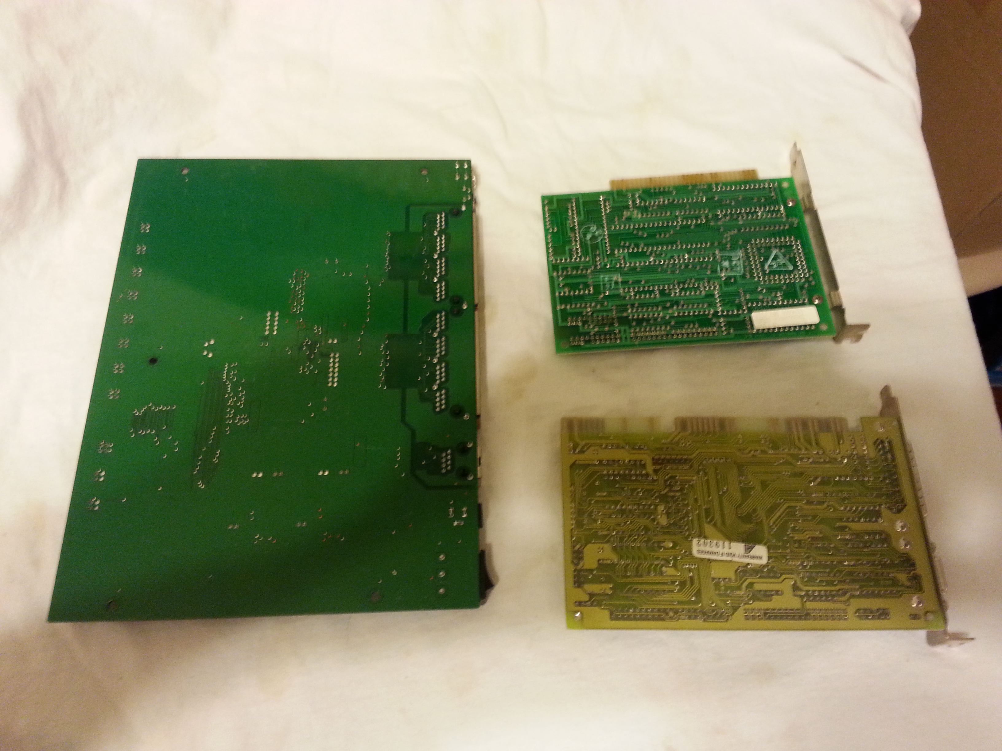

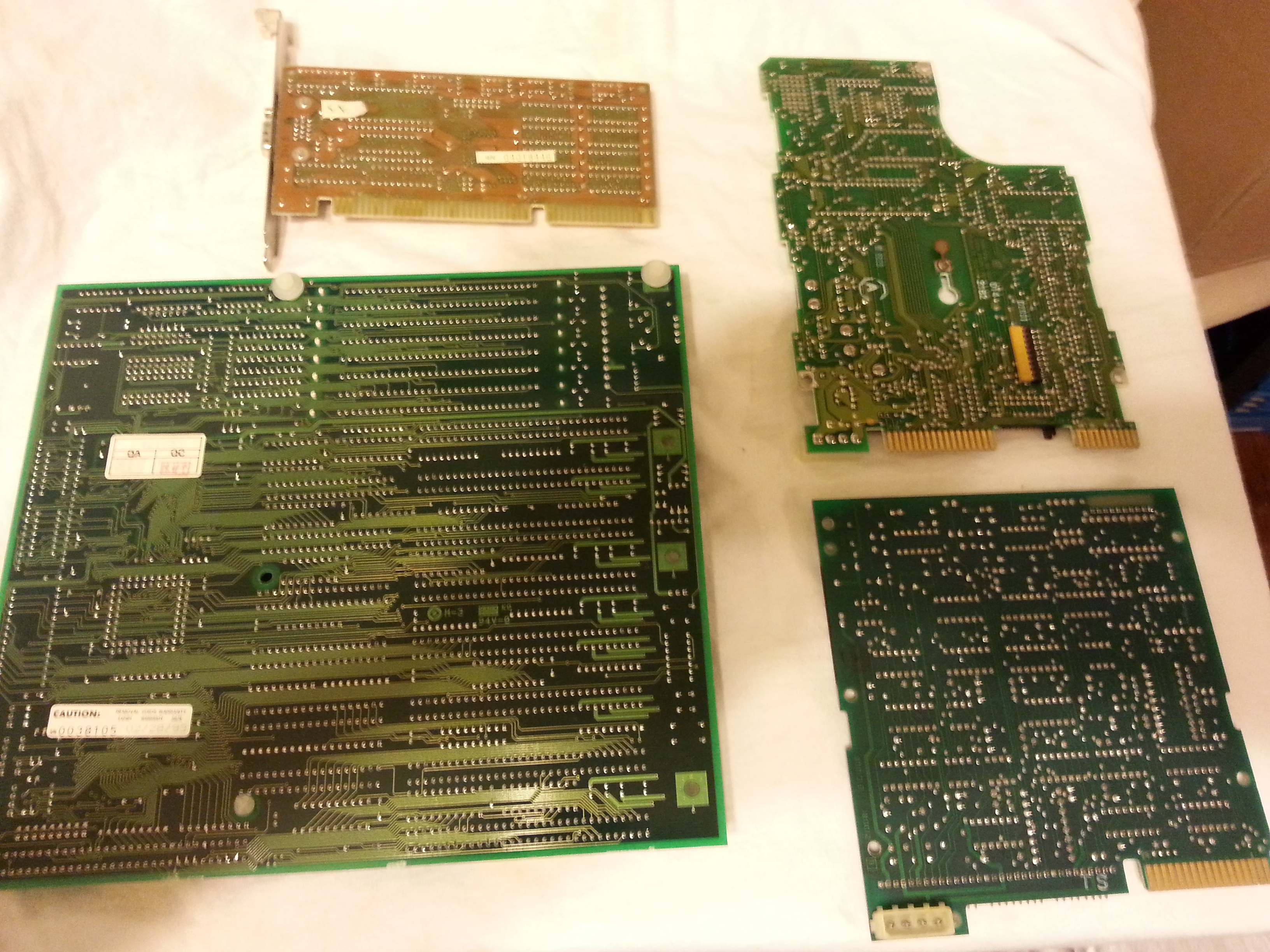

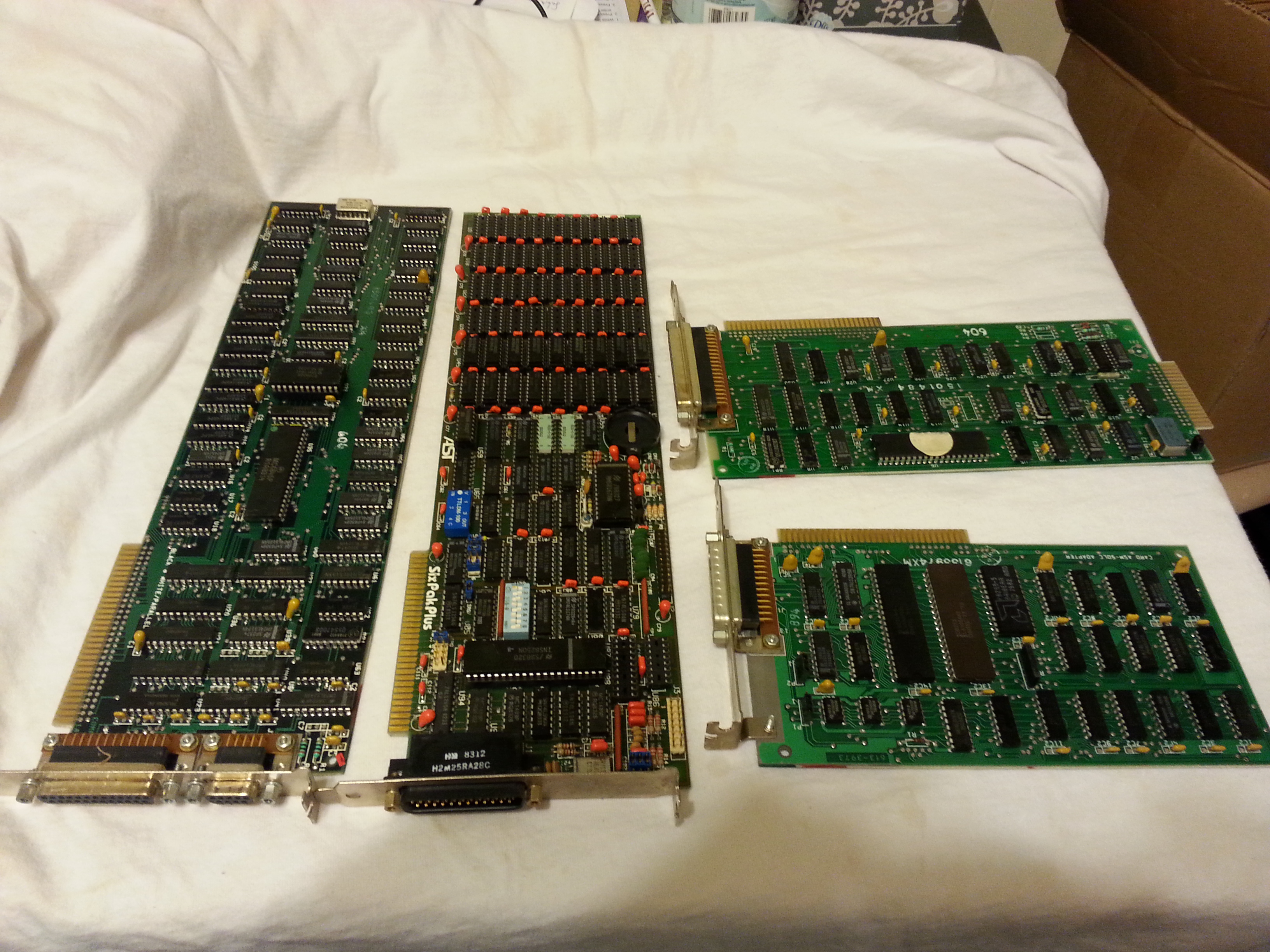

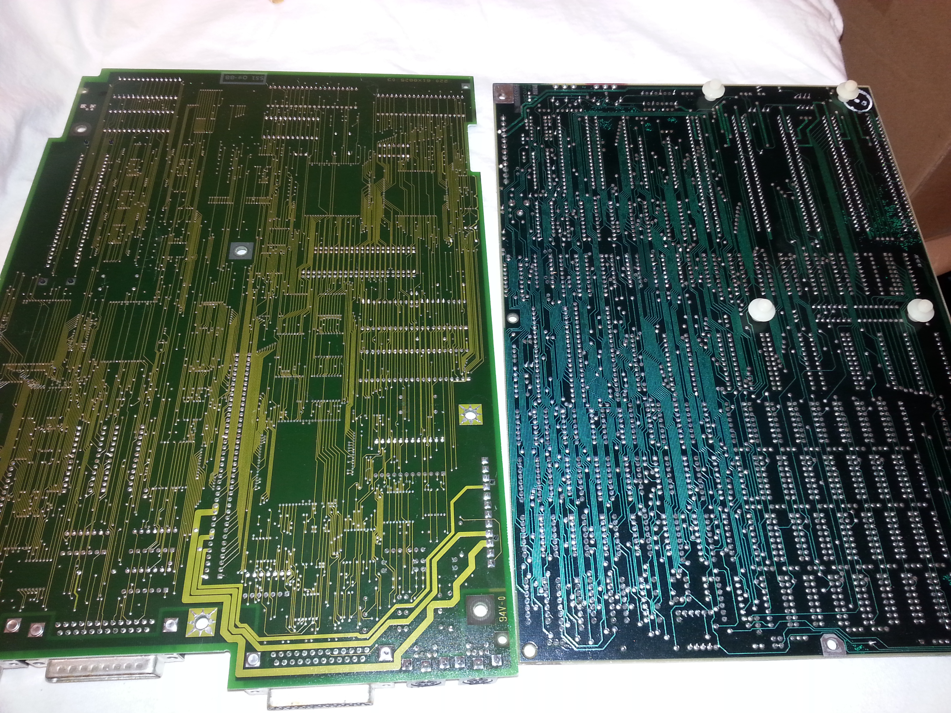

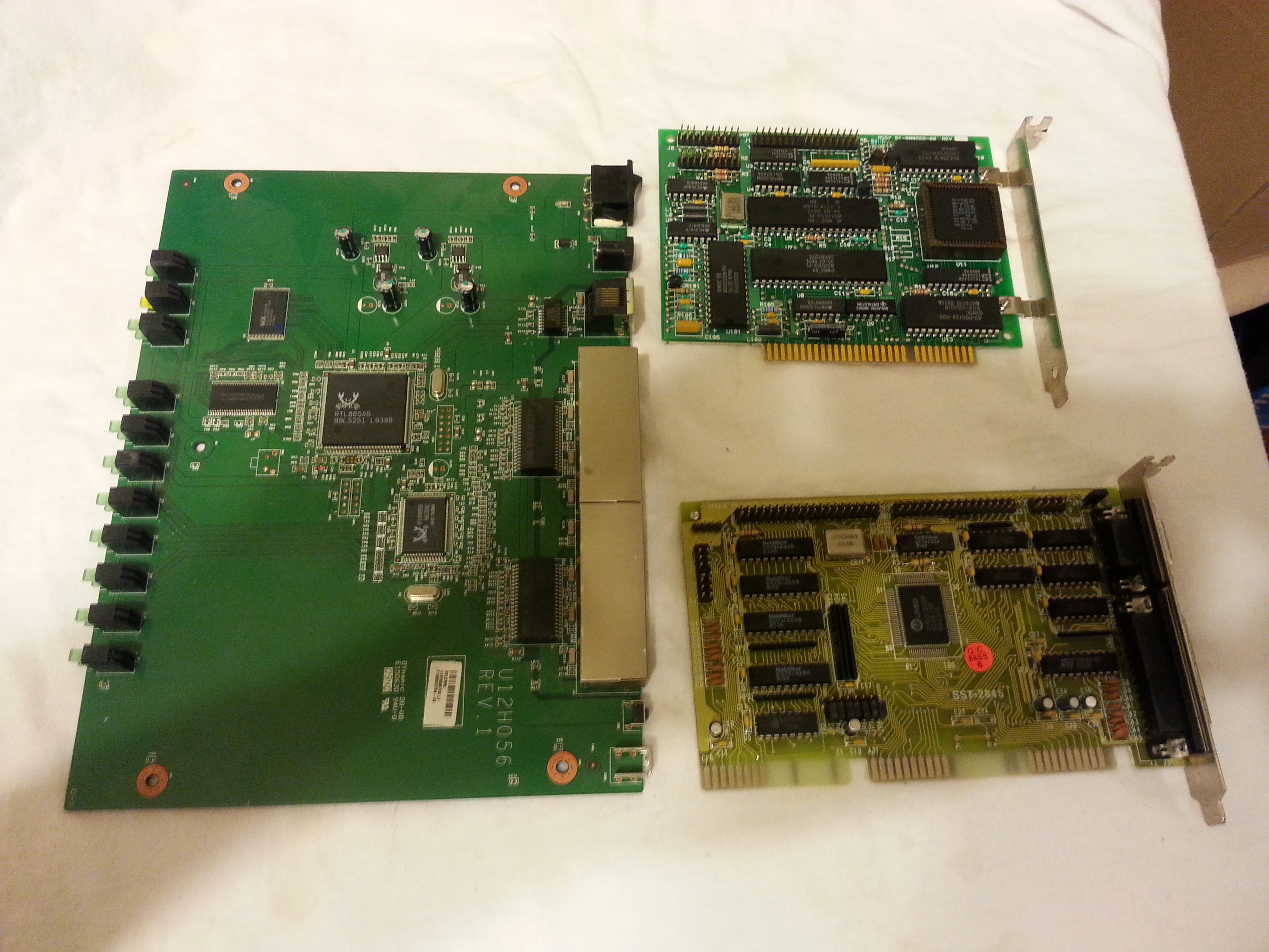

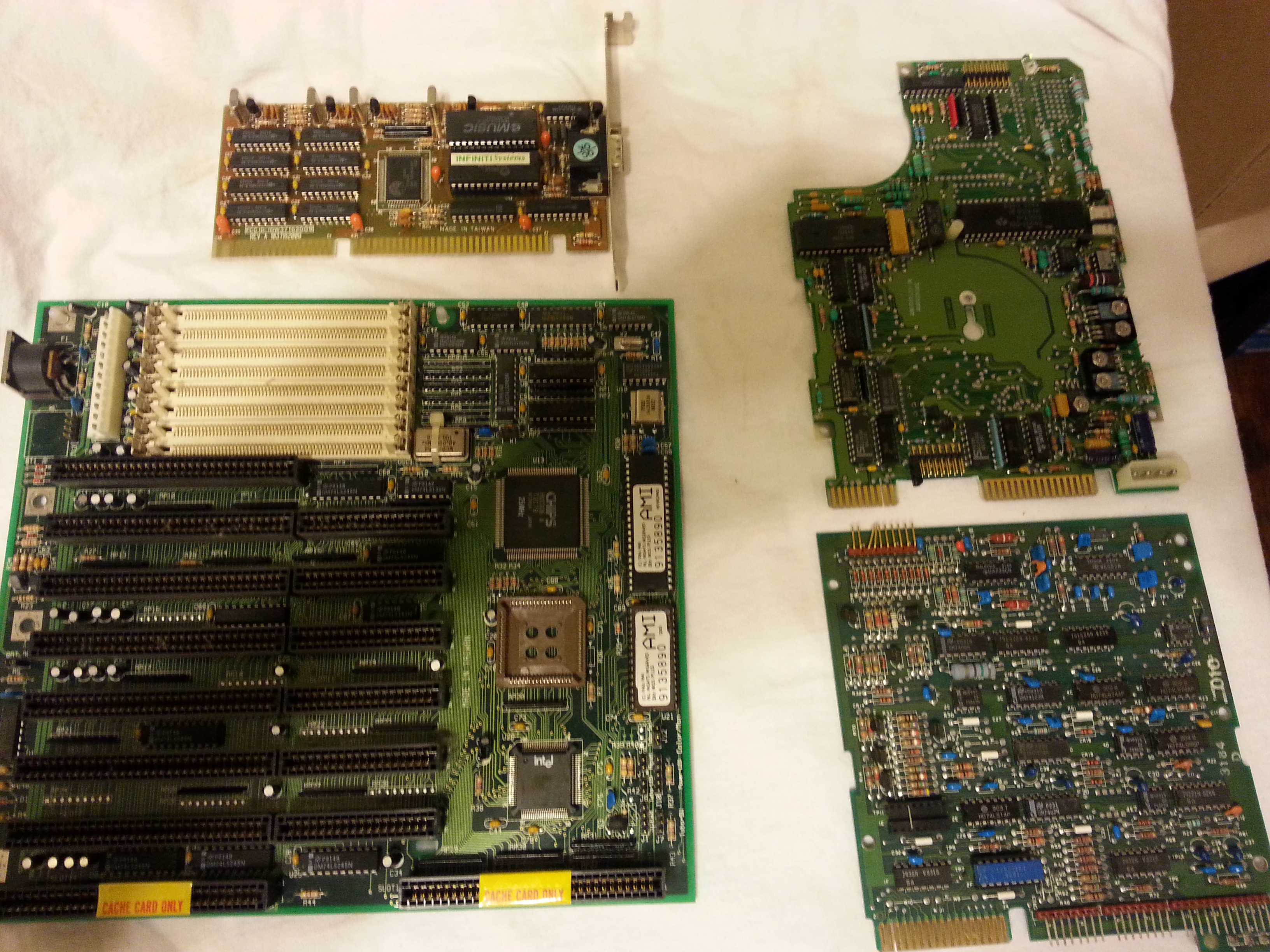

Need to verify these boards. Im pretty sure I know but i wanna make sure.

--In the first pic: the two boards to the left are telecom. You could even remove the gold fingers to sell separately as Clean Gold Fingers. The other two cards for sure are gold finger cards and may pass for telecom with finger attached.
--Third pic: top left board is gold finger card. Bottom left board I don't what motherboard category is. The two boards on the right if they came out of a hard drive then they are Logic Boards if they didn't then Gold Finger Cards
--Fifth pic. Board to the left is Peripheral. The ones to the right are Gold Finger Cards.
--Seventh pic. They are both Telecom but the one on right has 9 Gold Cap Foreign Chips that you can sell separately. The one on the left has one large Gold Cap Foreign Chip. I don't think removing those chips will devalue the boards. Those chips will bring more than the actual boards.
--Last set of pictures: from left to right top line..Green/Brown Fiber with Metal, Green/Brown Fiber with metal and Aluminum Top AMD.
from left to right bottom line..Green/Brown Fiber "NO" Metal, Black Fiber, and 386/486 chip
