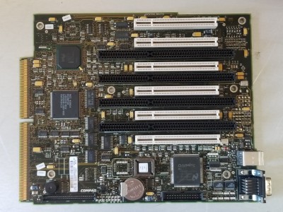

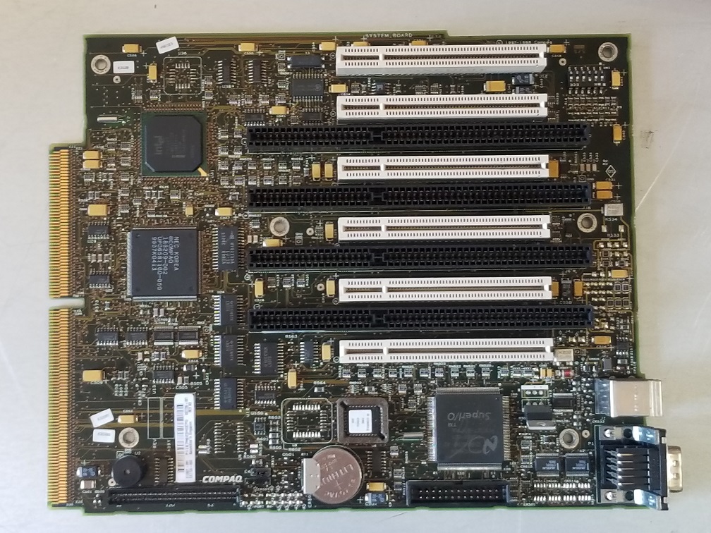

Let me know what you think. Also, should I trim the fingers?
PostPosted: Wed Mar 31, 2021 10:06 am
Here's my guess:
1) Low Grade Telecom as is. High Grade Peripheral without fingers.
2) Backplane with or without the fingers.
PostPosted: Wed Mar 31, 2021 10:16 pm
Posts: 2721

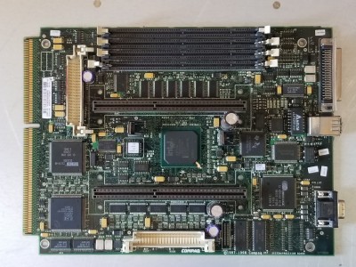

That top one looks like it had a two slot processors. Should it go higher than low telco?
~~edit~~ It's from a proliant 1600 server. So I'm thinking large multi-socket server board~~
Bottom, make sure you remove the battery.
PostPosted: Wed Mar 31, 2021 10:32 pm
After looking at it again, I can see your point. So then I would say Large Multi Socket Server Motherboard. I'm not sure if trimming the fingers would harm the grade.
PostPosted: Thu Apr 01, 2021 9:33 am
UPDATE:
Chris says:
Boardsort wrote:
I would buy both as Multi Large with the battery removed.
Trimming the fingers would take them both to backplane.
