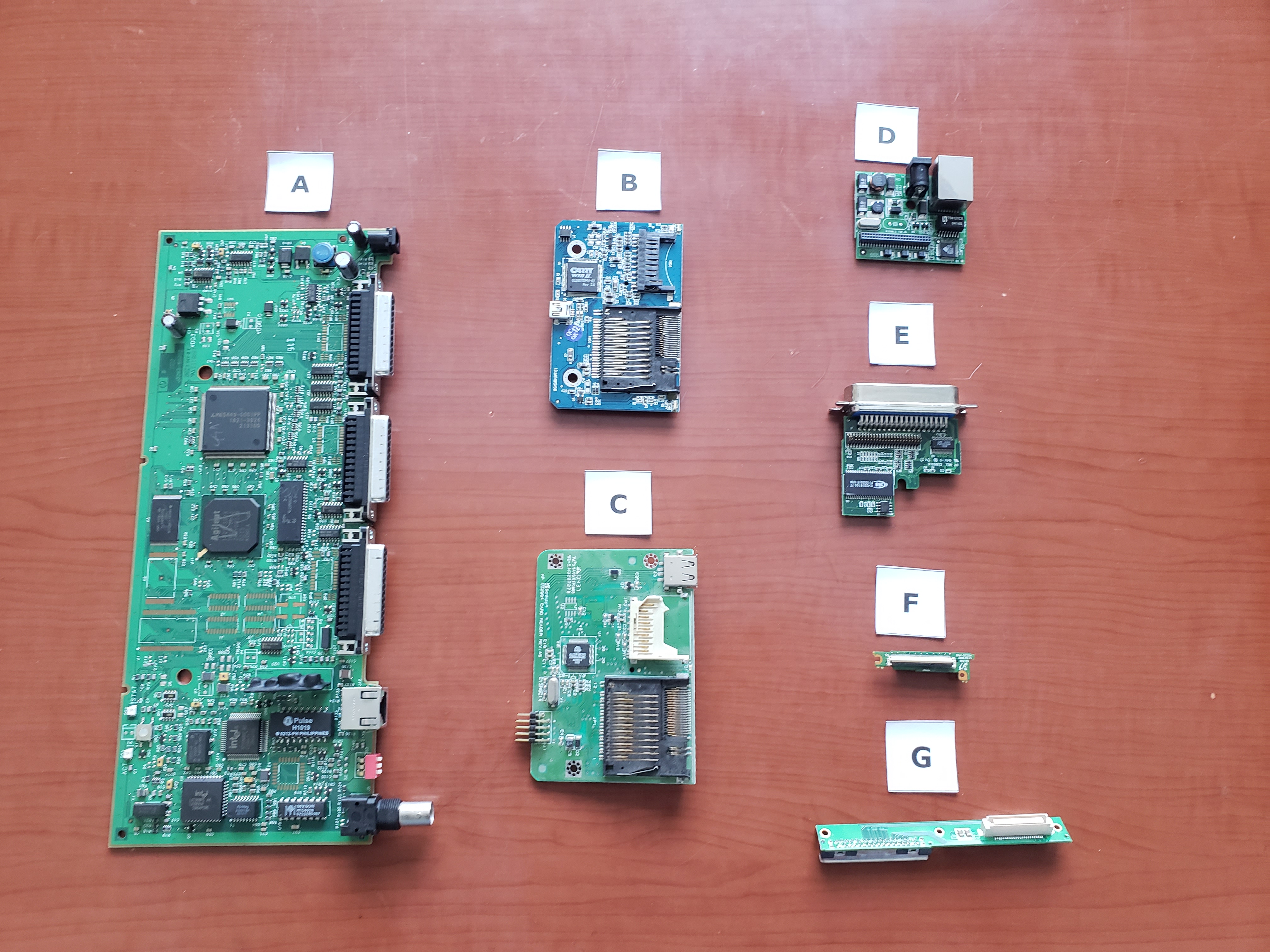

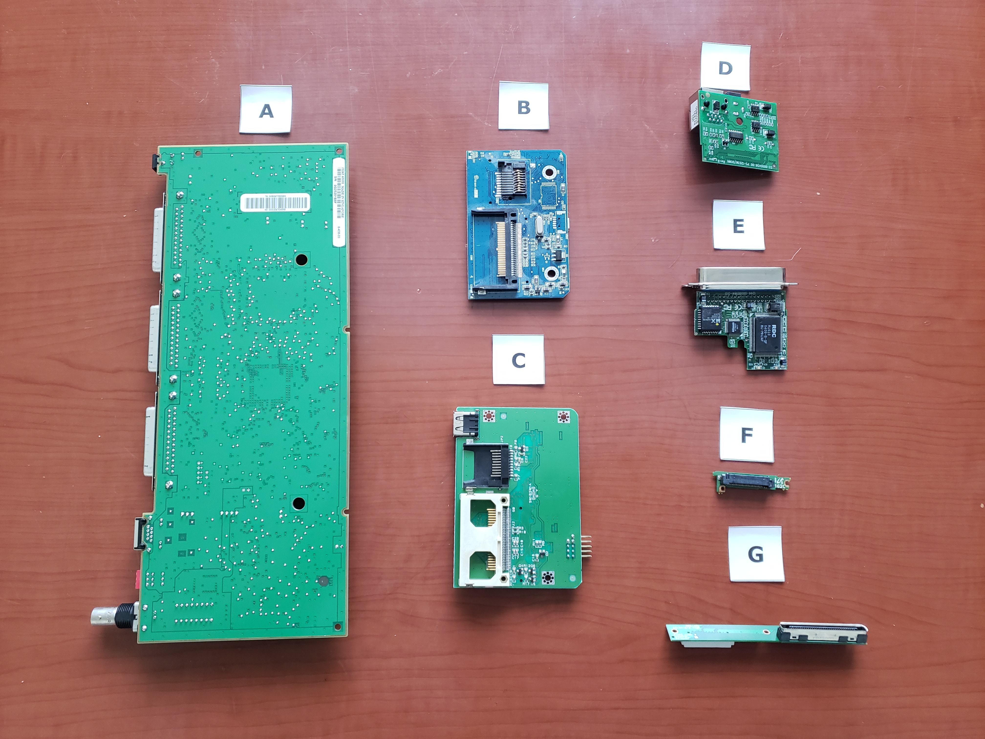

Looking to get clarification on how to classify these prior to shipment.
Recent shipment had similar items to B and C that went as High Peripheral. Also G recently was sent as Connector end. E should be Optical drive I believe as that is where it came from.
Thank you in advance!

A) High Grade Peripheral
B) High Grade Peripheral
C) High Grade Peripheral
D) Low Grade Peripheral
E) I'll check with Chris on this one.
F) Connector End if pins are gold.
G) Connector End

Correction to my post, F should be Optical Drive, not E.
C.
That board doesn't have any chips on it that are needed for CD/DVD board grade, ccussins assessment is correct.

Fair enough, F is sorted. E remains. I expect to be shipping out 2 boxes today and will sort that with the next round.

E is High Grade Peripheral.
