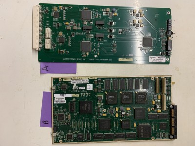

11a - Perif Hi/lo?
11b - Telco Hi?

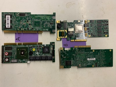

10a - Telco Hi/lo?
10b - Perif Hi/lo?
9a - f&b RAID Card was either Telco or Green Fiber CPU, can't recall
9b - f&b RAID Card was either Telco or Green Fiber CPU, can't recall

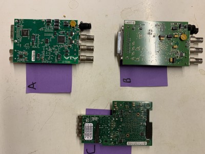

8a - Perif high/lo?
8b - Perif high/lo?
8c - Perif high/lo?

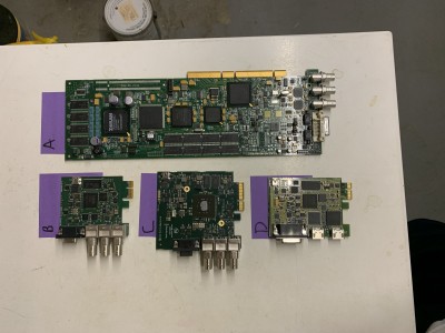

7a - f&b Telco low?
7b - Perif high/lo?
7c - Used to be Clip fingers, Perif, now Perif high/lo??
7d - f&b Intel Compute stick - Telco High? Have it's own class yet?

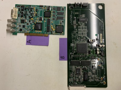

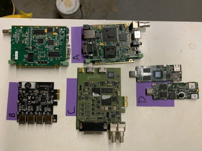

6a - Small Socket?
6b - Used to be Clip fingers, Perif, now perif high/lo?
6c - See above
6d - See above

11a - High Grade Peripheral
11b - High Grade Telecom
10a - Clean Gold Finger Card
10b - High Grade Peripheral
9a - High Grade Telecom
9b - Clean Gold Finger Card
8a - High Grade Peripheral
8b - High Grade Peripheral
8c - High Grade Peripheral
7a - Low Grade Telecom
7b - High Grade Peripheral with the fingers; Low Grade Peripheral without the fingers.
7c - High Grade Peripheral with or without the fingers.
7d - High Grade Telecom
6a - High Grade Telecom; I don't know if you could remove the fingers without a downgrade. You could probably get away with it, but I wouldn't try it unless the card was just covered in chips.
6b - High Grade Peripheral with or without the fingers.
6c - Clean Gold Finger Card
6d - Low Grade Telecom with the fingers; High Grade Peripheral without the fingers.

It has been my experience that if you pop off those heavy metal connectors and toss them in your gold connector pile, you have a pretty good chance to get those (at least some) boards upgraded. Just an fyi.

The Silver Connectors are BNC (Cast AL?), so one gold (maybe) pin in the center. The DB style ports that makes sense.
Will reach out to inquire what the best way to deal with these is. I never mind a bump up for a little work that I can sell off local.
@ccussins - Thoughts on what Mal posted? Worth the effort?

For everyone's benefit, I did reach out to Boardsort to confirm Mal's assertions and have the following paraphrased response:
The Silver Connectors are BNC female (Cast AL), and have only one gold pin in the center. This single gold pin weight is so minimal compared to the weight of the AL that Boardsort does not have a class for it and they will NOT buy them at gold connector rate.
Many of the boards will receive upgrades by removing BNC connectors, but the connectors should not be sent in unless you are sending in as cast AL.
