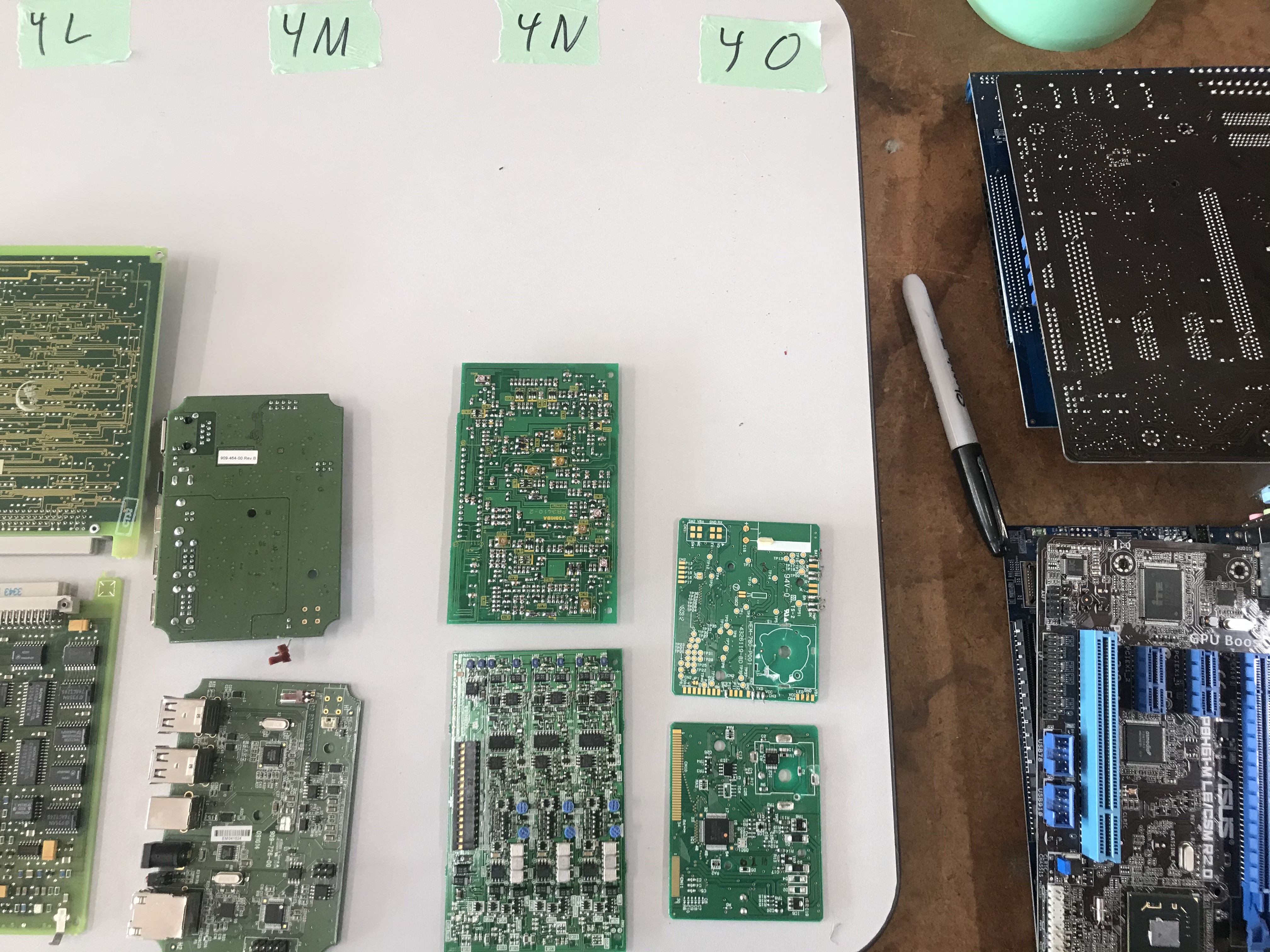

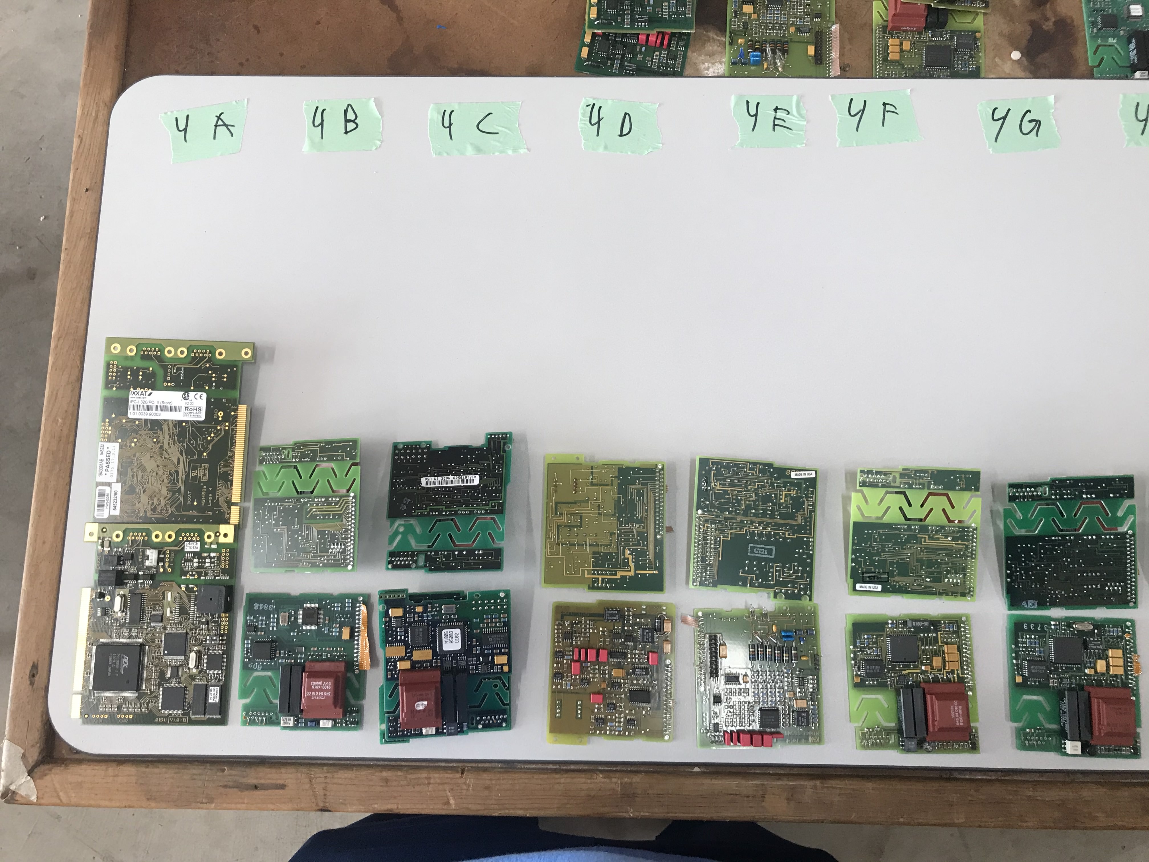

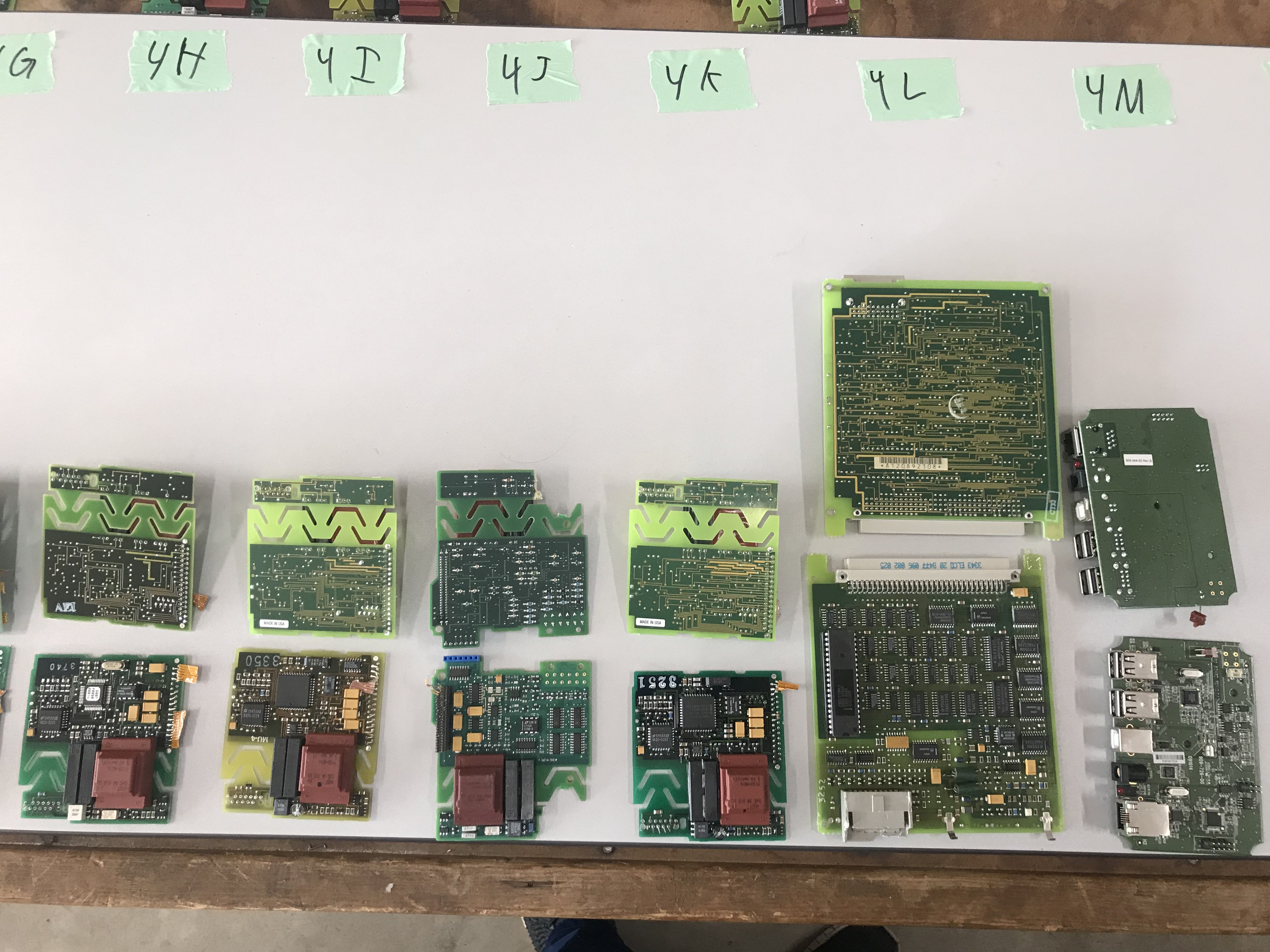

I need help with identifying these boards.
PostPosted: Thu Oct 21, 2021 7:12 pm
Posts: 395
4A high telecom, don't trim the fingers
4B not sure because of the red thing, not sure what it is and how heavy it is
4C high peripheral
4D low telecom
4E high peripheral
4F, 4G, 4H, 4I, 4J, 4K same as 4B, I'm not sure
4L high telecom
4M high peripheral

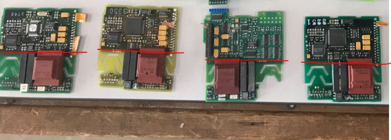

The "red thing" I believe is some sort of transformer (steel/copper) so I'm thinking low grade as is since the majority of the weight is that single component.
If you remove it I feel like you'd end up breaking the board, so if you go that route, the side with the ICs would be high peripheral the rest would be low grade with or without the "red thing"
I'd also note, when you remove wire you want to get all of it whenever possible.
PostPosted: Fri Oct 22, 2021 10:49 pm
Posts: 395
If you were to cut the boards into two pieces like this, then the grade for the section with ICs and tantalum caps would be:
4A high peripheral
4B low telecom but on the edge for high telecom
4F high peripheral
4G high peripheral
4H high peripheral
4I low telecom
4J low telecom
4K high peripheral
