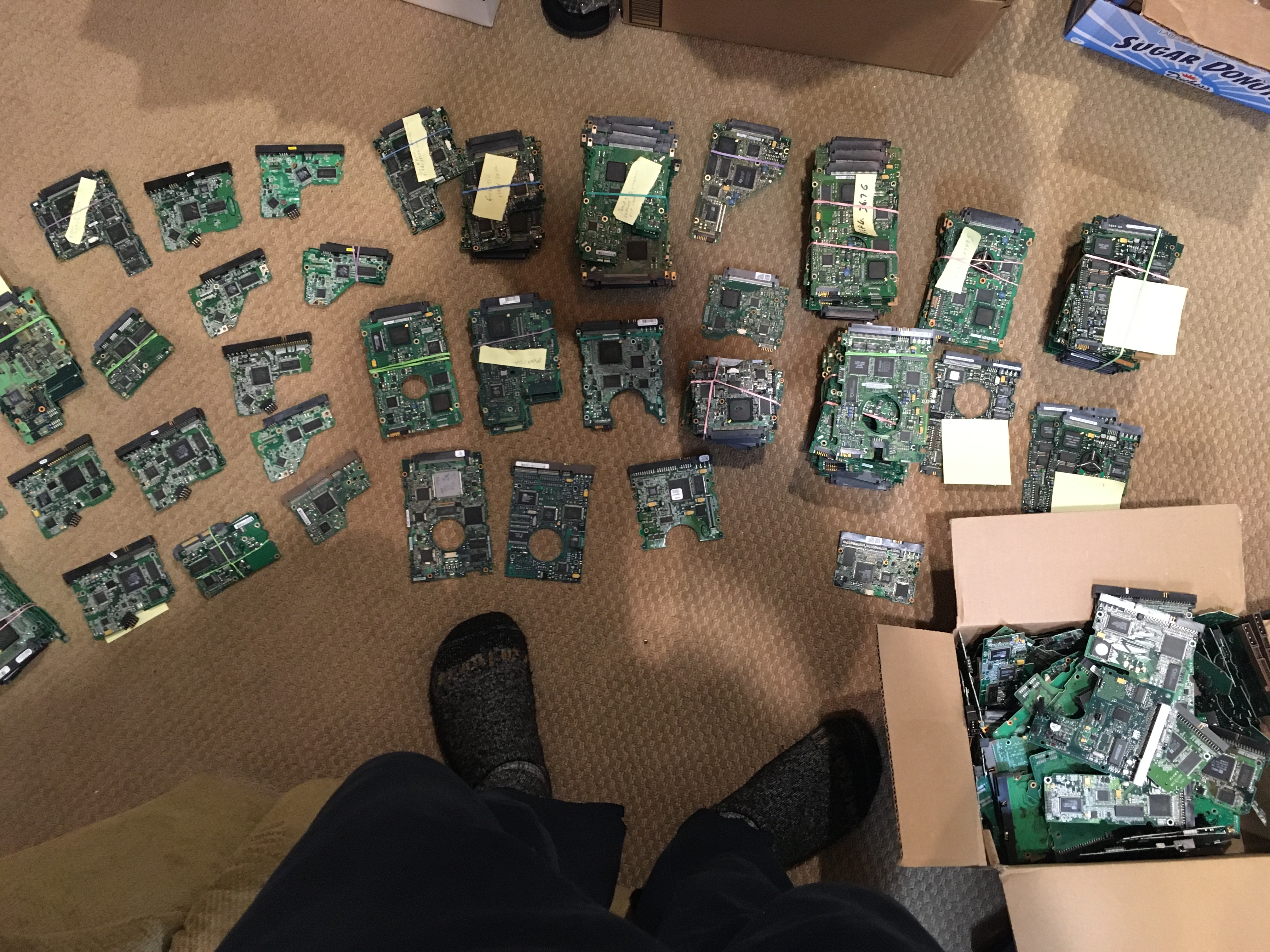

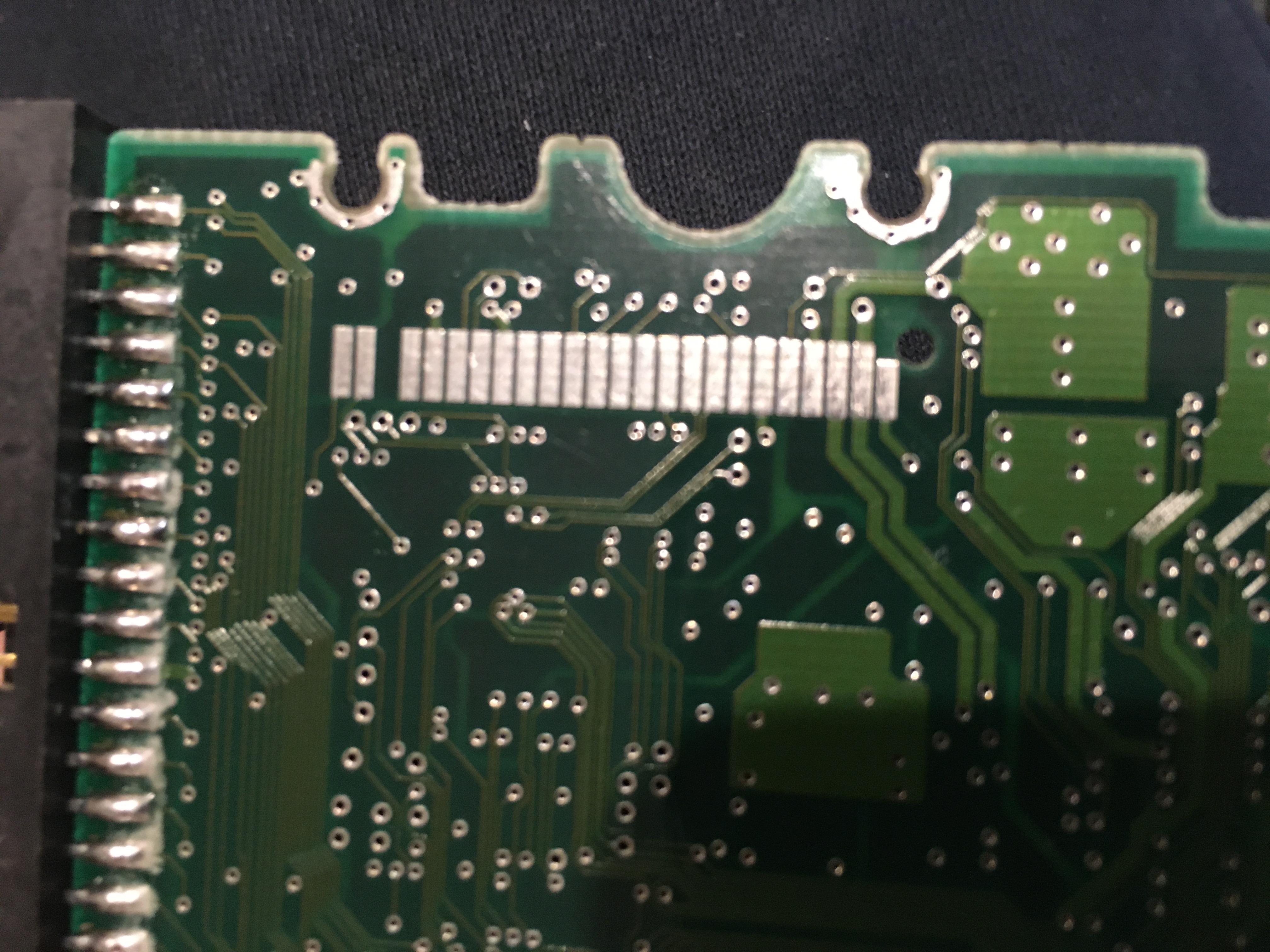

I have hundreds of boards that I have collected for the last 20+ years (bottom picture) that I thought were all hard drive boards. But when I started looking up the numbers, I found that some were tape drive, floppy drive or cd rom boards; so I evidently cannot identify them by the the plug socket.

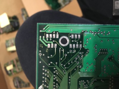

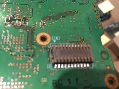

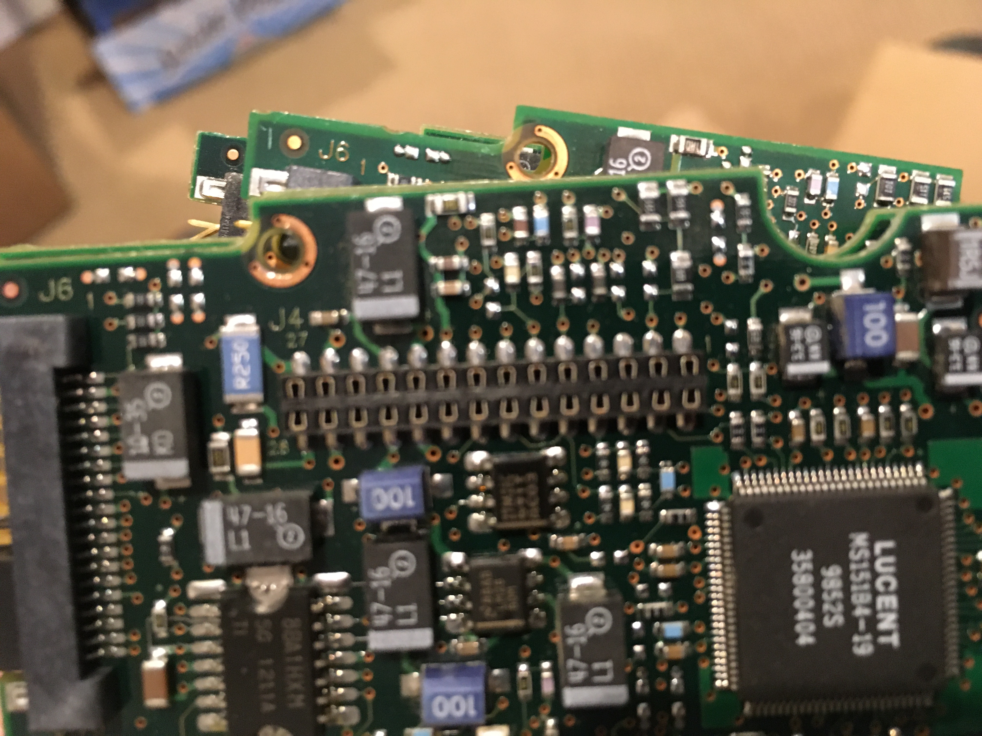

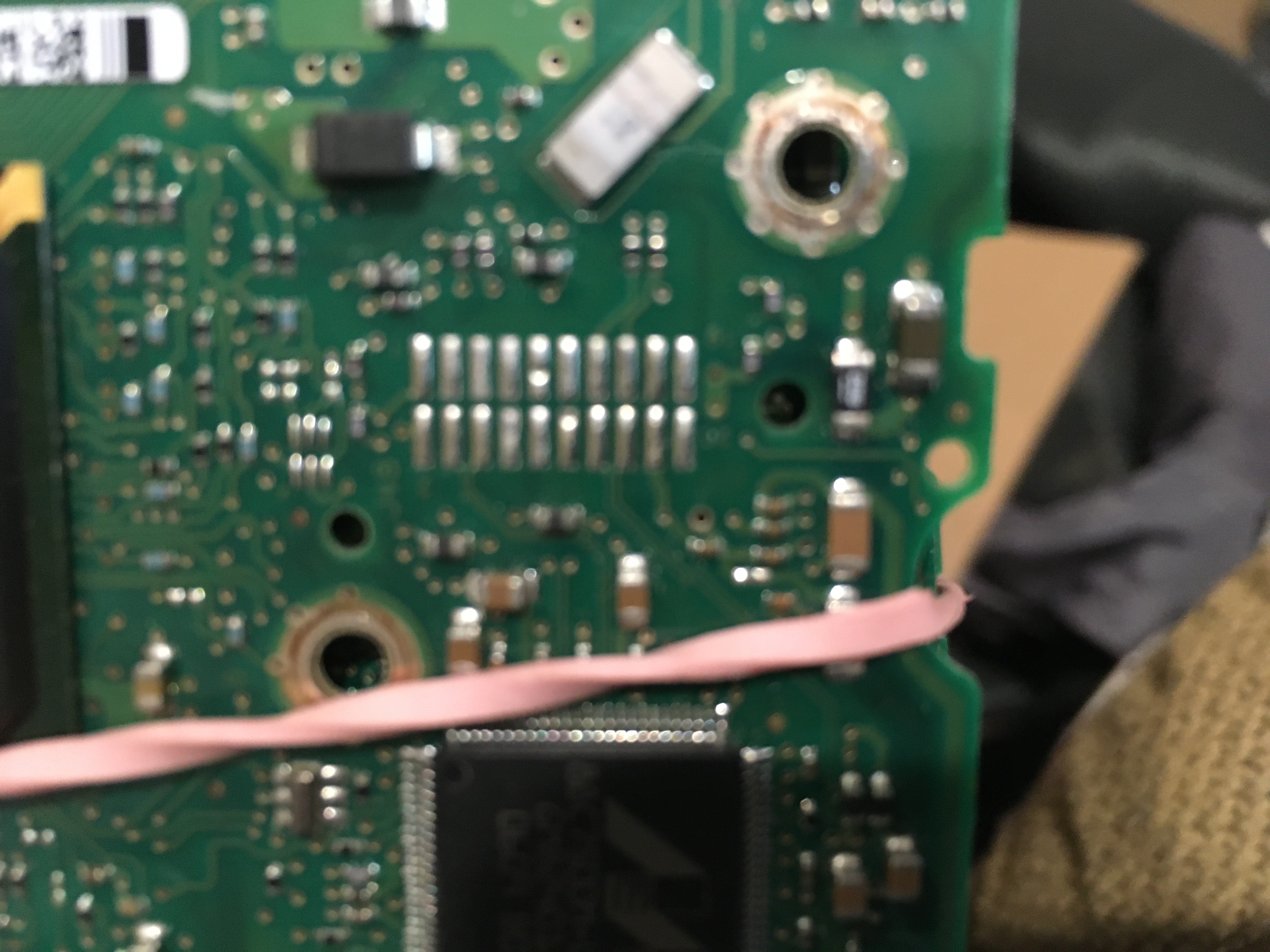

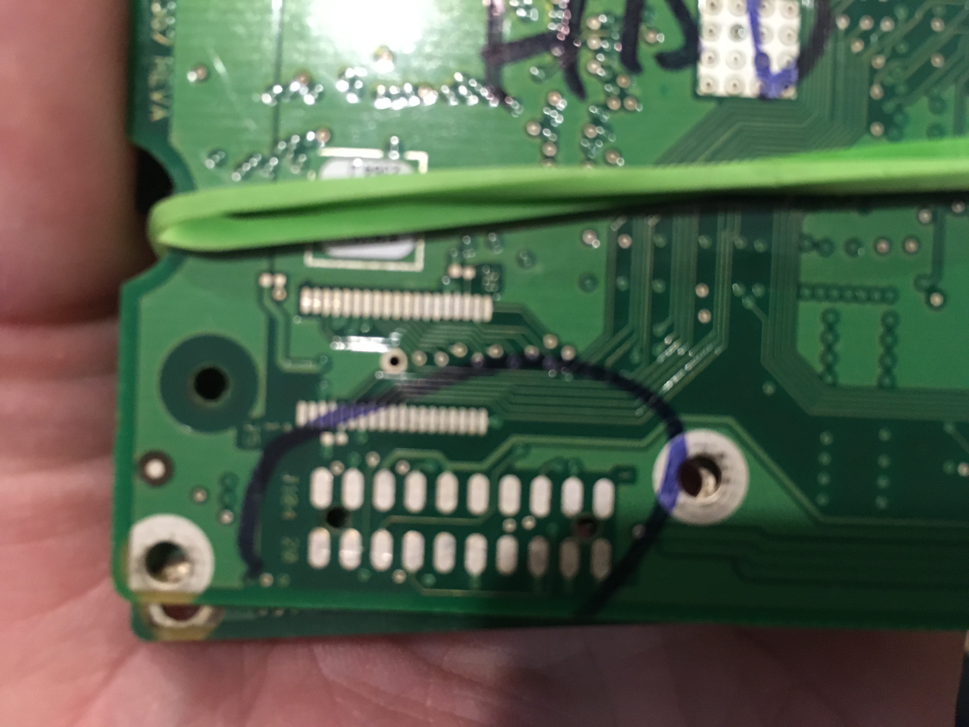

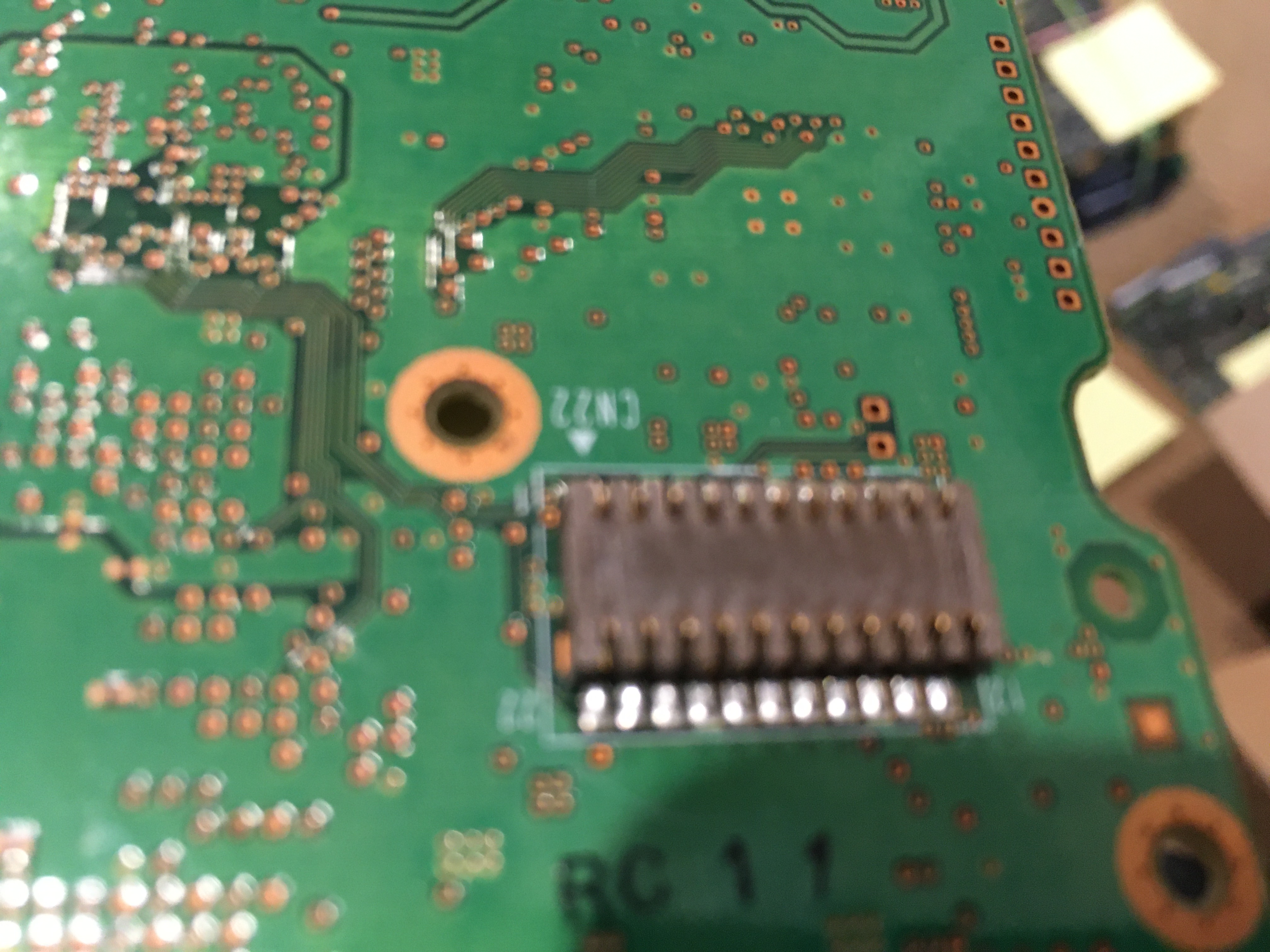

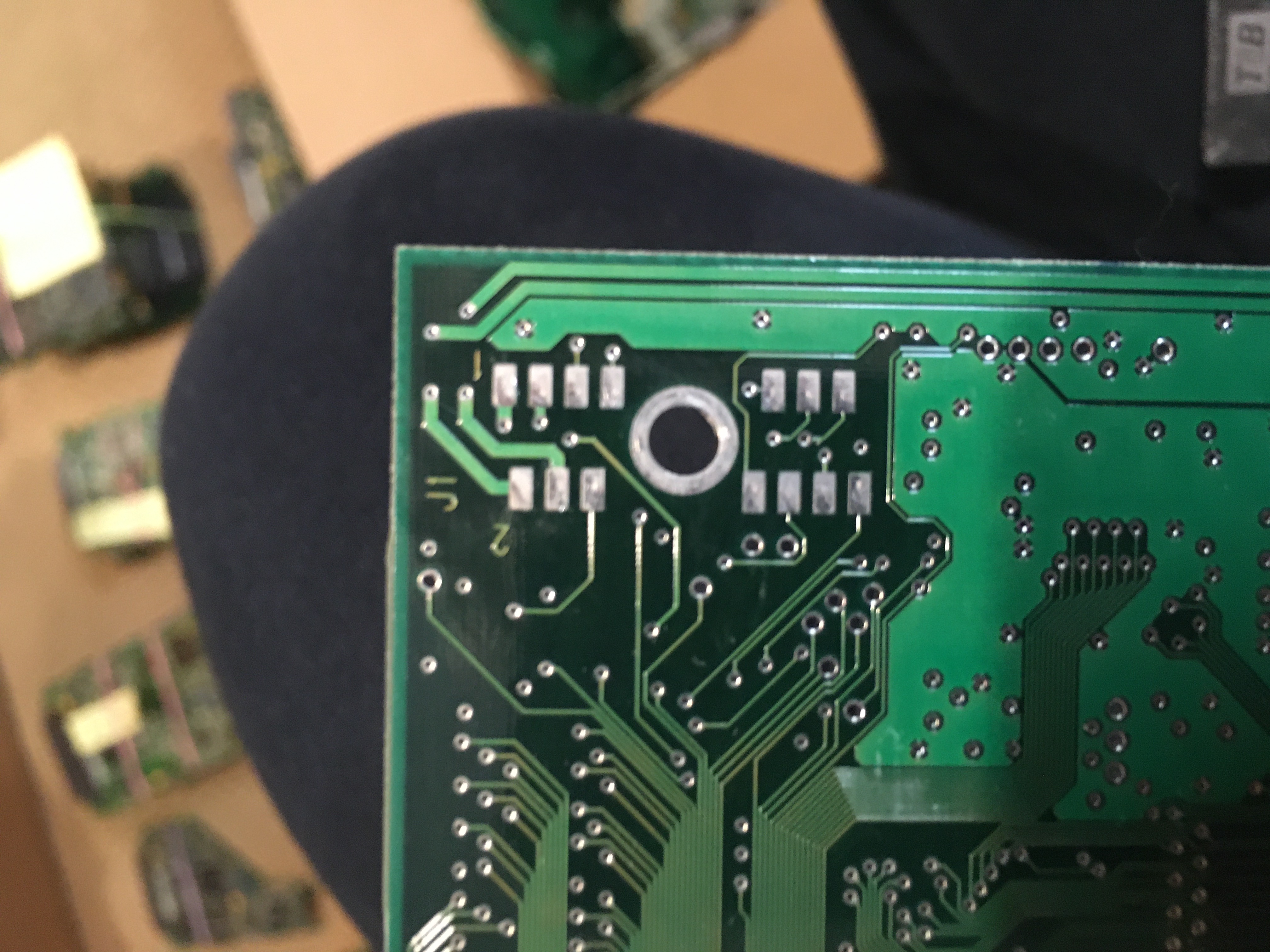

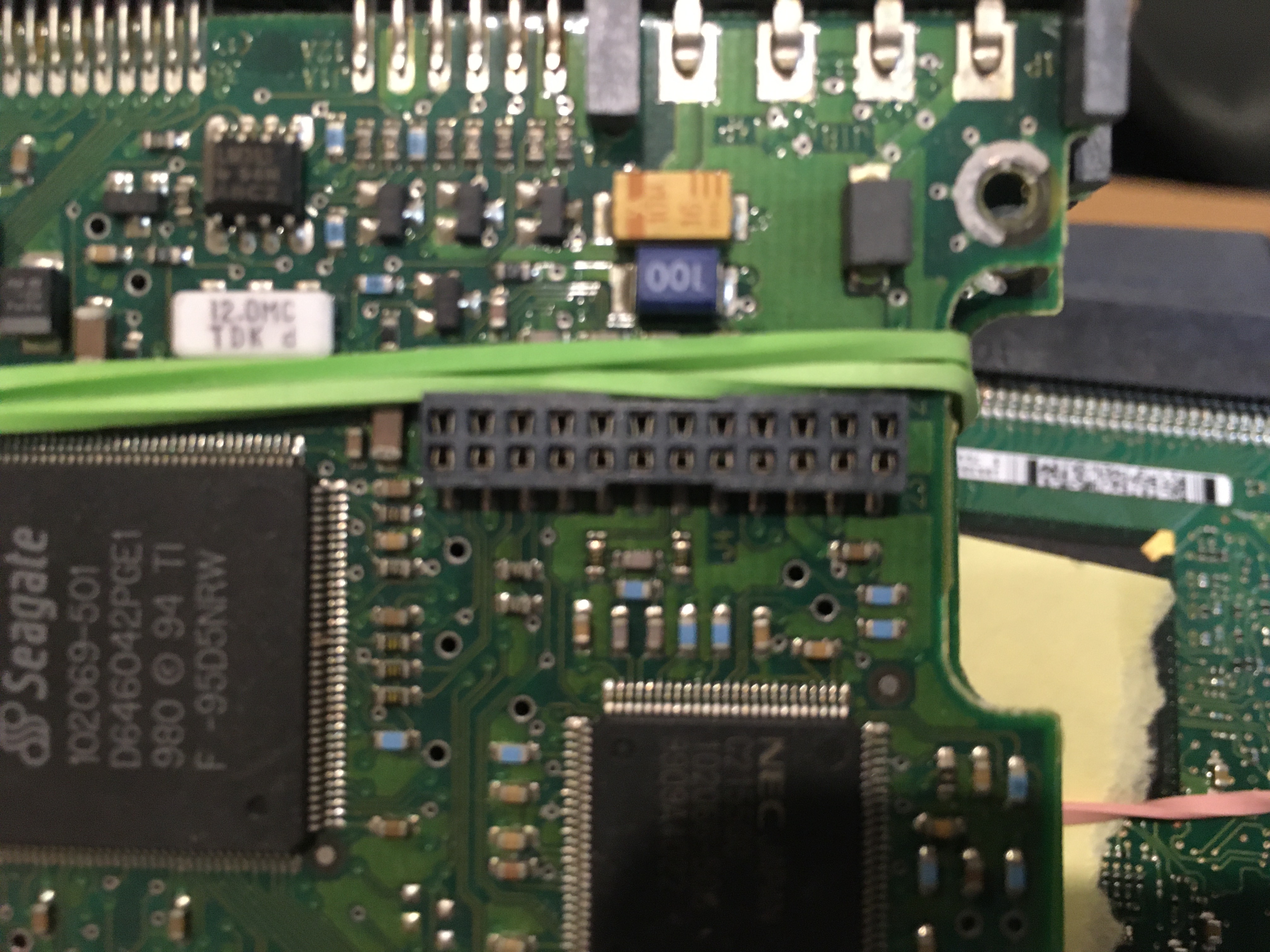

In looking many of them up by the circuit board numbers, I was able to determine that most of the hard drive ones have a kind of dotted 'footprint' or a plug like in the other photos.
Is it safe to assume that all boards that have this footprint or plug are hard drive boards, or is there another way?
Or maybe a better question should be is "how do you separate hard drive boards from CD rom and floppy drive boards?"

Most hard drives have that connection. Either the socket for pins or contact pads that relay information/power from the board to the inside of a hard drive. I don't know off the top of my head if HDDs are the only format to ever use that but most HDDs do have it.
If I have some time later tonight and nobody else answers I'll see if I can go through the rest of you're questions
