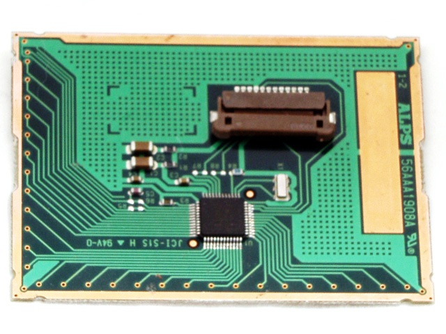

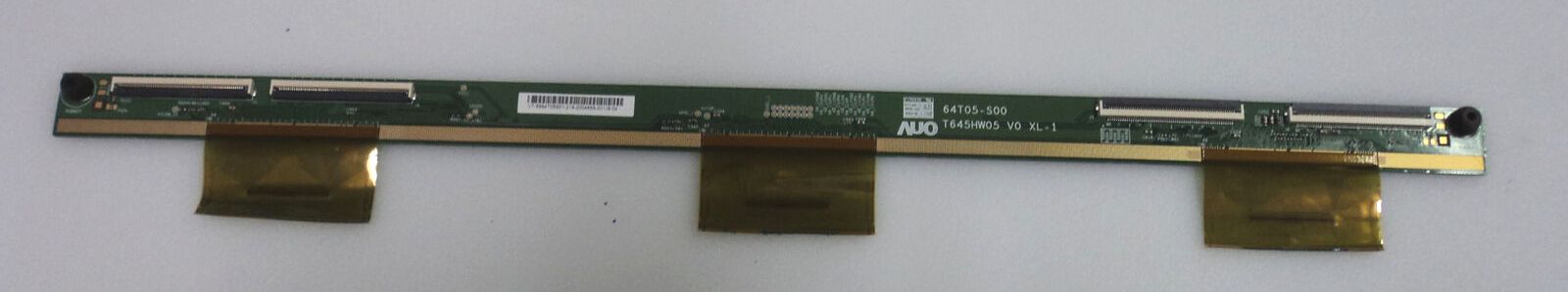

I do not need an ID on these but just wondering if Boardsort has a category just for these? I looked but could not see any. They always seem to have a lot of gold showing.
these are two boards from laptop and flat screen tv.

High peripheral; laptop trackpads are almost always high peripheral.
Midgrade. A little more info from another post that I answered recently:
marked141 wrote:
From what I understand, Boardsort prefers the "tape" to be removed. I don't know if it's strictly required. Definitely be sure there's no glass.
Also, for these specific boards from screens, they generally start at midgrade if there are no any components mounted on the board as the amount of gold is minimal and doesn't significantly increase the value. If there are ICs mounted on the board it could pull the grade up to high peripheral.
