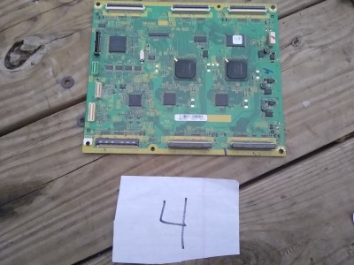

Hey,
Here are some boards that I got out of a couple TVs. Some I am comfortable with grading, and others not so much. In the future I will not add so many boards to one post, but wanted to keep this topic consolidated. Thanks.
My thoughts:

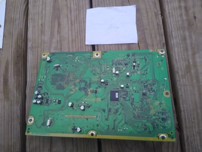

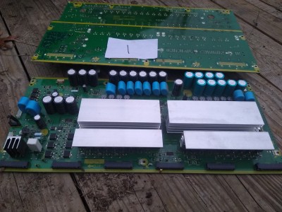

1) Midgrade (there are a few small ICs, so not sure if it could go higher)

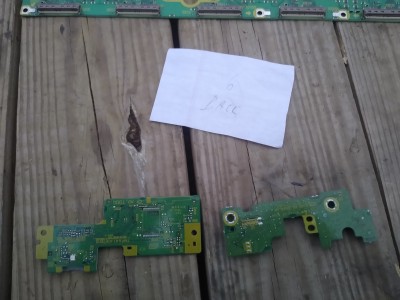

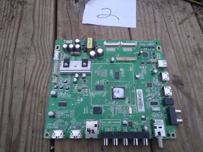

2) High Peripheral

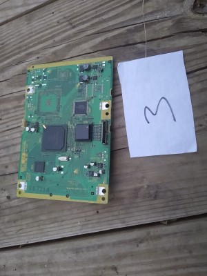

3) High Peripheral

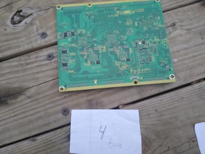

4) High Peripheral

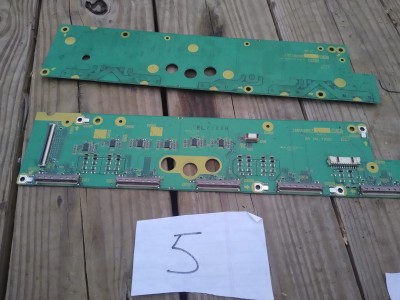

5) Low Peripheral?

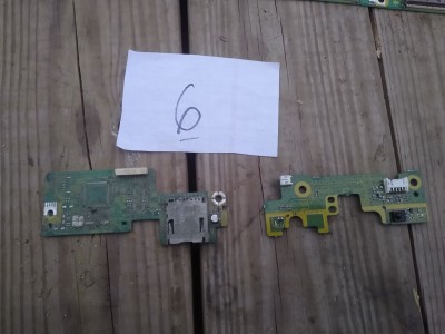

6) Low Peripheral?

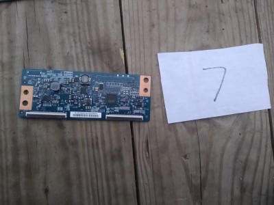

7) High Peripheral

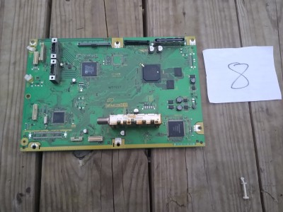

8) High Peripheral (small ICs on one side of the metal box)

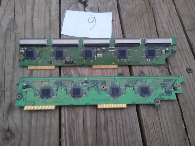

9) Clean GFC (Could it go higher due to ICs on both sides?)

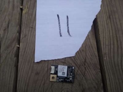

11) No Clue

 Post subject: Re: TV Boards 12-27-2021
PostPosted: Wed Dec 29, 2021 11:15 pm
Posts: 2483
1) Agree; it would probably stay midgrade even if the aluminum was removed so if you have a place that pays well for aluminum then you can decide if that's worth your time.
2/3) Agree
4) Maybe bordering on low telco.
5) Agree
6) Midgrade
7) Agree
8) Agree (those boxes typically have a few ICs inside)
9) I want to agree but not sure if those can go with the GFCs

11) Low peripheral is where I normally put those, remove any shields.

Hopefully most of that was helpful.
