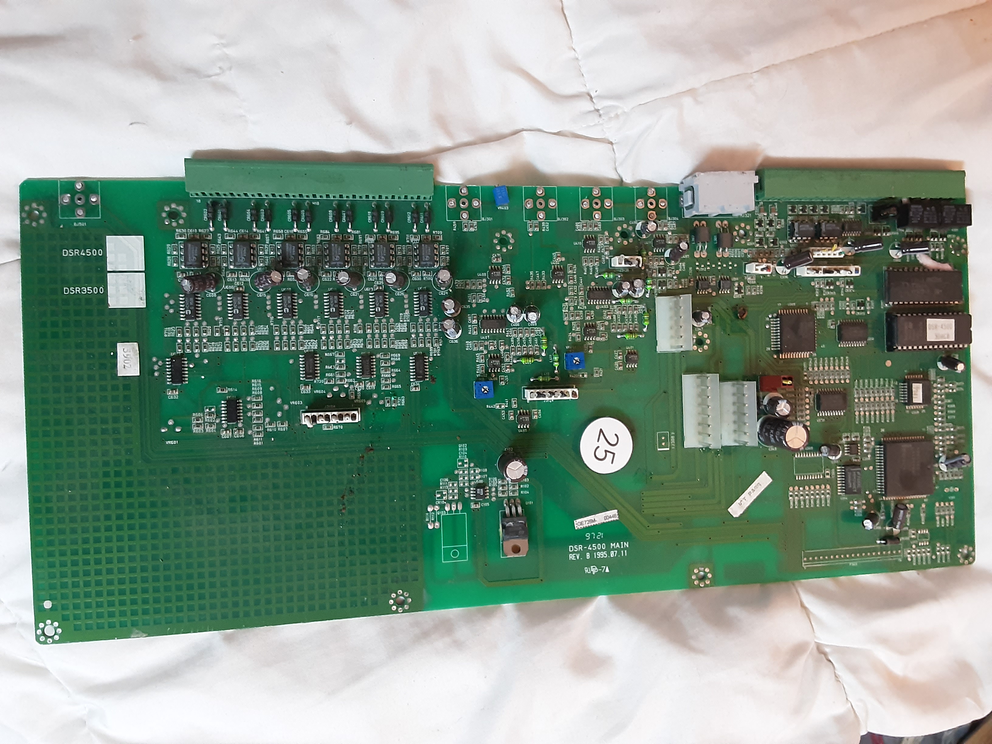

25) High peripheral

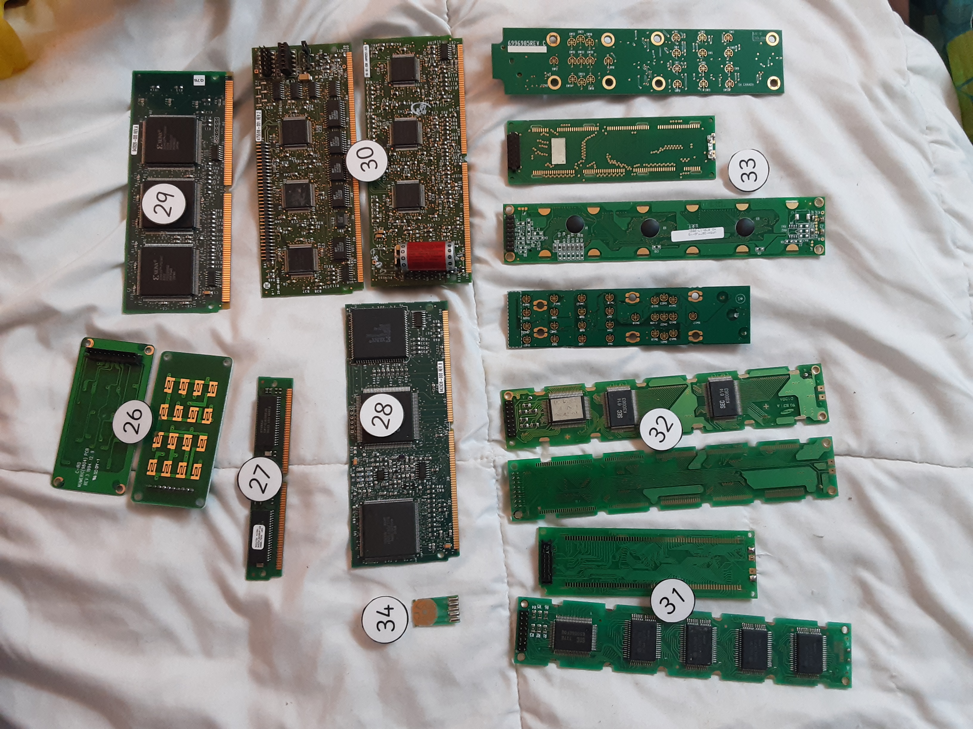

27-30) Not really sure the fingers look more like copper than gold and I don't know if that's just the image distorting the color or if it's actually copper colored.
31-33) Except for the two that look more like some sort of keypad under 33 these appear to be small LCD screen boards. The six LCD will be high peripheral as long as there are ICs (or bump ICs) on all of them, the one with 5 ICs will probably get at least low telco. The two keypad boards, unless there's more on the back would be midgrade.
34) Midgrade at least, maybe low peripheral if that circular area is gold.
