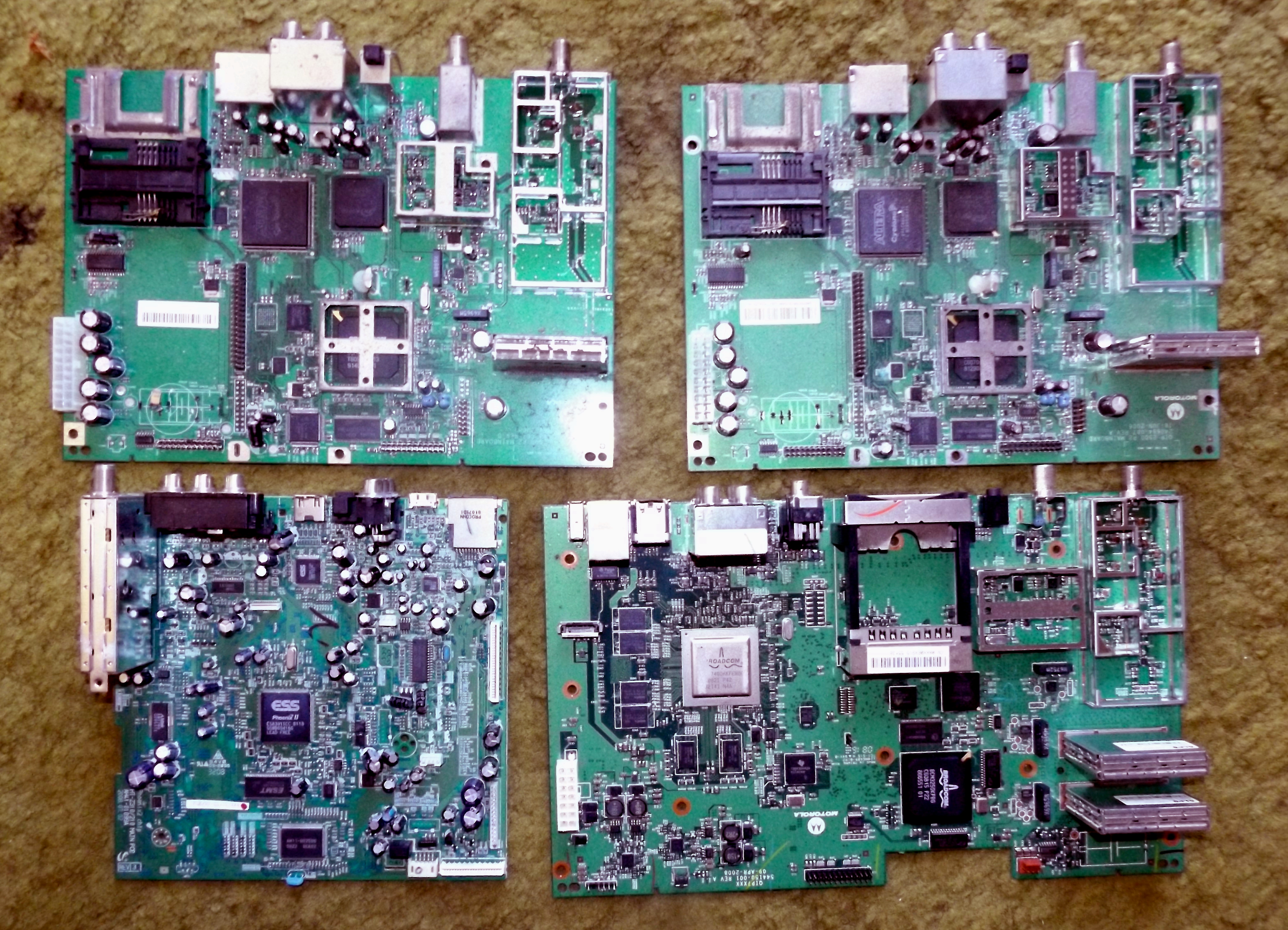

Picture 1: from cable boxes, DVRs

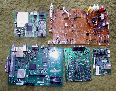

Picture 2: more cable boxes, DVRs

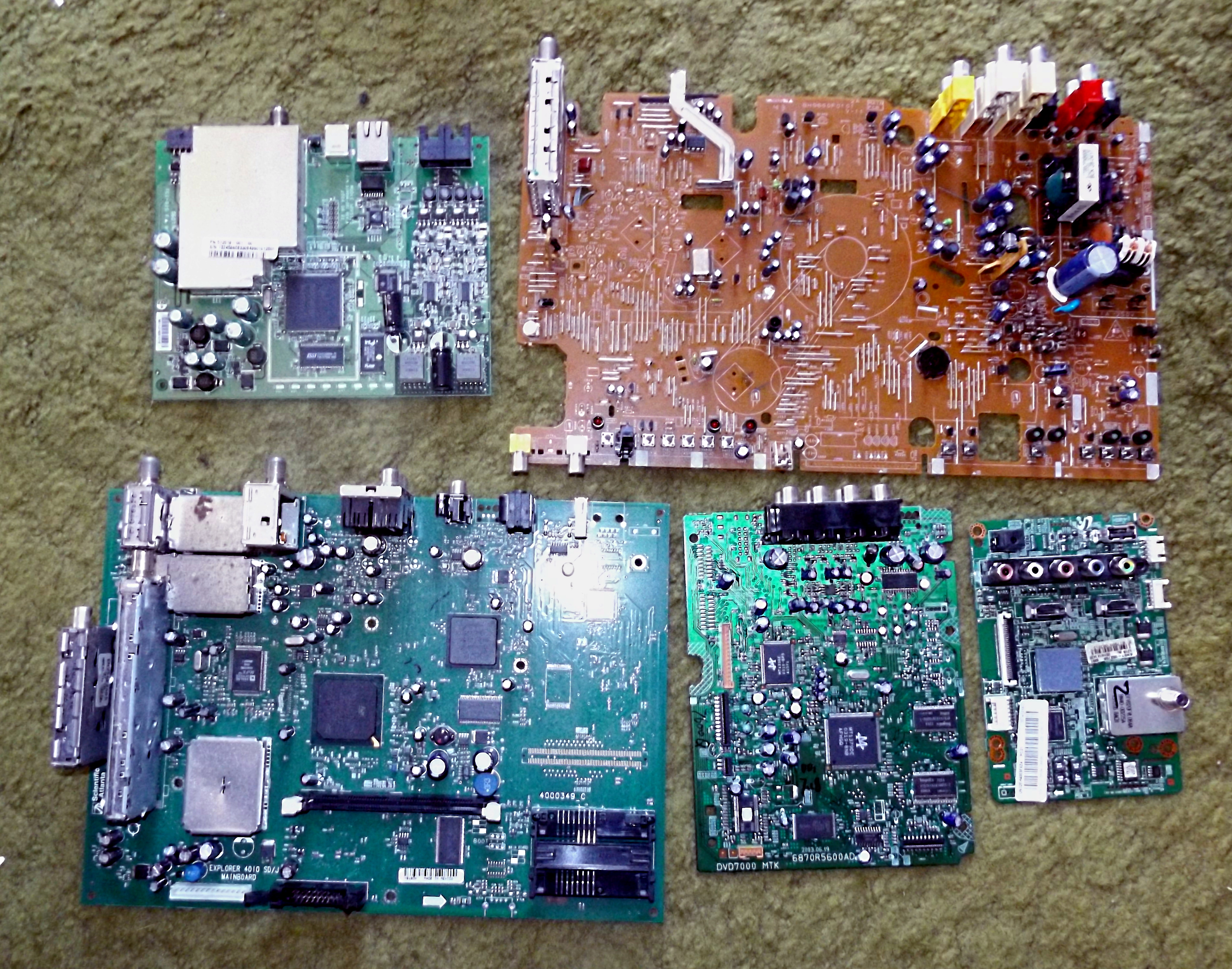

Picture 3: a/v stuff. The first board is from a big amplified speaker.

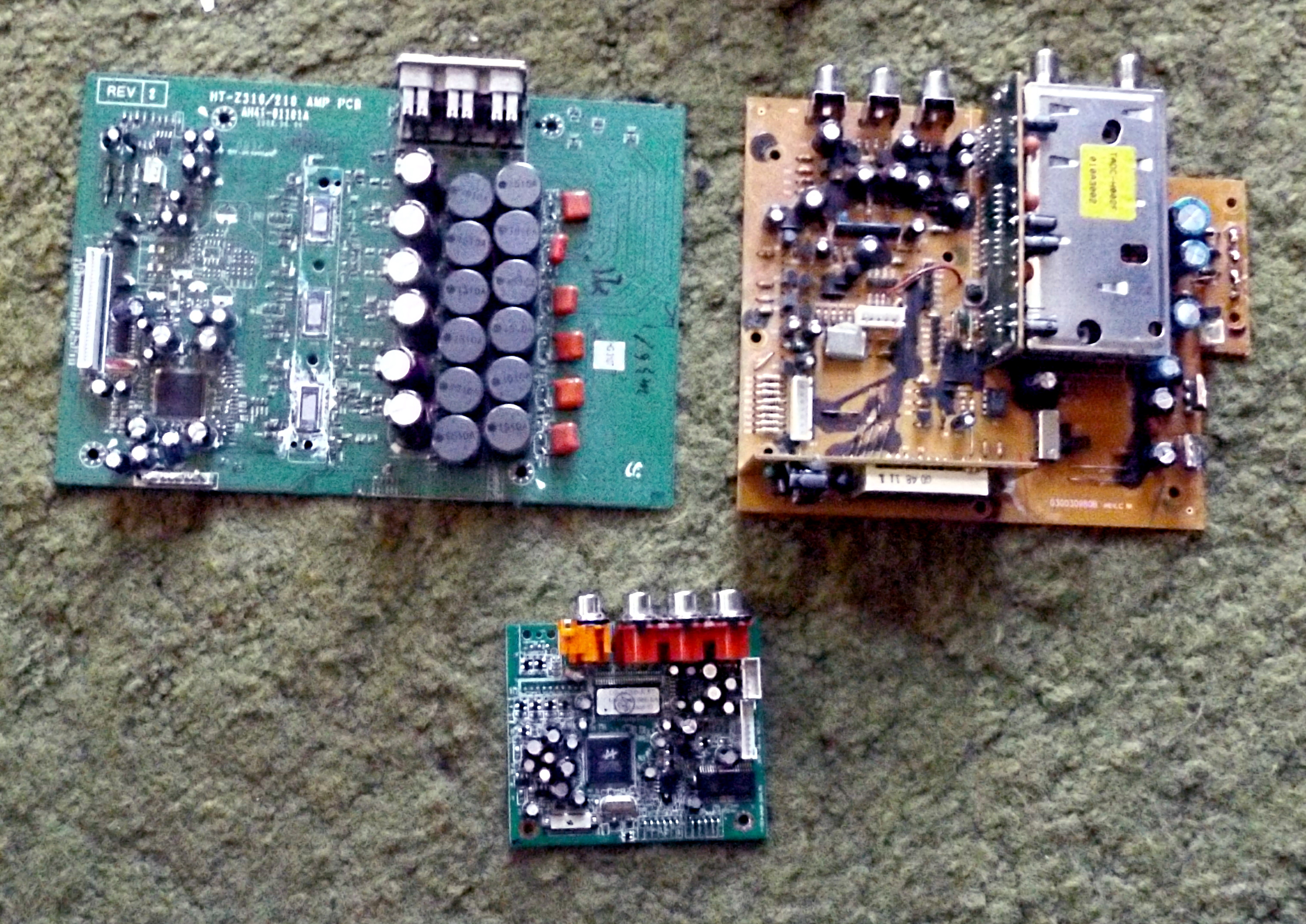

Picture 4: power supply boards

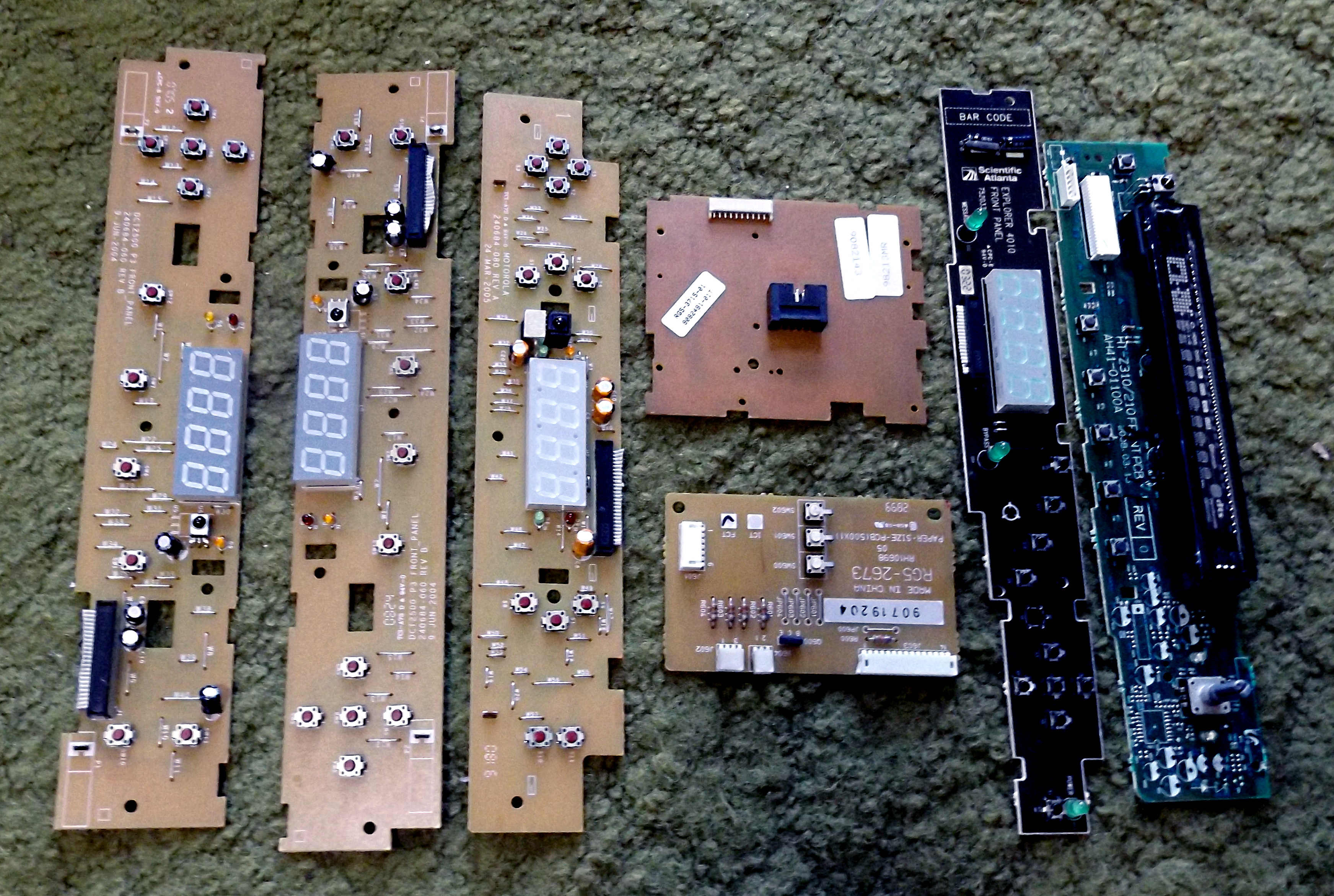

Picture 5: user interface boards

In picture #2 the brown board is not similar to the other boards. I would imagine the brown board is low grade and the other 4 boards look like Peripheral High Grade.

1) Should all be high peripheral
2) Brown board low grade. The middle board on the bottom row is high peripheral. Rest, if you can clean them up as described above and retake pictures that would be great.
3) Brown = Low grade. Small board I'm leaning high peripheral. Larger board, this is one the picture quality isn't helping me to be sure on; I'd say low peripheral right now.
4) Low Grade
5) Low Grade; the one with the large display I'm not sure on, the board itself would be midgrade but there might be chips under the display and the display itself might add value to the board
