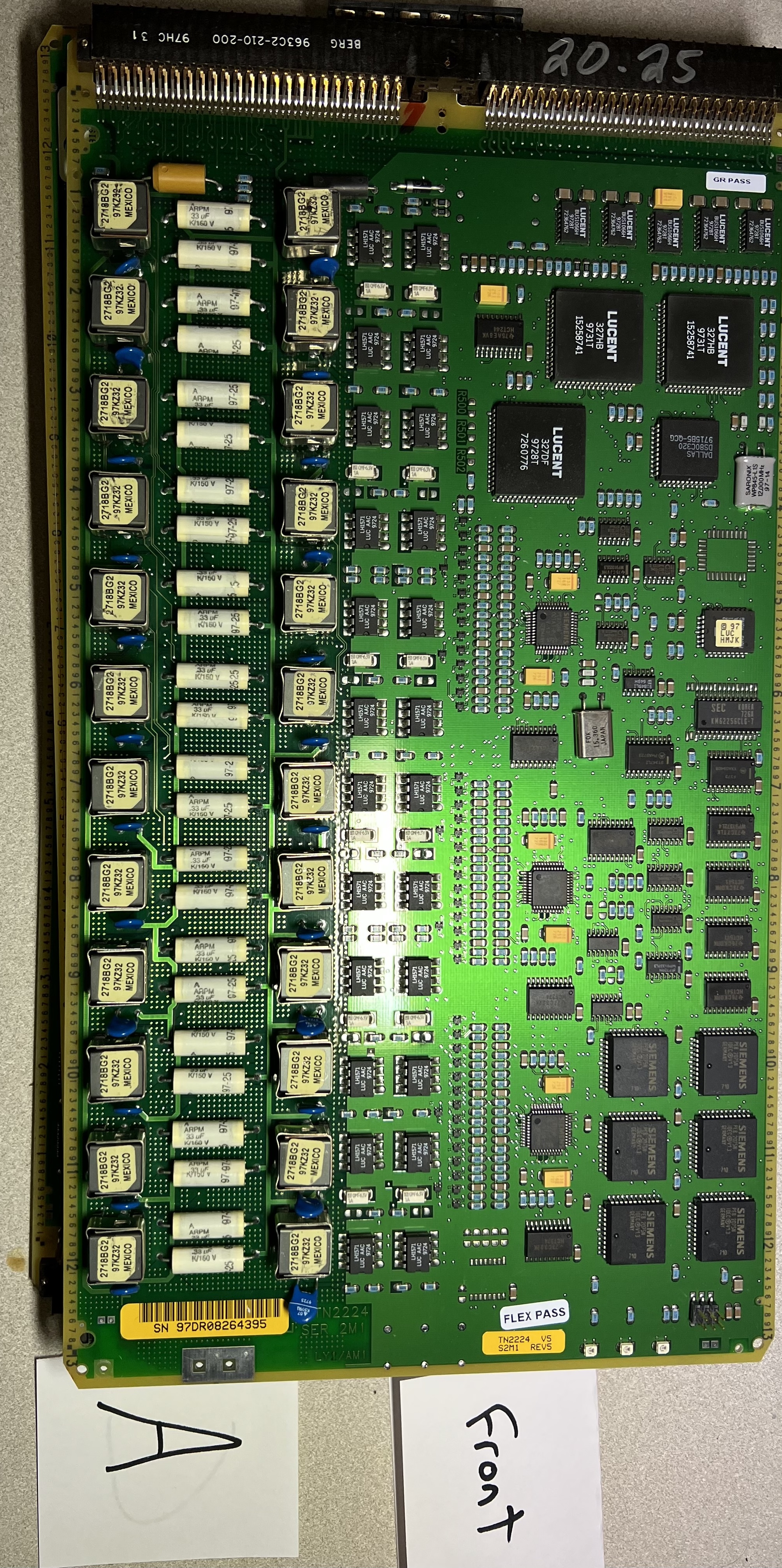

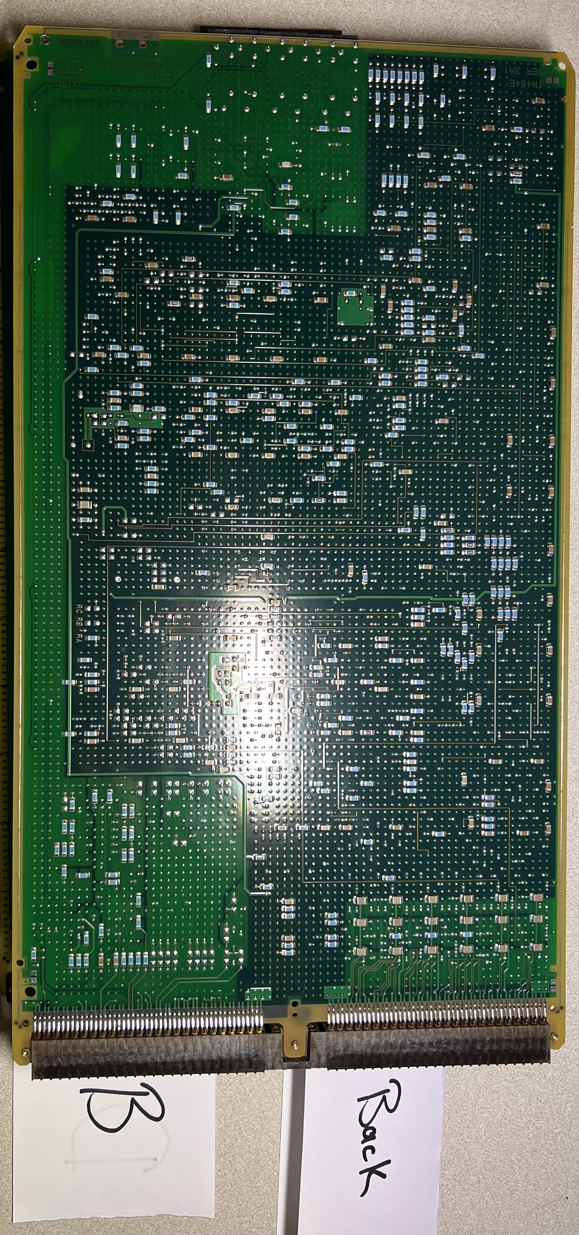

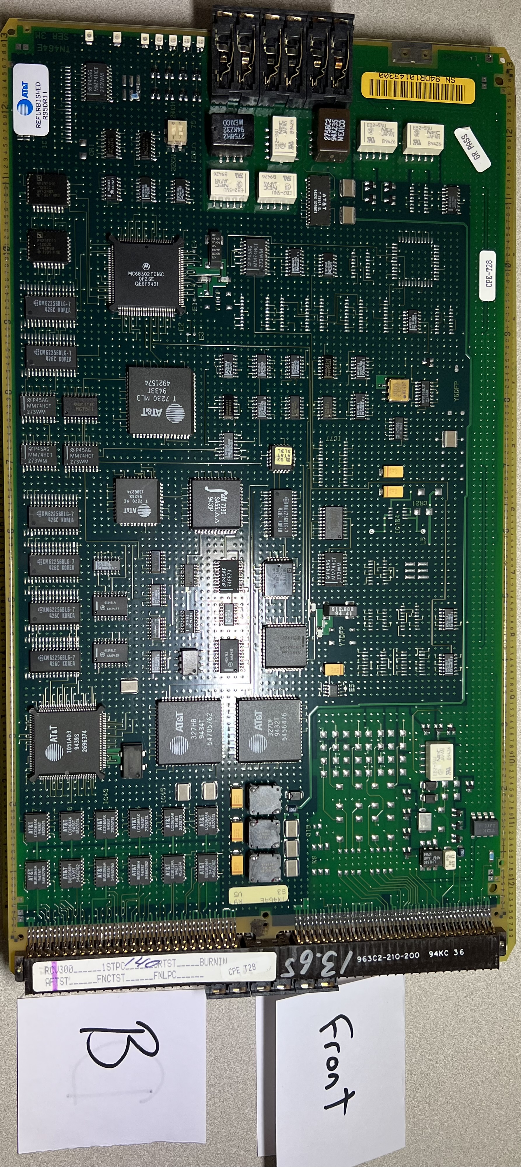

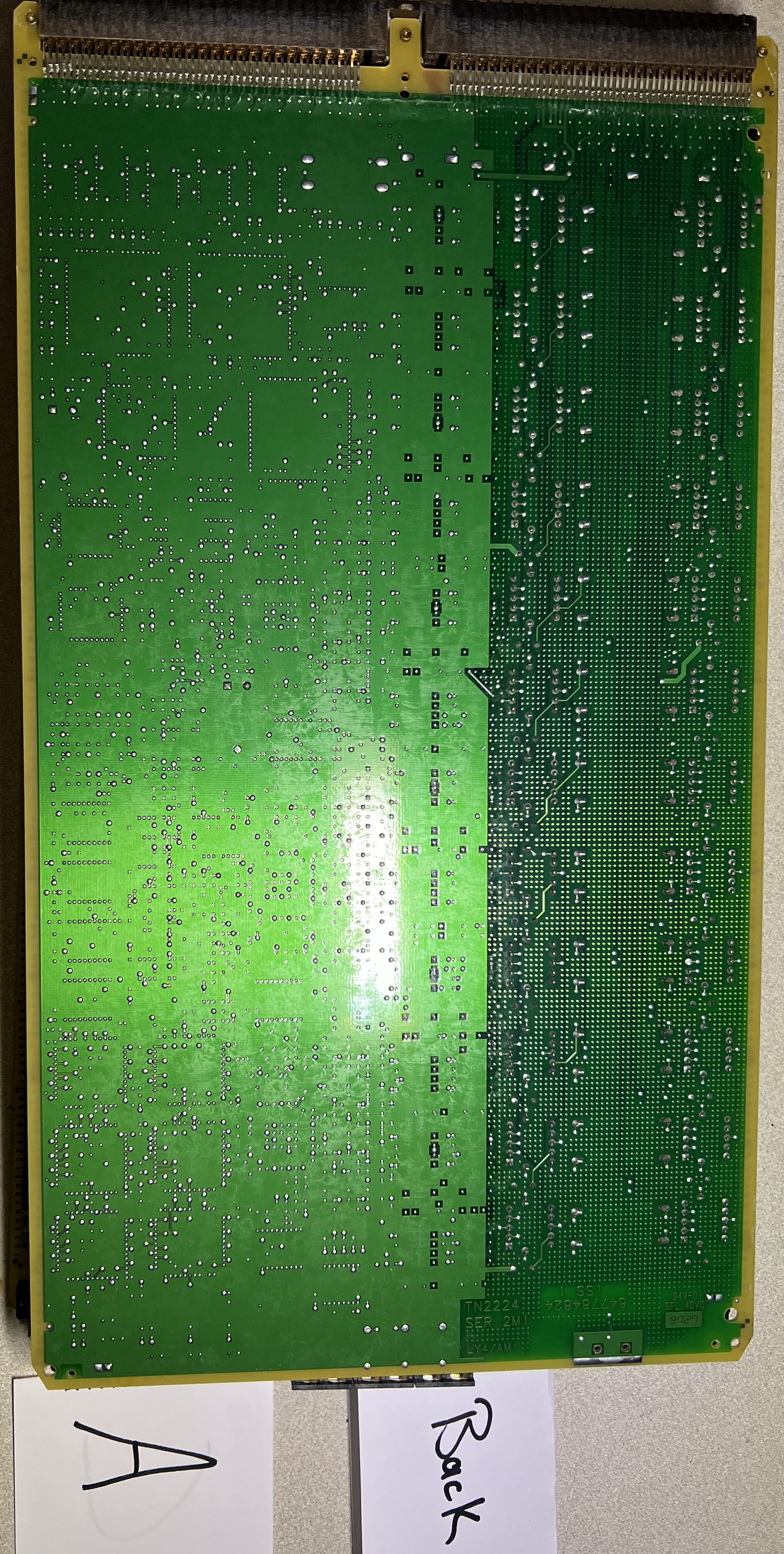

Hello all, I have some cards from an enterprise class PBX circa 1999 that I need help grading. There are several different types but these 4 are a good representation of the range. Hoping to get enough info to be able to grade the remainder accurately. The pins in the connectors are gold plated. Thanks in advance!

Until I can get to a computer (phone just doesn't cut it on some of these photos) I'm going to say A-C are at least low telco.

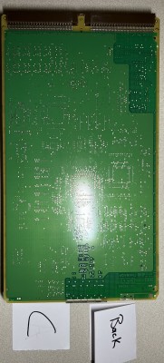

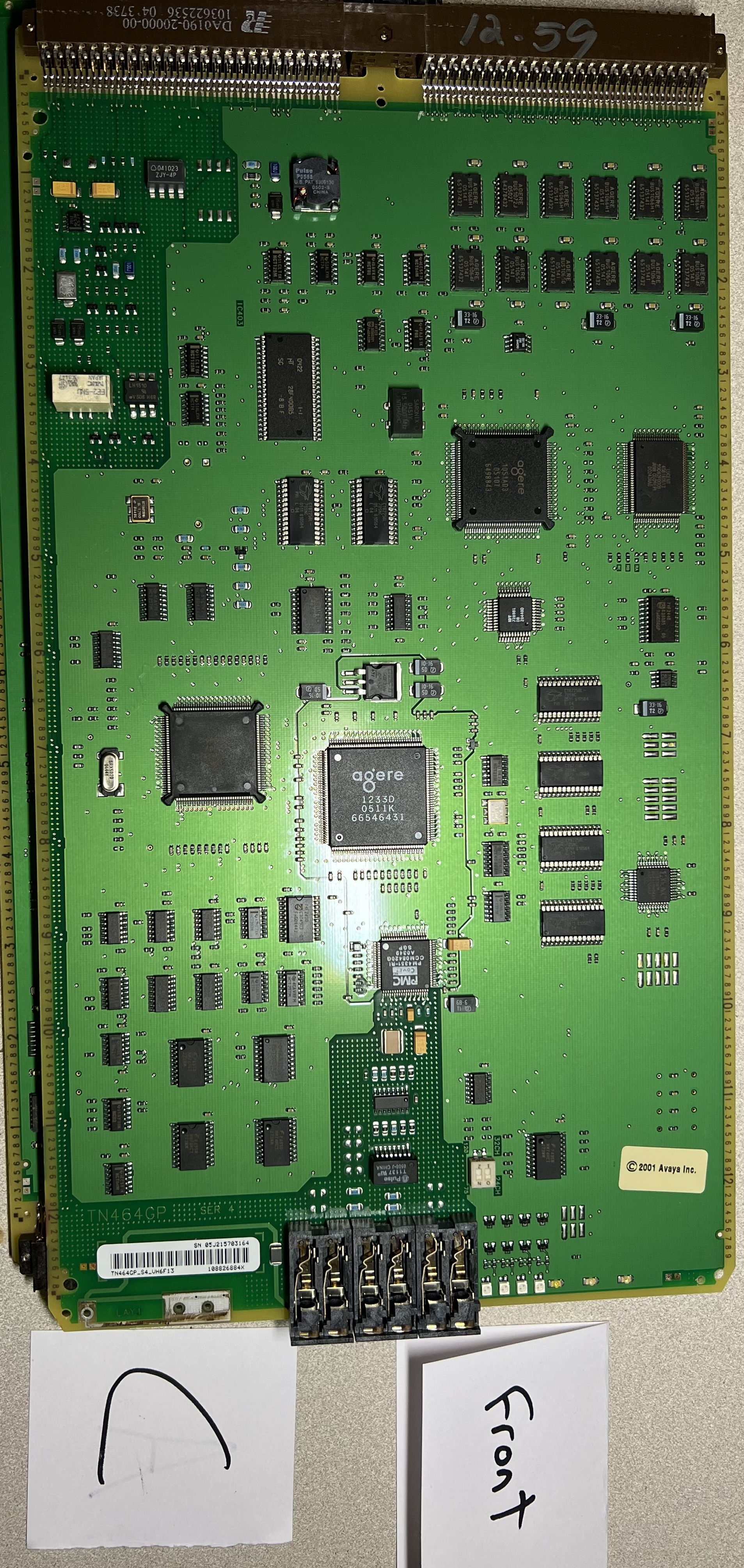

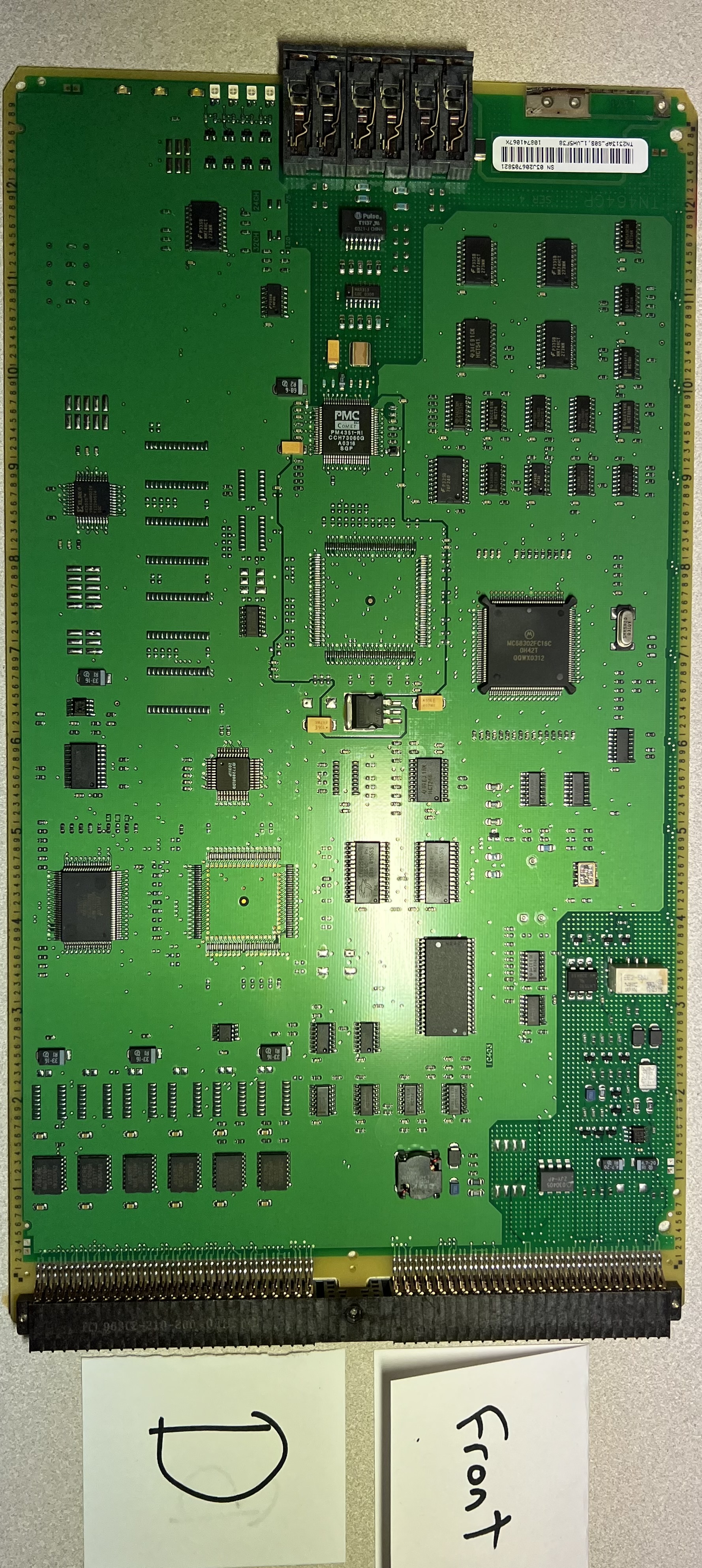

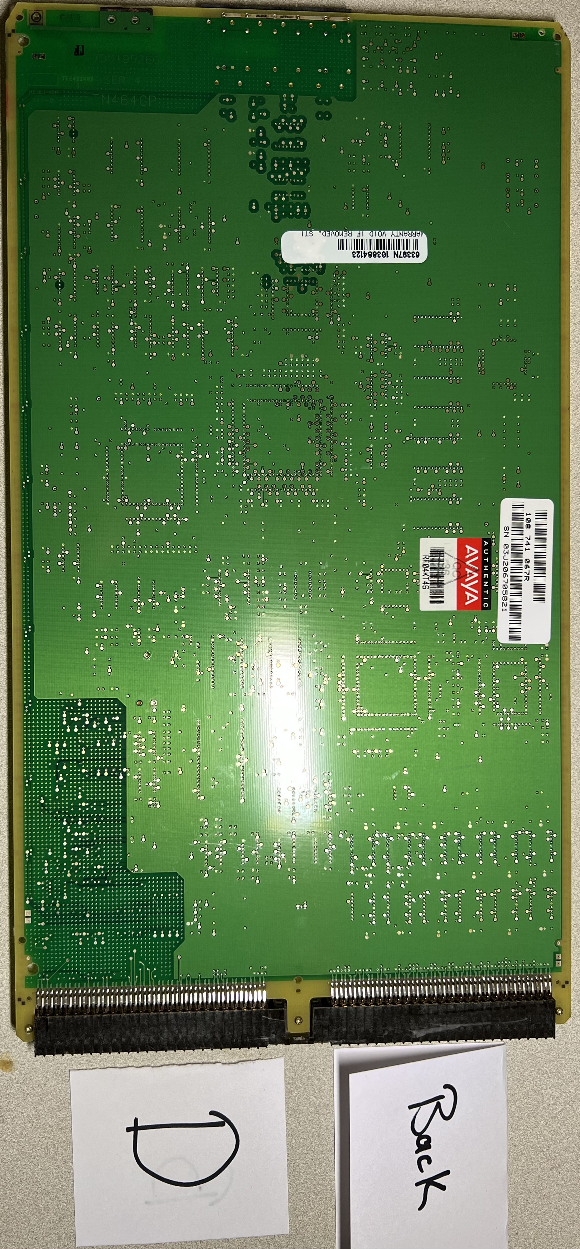

D, are the missing chips not there because they were removed or because the board wasn't manufactured with them? Removed chips can make a difference in the grade and I'm on the fence between high peripheral and low telco. If no chips have been removed then I'd lean much more to low telco but if they were removed then I'm still on the fence but leaning high peripheral.

On "D" nothing has been removed, there are just solder points for different IC packages that can use the same PCB. If you look at "C", it is the same PCB as "D" (flipped 180 degrees from each other) It just served a different function on the system thus a different IC arrangement.

A) Low Telco
B) That looks like a Gold Cap Chip a little higher than halfway up toward the right side. Totally missed it before, that's going to go Gold Cap Chip Board.
C) I think this can manage High Telco
D) I'm leaning Low Telco.
