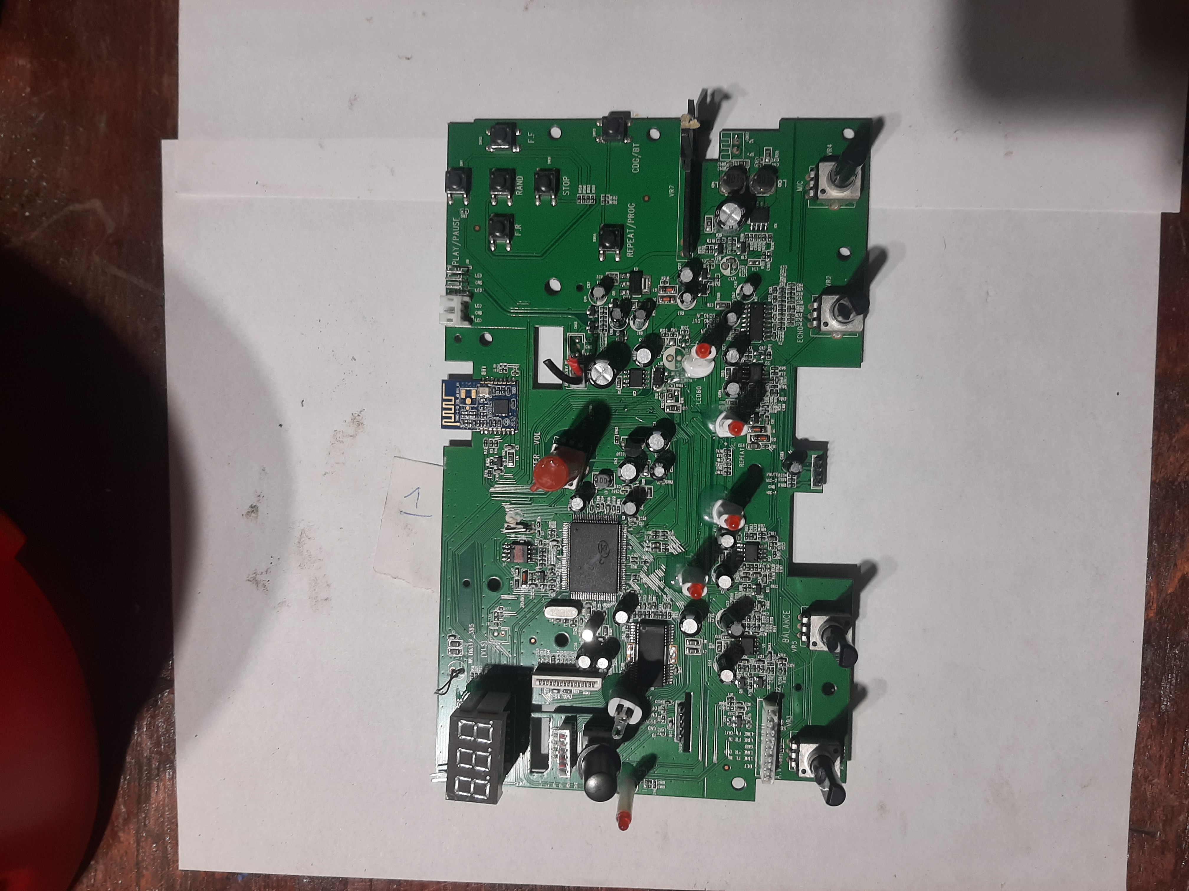

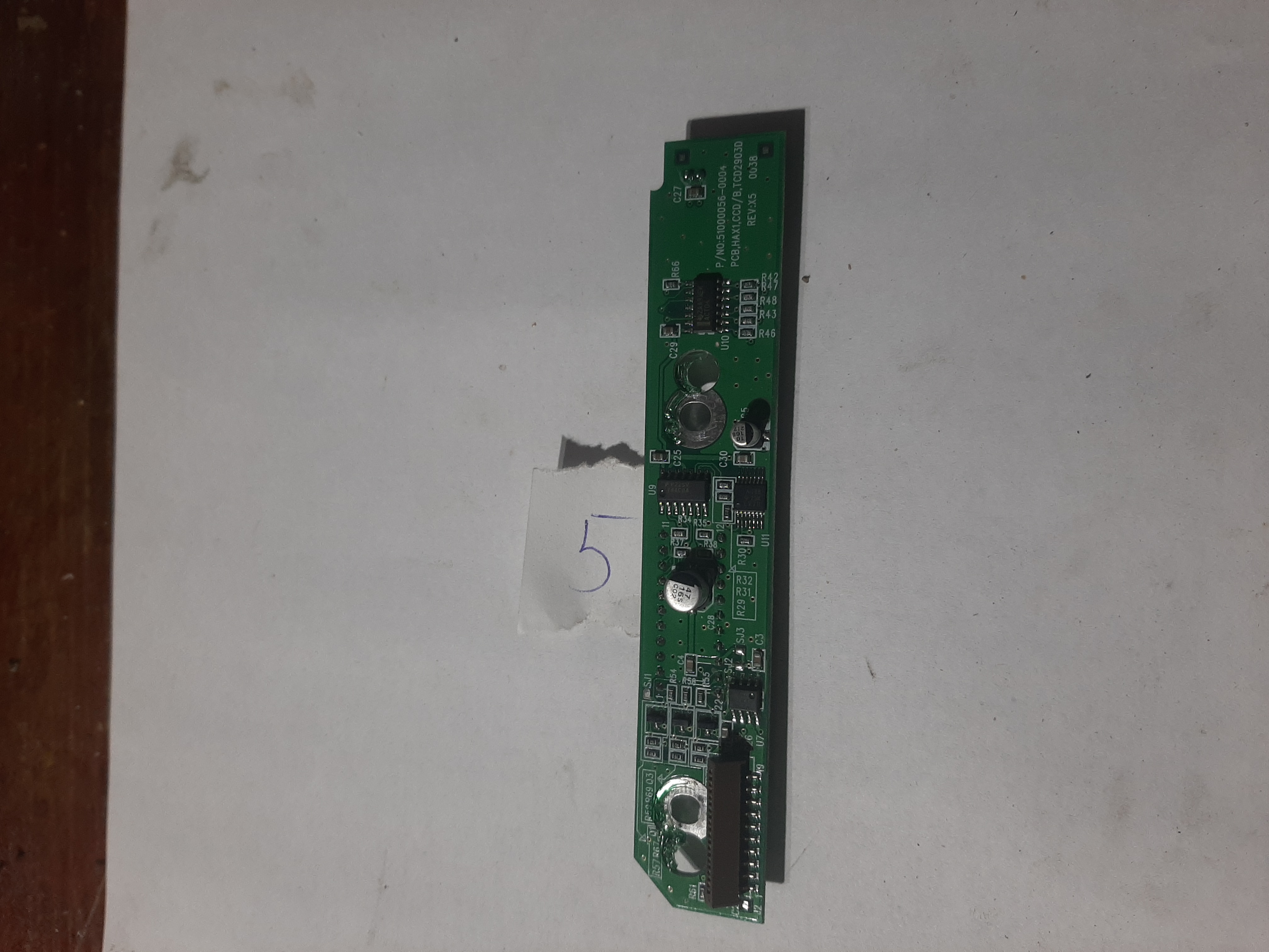

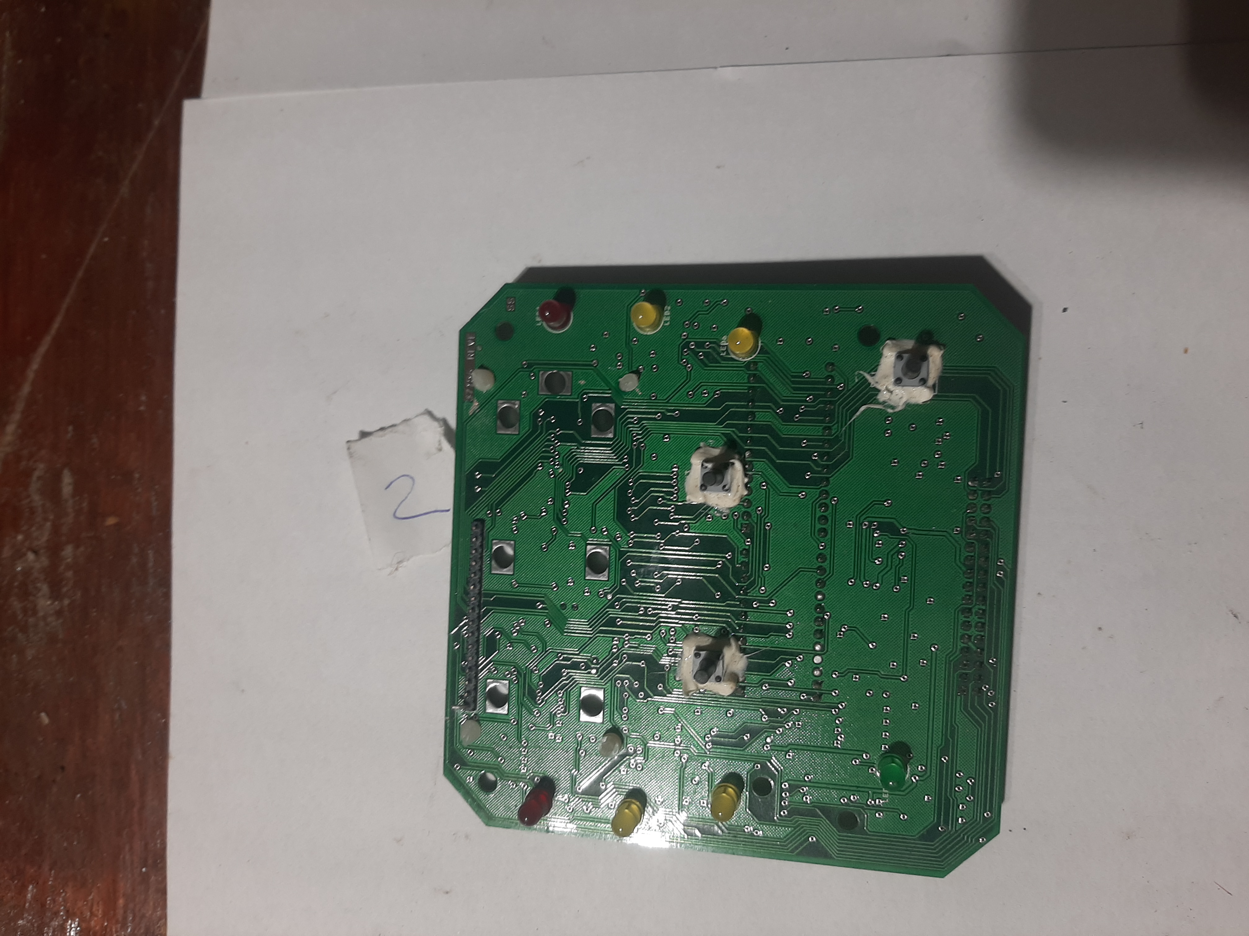

On board 1 should blue chip be removed and if so what would the two grades be.

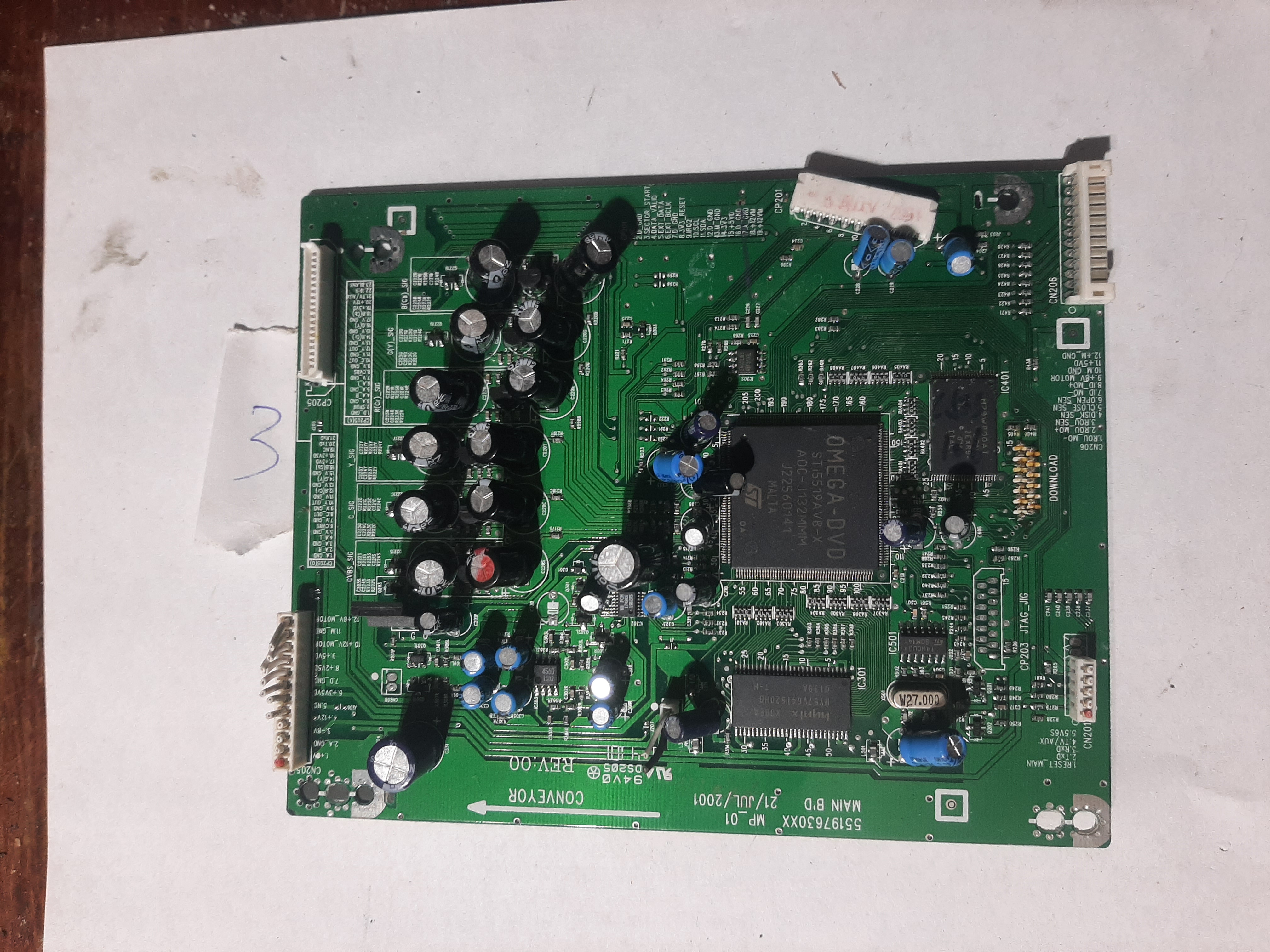

#3 would this qualify for low peripheral or mid grade

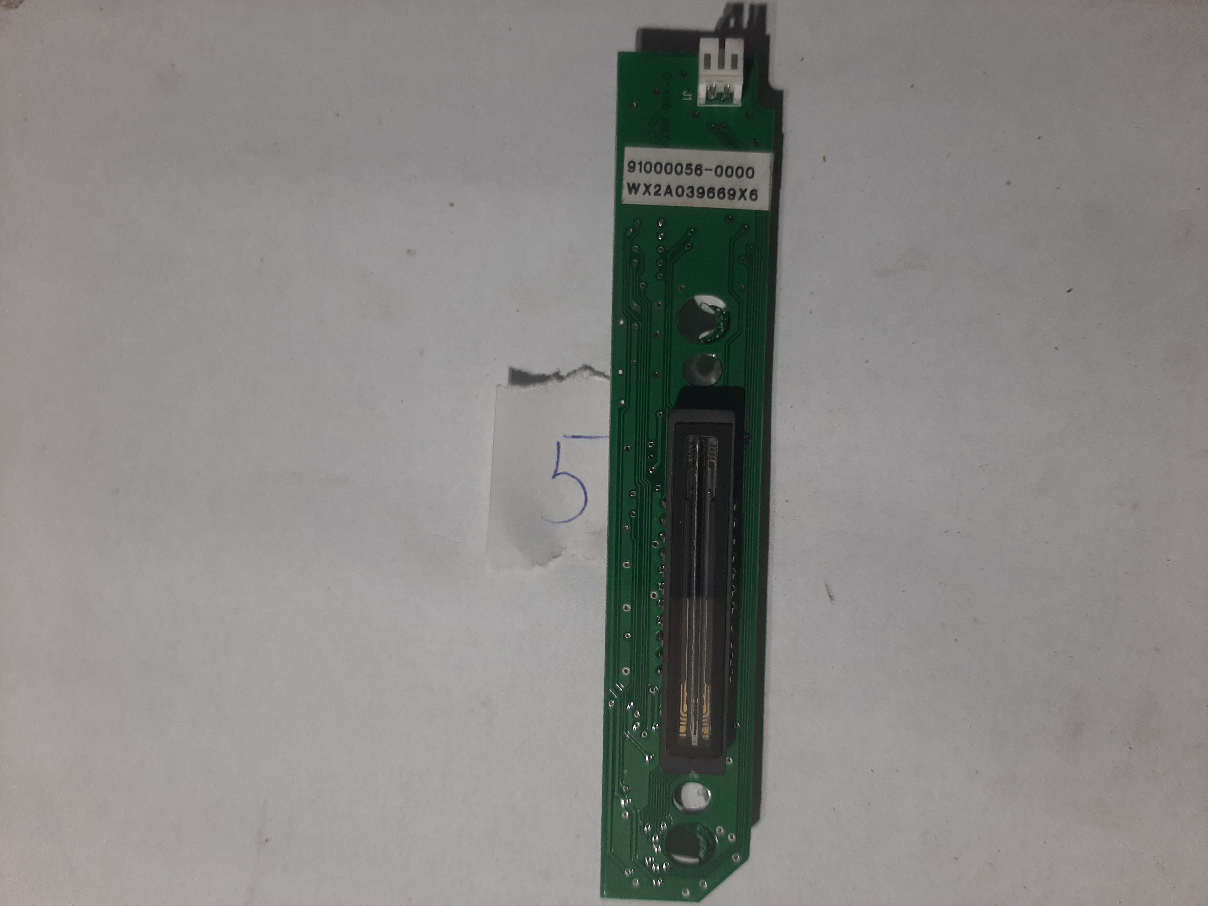

#5 ic looking part has gold inside and on legs.
Thanks for the help

1) No reason to pull the soldered module, high peripheral

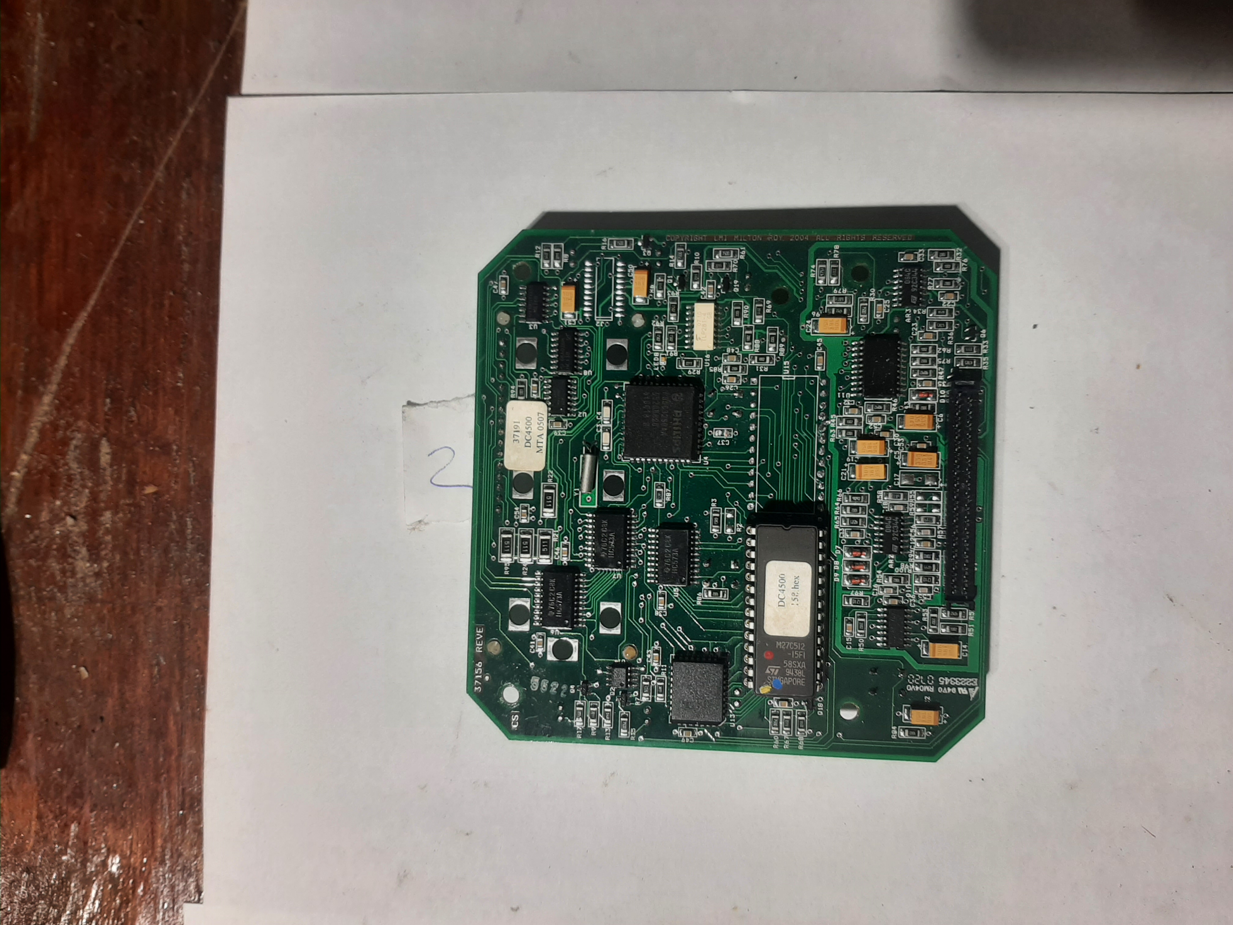

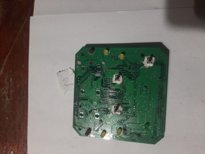

2) High peripheral at least; probably good for low telco but not certain.
3) High peripheral

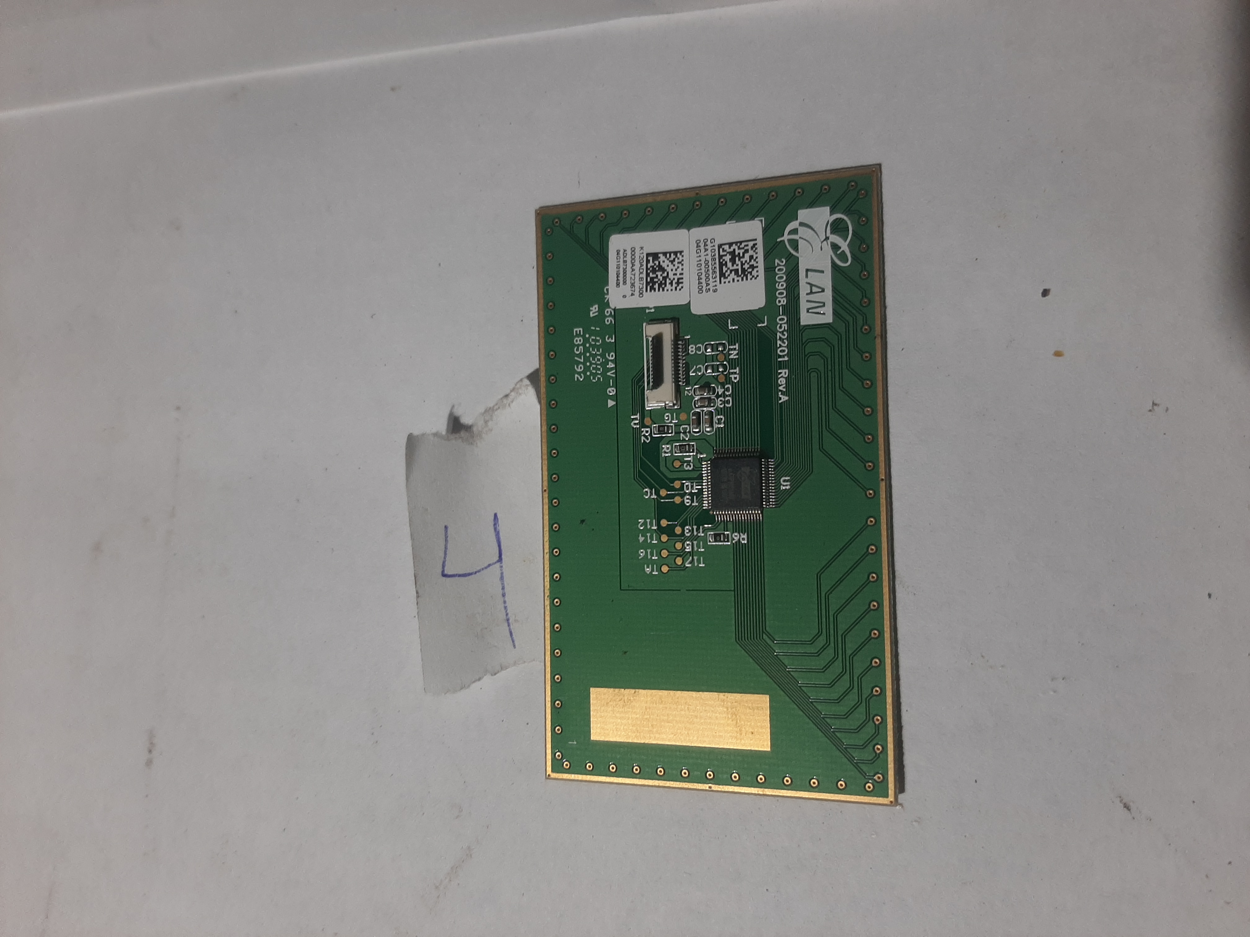

4) Trackpads almost always get high peripheral.
5) Let me see if I can find a post...
Found it. High peripheral. If you're curious this is the reference I was checking on
