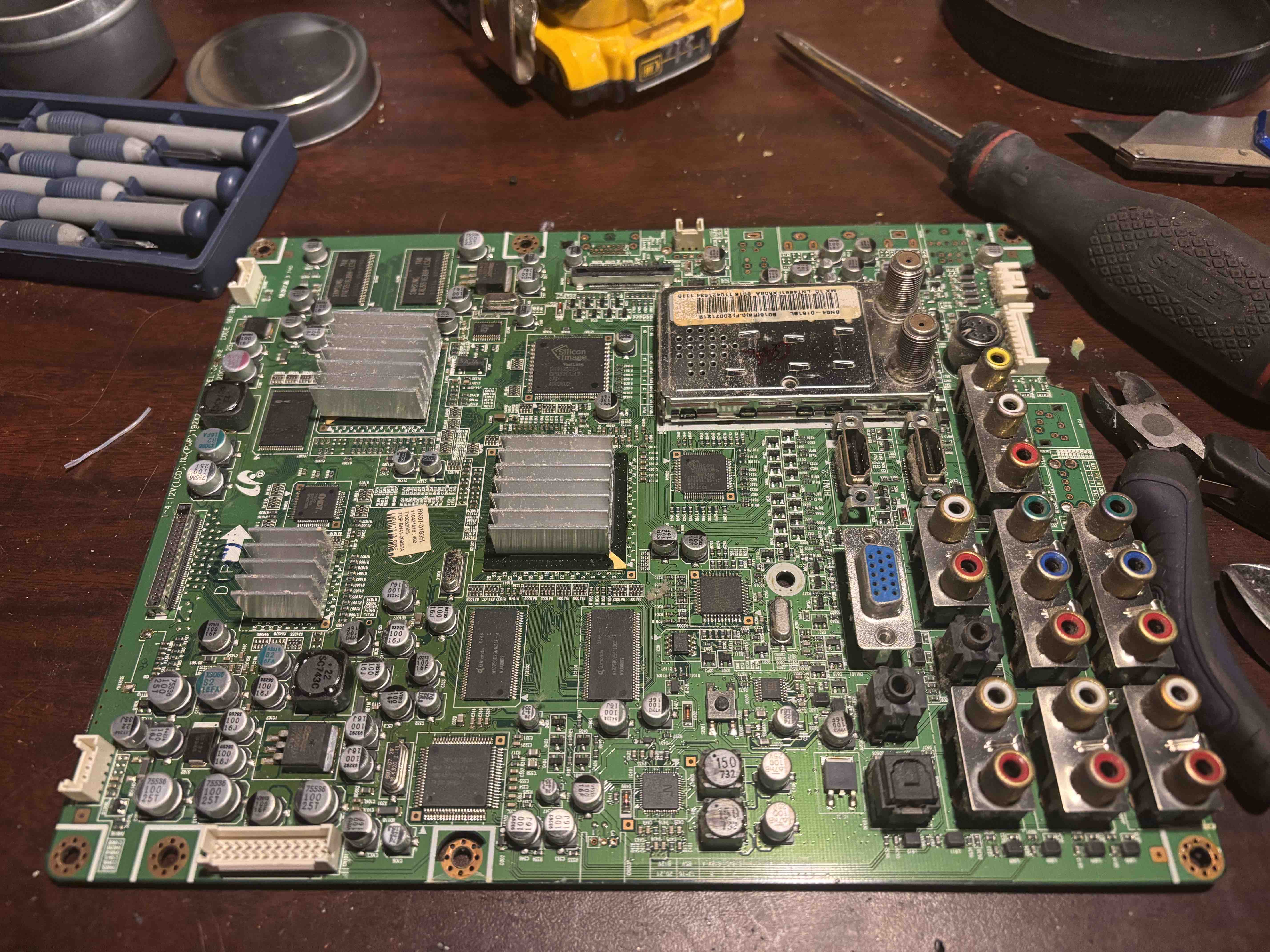

I feel like I am getting the hang of deciding what boards are what but would like to throw them on here to double check myself.
Should I depopulate or leave as is?
What would this one be classified as it is now?
Assuming if I depopulate, it would be low grade at that point?

Boardsorts prices are generally best if you don't depopulate the boards of soldered components. If you have other places to take different components at a better rate locally or are producing enough volume of specific components to sell, it may be worth it to depopulate.
This particular board you should remove the steel shield on the tuner box if you can (that one looks more troublesome) and the aluminum heatsinks. High peripheral will be the category after that.

Thank you
