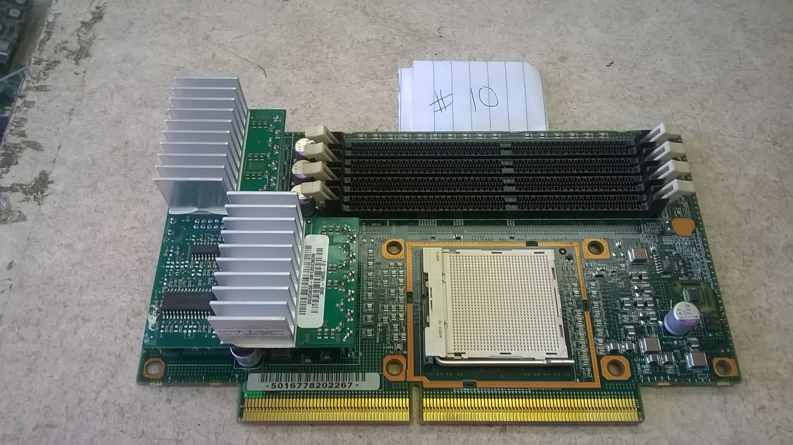

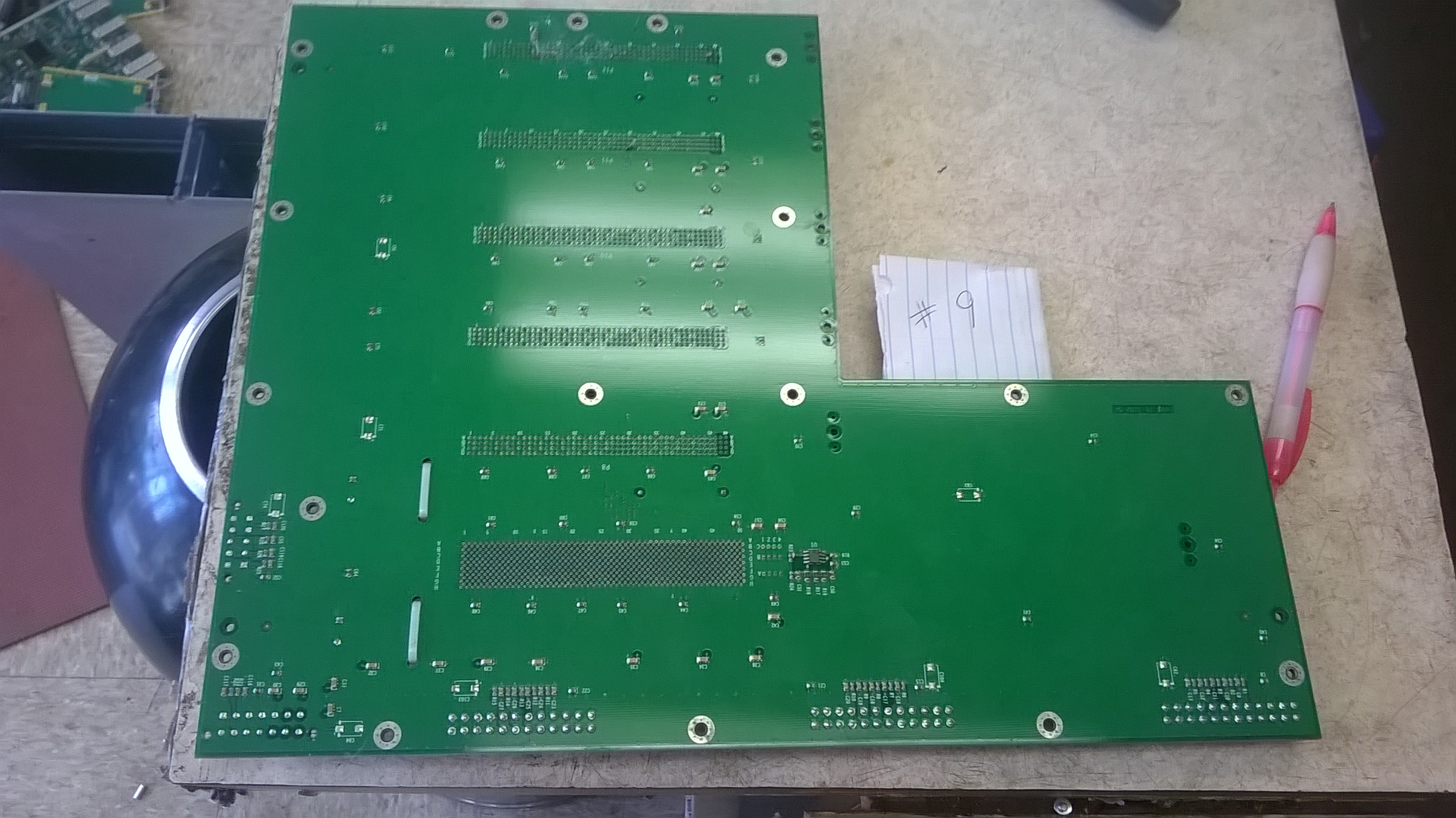

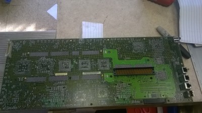

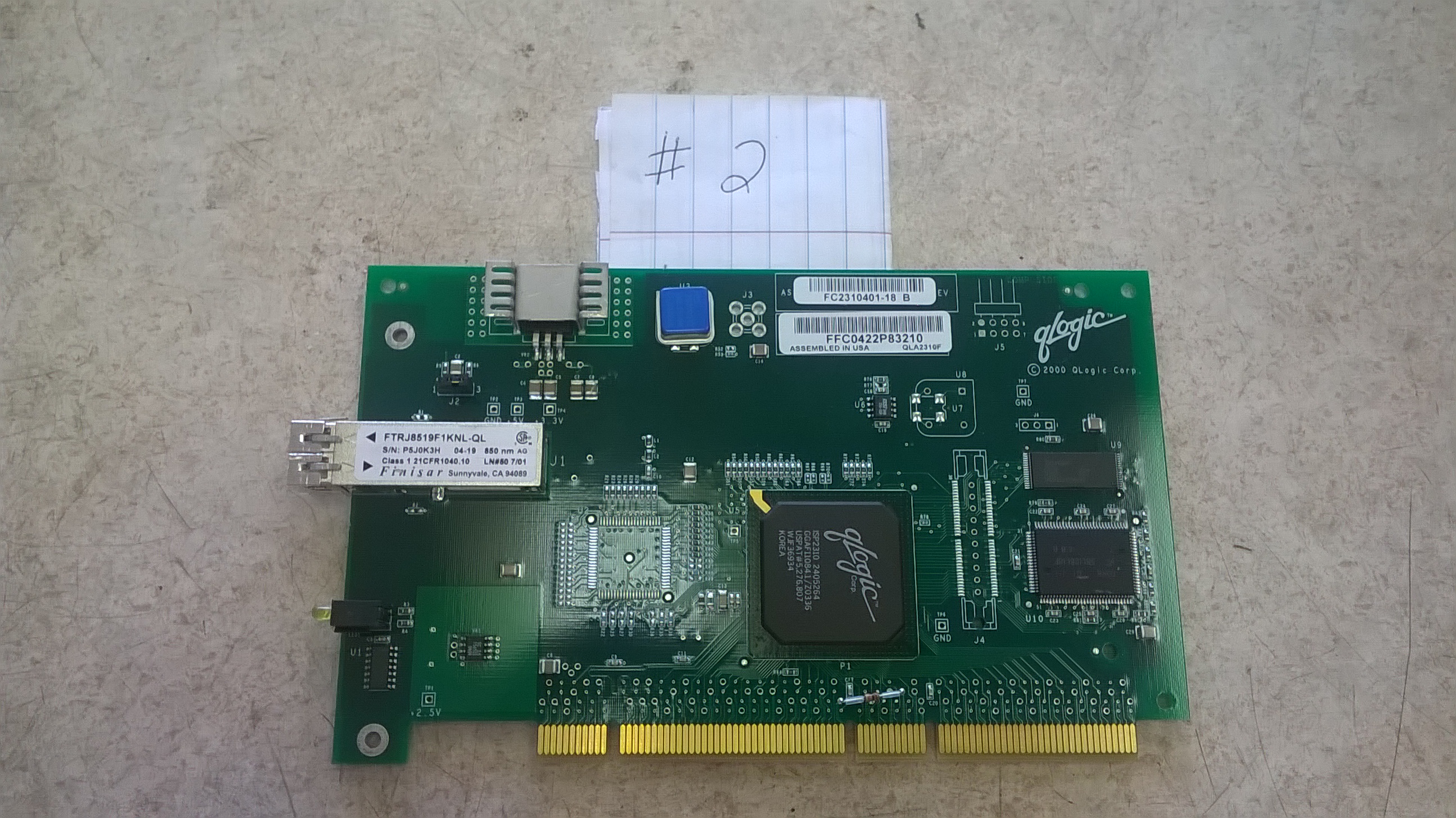

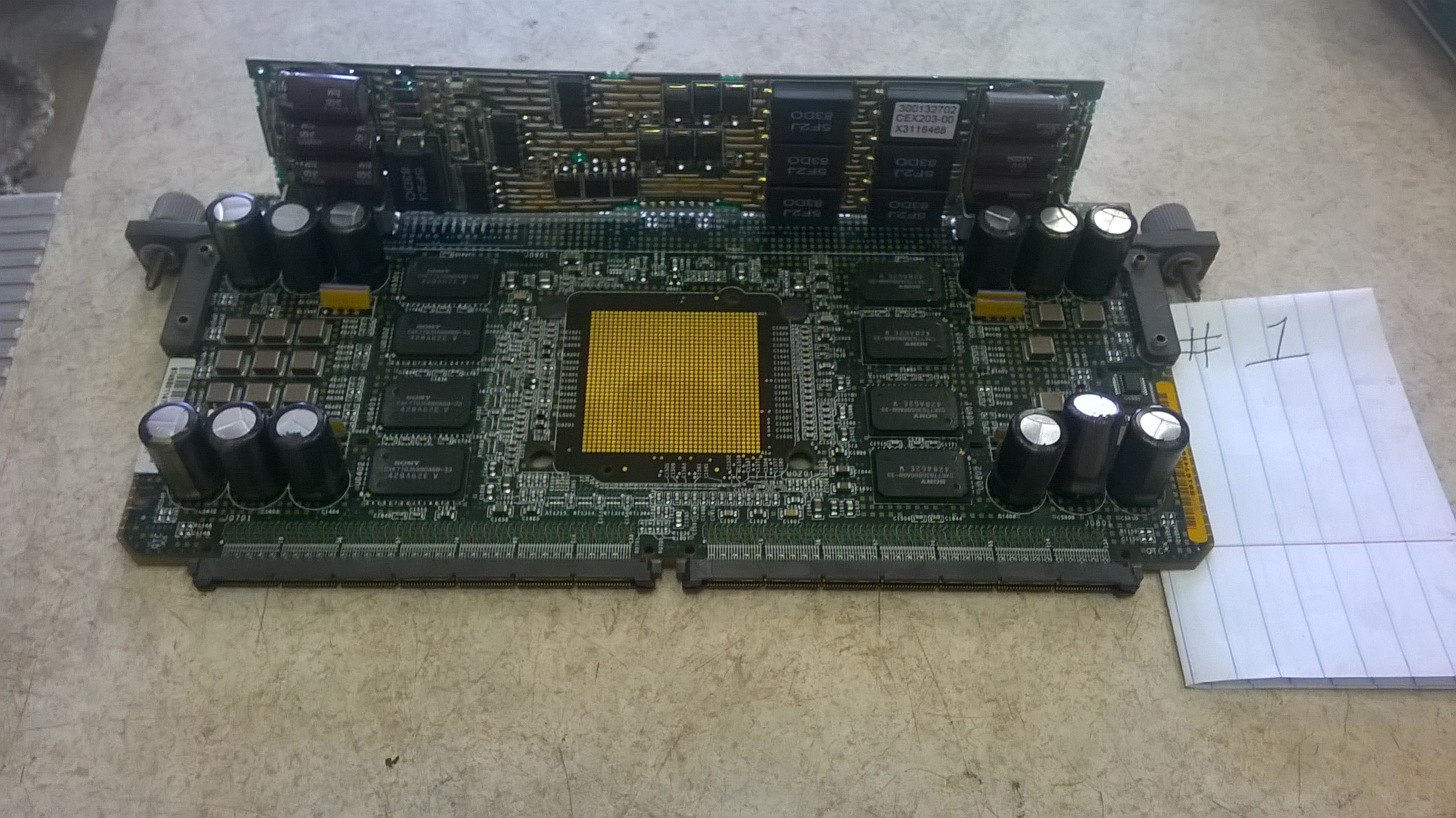

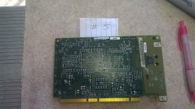

Looking for board I.D. on these boards please and thank you!!!!!

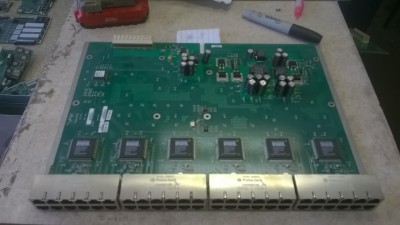

8 not sure. If it was gold flashed it would be telco and if copper or not flashed peripheral. Thia is silver or nickel so...?

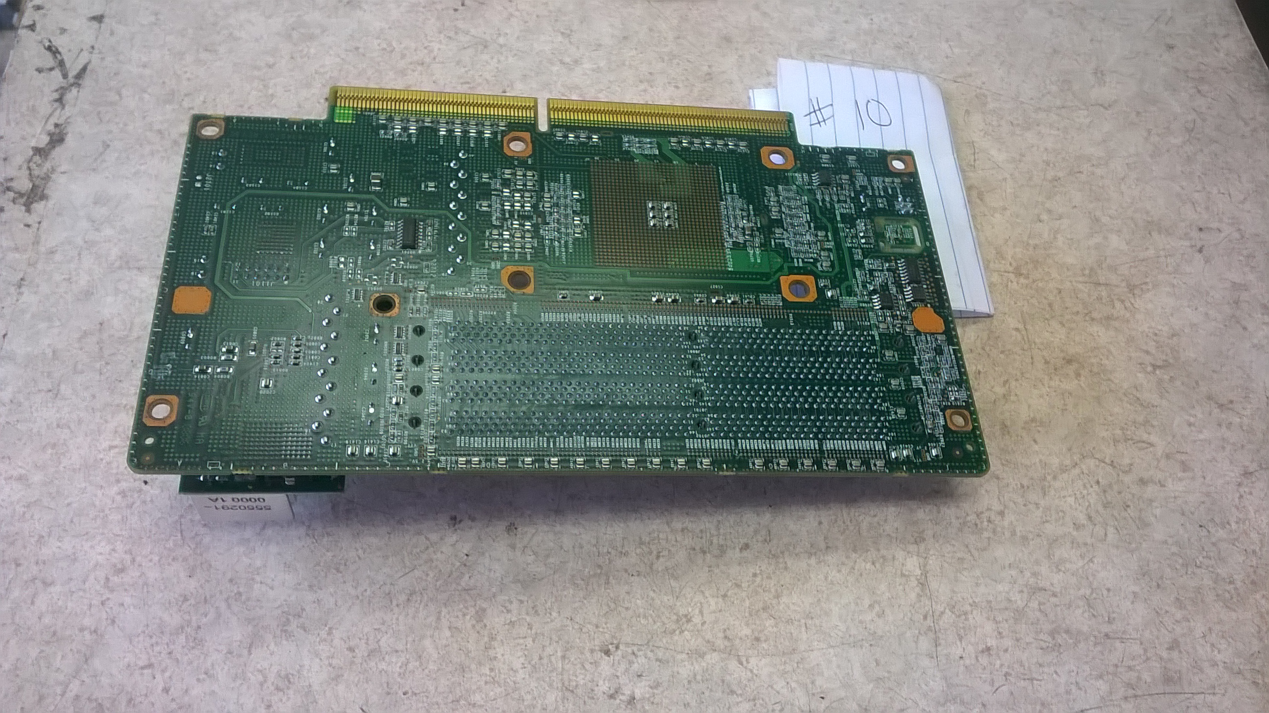

10 remove heatsinks. Green fiber with metal (cpu riser like mac sun etc)
9 backplane. To be telco you need gold flashing. Still heavy though.

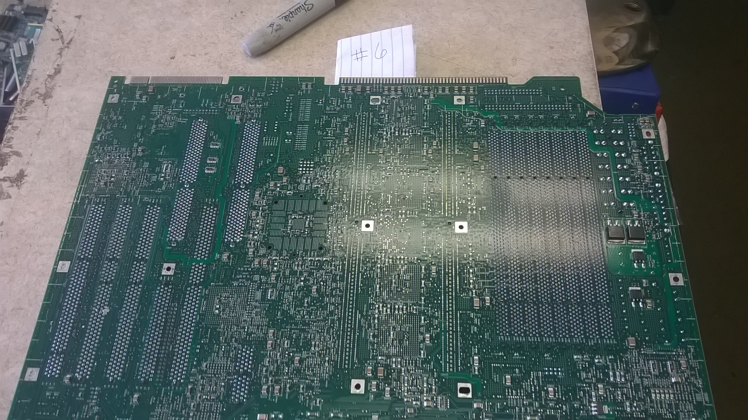

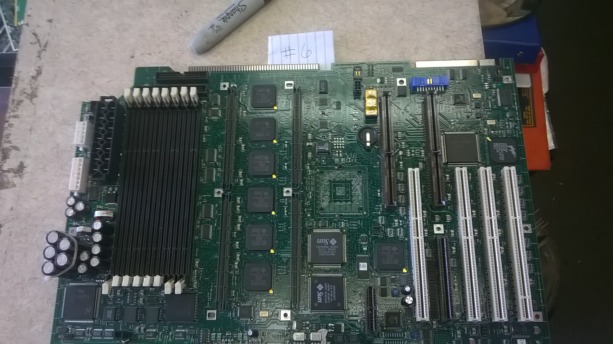

6 multi small socket OR standard large (old motherboards without sockets) Depends on who does it. . They've gone both ways for me.
5 finger card

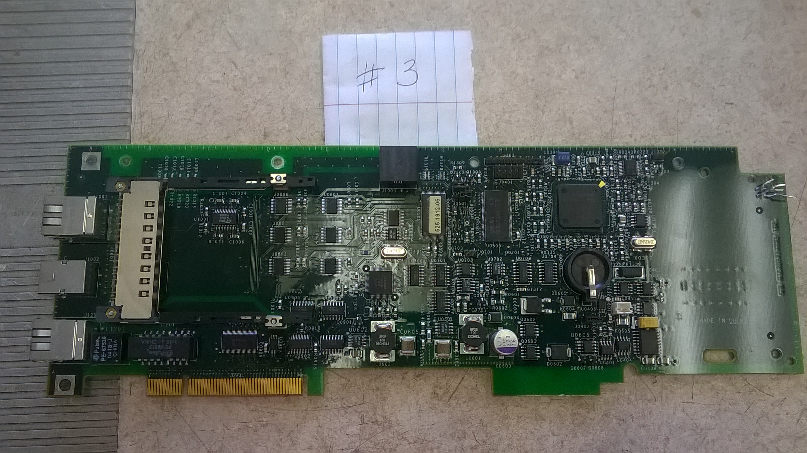

3 pushing the limits but it's finger card

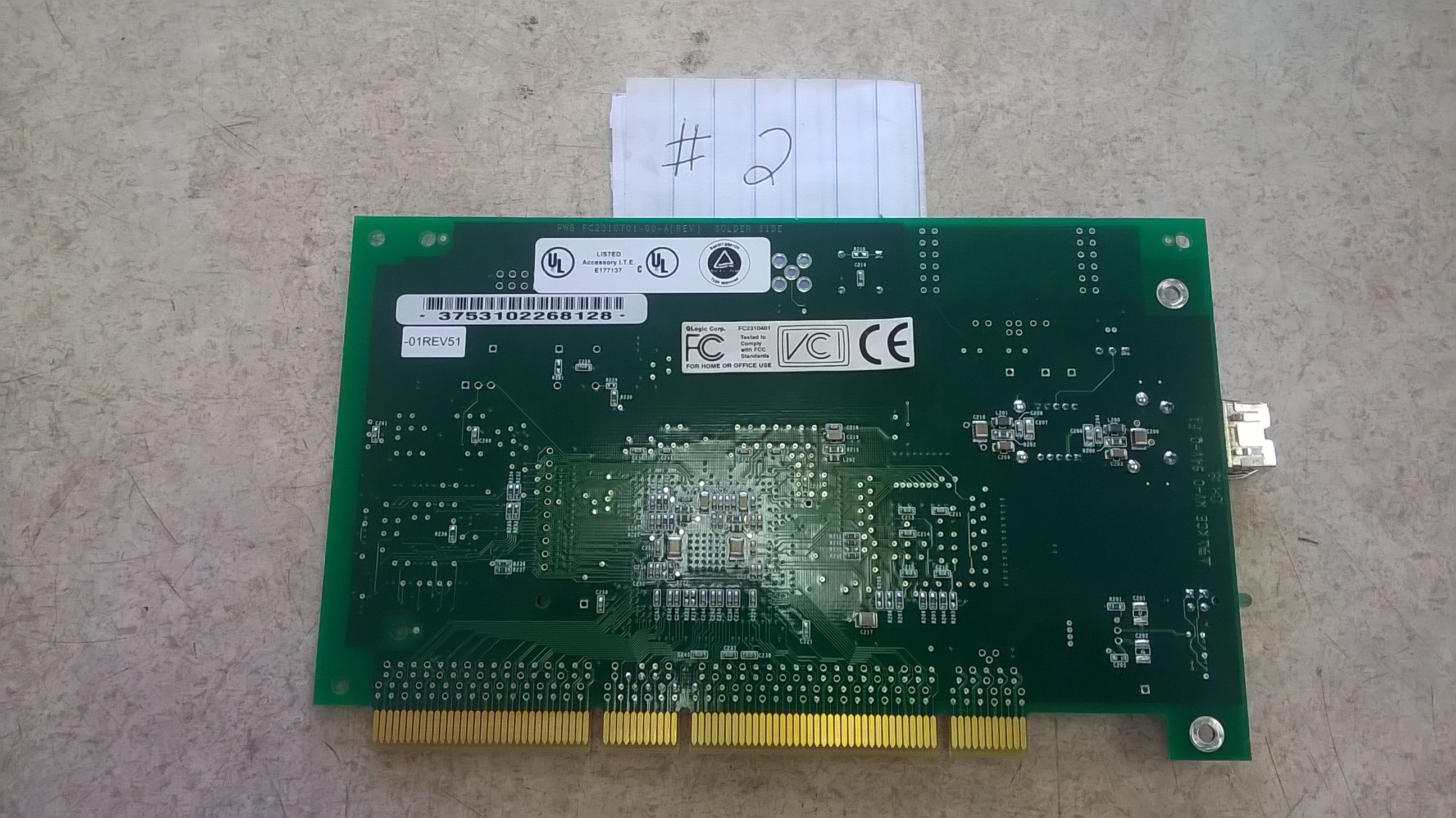

2 finger card
1 fairly sure large socket motherboard
