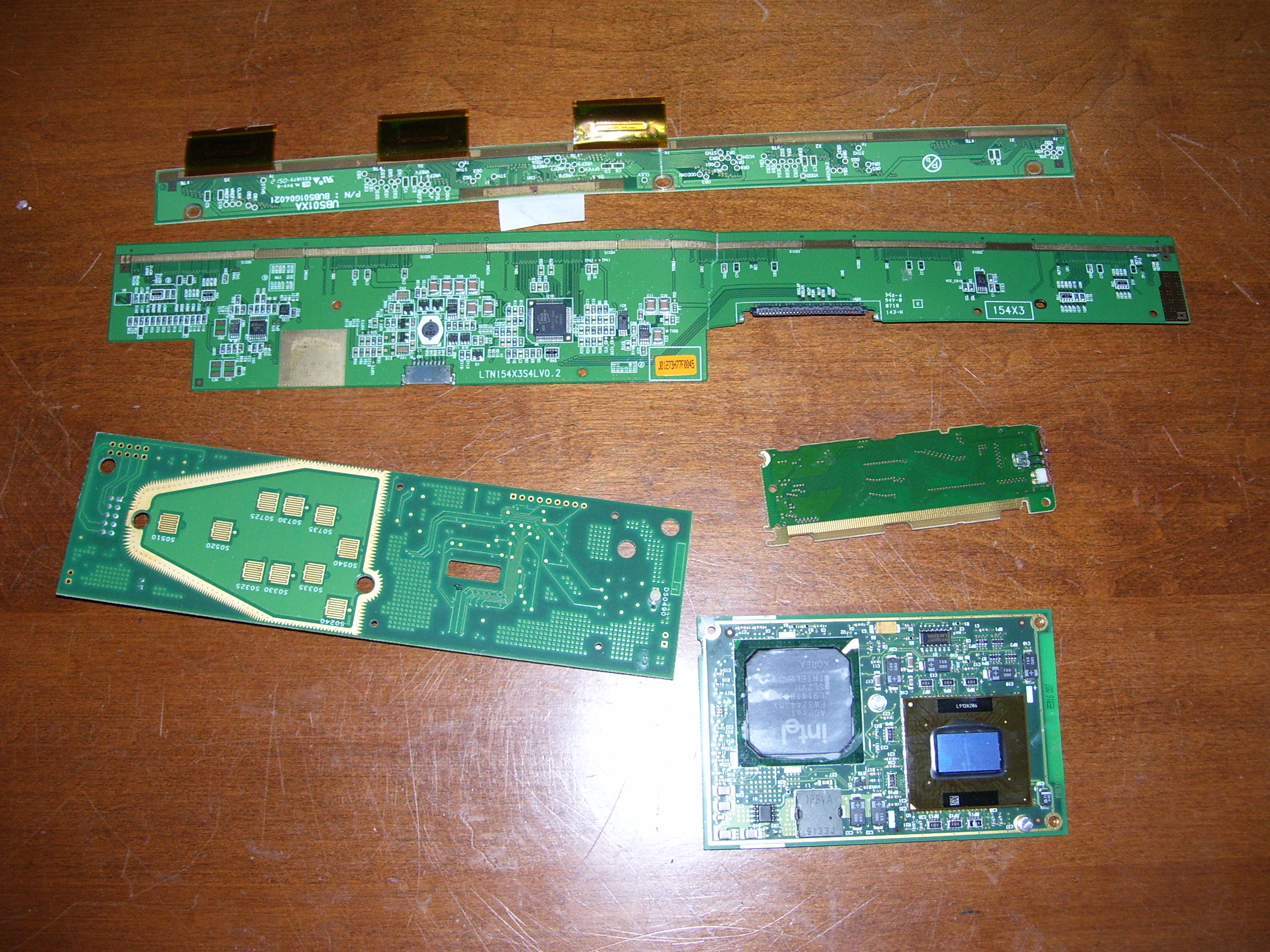

I have these boards but aren't sure what they would go as because they don't have gold fingers but does look like gold on the boards...

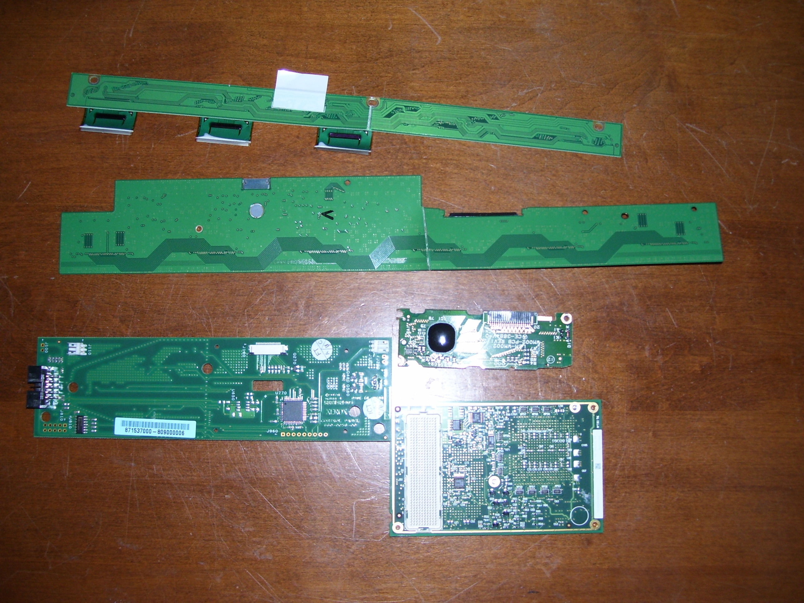

The square board looks like it has a gold connector with gold pins on the back (The white area).
Any help would be great. Thanks!!!

those are kinda tricky im not 100% but......
i believe the large bottom 2 are going to be peripheral.
the little 1 at the bottom could also be that..[or perhaps gold-finger card]
as for your top 2 they are going to be mid-grade or better if that is gold plate then i could see them going for peripheral grade as well..
perhaps one of the others will be able to to give you a more clear grade..

The bottom right card is a laptop cpu card. If I remember correctly they buy them as green fiber metal top cpu's.

I believe I saw flat panel boards similar to the top 2 designated as peripheral on an earlier question, some time ago...

All would be considered peripheral except for the laptop CPU card, which is green fiber with metal. Check current pricing to find the value of these cards.
