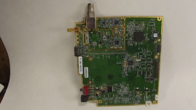

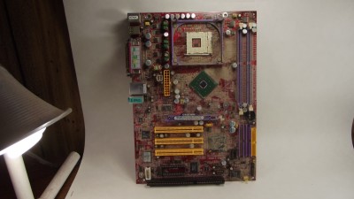

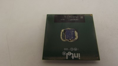

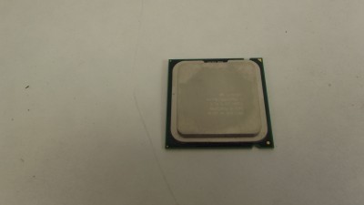

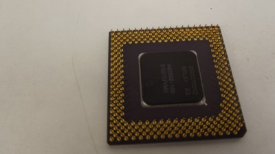

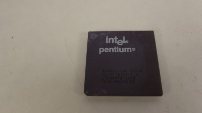

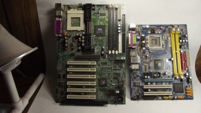

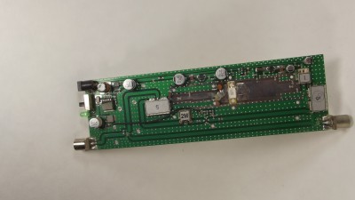

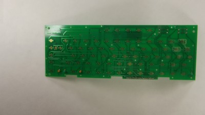

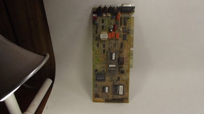

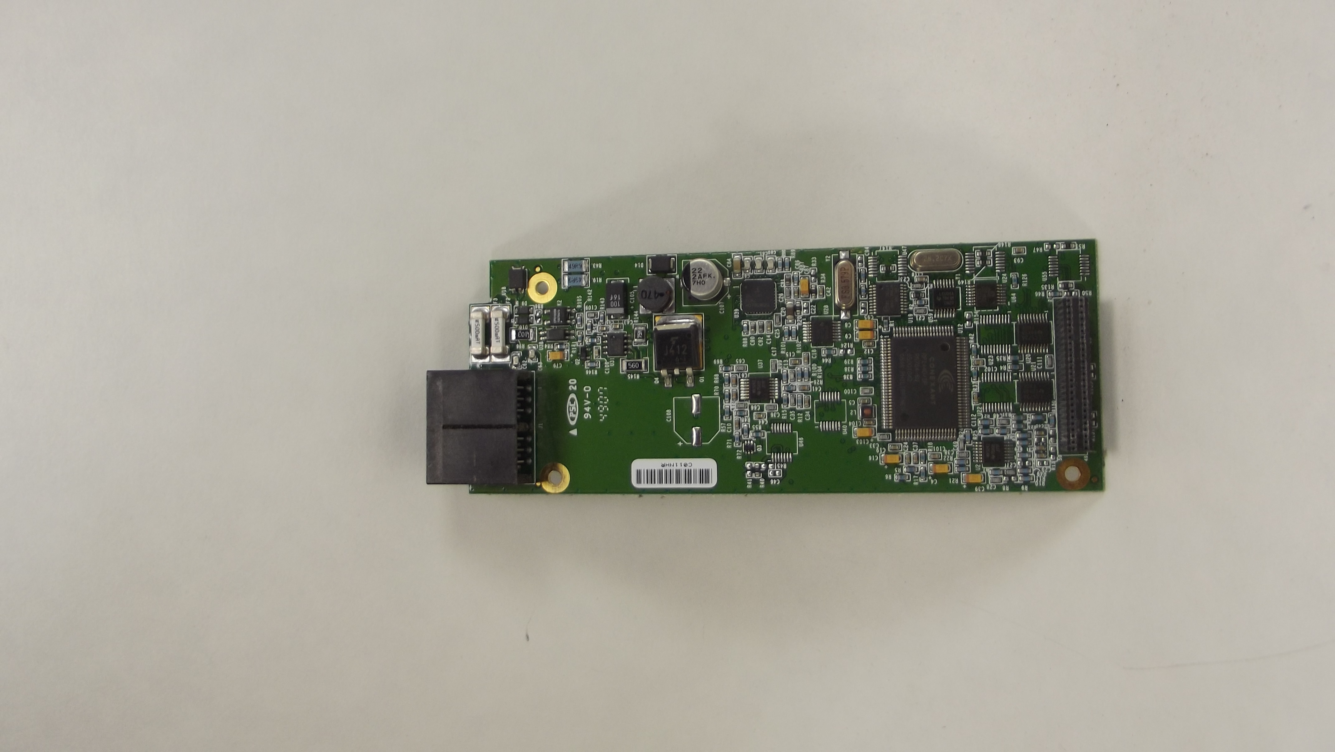

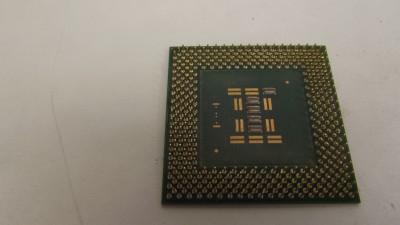

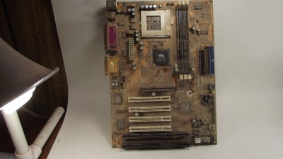

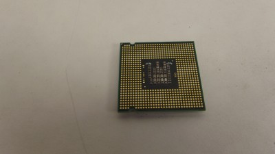

HI this will be my first of many loads of old generation electronics comming out of the oilfield. I am confident in sorting gold memory, gold finger boards, and logic boards and nothing else. Any help you can offer on this other pictured below will be greatly appreciate.

processor 3: green fiber with no metal
processor 2: no pin
processor 1: Pentium ceramic
motherboard 3: large socket
motherboard 2: small socket
motherboard 1: large socket (left), small socket (right)
#5: finger card
#6: peripheral
#8: peripheral
Can you post photos of the back sides of #7 and #9 please so we can more accurately determine what they are?
PostPosted: Thu May 01, 2014 3:36 pm
Posts: 378
I agree with kgryczan on all of those. Looks like 7 and 9 are mid-grade to me.
