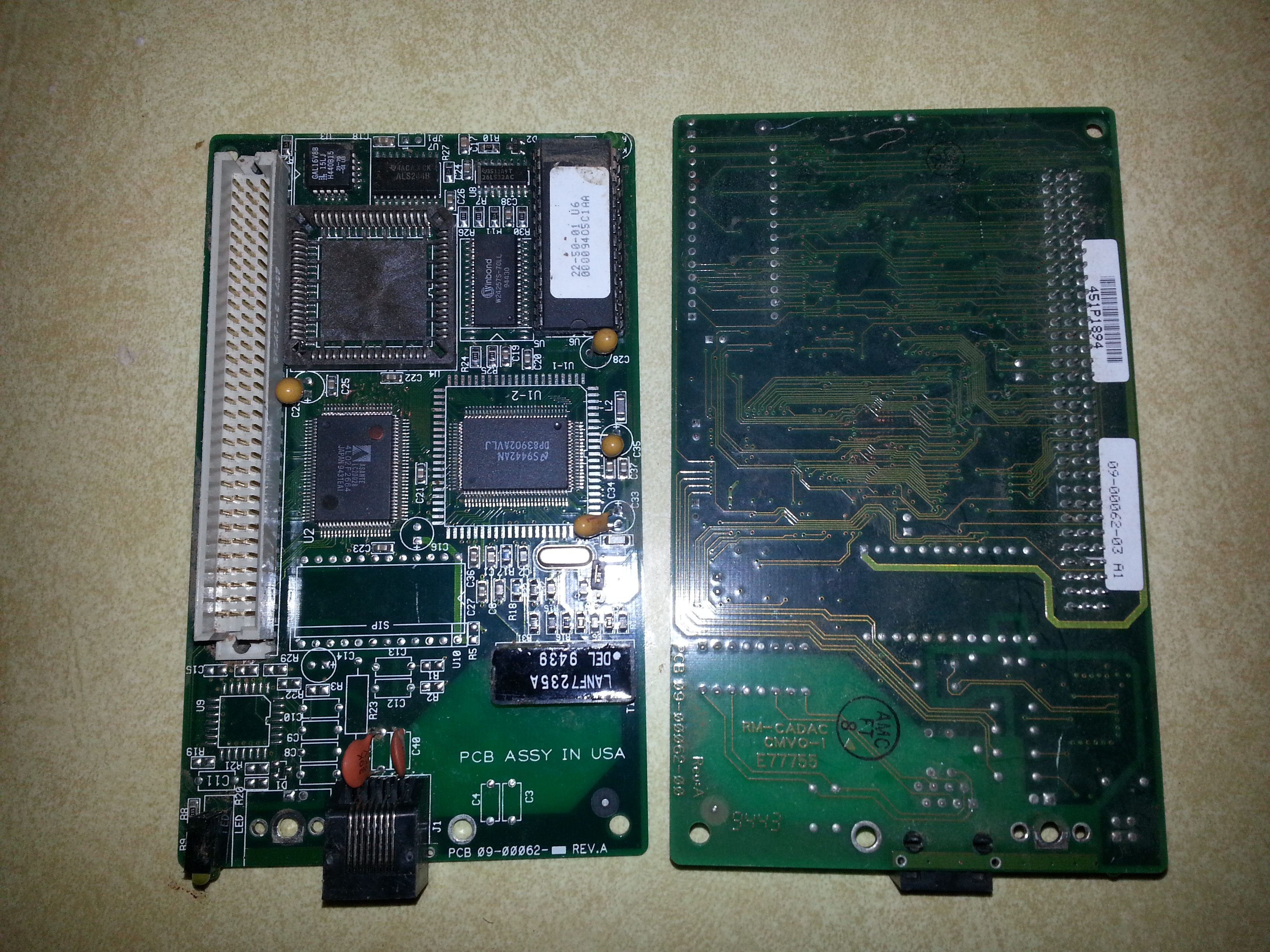

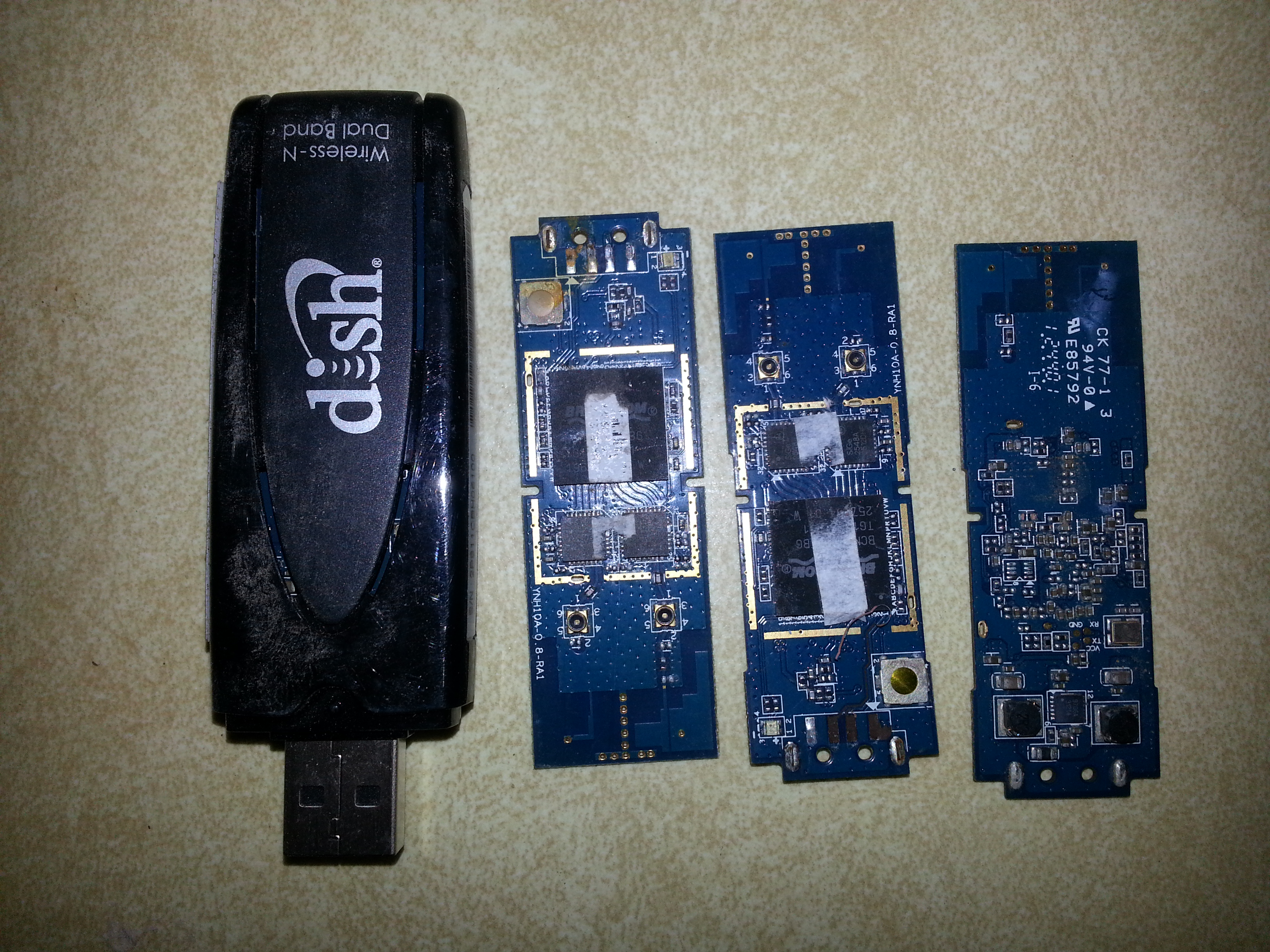

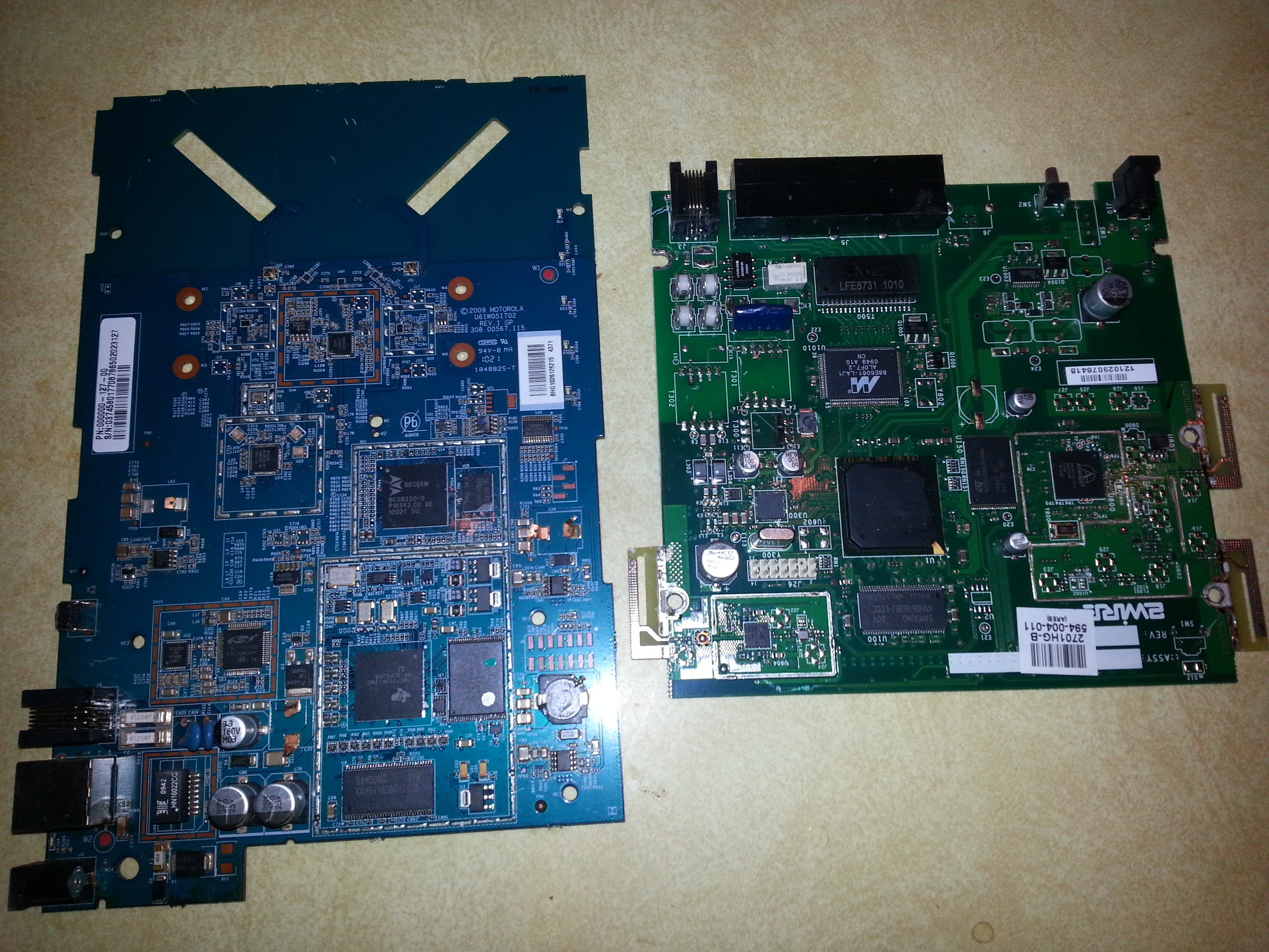

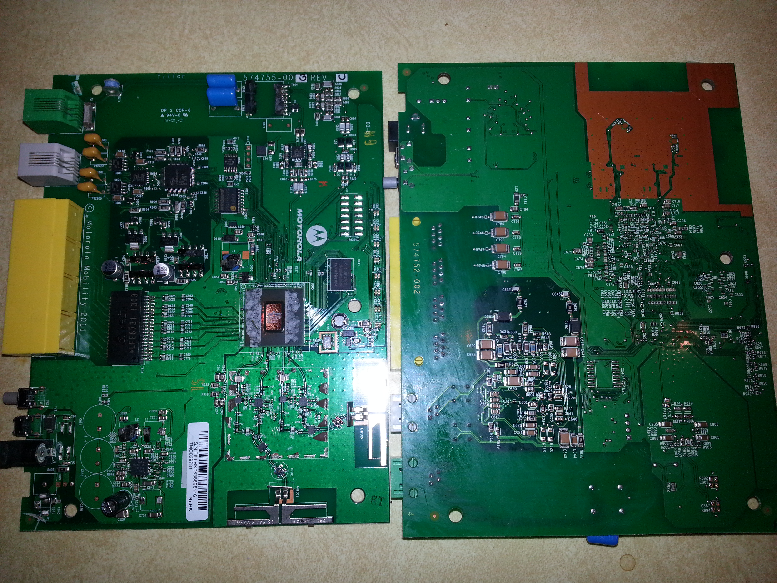

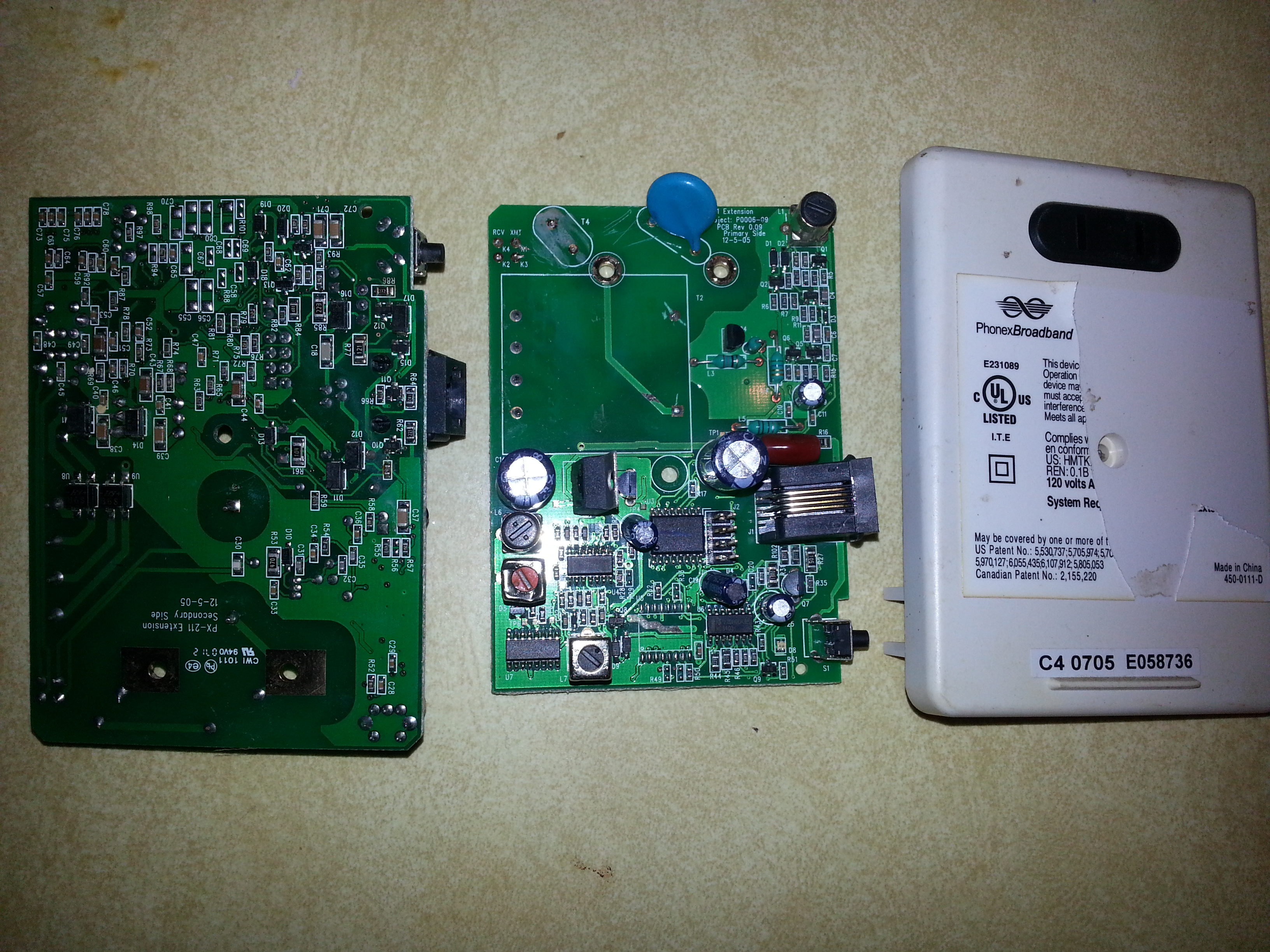

Can any of these boards from various modems go as telecom? Pic 1 old LAN card front and back from P1 computer. Pic 2 plug in broad band board. Pic 3 USB wifi cards. Pic 4 Clear wifi modem and ATT Modem Board. Pic 5 ATT Modem boards. Does anything need to be removed?

The P1 looks like telecom but best to wait for a confirmation from boardsort on that. All the rest are definitely peripheral.
I agree with metalmanjason. P1 will be telecom, the rest are Peripheral grade.
