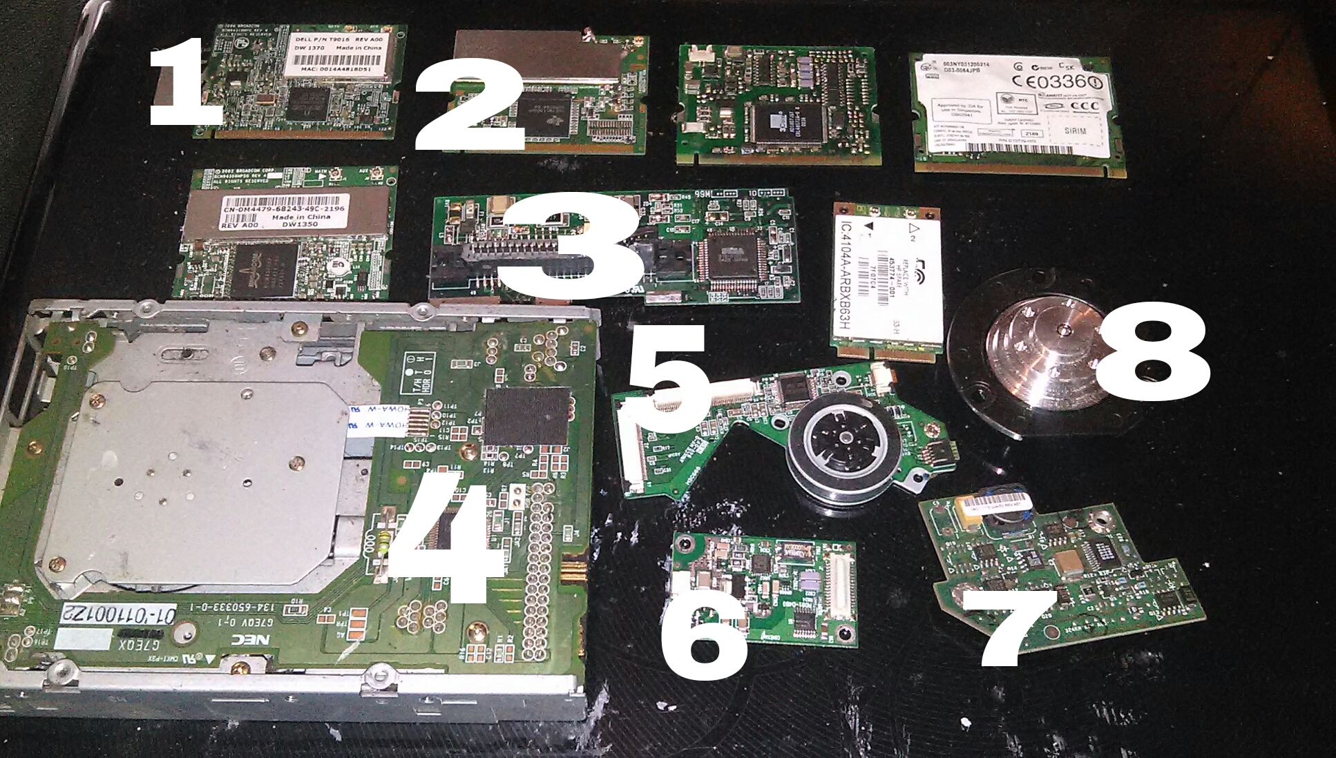

IFIGURED I WOULD PUT #1 IN THE GOLD FINGER CARD CATEGORIE.

First row finger cards
Second row l2r
Peripheral, peripheral, finger card
#4 hard drive. If you remove the board You'll get hard drive without board and a hard drive board.
5-7 peripheral
8 see below. Boardsort doesn't buy them.
If you scrap the drive further Boardsort buys the platters
The pin box goes in your gold connectors
Wire is mixed wire.
Rest sell to a yard.
permalloy (what the magnets attach to, goes in the $1/lbs range with magnet and $6 range clean
Aluminium shell cbm 40-60c
aluminium case is aluminium #1 @40-75c
Heads usually get #1 al or #2 at worst
Screws are 302, 304, or 308 stainless

Ohkay just looked up the part number on #4. Its a floppy drive!?
Board is peripheral
Yard
If you split it open pull (unscrew) the unit from the shell. Should get #1 al for the shell and cbm for the entire unit - board and case

#5 you needs to processed a bit. That board even if it is peripheral is attached to a metal plate. The board or fiber is very thin that most likely it will brake and you will have to sell it as mid-grade or low grade. Don't ship as it is because you will get low grade most likely since it has a big motor on it. You can use a utility knife to remove the board.

Thanks for the info number 4 is a floppy drive. and i also stuck a magnet to the floppy drive and it didnt stick. And im gonna remove those harddrive screws from my brass screw pile since you mentioned that they are stainless steel i thought the screws were brass since they didnt stick to a magnet

yeah its stuck on there with no screws im gonna need something flat to pop that out the board is very thin
