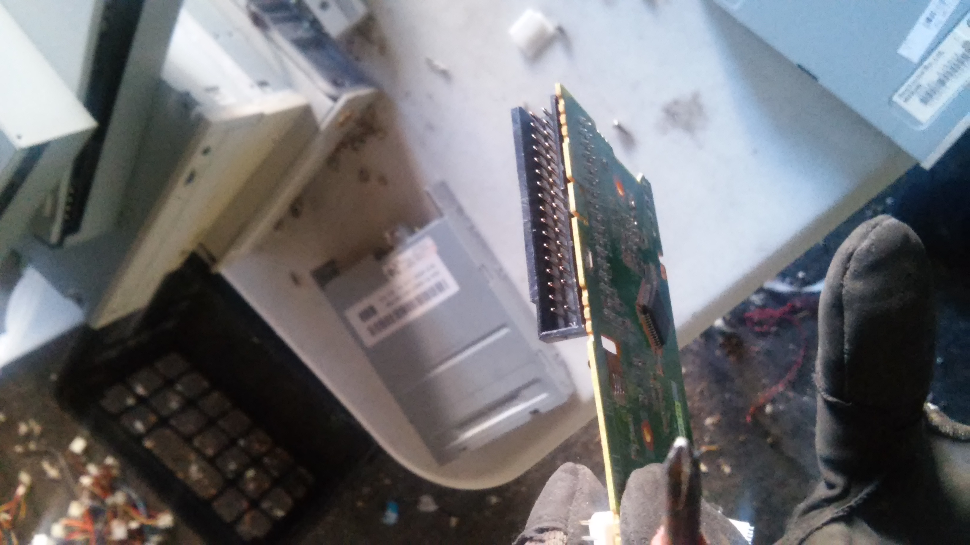

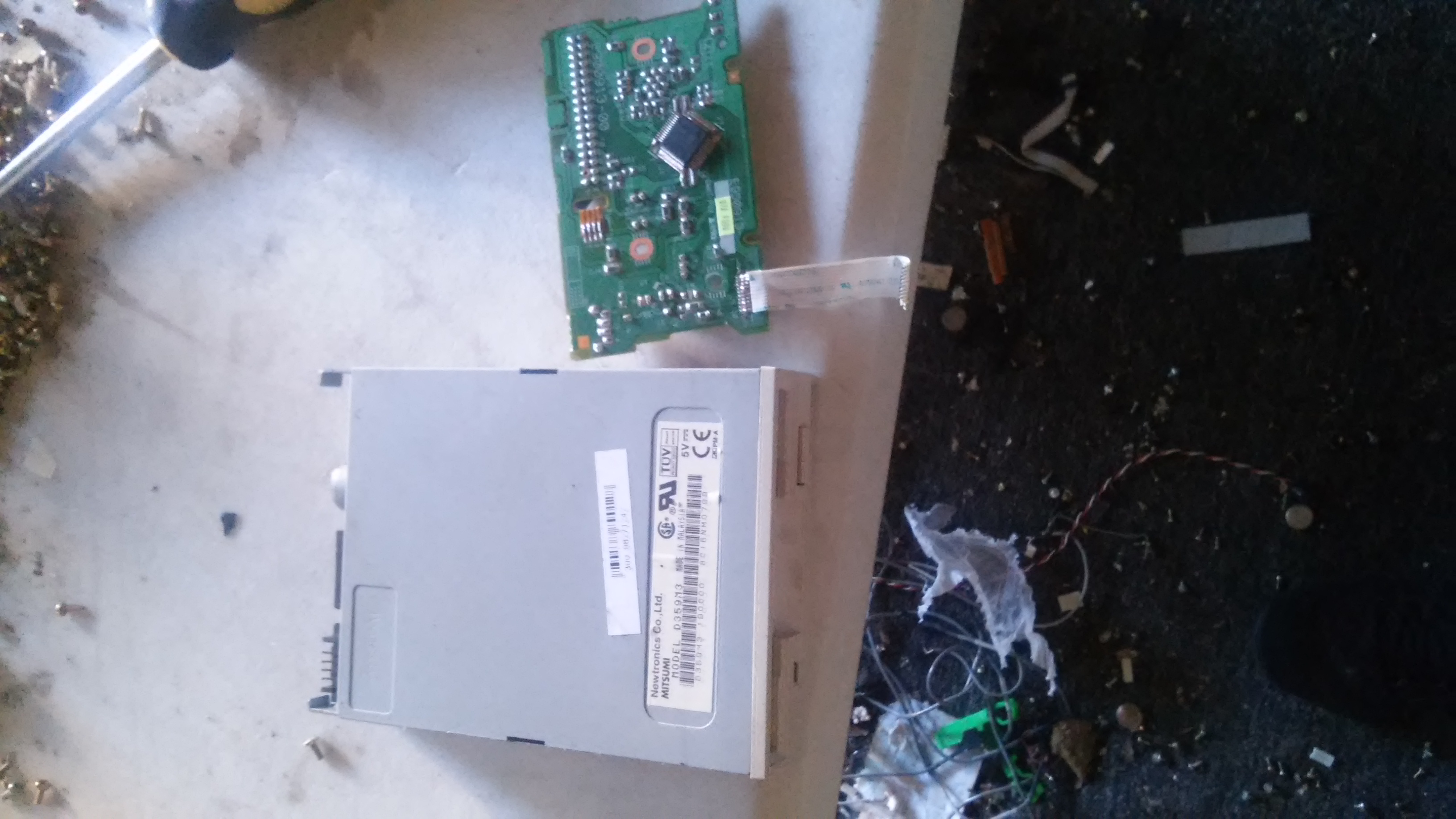

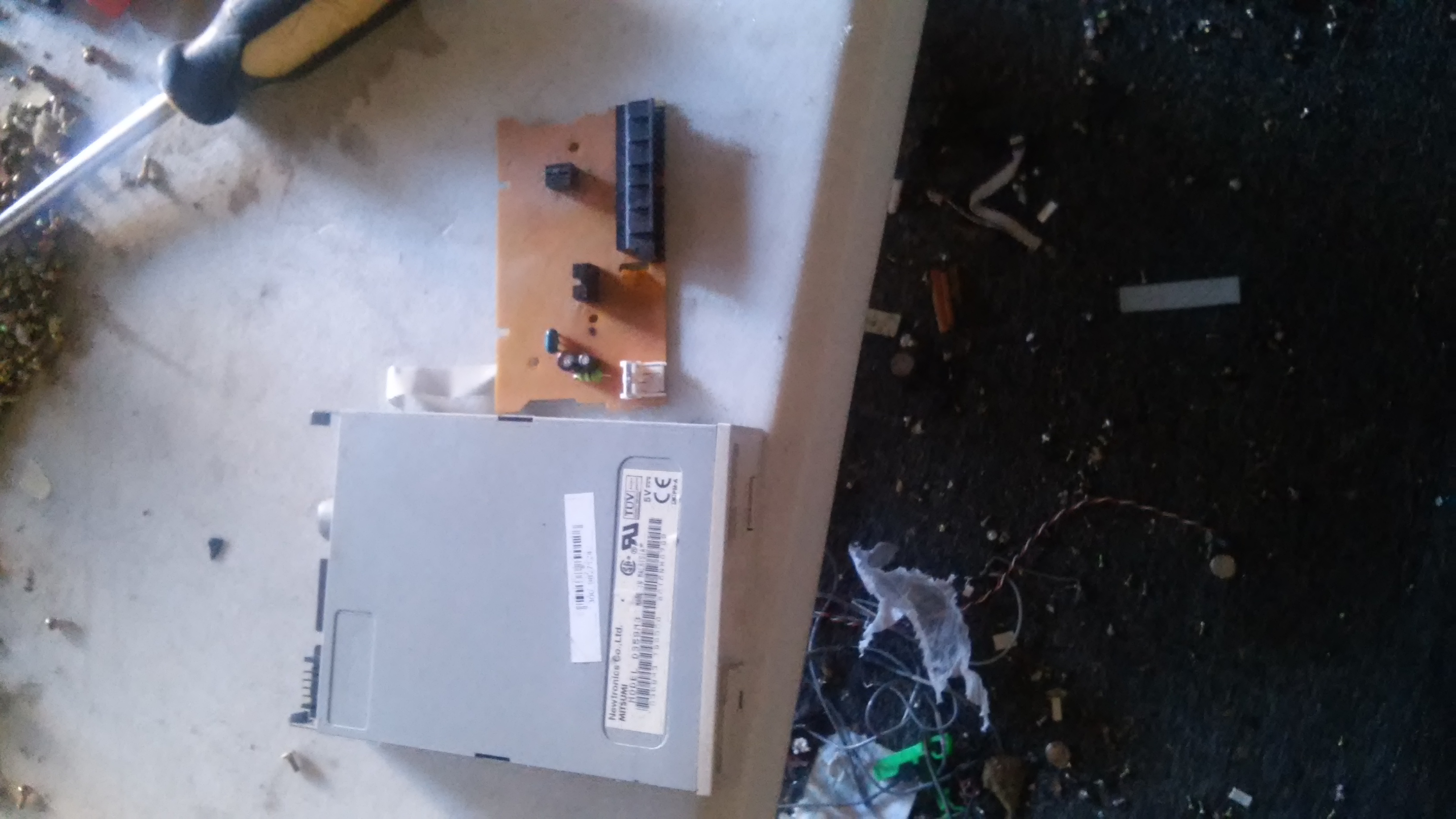

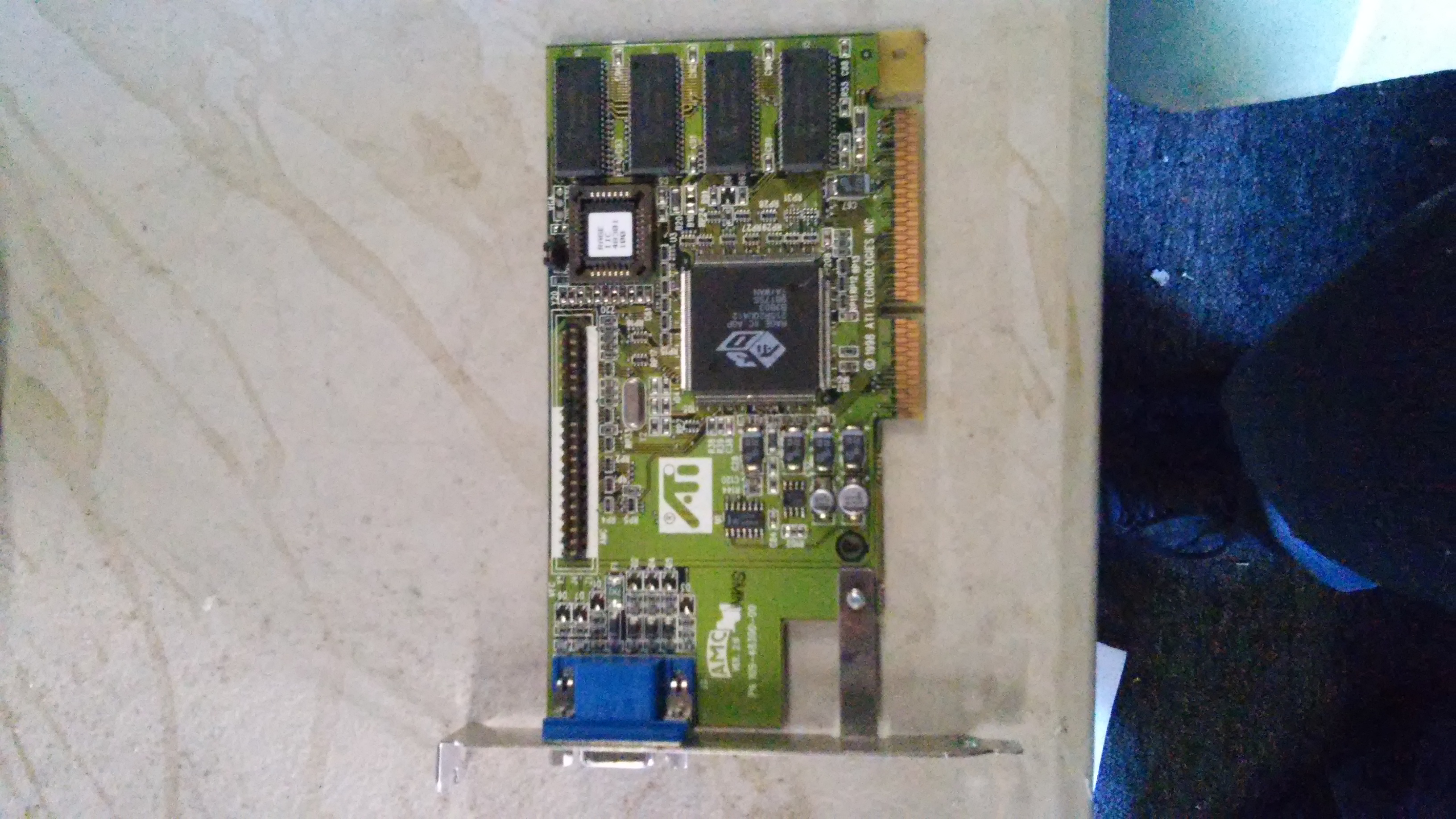

Does board sort take the cd roms without the board. If so what category? Wondering about the board below it has gold pins where do I put those? the last picture just making sure its a finger card.

CD rom/disk drives are taken as scrap shred steel if they do not have the board on them... if you want to make the most money, disassemble them and sort the metals and take them to your local scrap yard.
If you live close enough to boardsort, you can bring the drives with the boards and make money. If you are shipping things in, it is probably going to be cheaper to just send the boards... shipping the extra weight of the drives is going to cost you more in shipping than what you will get from boardsort.

The floppy board is peripheral. 99% f floppy disk boards go in that class.
The vga card is finger card
