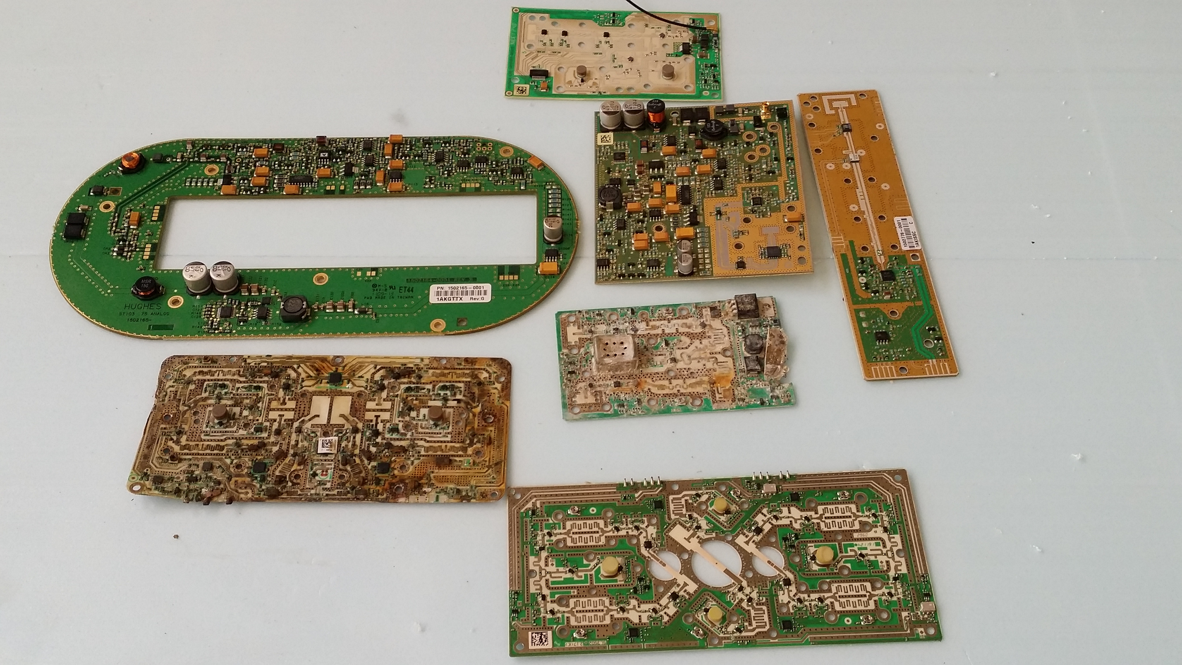

I took these out of satalite dishes the board on top is heavily coated in a white metal. Looks like silver to me. The two to the side of the Oval one is heavily coated in gold. The bottom boards seem to have a good amount of gold but not as high quality as the boards next to the oval. Any grading or advice would be appreciated. Thanks

The round one low telco
Directly t the right and directly below it: high telco
The rest peripheral.
In consumer and business level boards for satellite equipment you will often find a nickel-tin or silveride (a silver alloy). Still of value but not the level of clean silver.

Wow, im glad i saw this one. If i had these boards, i would have safely assumed the round board was periph and the rest were below periph. And i dont even bother shipping in any boards below periph due to the shipping costs.
I need to start taking pics and posting on here a lot. Im sure i throw many good boards into my light iron scrap yard pile.

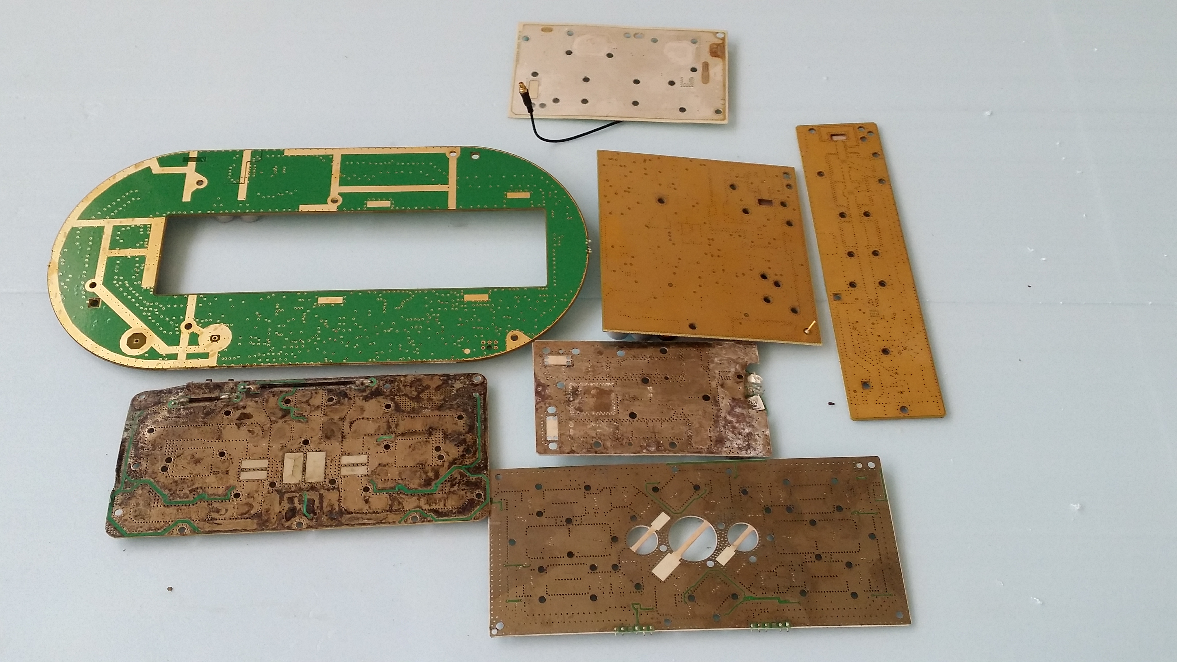

The ones I marked out are sandwich boards. They’re layered with a full size piece of very thin layers of gold and copper.
