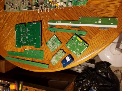

I am looking to see how the attached pictures would be graded - my guess is that most of these would be peripheral. Wasn't sure if any were telecom. I was planning on removing all of the gold socketed chips; NOT removing any soldered pin flatpacks (I believe that takes down value?). I have quite an inventory, each of the items in the pictures i have at least 20x of each, some more some less. Any help would be appreciated.
Photos listed have front first, then back picture of the PCB. I am pretty sure the last images i have some gold finger cards.

Trying to sort this out;
1st Picture
1-Periph
2-Not sure
3-Periph
4-Periph? or Low Grade Board?
5-Periph
6-Periph
7-Periph
8-Periph

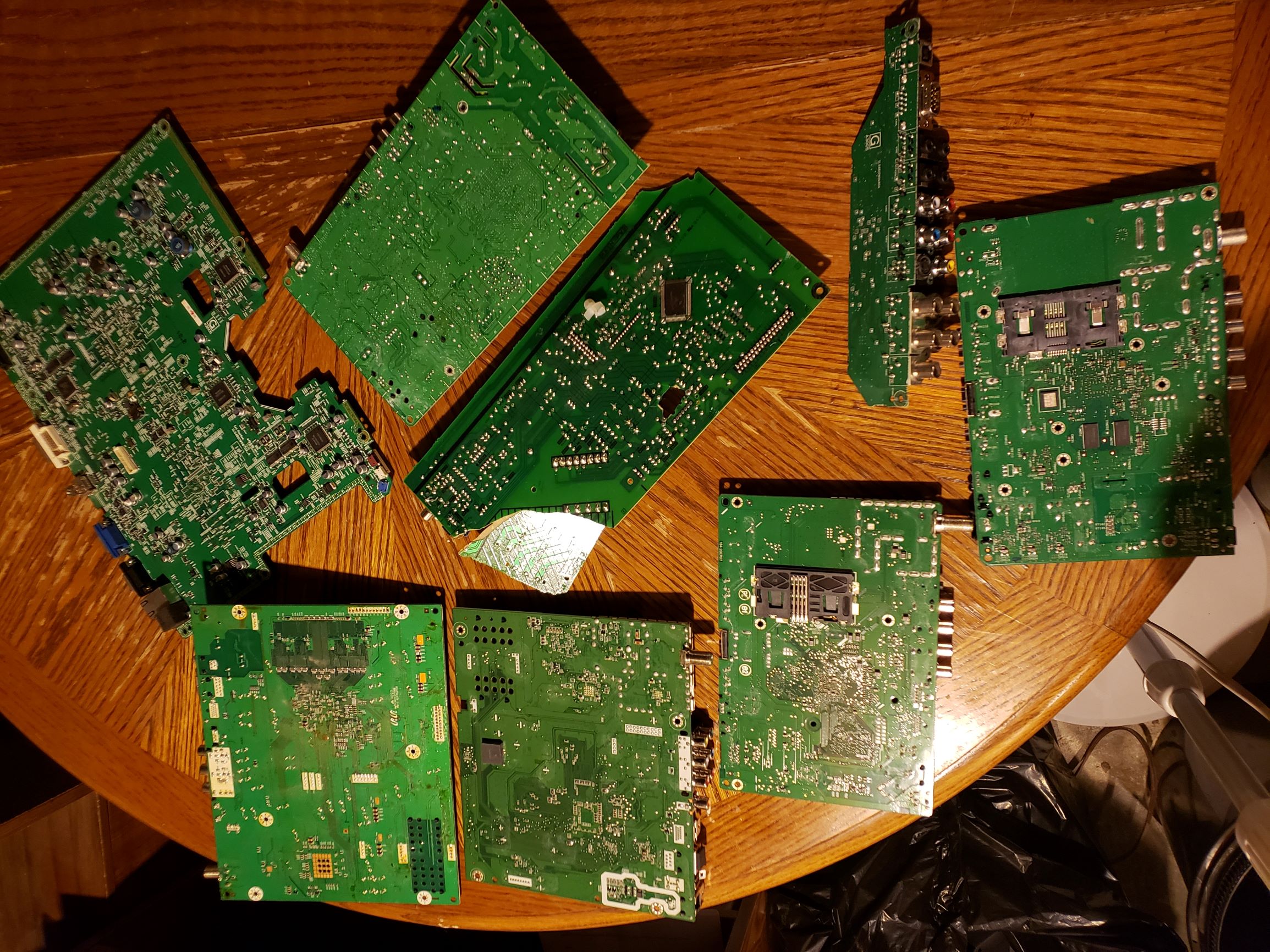

2nd Picture
All are tough - not sure

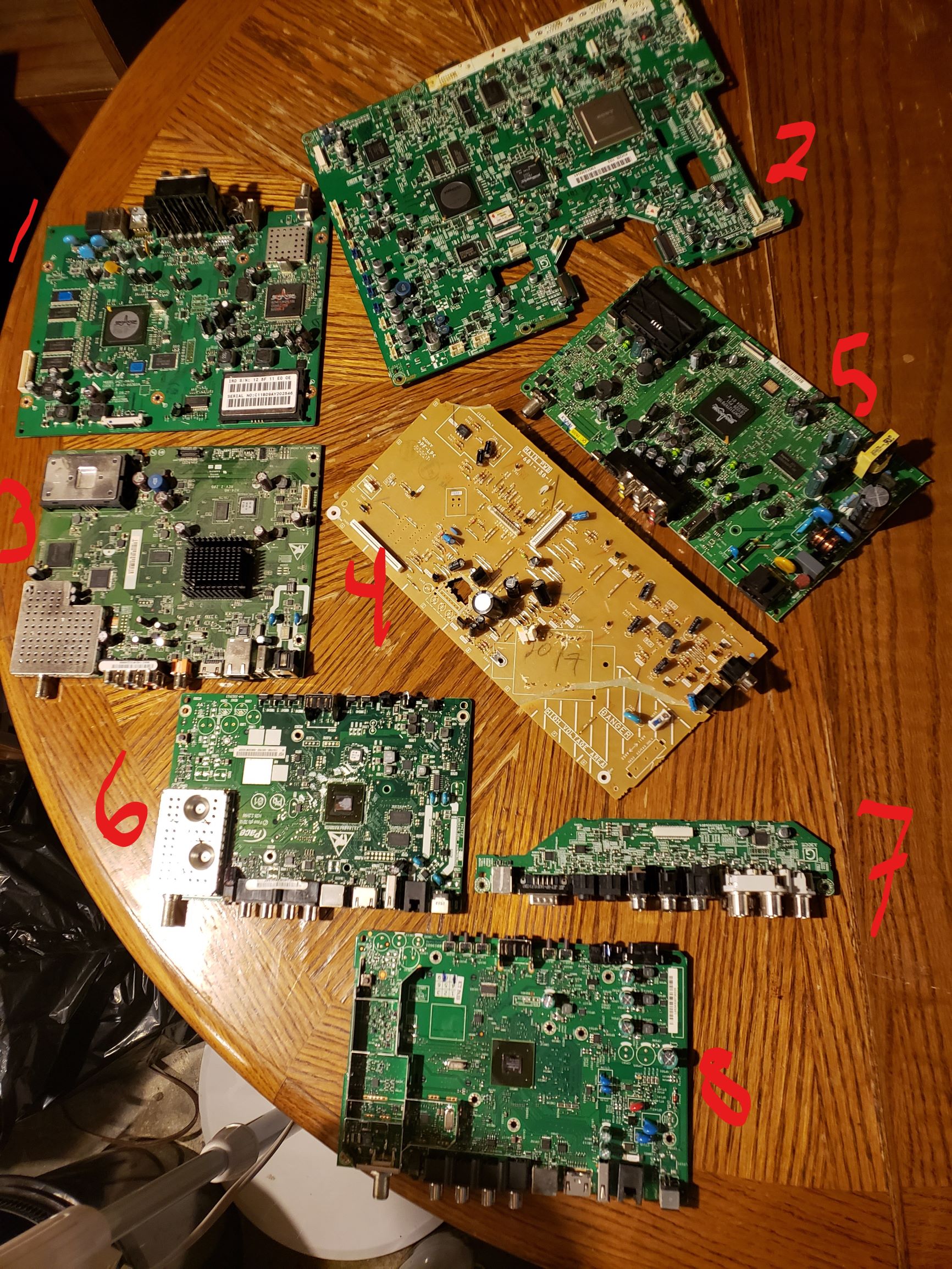

3rd Picture
1-6 all Periph
10,13,15,16 - Periph
Not sure on others

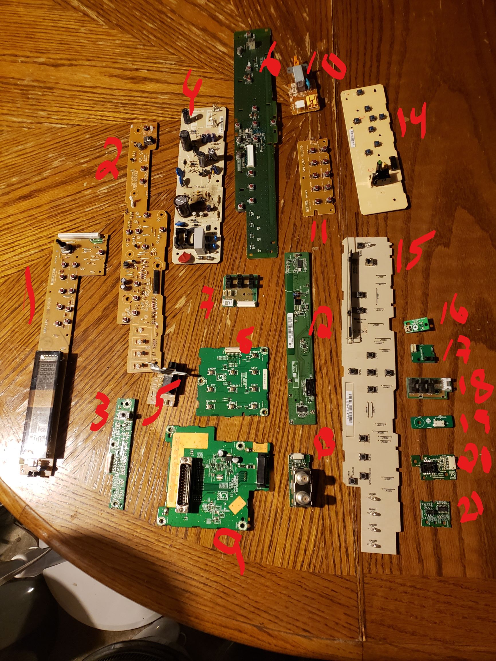

4th Picture
3,4,7-Periph
1,2,8,9-Gold finger boards? Wasnt sure if 2 was empty RAM
PostPosted: Fri Aug 30, 2019 1:59 pm
Posts: 10491
1)peripheral
2)peripheral
3)peripheral
4)low
5)peripheral
6)peripheral
7)midgrade
8)peripheral
1)low
2)low
3)low
4)low
5)low
6)mid
7)low
8)low
9)peripheral
10)low
11)low
12)mid
13)low
14)low
15)low
16)low
17)low
18)mid
19)low
20)mid
21)mid
1)mid
2)peripheral
3)peripheral
4)peripheral
5)mid
6)peripheral
7)mid
8)mid
9)mid
10)mid
11)mid
12)mid
13)mid
14)mid
15)mid
16)mid
17)low
1)peripheral
2)peripheral
3)mid (tiny gold saves it)
4)mid
5)peripheral
6)mid
7)mid
8)mid
9)peripheral
PostPosted: Tue Sep 03, 2019 2:41 pm
Joined: Tue Aug 20, 2019 4:47 pm
Posts: 9
I am just curious, so on the first picture, you made note of #6, #7 and #8 as mid-grade. I thought anything with a Jack would go as peripheral?
All three of those are from Cable Boxes.
PostPosted: Tue Sep 03, 2019 3:48 pm
Posts: 10491
Two comments. I got the photos messed up in my head. Two of those were indeed Peripheral. Sorry
Second. The class devisions have changed and expanded considerably recently. As all businesses grow and change some things change with them. The simple existence of the jacks is no longer enough to make peripheral; currently. I’ll re review these in a little while. Look back for a final list tomorrow.
