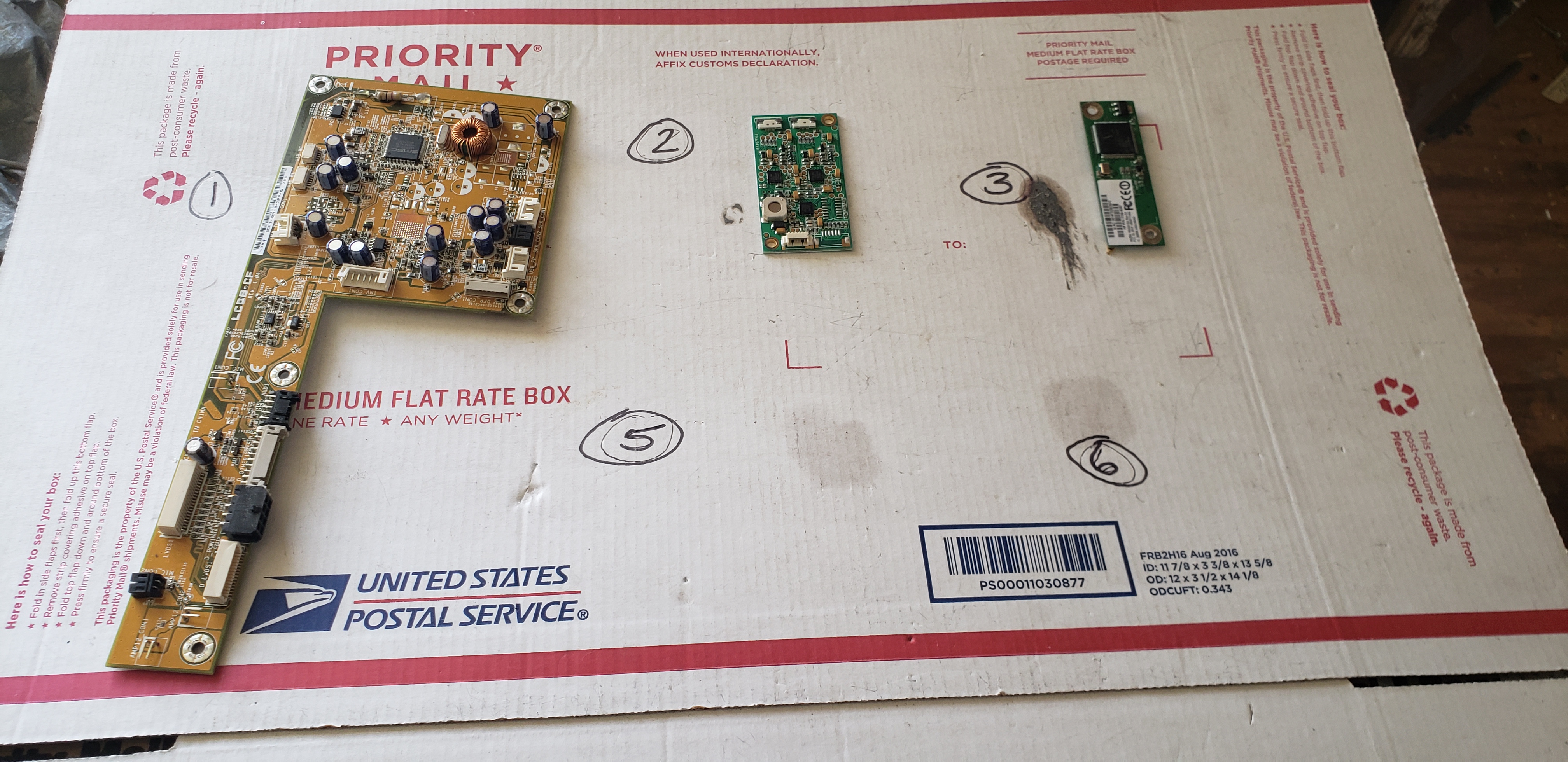

Last couple for today.

The two smaller board should go peripheral the brown one I believe is low grade maybe mid grade.....I would wait and see what Lost says for sure.
PostPosted: Thu Jan 30, 2020 1:42 pm
1: Thinking low grade here. Would like to see the bottom of the board to see if there's other components on the back side that could upgrade it to mid grade. Doesn't look like your typical power board.
2: Peripheral. Three small ICs and many of what I think are tantalum capacitors.
3: Mid Grade. Only thing I see is just that one square IC. Would need to see the back side to determine if the board could be upgraded to peripheral.

Agree on 1: it’s not a power board. It’s a low profile signal relay board; I/o etc.
It has only one gold pin port. Most of the power pins are steel, and a few tin signal pin ports, eg USB ports. This one is definitely low unless it has a massive amount of ICs on the back.. which is unlikely.
2 has two gold pin ribbon connectors and ICs. We agree again.
I believe 3 has a small gold port on the underside? This is already on the border of peripheral. If there a small round gold port any anything other than steel on the other side it will clear peripheral.
