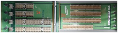

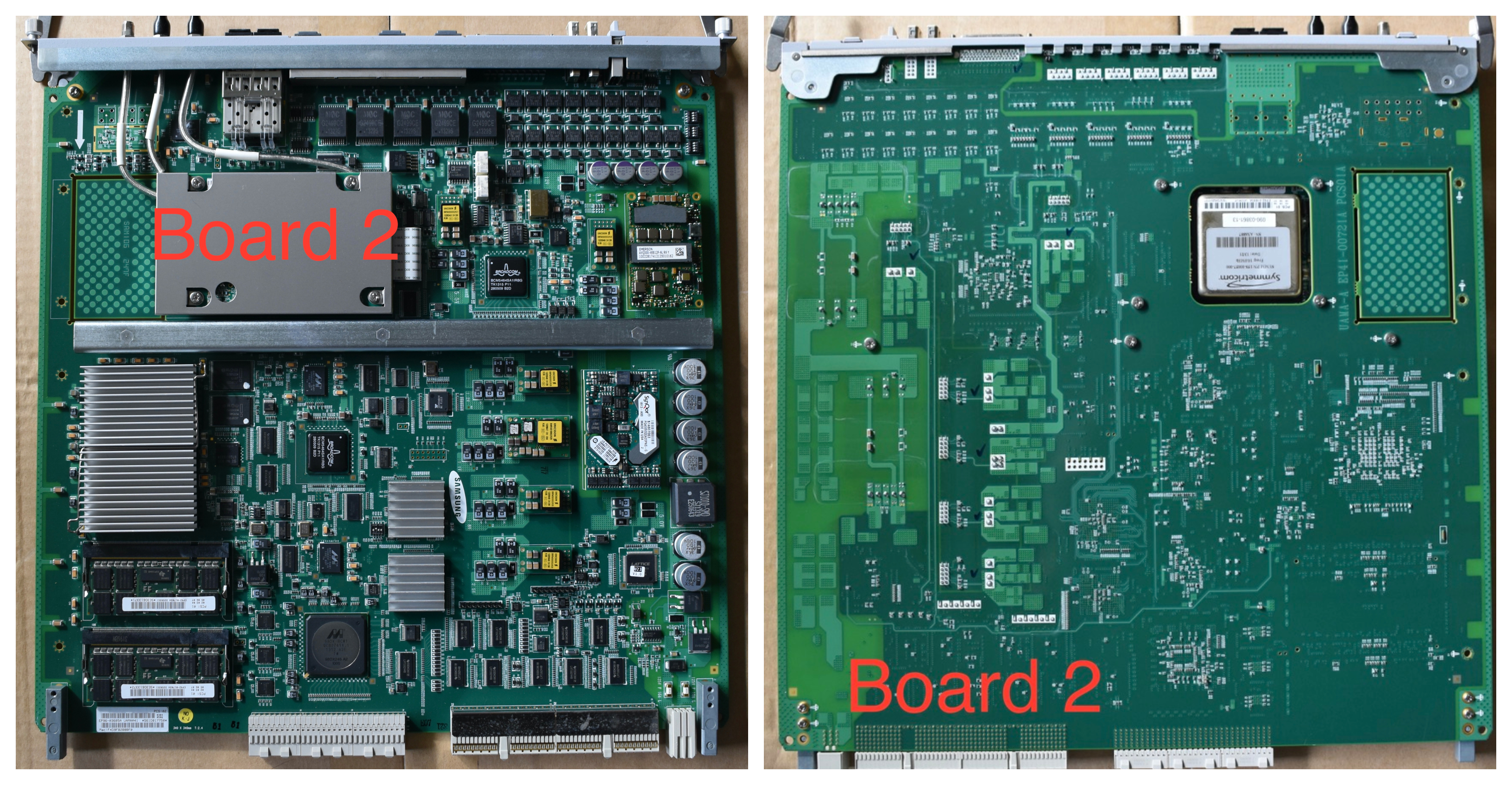

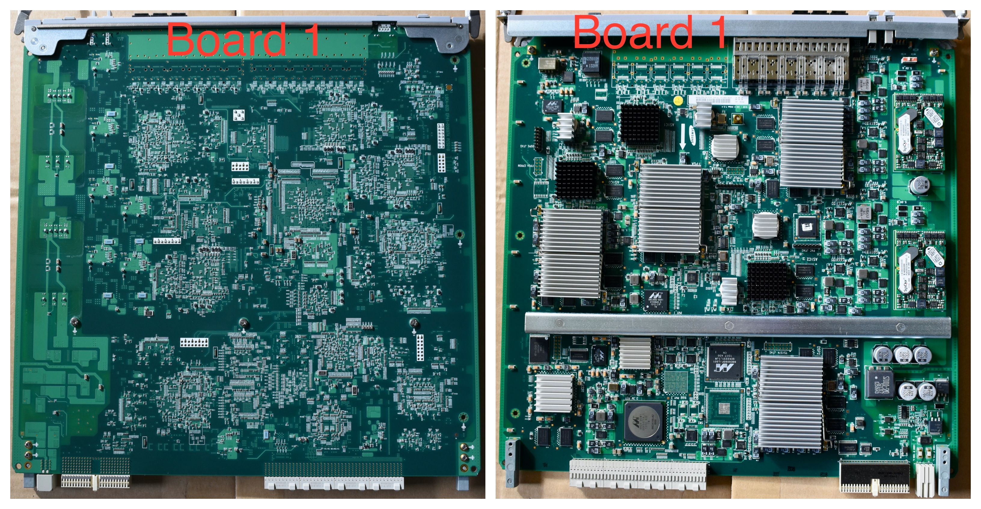

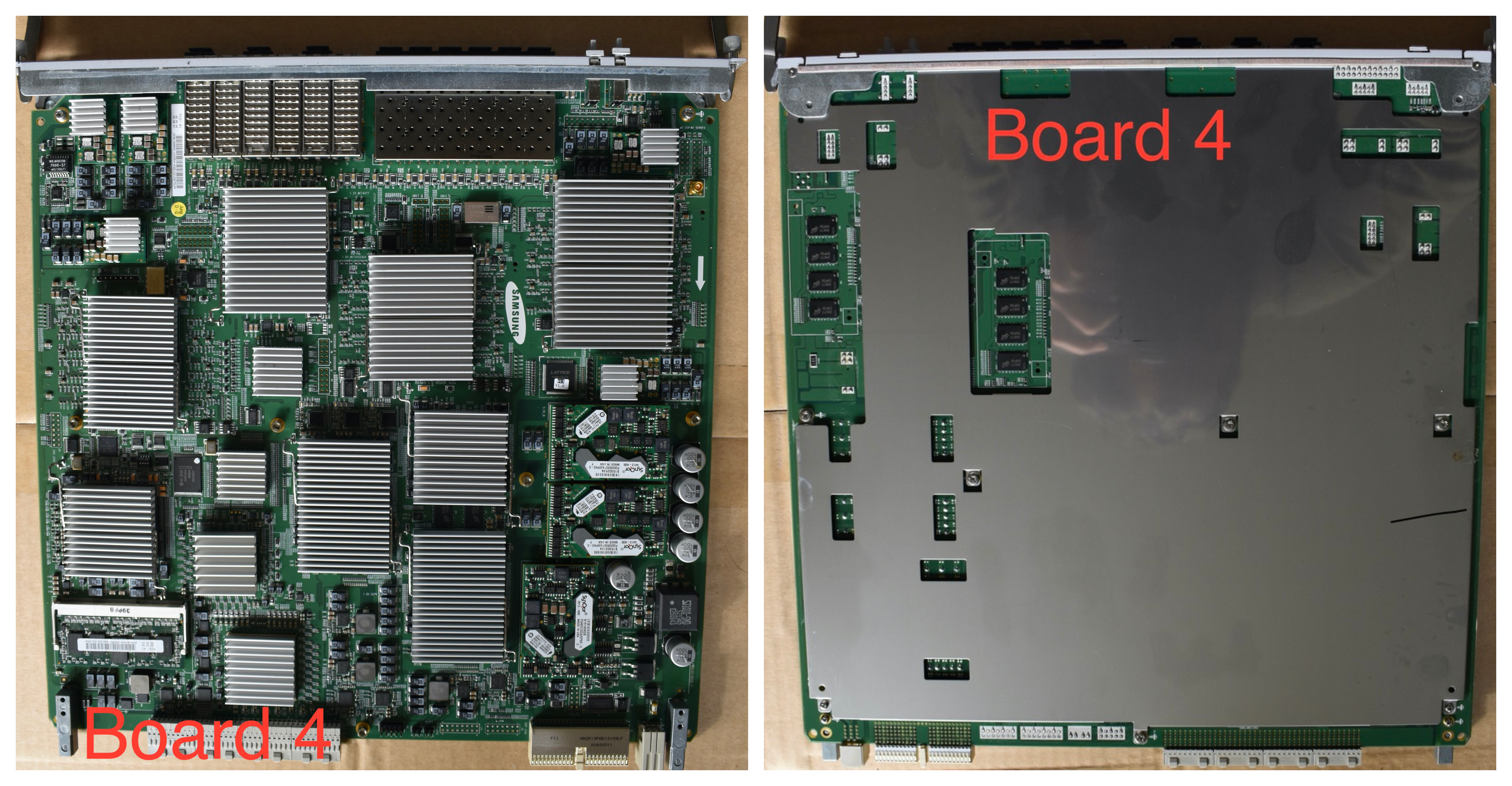

Thank you for taking the time to look at these.
I have three different types of boards and a board in the back they slide into (board 3a 3b).
I assume heat sinks, shielding and the front panel come off. What else is normally removed to make the process smoother and to give accurate weights?
Thanks again!

Board 3 is prolly backplane,
The rest are hard to tell with all the heatsinks, shielding ect, and they're not going to buy them at any decent grade with that stuff still on, so take as much of that off as you can , from what I can see they look like a least a few MAY be high telecom but they'd probably buy as peripheral in this condition (or lower in the case of the full side shield)

1)Peripheral
2)peripheral
3)backplane
4)remove the heatsinks and tray and repost. Could be low telco or peripheral.
