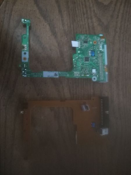

my guesses would be:
small socket
low grade
gfc
low or mid

That last one, if from a floppy drive, should be periph, I think? it's been mentioned that floppy drive boards are one of the only brown boards that buy at gold recovery rates

From browsing thru the form, I gathered that most floppy were periph, except the brown. After that i got confused.

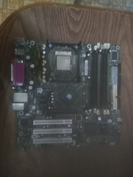

Small socket green

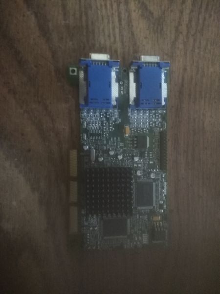

Low

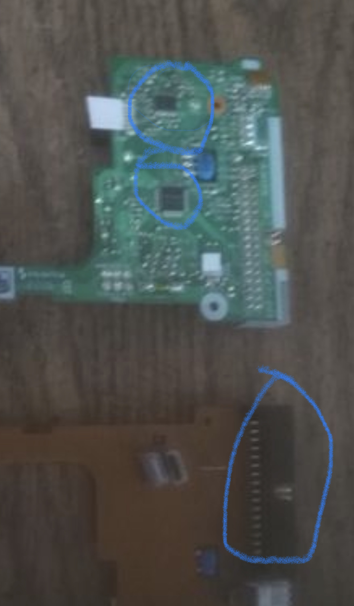

Gold finger card with heatsink
Peripheral
As long as it has the controller and pins the floppy disk boards go as peripheral.

Thank you for the circled picture. Now i know what to look for.

Remove the CPU from the small socket motherboard in the first picture.
