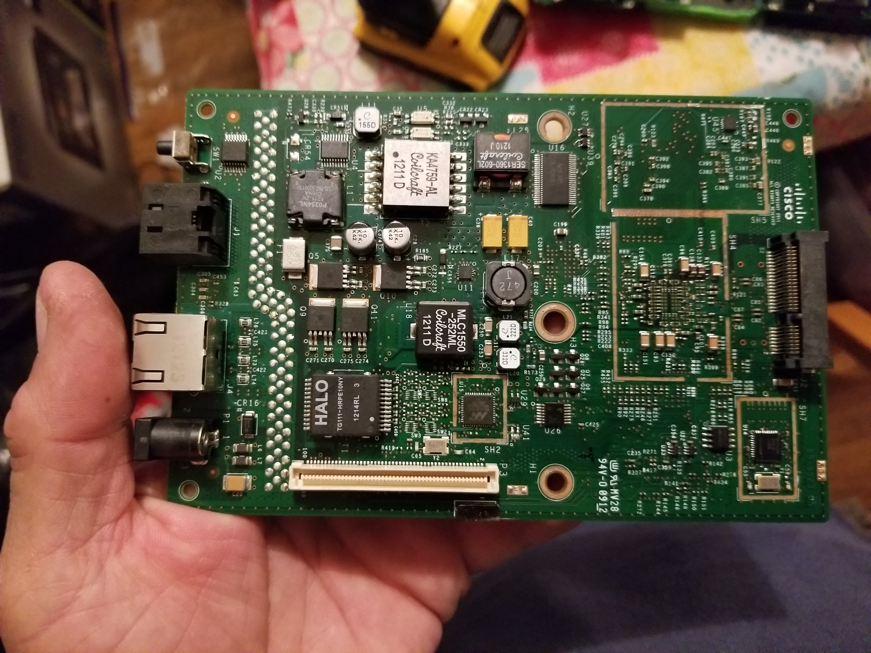

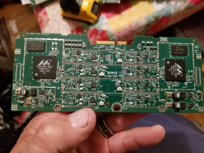

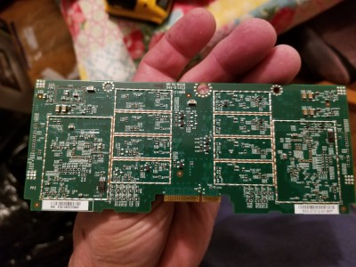

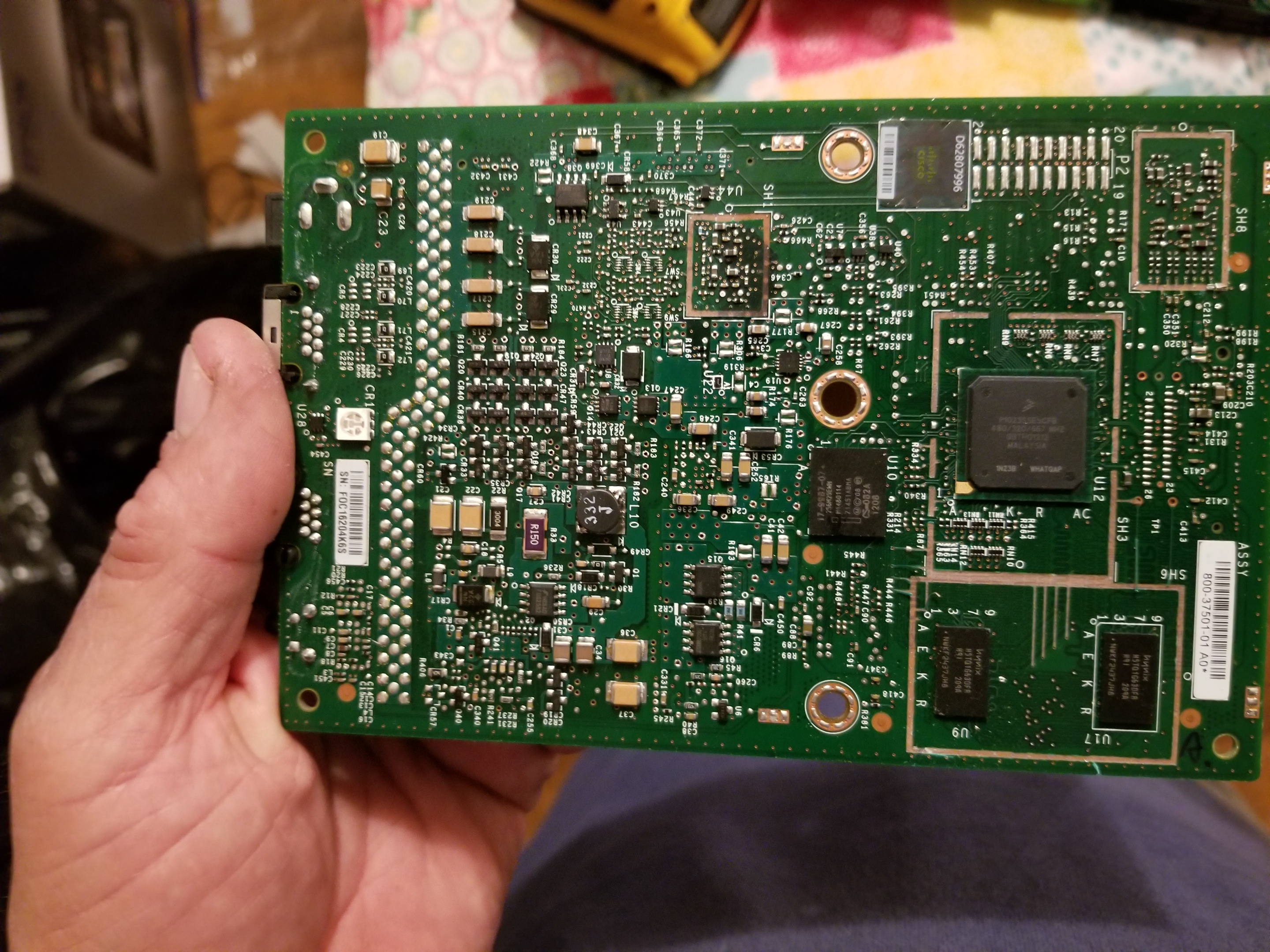

These are air card boards not sure of class
Front and back 2 boards

Top one low telco
Bottom... I think there’s enough quality to offset the small fingers and keep it as a gold finger card.

Hey lost, in your eyes, what pushes top board to local telco?
Are those circular markings on it the same markings you've referenced indicate secondary metallic layers?
Not the flashing rings around the screw holes, the smaller orange dots

Actually this is a prime example that some people just want to be different. Here the markings are meaningless. What does have my attention the multiple MLC ram chips. A controller. Multiple rims. Cache. The compact layout and a high quality tension connector (on the left). The components in the small package move it up for me.
