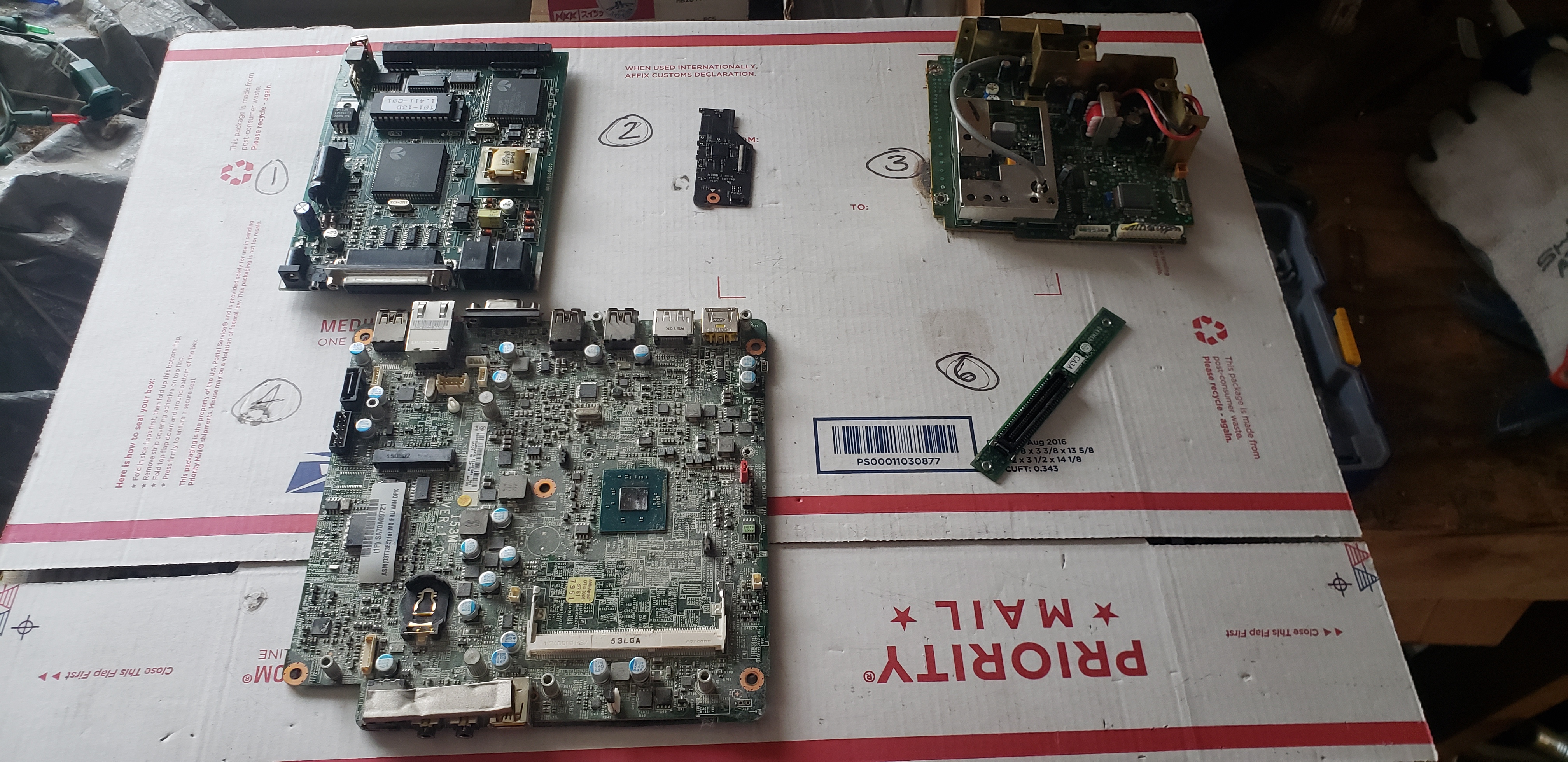

Just a couple more to double check sort

1,2,&4 are peripheral
3 is midgrade, and I don't think it could ever make peripheral, if you start pulling that metal.
If 6 has a chip on the other side, peripheral, if not, gold pin connector
Peripheral@ $1.60/lb ATM is the lowest value material I PERSONALLY will attempt to ship to BoardSort (from FL), so if your shipping to them I'd suggest pulling the pins from that connector board, you'll lose overall sale value but I can't figure out how to afford shipping GPC@.50, clean gold pins however, @$5/lb is a much more attractive option to me, especially since a bag of pins is one of the densest things I'll be shipping (potentially rivalled by ceramic processors)
As for the midgrade, unless you get a really good price locally (how good depends on how much you value your time but at least 20¢/lb which I only get 8) tear them apart as much as you can, lots of metal for local yard, and ics for BoardSort ($6.75/lb awesome)

1)Peripheral
2)Peripheral
3)Low
4)Small socket
6)Peripheral
3 is just a power box without the shell. Despite being green there’s no room to bump it to mid.
4 is REALLY borderline. I’ve had, and been told of, compact boards like this CE going both ways. Ultimately is up to the person at the dock.

Thanks guys for the help and info.
