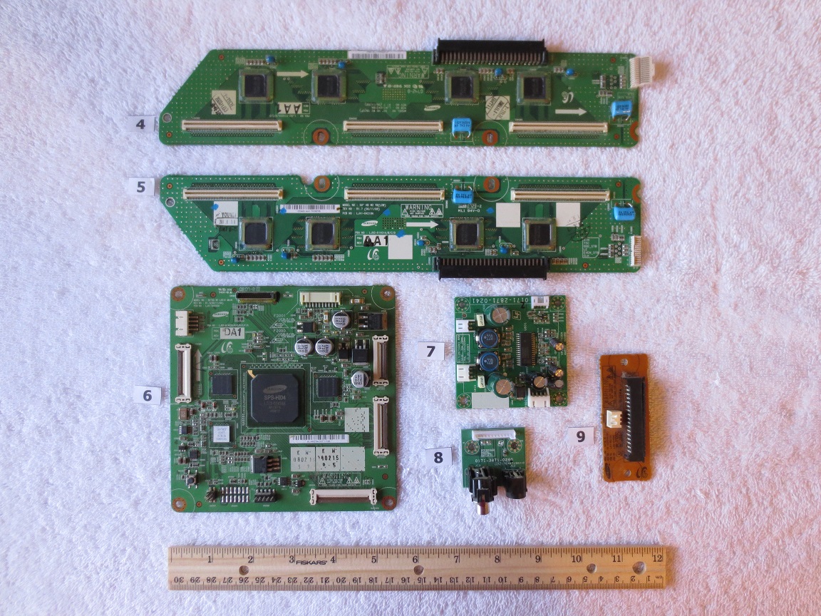

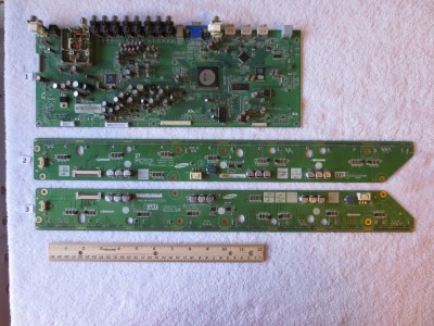

Here are some boards that I'm not completely sure on. They all came out of an old Vizio plasma TV and I think #1 - #6 are peripheral and that the rest are midgrade.

1)peripheral
2)midgrade
3)Midgrade
4)peripheral
5)Peripheral
6)peripheral
7)midgrade
8)Midgrade
9)Low grade
9 I’m basing on my experience of them using tin for the pins here and not nickel. Nickel would be enough to push the board to midgrade.
 Post subject: Re: Grading Verification
PostPosted: Wed Jun 17, 2020 12:32 pm
If I removed the two large green capacitors on #7, would that make it peripheral?
PostPosted: Wed Jun 17, 2020 1:16 pm
Nothing will bring 7 to peripheral.
You could cut the IC off and sell it for IC rate but the board would drop to low.
PostPosted: Wed Jun 17, 2020 1:27 pm
OK. Thanks again.
