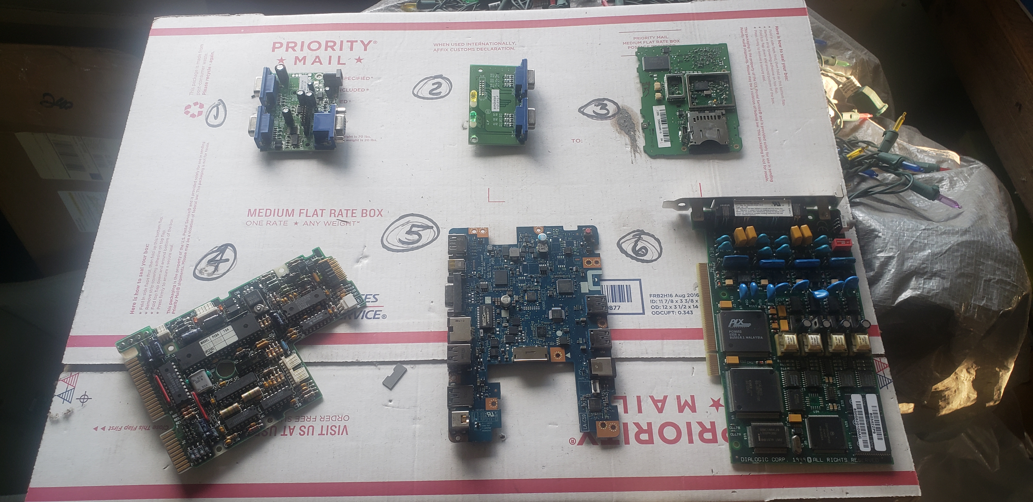

Have a few boards to.verify class. Thanks
 Post subject: Re: Few more odds n ends
PostPosted: Tue Aug 04, 2020 9:31 pm
Posts: 517
Location: Ohio
1- gold pin connector end, if those tall pins are gold plated, peripheral
2- gold pin connector end
3- peripheral
4- high telco
5- peripheral
6- Assuming high telco but could go gold finger card because of the transformers and excess weight ratios

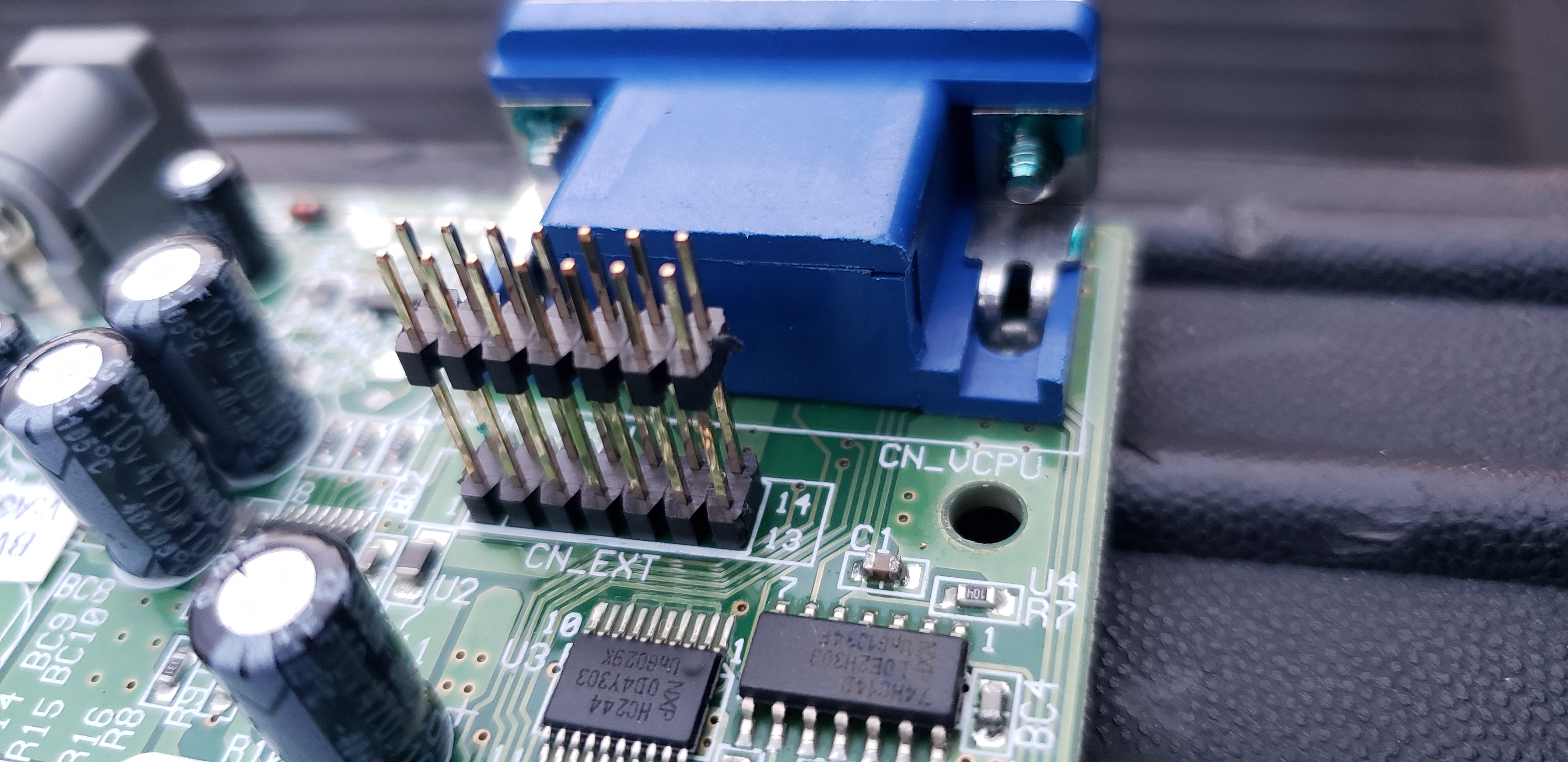

Shot of pins from #1

it can probably sneak into peripheral
PostPosted: Tue Aug 04, 2020 11:58 pm
Posts: 557
Number two may get peripheral if there are bare pins on the back but otherwise I will also say that it is gold pin connector.
PostPosted: Fri Aug 07, 2020 8:24 pm
6 is gold finger card
1 is a problem. In the shell it’s usually in its definitely gold pin connector be it a plastic or metal case.
Open? Less weight so peripheral.
