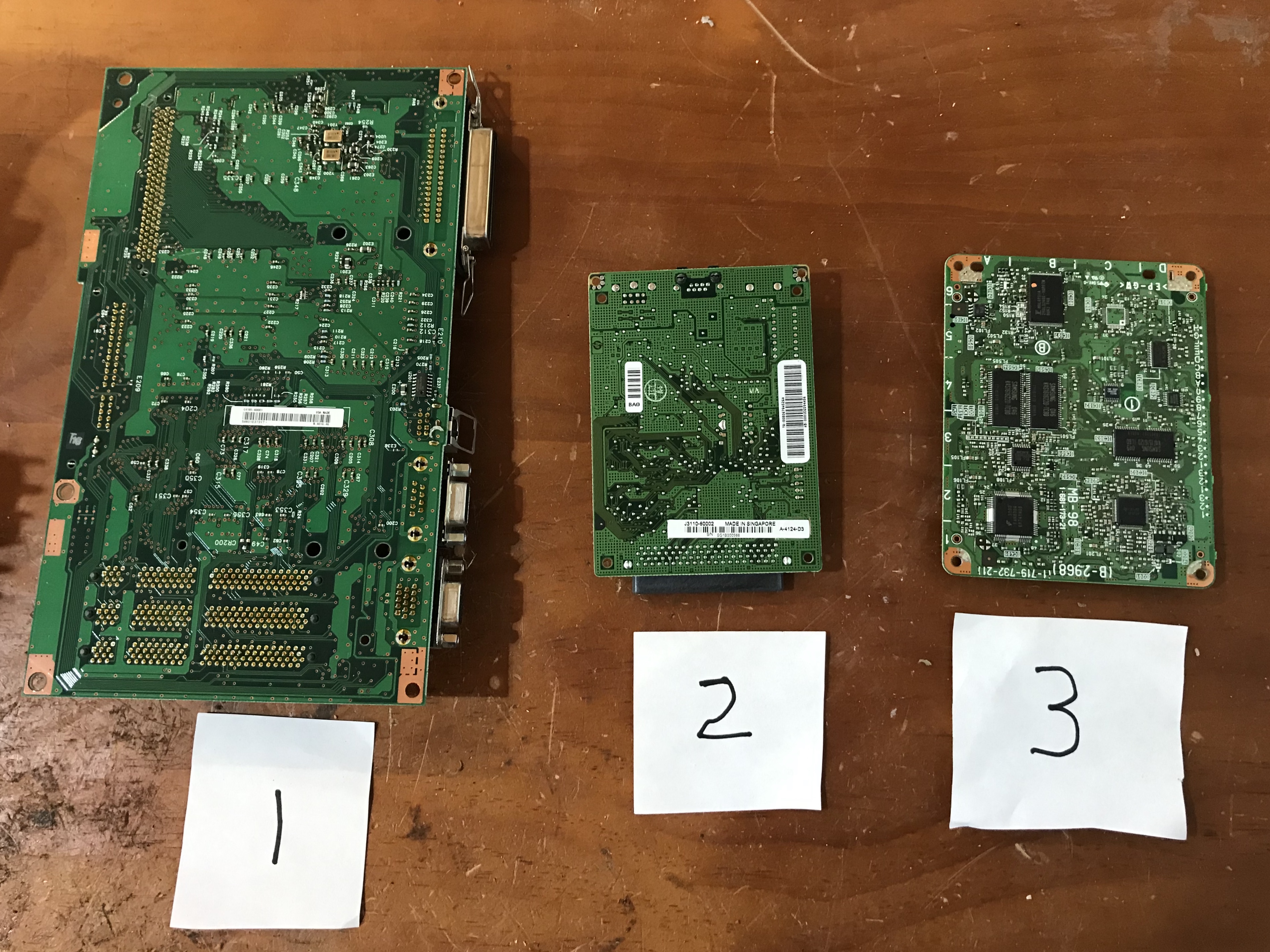

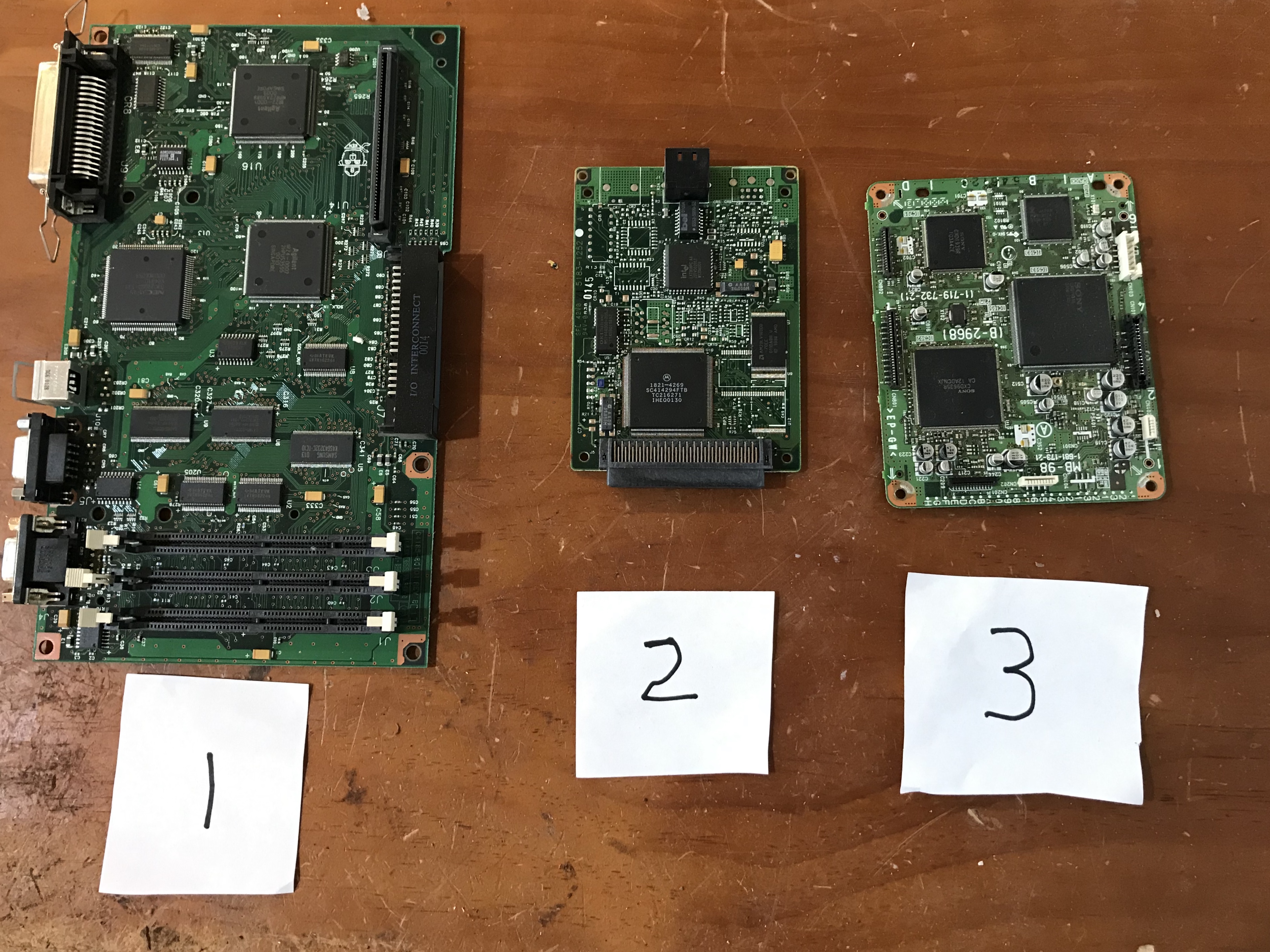

Just a little unsure about these
 Post subject: Re: A few more to grade
PostPosted: Fri Oct 09, 2020 11:36 pm
Posts: 10625
Low telco. It may get better on reception. Or not.
1) low telco
2) peripheral
3) peripheral

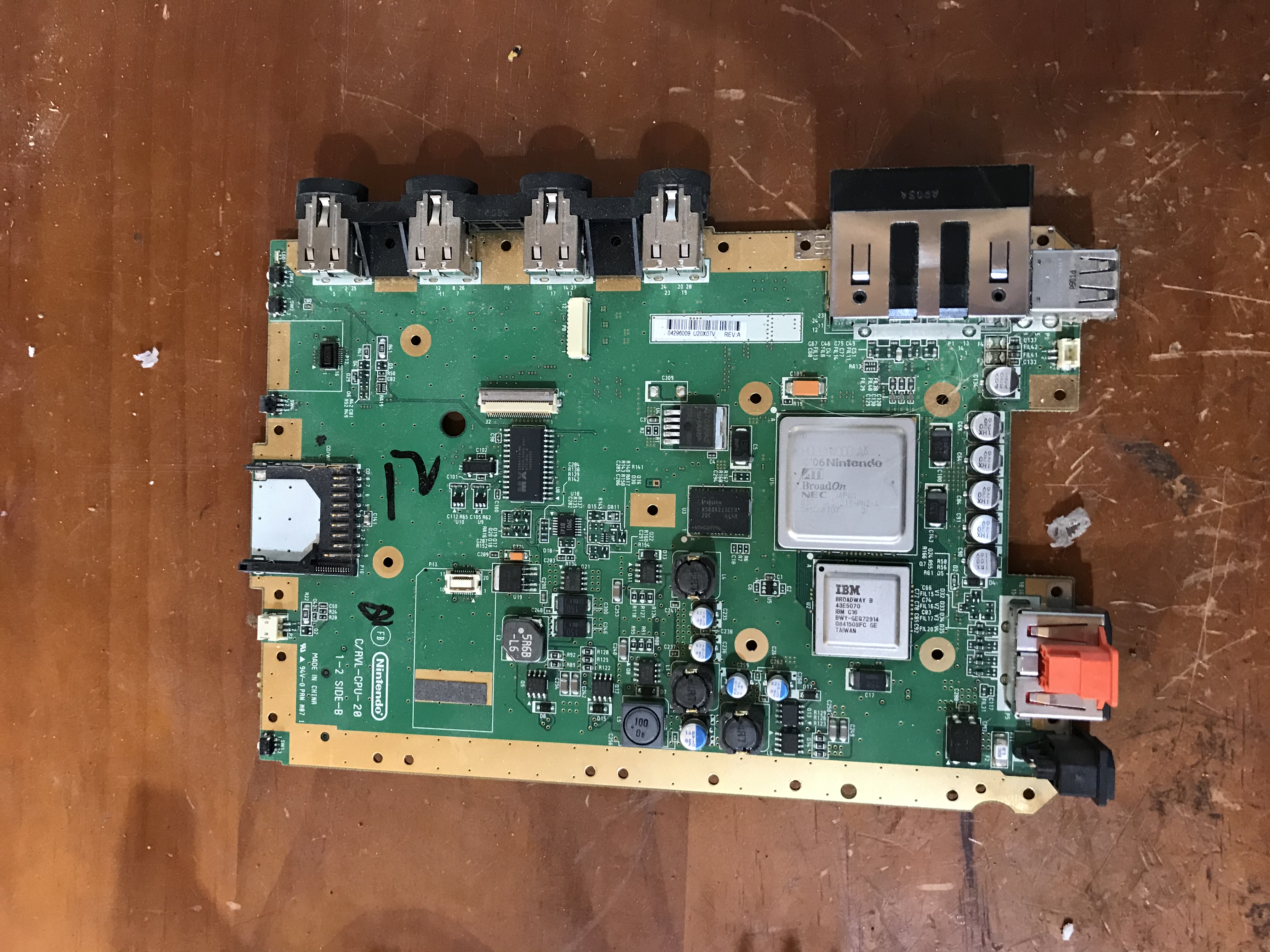

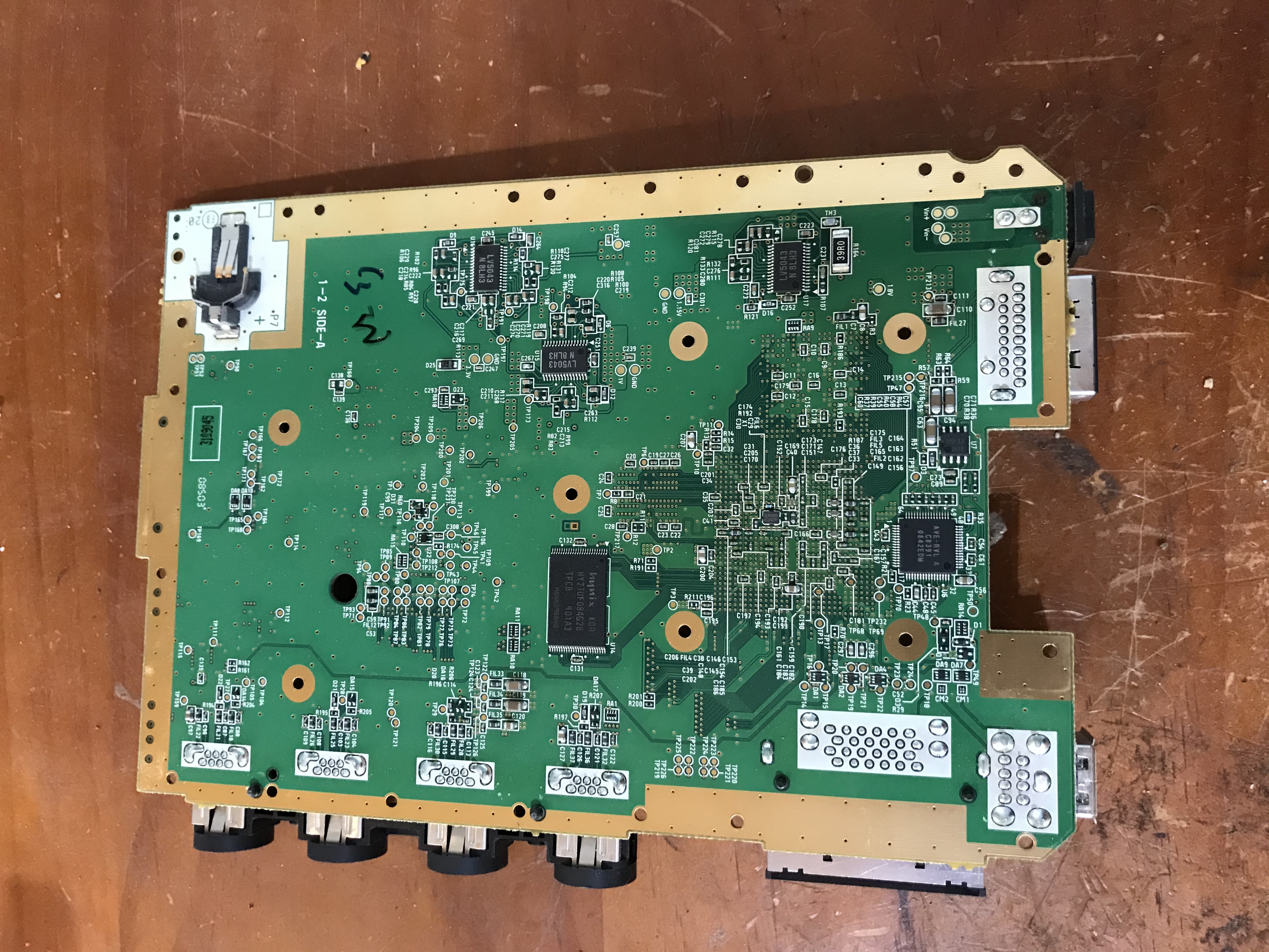

The gaming system, Wii?, Will be peripheral for sure. Hope for anything better.
PostPosted: Sun Oct 11, 2020 2:43 pm
Posts: 10625
My last shipment included a Wii and a switch board.
Quoted them as and received low telco and high telco, respectively.
7th generation and later are very hard to call.
There are at least 6 Wii boards I’ve seen. 4 of which I’d place as peripheral. The PS4 from Brazil and South Korea will also go as low telco given how compact they are.
The switch... the older ones go as high telco. But the redesign goes as low telco. It combines all the io and connectivity chips into a new soc. greatly reducing chip count on the same board.
The vita will likely be high telco but I’ve yet to see one’s insides.
That PSP models range from peripheral main board to high telco.
Some of the ONE boards like the ONE X will clear low telco.
Same with some PS4 Pro.
At some point I need to do a drastic rewriting that game system list buried away in the general section.
