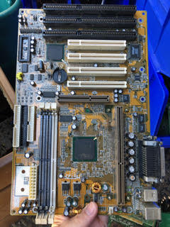

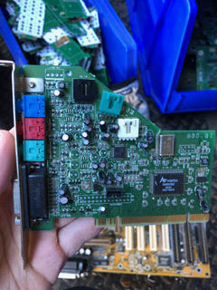

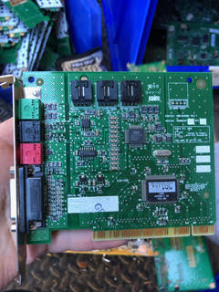

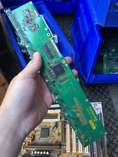

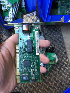

ID Request. Thank you!

That top one is a network card looks like, is there a model number on there? I just sold a lot of five brand new Gigabit network cards still in the package recently.
I would personally not sell anything I didn't test as working, but if you have any desktop pc around that should be easy enough to test.
Bottom two are audio cards I think. This would all be Gold Finger Card NO Fan NO Heatsink WITH Bracket scrap.
The second one is a motherboard...Small or Metal Socket COLOR Motherboard
I think the Toshiba one would be low grade, but not sure.

The motherboard would be a Large Socket Motherboard and the Toshiba board would probably be Low Grade Peripheral.
That is a slot processor motherboard. The chip in the middle is for the chipset, not the CPU

Here's my guess:
1) Gold Finger Card with Bracket
2) Large Socket Motherboard
3) Low Grade Peripheral
4) Gold Finger Card with Bracket
5) Gold Finger Card with Bracket
