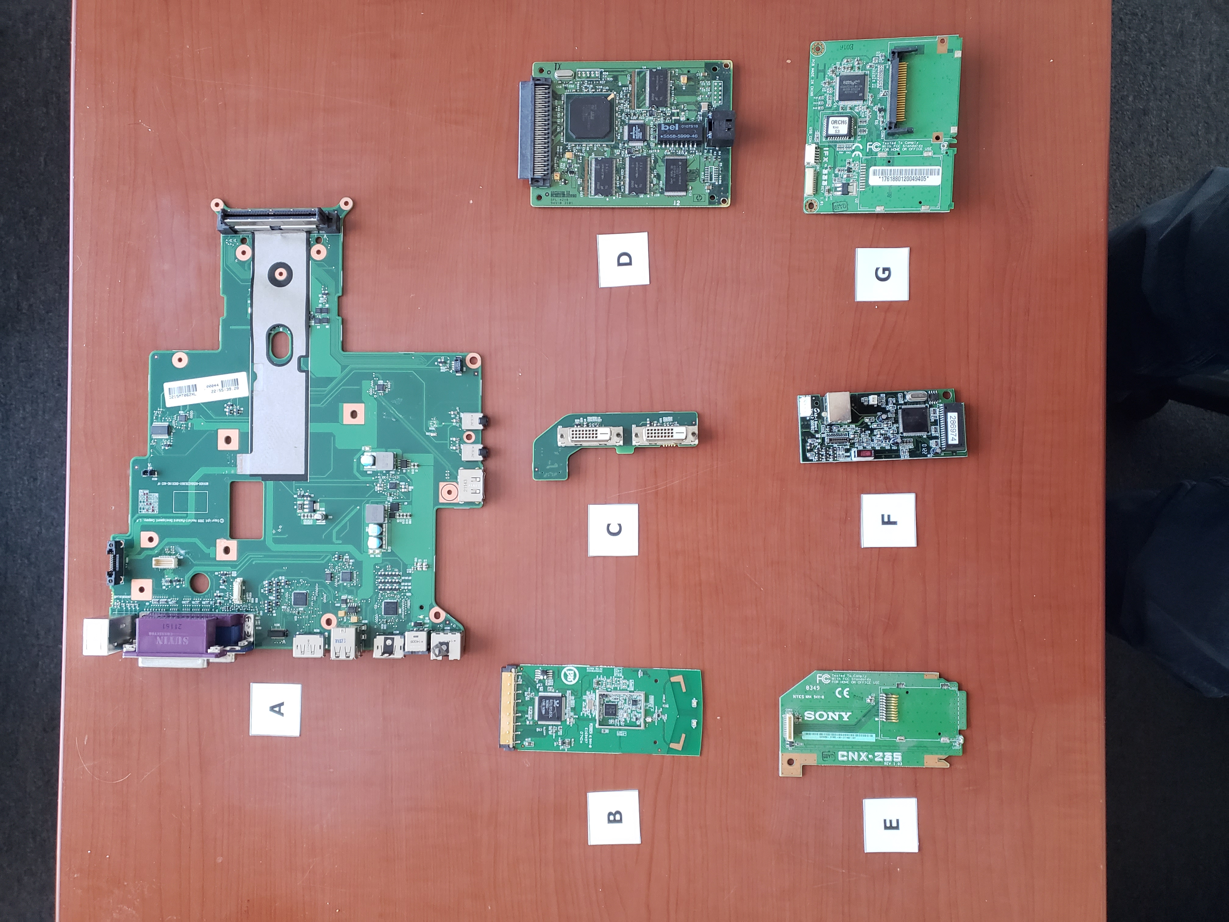

Front and Back Laptop Parts

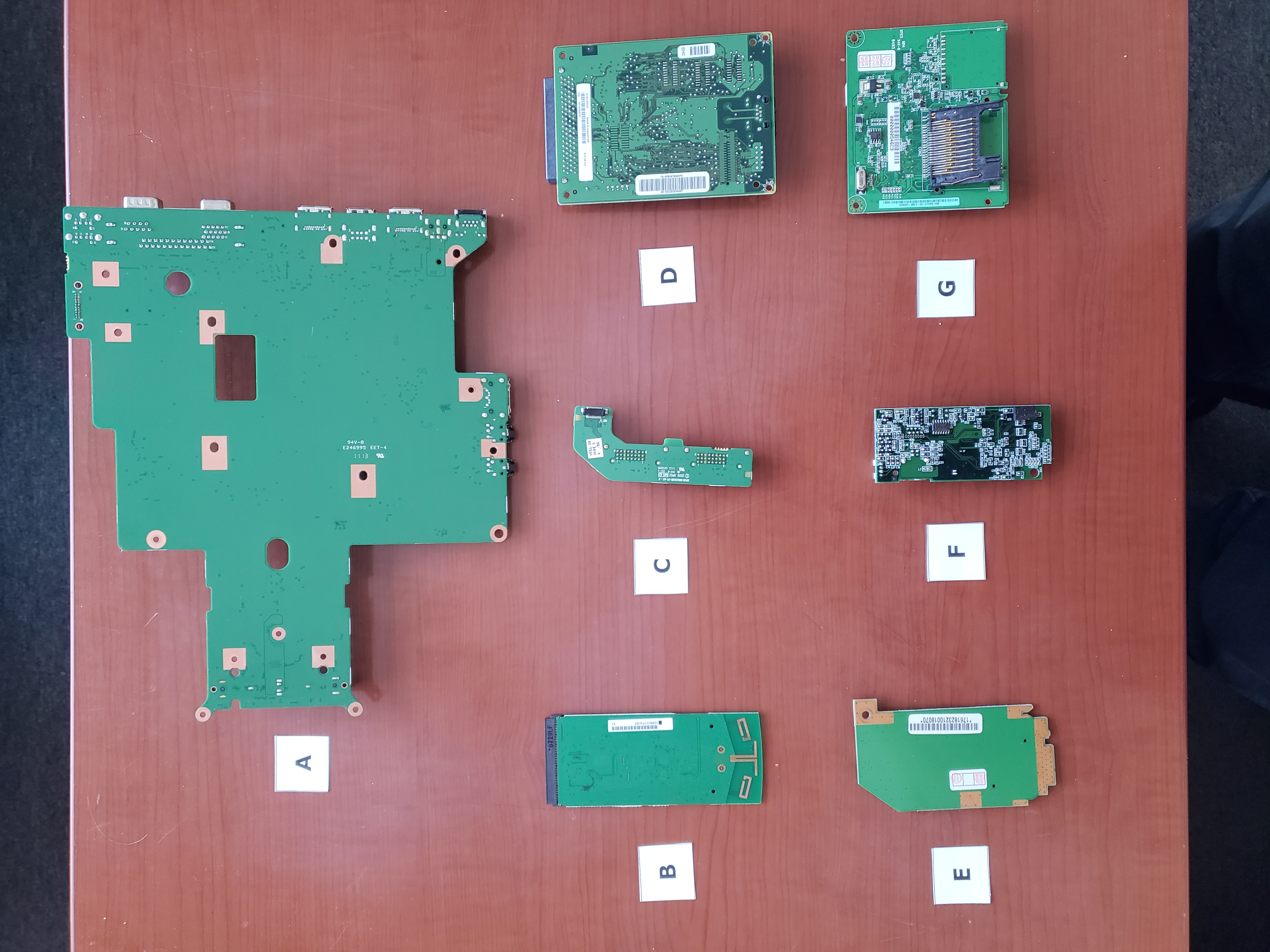

A. Low Peripheral (looks like a docking station which I believe usually get graded lower) Perusing the site to help on another post it looks like my initial grade may be a little low on this board. Seems docking stations typically go high peripheral but can vary enough by board to go a little higher or lower. Looking back this is probably borderline high peripheral, ultimately up to whoever sees it at boardsort.
B. High Peripheral
C. Backplane
D. Low Telco
E. Midgrade (not sure if the gold pins are enough to bump it up)
F. High Peripheral
G. High Peripheral
Again, if someone else like ccusins or lostinlodos says otherwise, go with their grade.

I would think that C would be a Connector End or Low Grade Peripheral instead of Backplane but I could be completely wrong. Wait for Lostinlodos.

Sorting A as Low Peripheral
Sorting the rest as listed except C & E which seems there is some question.

Yeah, A would be Low Grade Peripheral. I seriously doubt C could get Backplane.
And I agree with marked141 on E. I don't think that those few gold pins are enough to bump it to Low Grade Peripheral

Sorted and Done. Thx
