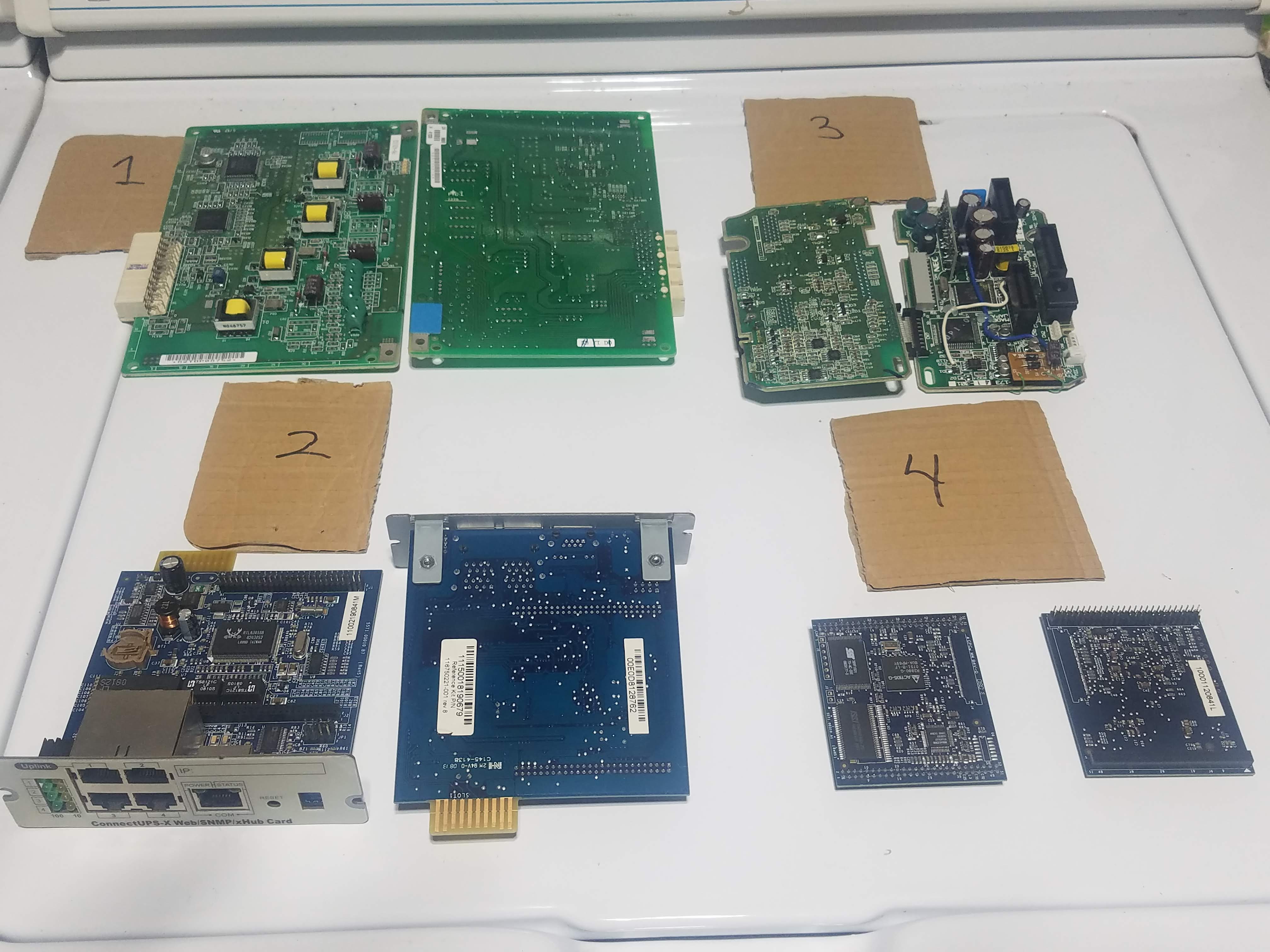

Please grade boards, my thoughts
1. High grade peripheral
2. Gold finger ( can I leave bracket on?) Can I improve board?
3. High grade peripheral
4. High grade peripheral

1. I'm leaning toward low peripheral, there's only two ICs on the board and all those transformers. Are there gold pins in the connector? I don't think it will matter but it might.
2. I don't think there's enough fingers compared to total board for GFC. If there is then it would be GFC with bracket. Take the bracket off then clean GFC no bracket no heatsink. But I'm thinking high peripheral once the bracket is off.
3. Low peripheral, think the weight of capacitors and plastic is going to drop the grade.
4. High peripheral seems right

1. No gold pin, leaning low grade peripheral
2. Can it be improved if capacitors removed
3.Remove bracket worst case high grade peripheral

I think you switched 2 and 3 in your last post.
I'm not 100% sure what all is on that #3 board so I'm not sure.
#2 The fingers are only on one side and very few so I don't think GFC is possible. Get the bracket off and it should be high peripheral.

Marked141 removed all heavy stuff off and reposted let me know what you think

I think he posted it in a new thread. Mcm262, this one?
viewtopic.php?f=4&t=20981
If so I can definitely see the board better in that photo :D
I think it'll be okay in high peripheral now, especially if those pins have gold plating on them.

Pins definitely have gold. Thank you!!!

marked141 wrote:
If ccussins comes along and says different I differ to him.
I agree with marked141. 1 would definitely be Low Grade Peripheral and I would put 2 in High Grade Peripheral with the bracket removed. There is a chance 4 could go higher but I would put it in High Grade Peripheral as well.
