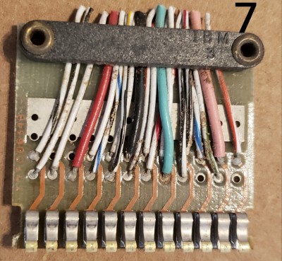

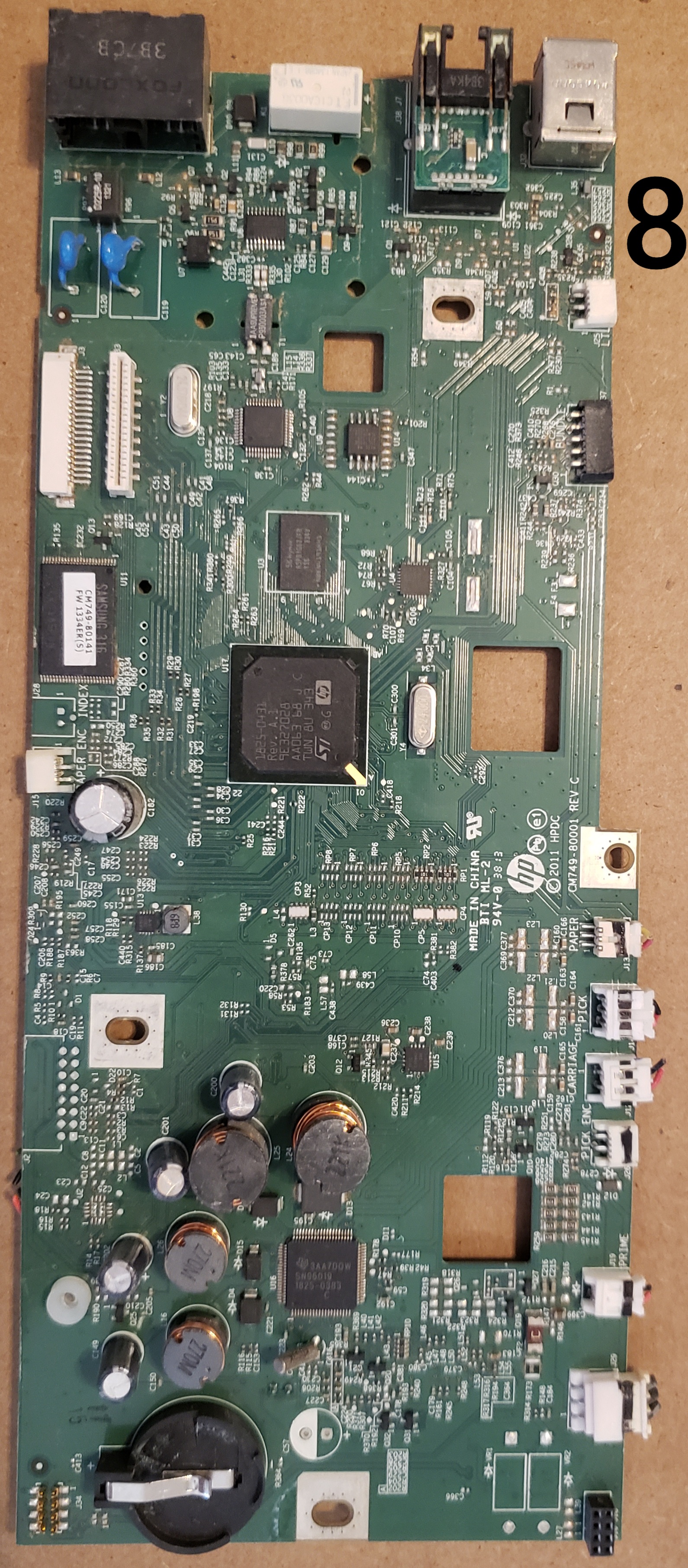

What grade would these boards be?

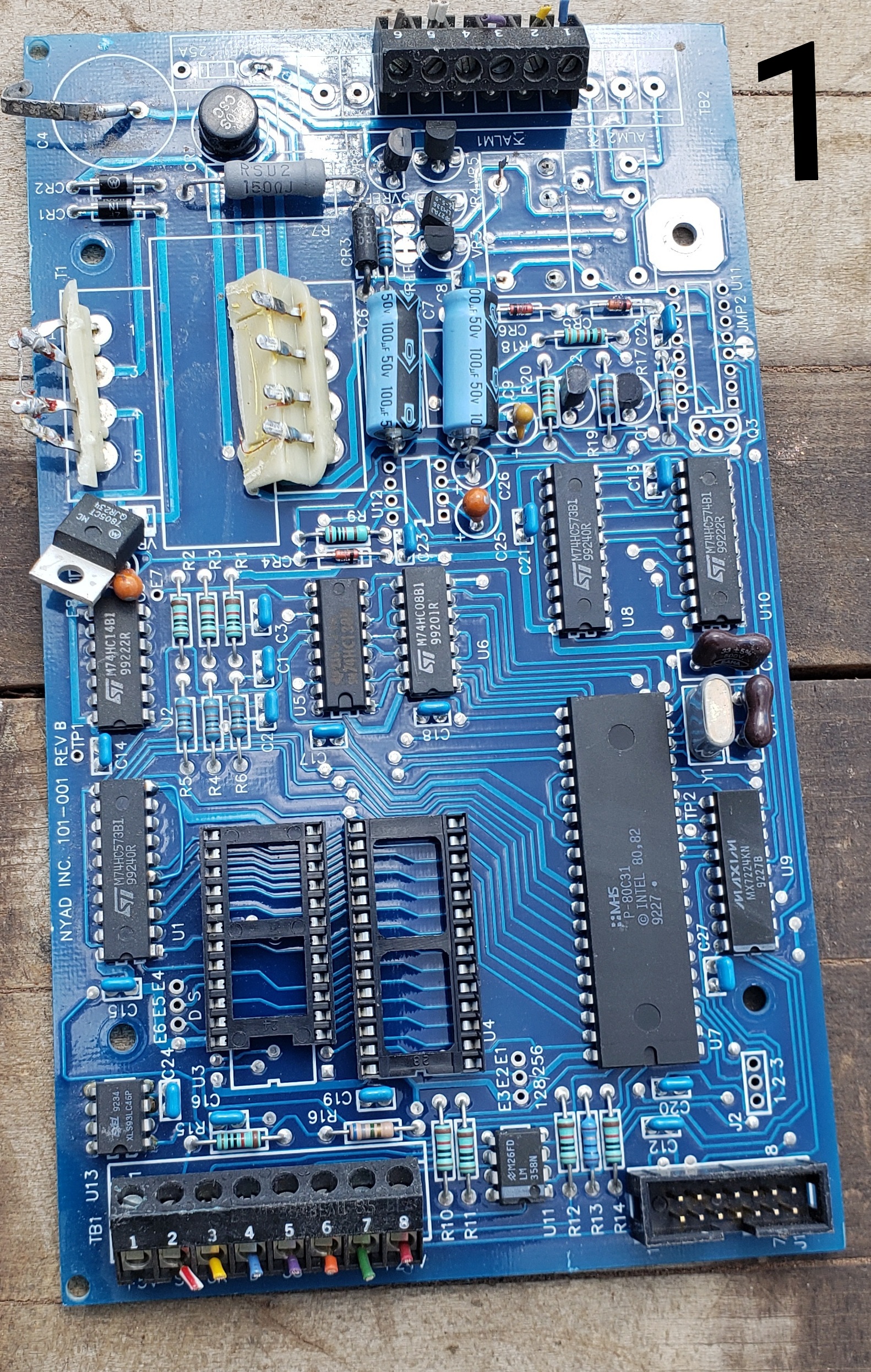

1) High Grade Peripheral

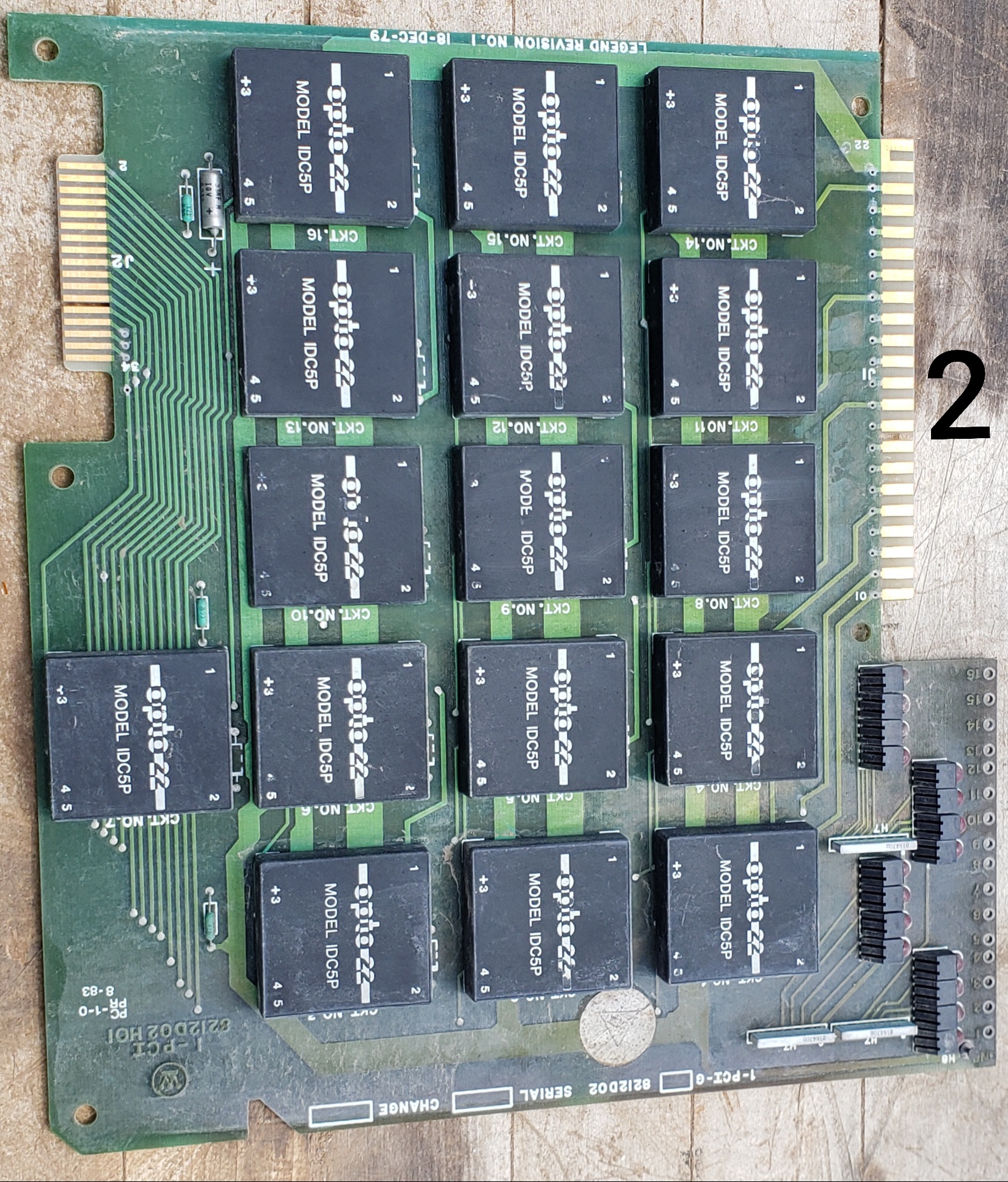

2) High Grade Telecom

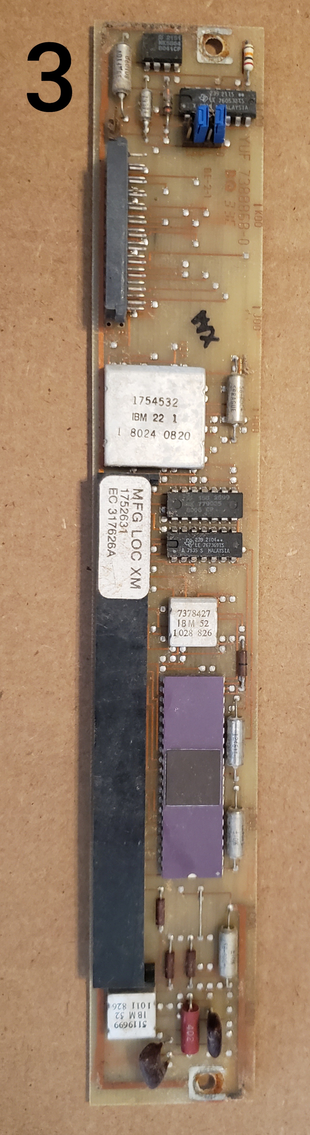

3) High Grade Peripheral

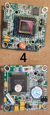

4) Low Grade Telecom

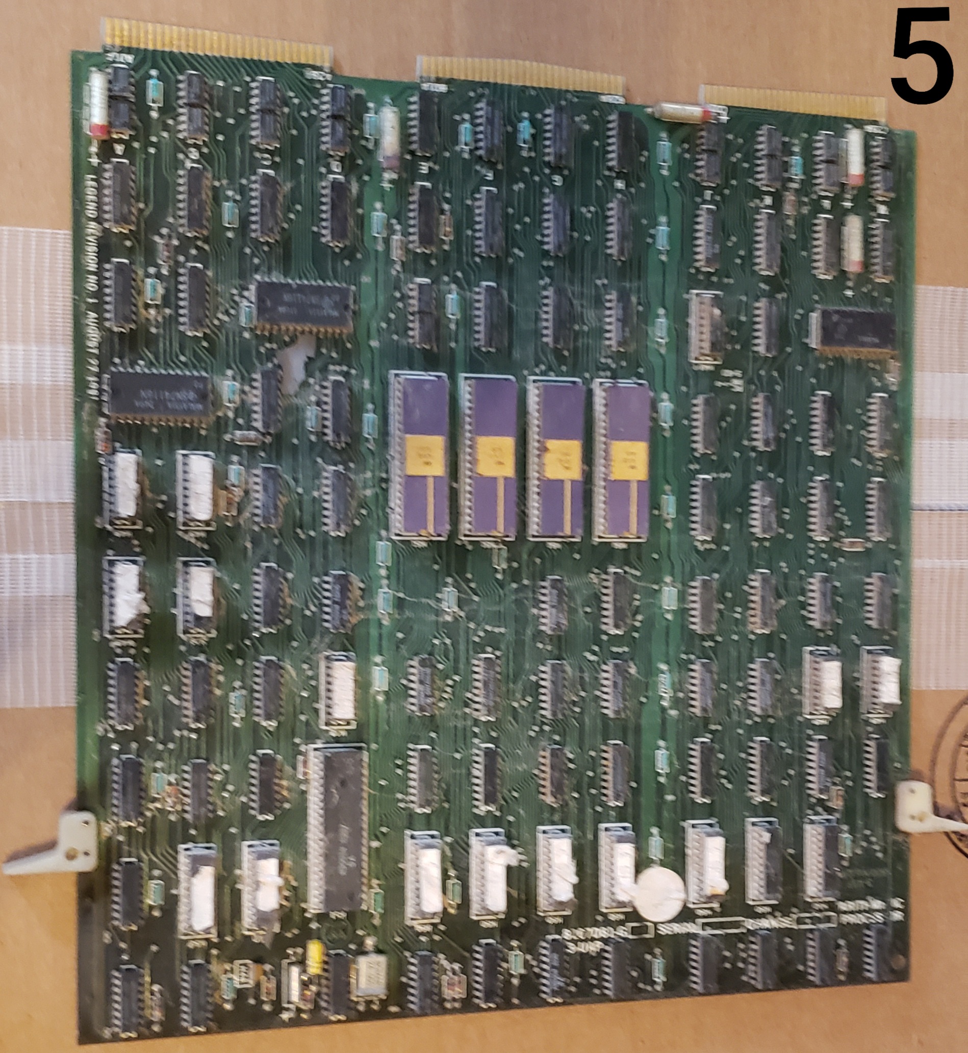

5) Gold Cap Chip Board

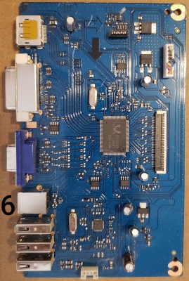

6) High Grade Peripheral
7) Low Grade
8) High Grade Peripheral

What I would do on 5......
Carefully trim the gold fingers......this will NOT down grade the board.
If those gold cap chips have gold pins pull them them for 8086 rate
YES pulling the gold cap chips WILl down grade the board to high telco.
If you aren't sure its worth it you can carefully pull one of the gold cap chips and weigh it and do the calculations and go from there.

Are (4) out of mobile vision camera?

You need to check the chip on board #3 with the black square on it. There could be a gold cap hiding under that black square. That's what I would do anyways. ;)

malphorian1973,
I wondered the same thing but it looks copper. You are right though he should double check it.

@rdw1121 #4 is from a camera. I will also trim gold fingers on #5.
@malphorian1973 I will double check the chip on board #3.

Board 2 - Those black squares are not CPUs, processors or ICs. They are Flat Pack Input Modules. 10-32VDC or 12-32VDC input.
I’d double check with either Chris and/or Lost as to whether or not that board would go as High Telco.
Thinking one would/could trim the gold fingers and board would go as low grade.
In addition, there’s a symbol, do not discard in trash, on the newer year manufacture. So, not sure what’s inside the Opto IDC5P flat packs.
As I said, double check before sending in as high telco or any other grade for that matter.

Board 2 - Those black squares are not CPUs, processors or ICs. They are Flat Pack Input Modules. 10-32VDC or 12-32VDC input.RFIII
If those aren't IC's, the board is probably Low Grade Peripheral.
