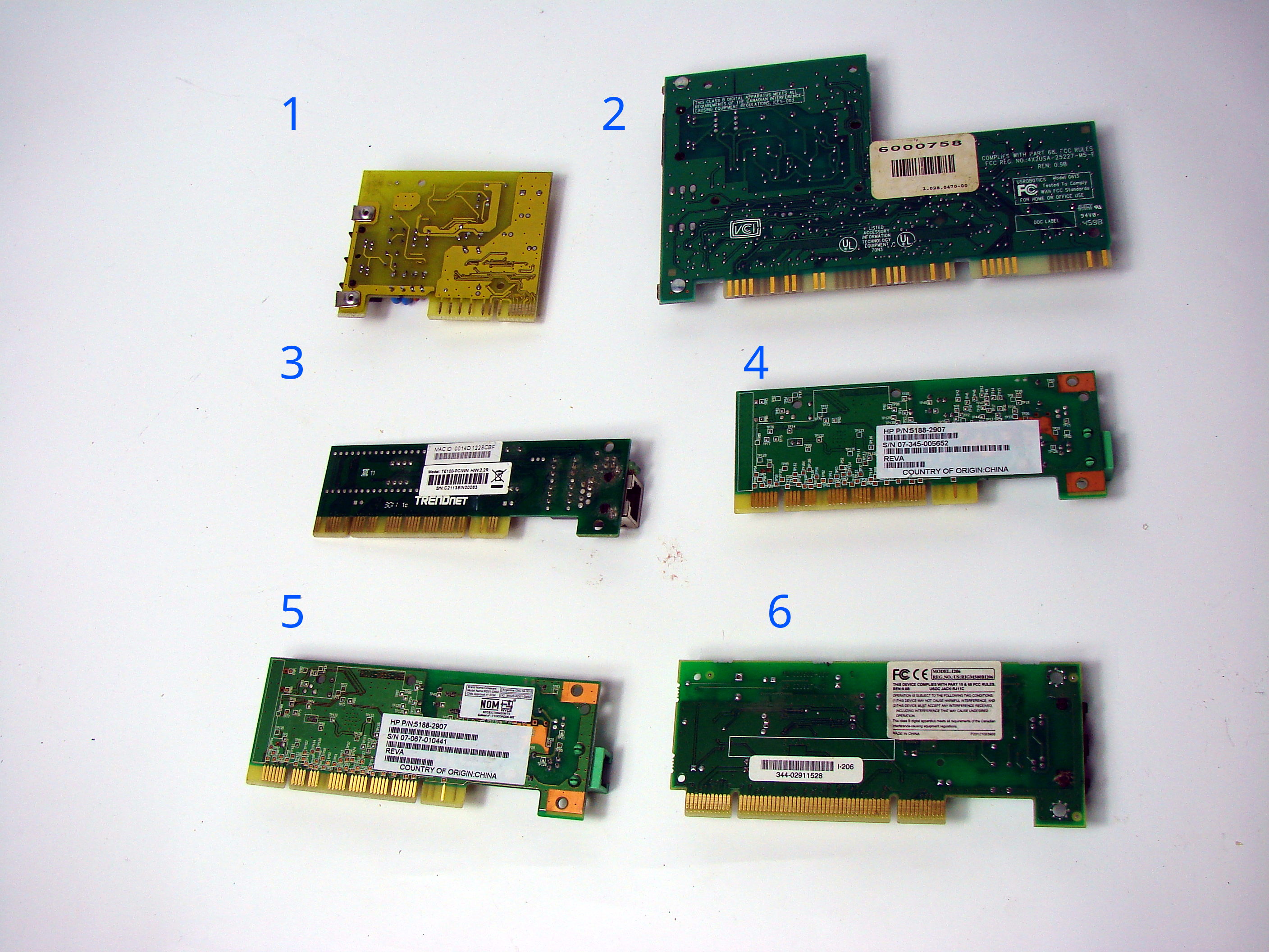

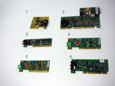

1. Is there enough finger to qualify as clean Gold Finger Card? There isn't much for population. What would it go under if not a Gold Finger Card?
2. Do I need to remove the transformer and speaker to get the clean Gold Finger Card rate?
3-6. Any reason these would not be clean Gold Finger cards?

Every thing here except 1 is clean gold finger card
1 I would say is high peripheral

I think that 1 it has enough finger for clean gold finger card rate (finger is hard too see in the picture along with the similar board color), but I would throw it in low telecom, just to be safe.
Or you could email Chris and ask, because this one is borderline.

I see the the gold fingers on 1, and I may very well be wrong on it. I don't think it will quite make GFC (not enough there).

#1 ended up being able to go for Clean gold finger
